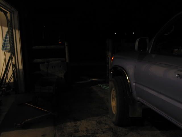

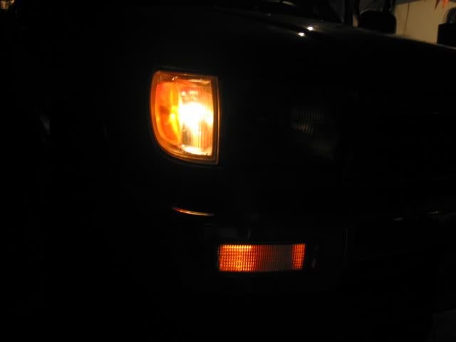

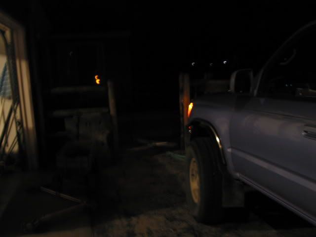

Not blinking, then blinking. It blinks amber though the camera isn't really picking that up...
Approaching the front of the truck, marker only, then blinker. That other odd light is the reflection in the sliding glass door...
As close to blinking/not blinking as I could get...

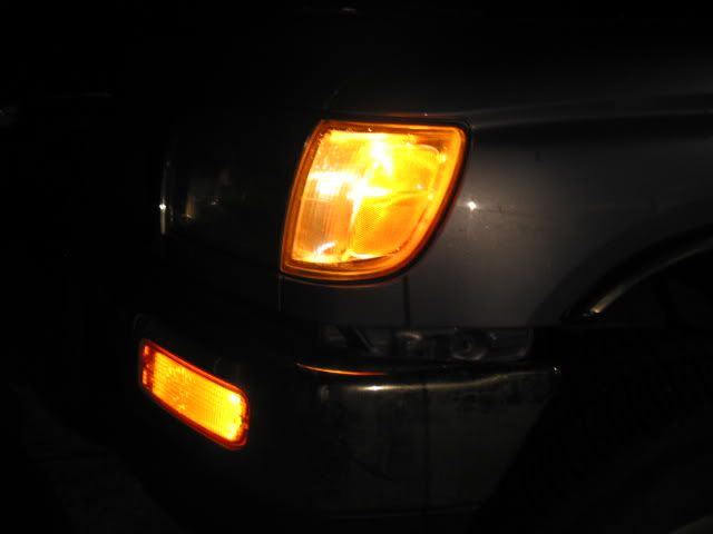

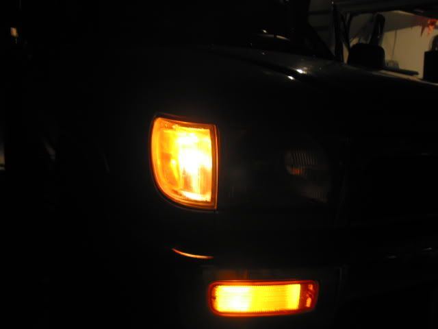

I took pics of one side with 168 clear and the other 921 natural amber. The camera could not pick out the difference in brightness or color. I could see the difference in person though.
Thanks to rworegon for the 921 bulb idea. It is a good deal brighter. I'm glad I used the amber bulb. It makes it even more blinker-like, especially in the front where the lens is clear and even on the side where most of the lens is orange. I did have to make my holes a tad bigger for the bigger bulbs, but it wasn't a big deal and the sockets still fit fine.
