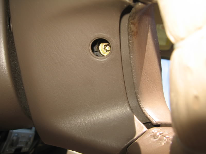

With the button cap removed, you can see the #27 torx nut. I started out removing it with 5/32 allen wrench
because I didn't think I had any torx bits. Later on, I did find a #27 torx bit. Btw, the screws don't actually
come out. They just loosen and stay in place.
Below is the torx screw on the left side of the wheel.
You remove the screw on either side of the wheel. Then you tuggle the horn/airbag assembly off the wheel.

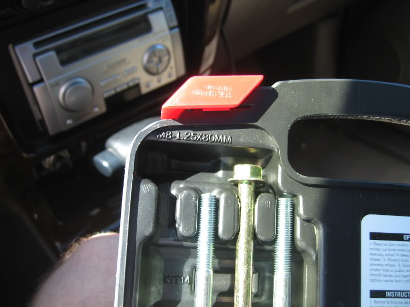

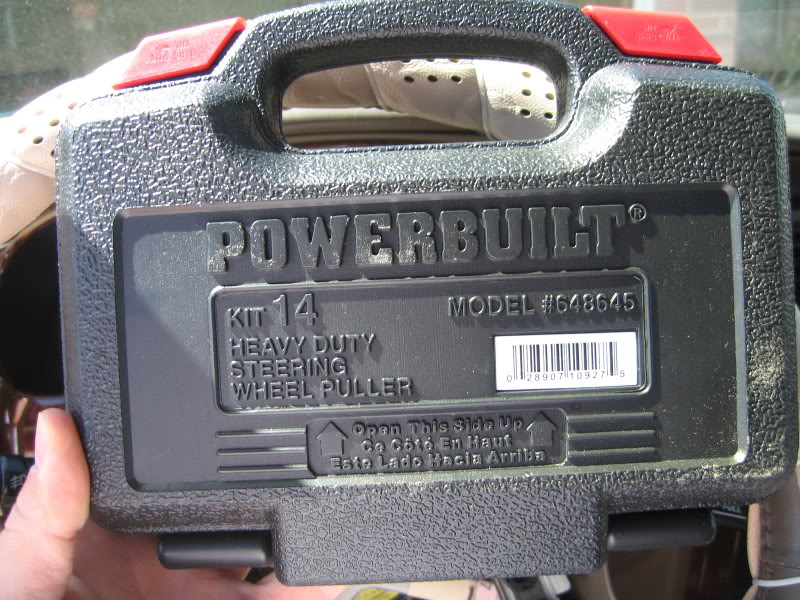

This is what the $5 rental steering wheel puller kit from my local Discount auto parts looks like. You give them
$30, they give you the kit. Then when you return it, they give you $25 back. You get something like 30 days
to borrow it.
You'll use the M8 1.25x80mm screws to remove the steering wheel.
