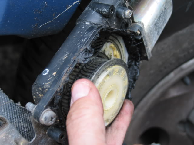

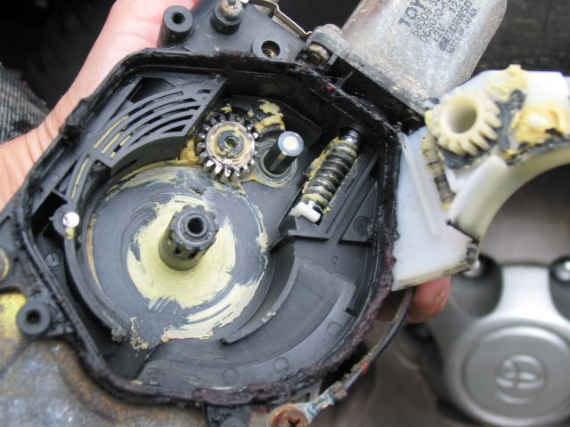

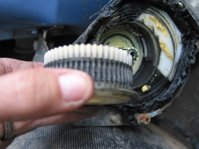

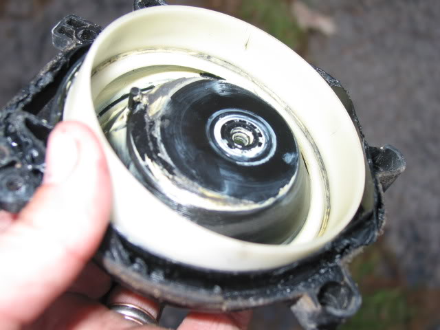

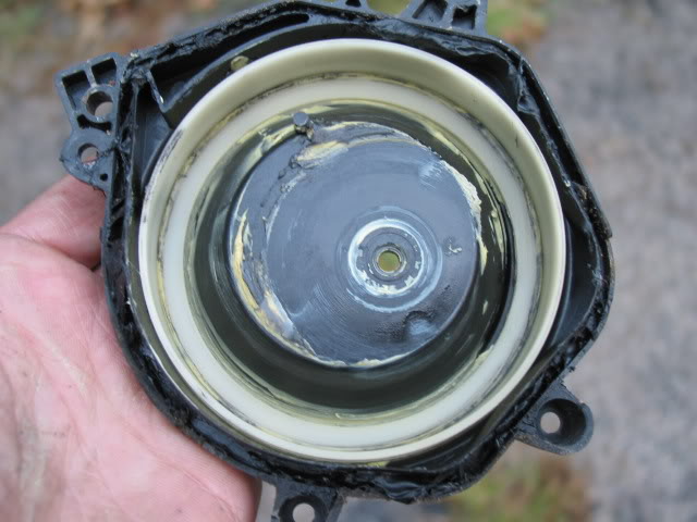

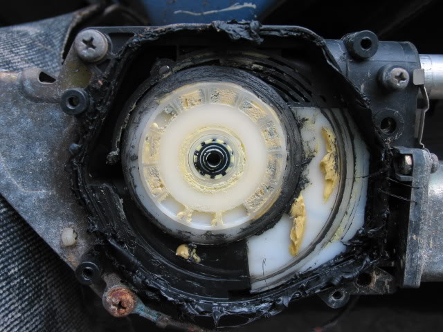

These were taken as documentation, not to figure out a situation like yours. It'd seem like he couldn't have plugged the antenna in backwards, that plug is keyed one way iirc. I don't know that the ground wire in the pic would make much difference other than not running if not grounded? It would be interesting to see what happened...if you figure it out please let us know (curiosity)

Thanks a lot for the help. Maybe he took off the motor portion and reversed it?

There has to be a connection internal to the motor case that got reversed. I can't think of anything else. Even reversing the worm gear would not do it; it would still drive the gear the same direction. Please post if you figure it out.

What I don't get is that to get the pieces out all he has to take out is the round center sections. He would not have needed to mess with the gears at all, and definitely not with the motor. No electrical either, other than that little wire you can see in my pics gets unscrewed at the bottom (iirc) and the connector he unplugged.
