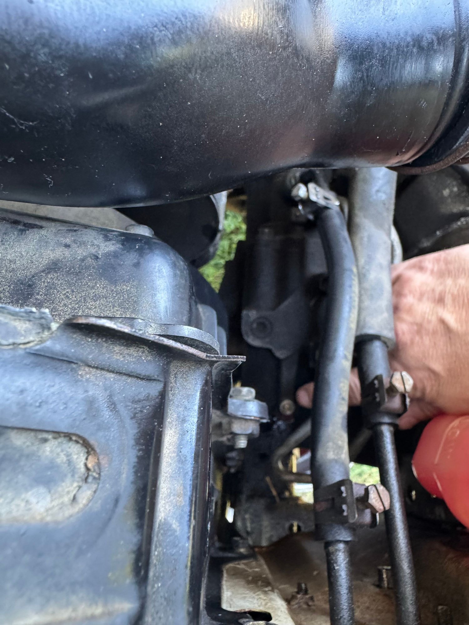

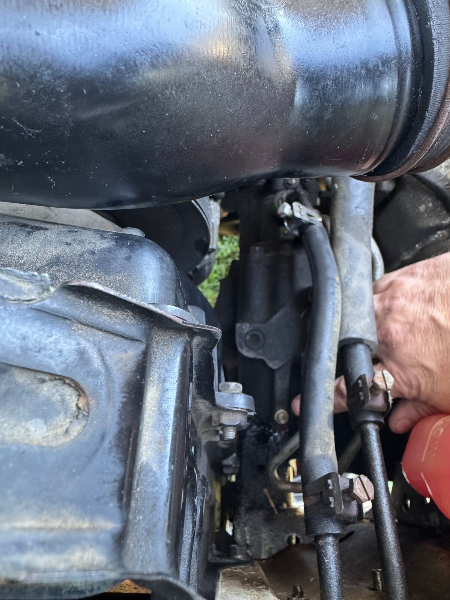

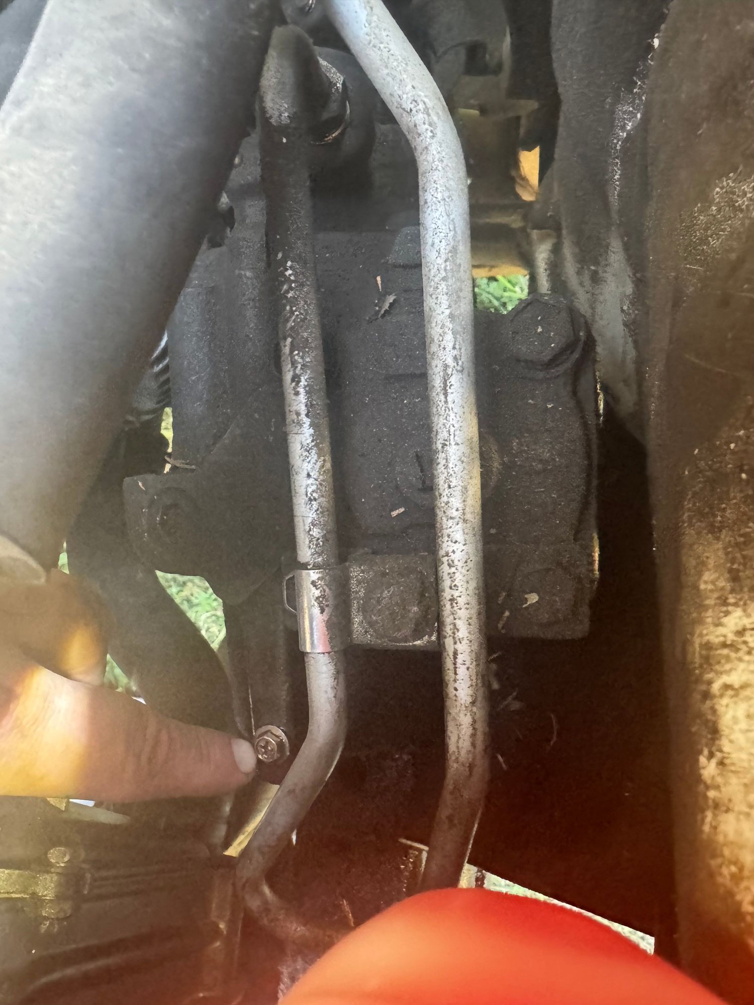

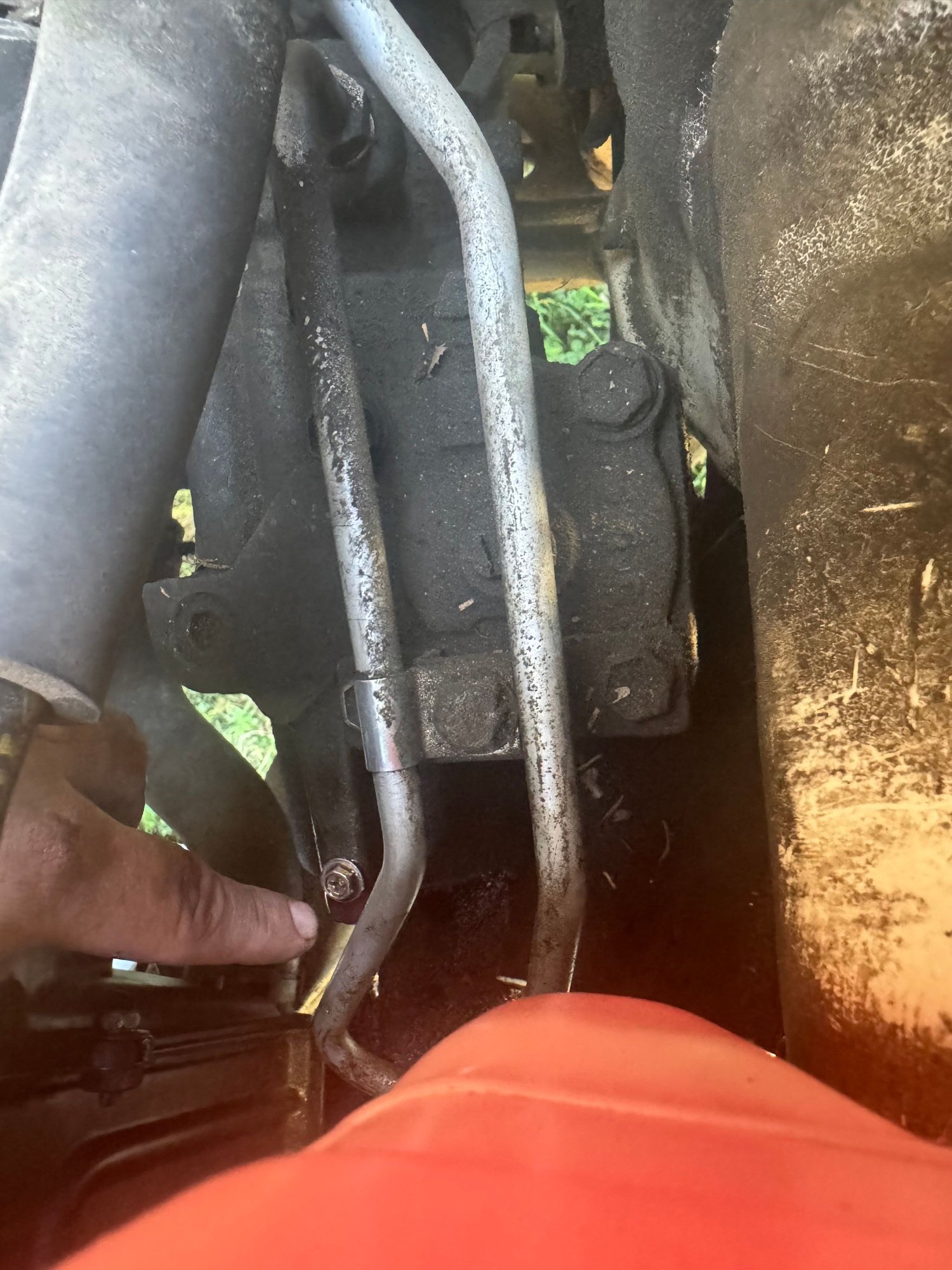

Facing the front of my truck, the steering box is to the right of the radiator, there is a hole on the left side of the steering box on the top. When I put ATF into the reservoir, it just drains out immediately from this hole. I tried puttig a screw into this hold, but it threads down and never tightens. What is this hole? Why is the ATF draining out of this hole?

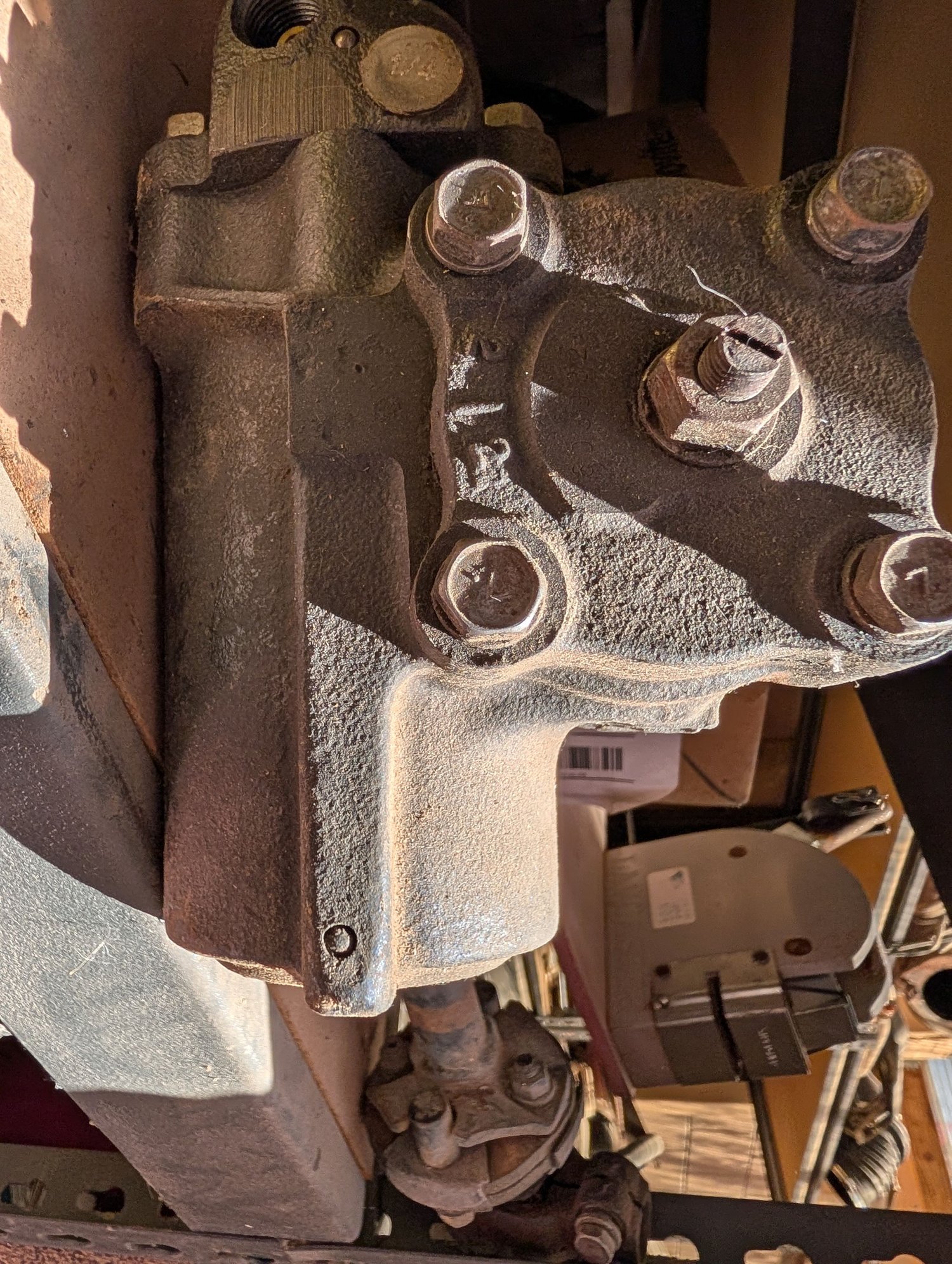

That looks like the ball or plug that was installed in that oil passage after machining blew out. I never saw that happen before. Here's a pic of my early IFS steering box.

There's an oil passage drilled across that rib and then straight down from where the plug should be. IDK how you could fix it. If you tap it for a set screw or something, it has to allow oil to pass.

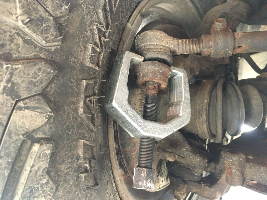

a pitman arm puller works pretty well. i bought one a decade ago, and have used it multiple times. it can sometimes be used to release tie rod ends, depending on configuration.
my puller is a pittsburgh tools version that i purchased at napa. these typically go for about $15 to $20. i literally used it last week to replace the original pitman arm on one of my '87 4runners. worked slick, had the arm changed out in no time.
here it is in use to remove one of the tie rod ends
