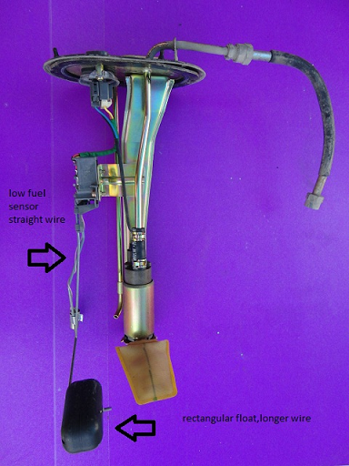

final update here
today i wakeup decided to settle down the fuel sending unit issue in my 98 4runner,well yesterday i was looking some pictures of different fsu and i noticed that the fsu n my 4runner didnt match the one that is intended for the 4runner models.
in my 4runner the low fuel light post goes straight from fsu to the bottom of the tank baffle,in the picture i found it has an horizontal bend in the top then goes straight to the tank baffle another mismatch is the float in my 4runner is rectangular and pointing to the back of the tank in the picture i found is has a square float and the float hanger wire is shorter.
so that means that the PO certainly mess up with the tank and who knows told him that a tacoma fuel pump bracket and related parts were the same.well the fuel pump is ok the fsu meter is ok but the floater ,hanger wire and low fuel light sensor are located different also the fuel pump bracket is longer.
i had to test several times the fitment of the float but i managed to set it up right,bottom part of the float flush whit the top part of the pump filter ,now it moves freely and works right,here are the pictures of the sending units.
Attached Thumbnails quick question about gas level gauge-4runner-correct-fsu-bracket1.png   quick question about gas level gauge-tacoma-fsu-bracket1.png
