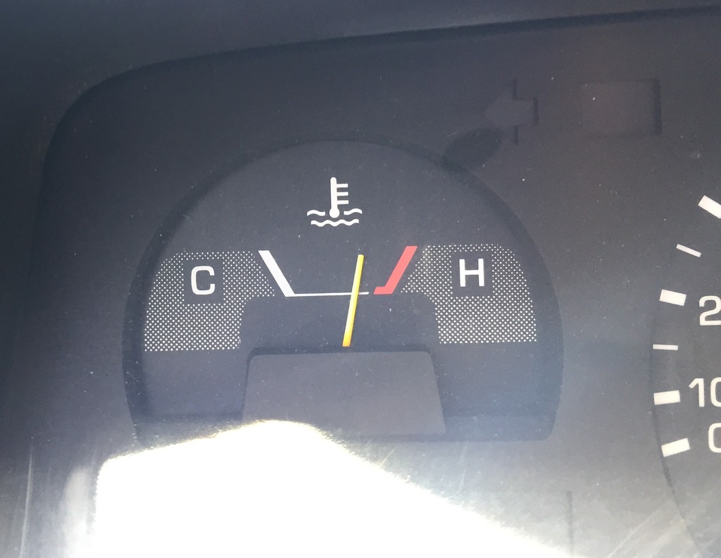

It's about 100 degrees here and I had to pull a small trailer with a golf cart. it was for a 1.5hr drive one way. I ran the air conditioner some, but kept it off most of the way. I checked the water level before I left and it was good.

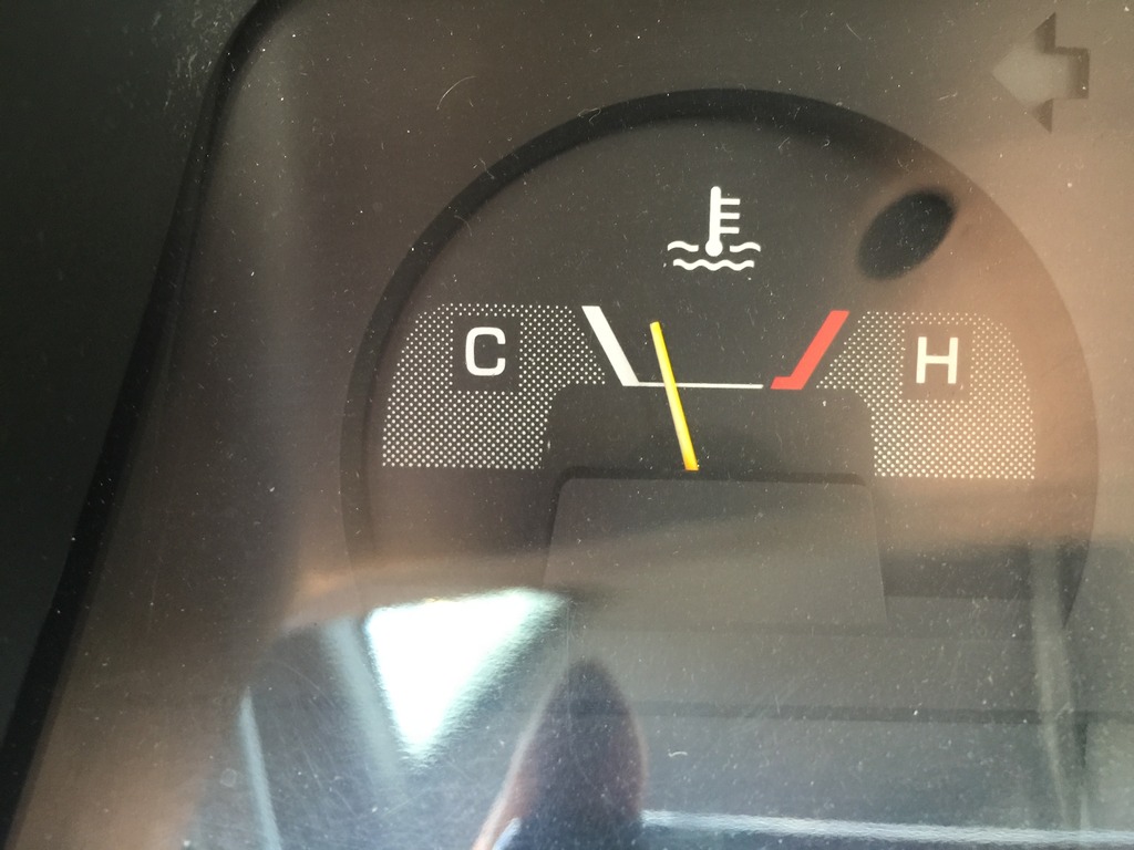

This was the highest it got during the trip, it stayed closer to the middle of the gauge the rest of the way. It never lost power or felt sluggish. When I got home.it did make a noise from the radiator area, and then a very low gurgling sound near the radiator while it was shut off. It was barely audible though. I checked the oil and it looked ok too.
It's an older truck, but I would think it shouldn't be borderline overheating, just pulling a golf cart.

obviously it shouldn't be that high and towing a golf cart shouldn't be too much for the engine. I would start small by checking the radiator cap and see if it needs to be replaced. If its bad and not holding the pressure, it will let the water boil.
I was going to replace the fan clutch, radiator, cap and thermostat. But I'm at a loss with the radiator. No one has one that will fit. There's 2 sizes. 15 3/4 and 16 3/4. Autozone first gave me the 15. The bolt holes didn't line up. I returned it and got the 16. It fit perfectly but this one takes a larger radiator cap. I get it all back together, and the freaking hood won't close. It barely closes without a cap.

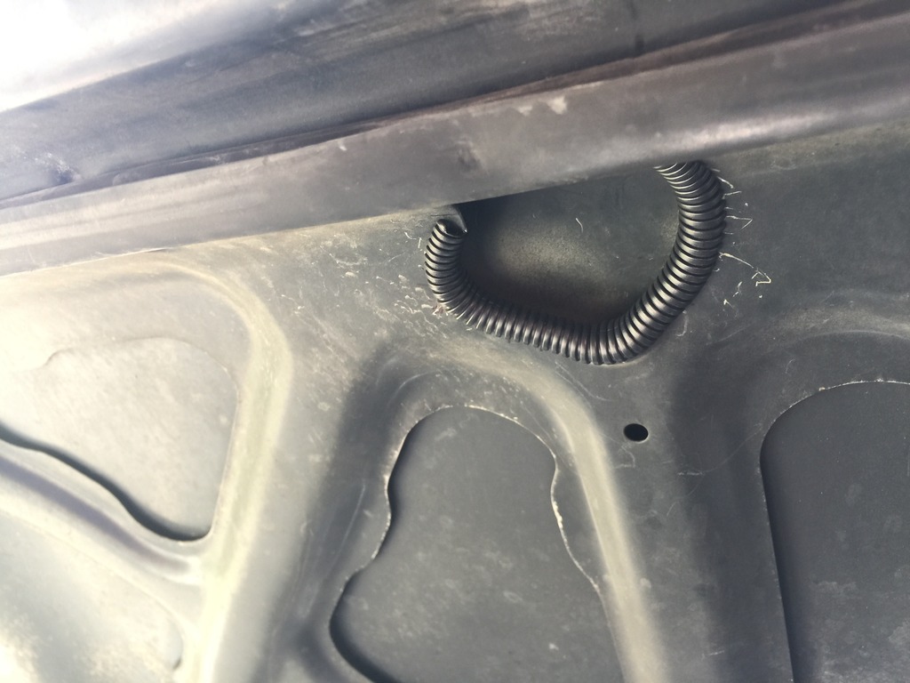

Well I decided to see about having the radiator re rodded. I took The radiator to the radiator shop, a old school place. Tons of radiators everywhere. He didn't even have a computer. He looked up the stuff from a book. Felt like going back in time a little bit.
Anyways, he said it was stopped up by the way it drained out ( he plugged, then filled it). He wouldn't fix it because he said it had calcium build up on it.
I decided to make the new one fit. I was going to try to put spacers to bring it back a little, but I cut a little of the sheet metal from the underside of the hood near the cap. I also got the correct flat cap as well.
That got it closing. It may partly be my fault because I was expecting it to close easier than it does. I guess I never paid attention to just how much force it takes to close the hood.

It wasn't bad. I only did it because it's an area that will never really be seen. I cleaned it up and put wire loom around it.
I think it fixed the problem though. It's 90 degrees, so I pulled the emty trailer 25 miles at 60-65mph with the ac on high. It never went much past the cold mark.
