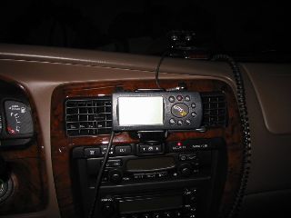

I wanted to mount my GPS V and the Mod in the Tech section seemed too much work. I decided to mount it in the digital clock opening. I took off the circular disc on the mount, and used it as a template...I drilled two 1/8" holes through the disc and two smaller pilot holes (very small drill bit, just to allow screws to go in without eating up material) into the opening ( see Pic 2). I was careful not to drill too deep so as to not hit wires or the rear-window switch. I also use the shortest possible screws (1/2" - 3/4"). I mounted it so that it was far enough away so I could still use the vents and the hazard switch.
You get a better signal using an external antenna for this mod but you should still get a decent signal with the stock antenna (externals are 15-19 bucks on E-Bay.) I got accuracy of 8' with external, 21' with stock antenna (also had better lock with external).
For the faint of heart, double sided tape could be used for mounting, but this is a more solid method (and the holes were very small). I like the fact it is off the dash, and near the factory spot for the navigation unit. Pic 1 shows the unit in place. It is easy to unmount, and the disc is not very obtrusive. The clock cannot be seen when it is in place, but the GPS V has a hyper accurate clock display, so there is no loss.
If anyone else tries this, let me know. It works for me, and it is also less obvious to would be thieves if you don't want to unmount it.

Here is Pic 2 of the disc mount.

Plamar,
Very creative what you did re GPS mount. I bought the original Garmin GPS Streetpilot from a guy on ODW. So far I like it but I can't really get closer than 200ft. I believe that is as close as I can get---I really have not had the time to read the manuals and play w/ the software. Ok, sorry to digress...
I finally found a use for my useless cupholder (I have a 98). I used double-sided velcro tape on both the back of my GPS and my cupholder and mounted it there. Like most of my mods, I like to design them to look OEM and easily attached/removed. Its not very stable as it bounces up and down, but not to the point where its unreadable. On rough roads, it'll bounce alot but all I have to do is to put a finger on it and its stable. Does your mount shake/bounce alot?
Also, I bought a powercord from an ebay seller named "gpsgeek". I hardwired that to my aux fuse box. I then drilled a hole into the side of the radio panel. The great thing about it is that there is enough cord to retract into the radio panel and to reach the GPS.

Plamar,
Thanks for posting your mod. It gave me an idea that had not occurred to me before of how I might solve a problem I have with an LCD screen I use on my GPS/PC setup. I'll have to see if it will work.
Alan

Bob...sweet idea..of course I have no cup holders there. I bought my antenna from gpsgeek, and also a power/data cable for the PC. No, mine does not move at all (well, if the whole truck moves, it moves) since it is really screwed down. And your power cable rocks! I might have to think of that for mine.
Alan....my pleasure...this board has been so helpful to me in the brief time I have been here, I thought I would share a tip I tried. I am now going to try and think up something to perhaps raise the unit up just a tad to be more in my line of sight, but not too high that it might as well just be on the dash...but this is a fine place for now.
