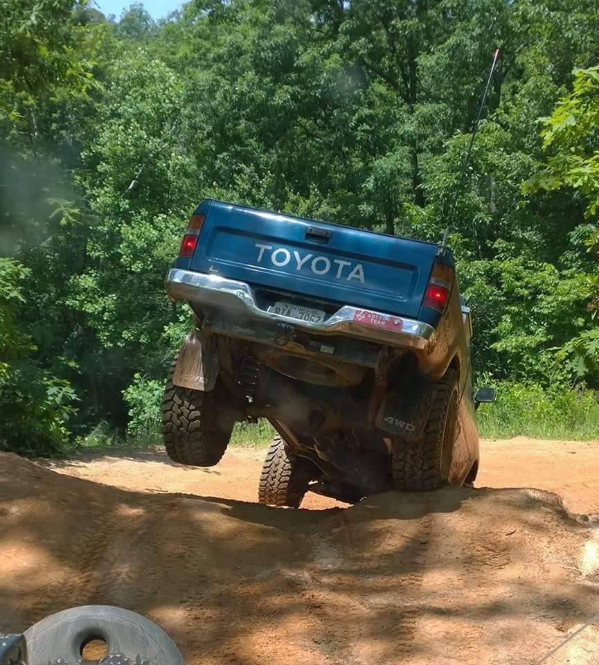

i got pretty squirrely this weekend and I'm rocking an 86 4Runner with original rear leafs and the zuk mod. I have a video up on my build thread that shows its performance. I was pretty happy.
