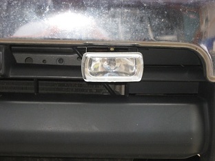

I don't know if this helps but I mounted mine to the existing holes in the bumper. I'm sure they would work better if they were mounted lower but this beats the stock headlights any day.
