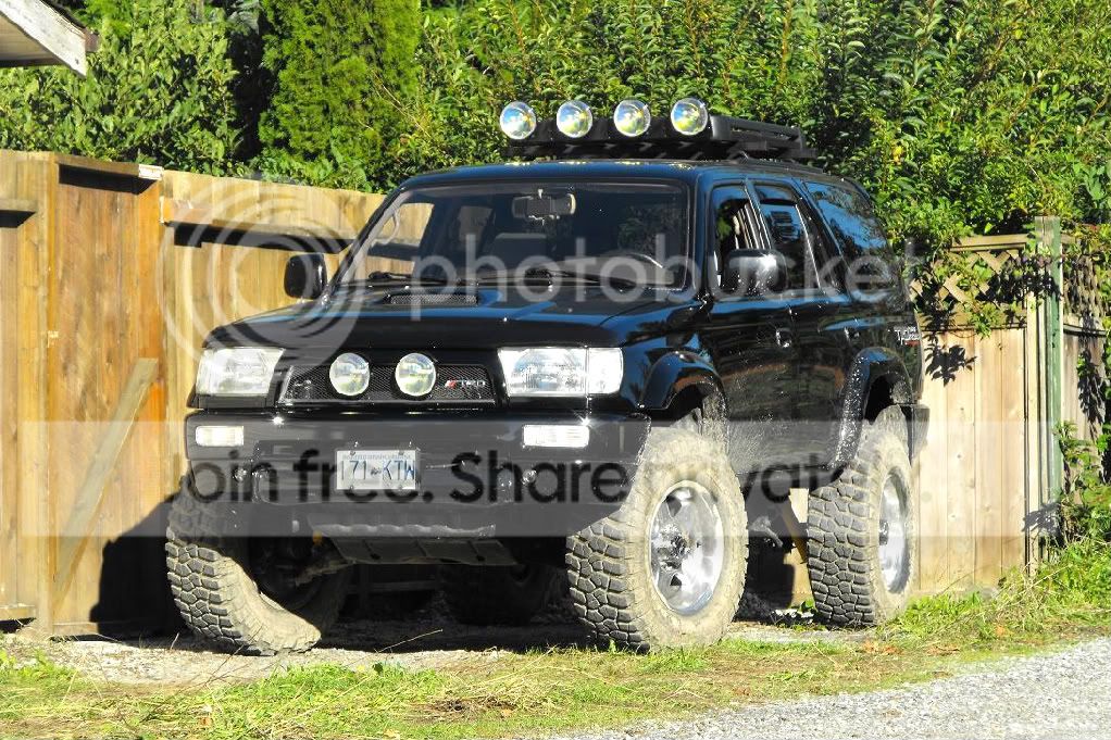

Oh and in addition to the lower valance Hella's I have, a pair of 520's are now situated on the grill..need I mention another 4 on the roof?

The grille was origin'lly a Satoshi Mod grille...and I really really wanted to make use of the 520's so with a bit of improvisation I came up with what you're seeing. I like the way it turned out.
Griff
