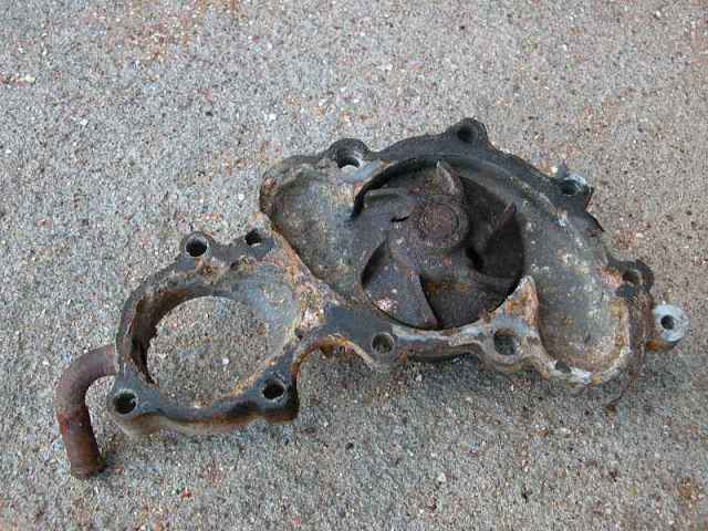

See what happens if you use pure water in your rig and also what happens when you forget to fasten the bolts. I could almost twist them loose with my fingers.
My rig stems from '93 and probably was cooled most of that period with water. Believe it or not, until the headgasket developed a leak the engine held its water for quite a reasonable time; it wasn't pooring from the seams as you might expect. After dismounting the pump body disintegrated when someone touched it not really all that hard.
Ava.

Actually..... as long as you use clean water, you will have no problems. Distilled water with a little bit of Water Wetter will give you better cooling than a 50/50 mix of water/coolant. Coolant really is more of an anti-freeze than a coolant. If you look at race cars, they use straight water. Water is still one of the best liquid heat transfers. The person that put the water in yours must have used some water that was high in minerals. That would definately kill a water pump.

That's what I always thought. My central heating system used pure water, was made of thin steel and never developed a leak. But if you see the damage the 'coolant' has done on this engine. Two heads needed welding in about 15 places, the aluminum adaptor between the camshafts, the pump, the intake manifold around the square water openings, on the trottle body one aluminum plug underneath was totally consumed, the steel tubing from the pump to the heater had the beginning of a hole, a water channel at de #6 cilinder needed welding (no meat to hold the gasket), some of the steel tubing has eroded quite a bit where rubber hoses have covered them.
I wonder if they used battery acid in this engine? Or is there a (inferior) type of coolant the does thise to metal?

Forgot this, but straight water boils at a lower temperature than water/anti-freeze. This means that under heavy load the cooling fluid isn't squeezed out as easily as pure water would be.

I'm not so sure I'd trust pure water either because of the variety of metals used in Toy engines.
Iron + Water = Hydrogen gas + Iron Hydroxide (Rust)
Aluminum + Water + Heat = Hydrogen gas + Aluminum Hydroxide

I'm not sure if this is an issue where you live in South America, but if you keep pure water in there during the winter it will freeze and either pop the freeze plugs or crack the block since water expands when it freezes.
In addition to killing water pumps, normal tap water, river water, well water, etc. will leave all kinds of deposits in your radiator and heater core, (made of copper or brass on most cases) eventually cloging them and it will kill your whole cooling system.
Use 50% purified, distilled and/or de-ionized water and 50% anti-freeze. Water wetter is fine but by no means is it necessary.
