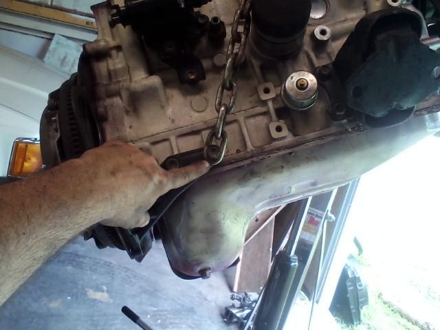

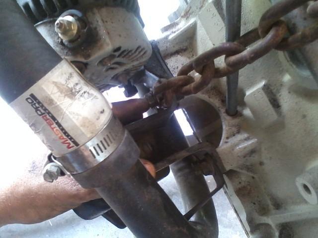

Old Aug 24, 2015 | 02:17 PM
Terrys87's Avatar
Posts: 11,787
Likes: 28
From: Anderson Missouri
You are missing the factory lift points on the drivers rear and passenger front side. If you have a boneyard locally they bolt on quick.
Here is how I lift a headless motor. Not showing in the picture, but I actually have my chain painted for the center of gravity and I also run a long bolt and nut thru a chain link on each side of my engine hoist hook. I posted this picture for some one else just to give them an idea for a headless motor. I don't care to put any strain on the head or aluminum parts. You may need to use some longer bolts for the lifting points.
I suggest using the transmission bracket for the rear.
A motor mount bolt for the front.

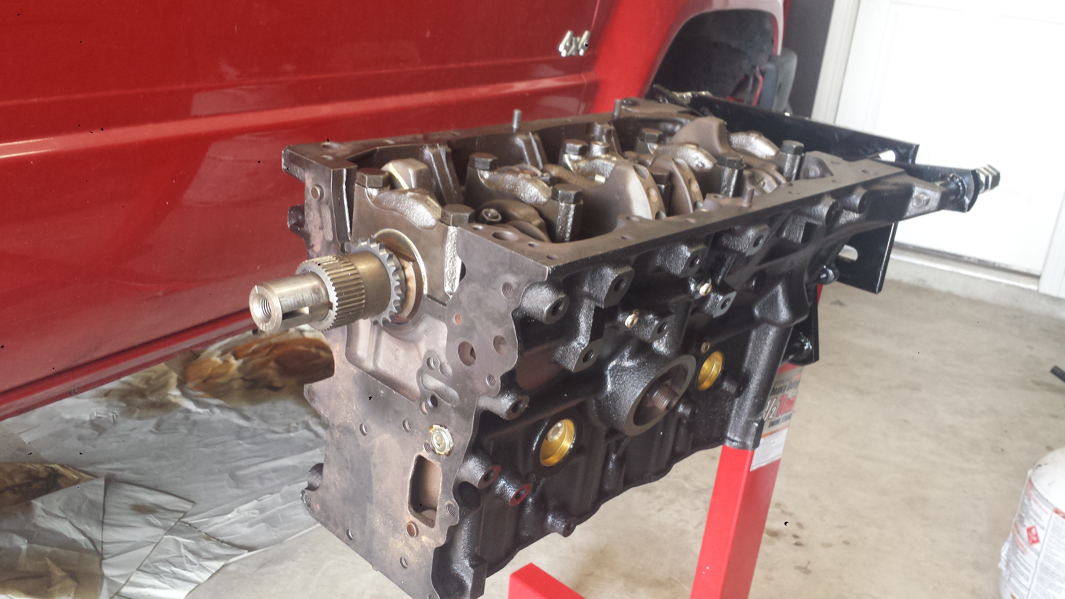

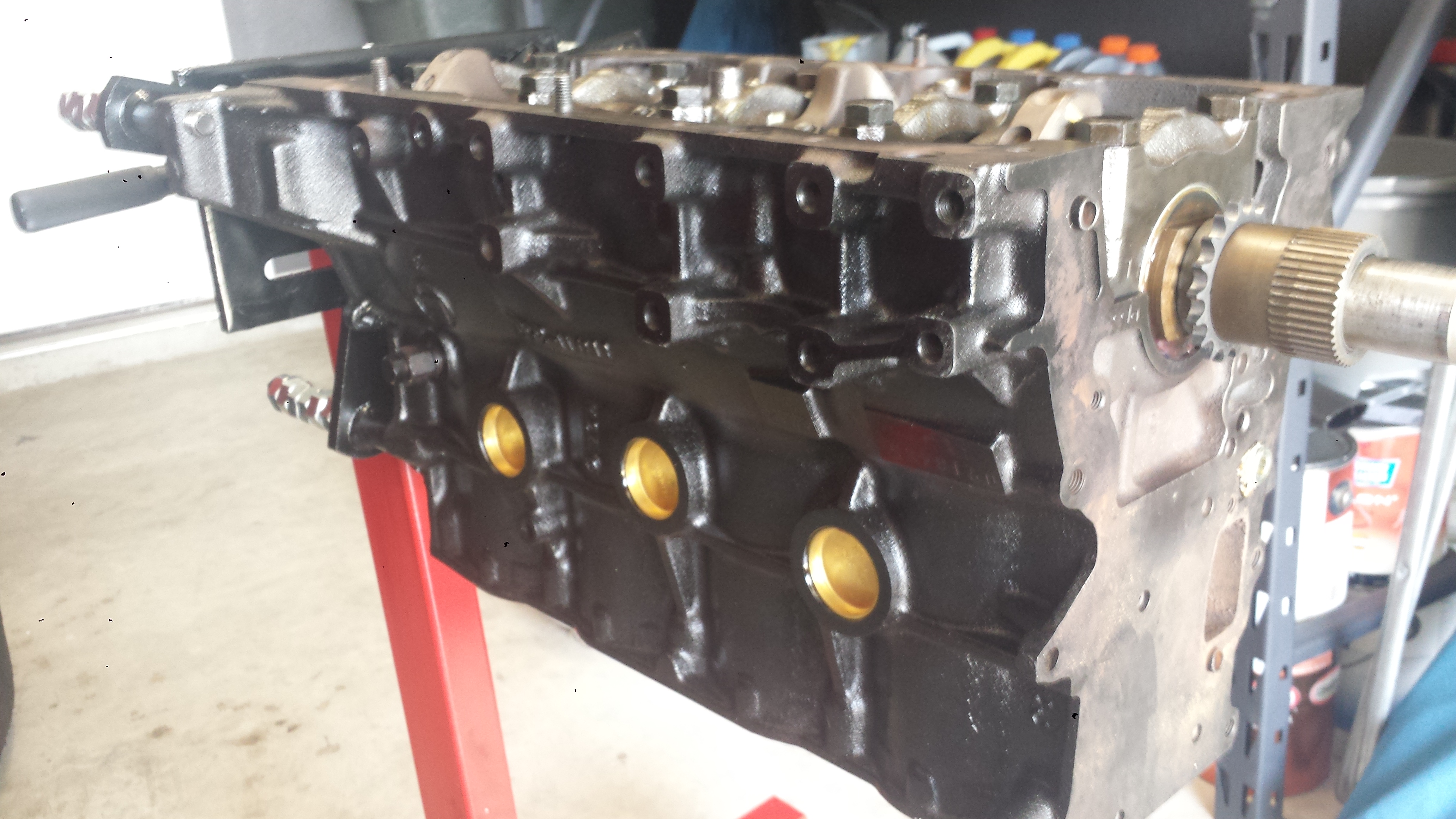

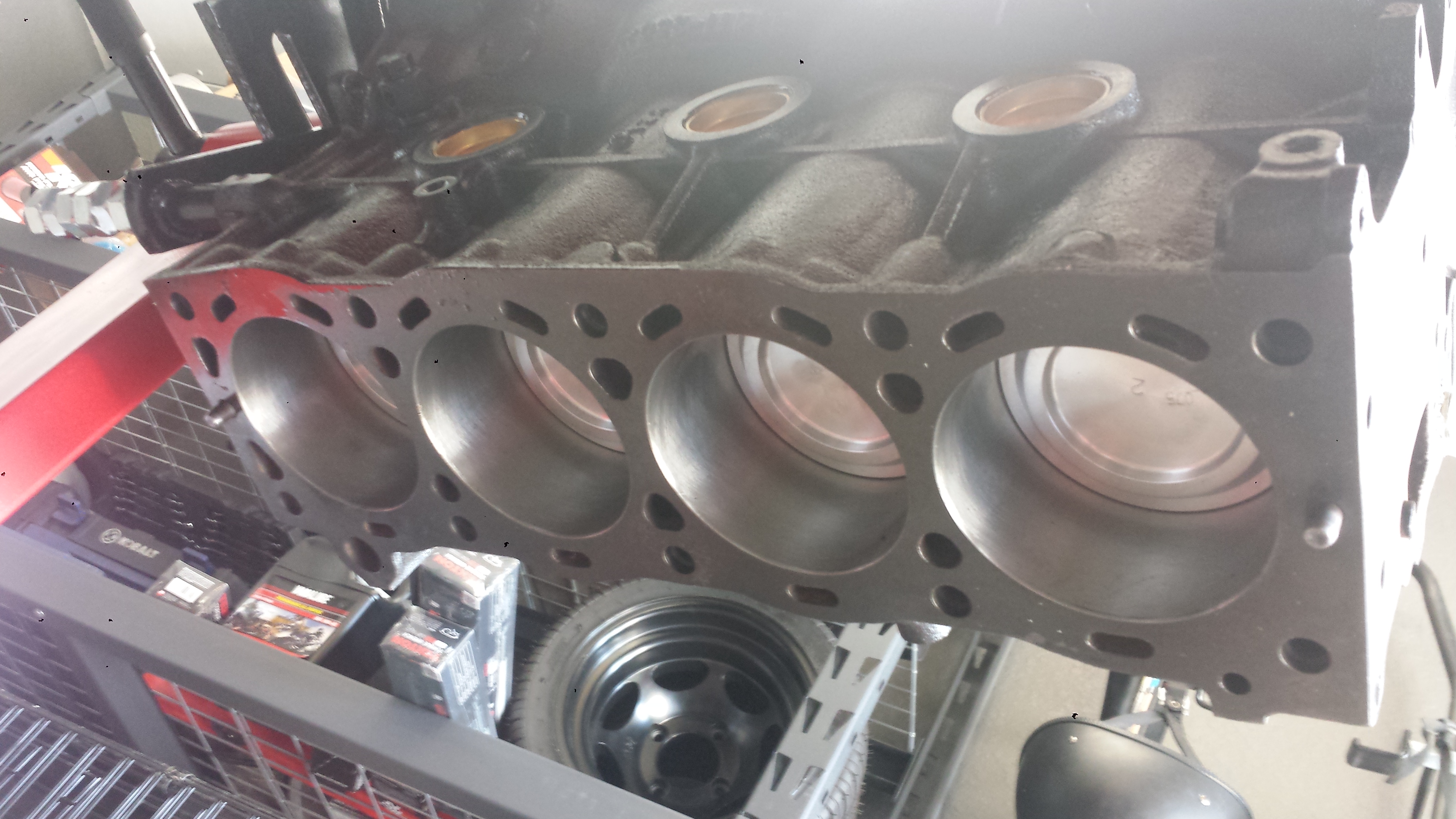

Hey Terry, sorry I never got back to this thread, life kind of got in the way. However, that method you showed is awesome and would have worked out much better than how I ended up doing it. I used some tow straps and ran them through the motor mounts and attached them to my engine leveler. All in all, it worked, but it caused a major headache because it made the lift assembly too tall and wouldn't clear the front... I had to hop in the engine compartment and lift it over the last little bit.
I have some pictures that I'll put up to show the ridiculousness. This was my first one-man-show engine pull and install, its crazy how having an extra hand around is so valuable at times.....sucks not having friends.
