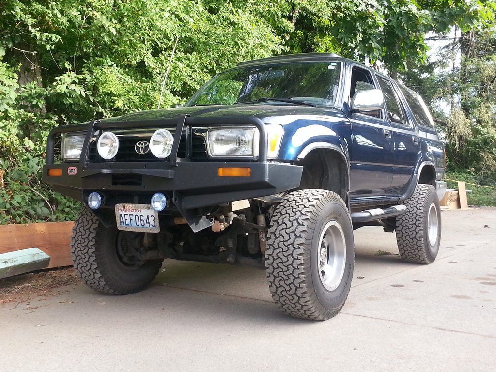

I've got a nice '94 4Runner that's pushing 325,000 miles and have been saving up to buy a new engine and today I came across an old 80's turbo diesel Benz for sale w 125,000 miles for $1200. It starts right away, runs and drives great, it's about 1/2 of what I was going to spend on a new V6 and i'm wondering what is involved in swapping it over to the Benz engine.
This is my DD and I don't have a ton of spare time to take on a lengthy project... my budget is not an issue (within reason) so I can buy the things I need to put it back together quickly but I don't have a ton of time for my rig to be down while i'm trying to work full time and tackle this project.
I've upgraded or replaced just about everything on this one except the engine and drivetrain and it's still in great shape for being 21 yrs. old, so it's worth it to me to dump more a little more money into it and hopefully see it turn 500,000 in my lifetime.
Just a side note... this isn't a housewifes' suburban assault vehicle... not a soccer mom's kid cab... not a pavement pounder... this bitch goes places and bakes cookies... it's been all over the west coast... 4 wheels fairly regularly (grampa wheeled anyway), it's been on it's side... been axle deep in mud... crossed a couple of rivers... etc.. I use this thing and use it well.
