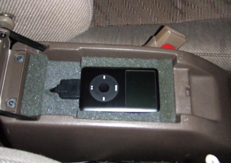

Alpine IVA-W505 HU/ MB Quart Components Powered by 2 Channel Alpine V12/ Alpine Type X-12in Sub in Custom made box, powered by V12 Mono Amp/5 Farad Cap/ Custom IPod Armrest bed (he he he)

^^^Sick. That might be my favorite system in this thread.

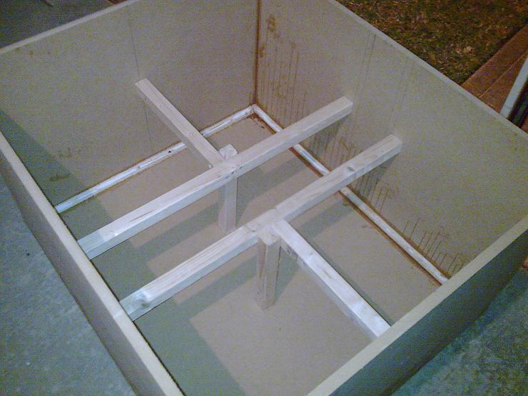

Does this look like enough bracing??
Attachment 73079
The ones that arent connected in the middle arent doing anything. But its more bracing than I have lol.
Attachment 73079
That's a big sub box! Is the box 12 cubes after displacement? That does looks good, tho.
Oh the 2 longest ones?? They are connected to the 2 that tie into the base (the ones standing straight up) Also, I'm going to tie it into the port (the port is going to fit snug between both braces!) Port will be 30 inches by 4 inches by 12 inches... 33 hertz!! I'm debating on having the first layer inside the box or just have both layers on top of box...

[quote=4rx;51091104]That's a big sub box! Is the box 12 cubes after displacement? That does looks good, tho.
Chea, It is actually 14 cubes LOL!! I sorta miscalculated!! Or, I can Make it less, but like I said I'm debating on having first layer inside box or having both glued and on top of box... I just don't know... If I do, I think it should be better am I correct?? Then I will have 3.5 cubic per sub!!
