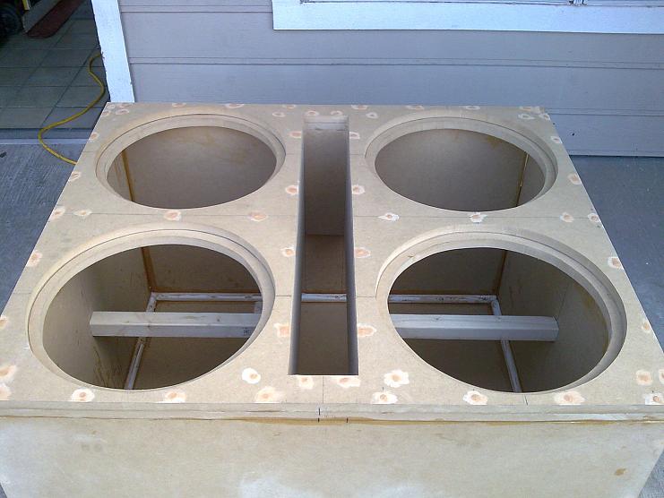

Chea, It is actually 14 cubes LOL!! I sorta miscalculated!! Or, I can Make it less, but like I said I'm debating on having first layer inside box or having both glued and on top of box... I just don't know... If I do, I think it should be better am I correct?? Then I will have 3.5 cubic per sub!!
Double layers on top of the box will be better. According to my winisd program, 12" port length is good. You're doing it the right way

Thanks.... Now the hard part of making the holes and port hole Here is a sorta dumb question, but never made a baffle top before... Am I suppose to glue the 2 together and then cut holes??? Just wondering if glue will mess up cut...
The glue will not mess up cuts. You should get some 1 1/4" screws and do predrill on both layers then put glue on it. That's what I did to my back wall in my 4runner.
like this..
just give you some ideas..

Here it is besides a 5 gallon paint bucket!!! LOL Still need to screw and glue the top down and either carpet or vynil it... Might have to make the RF logo and have it on the front and back of box...

Hey there are some empty holes in that box!

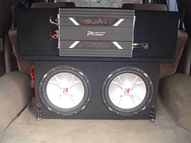

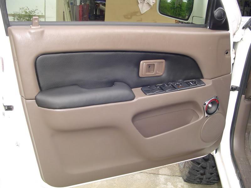

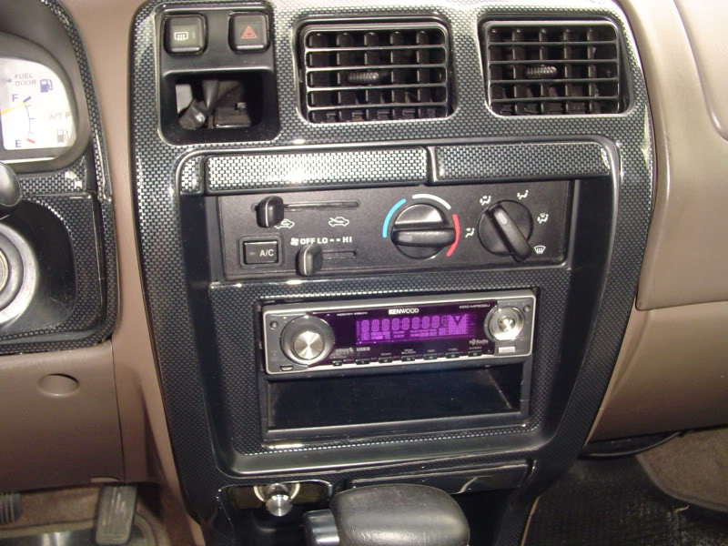

kenwood head unit, 2 kicker cvr 12's, power acoustiks 2channel amp 540rms each channell, 2 bullett tweeters, 3 emenince 8's, 2 kicker 6's, 4 channel sony amp

Chea... I need another amp.. The other 2 are still in my 4runner now... Just got through screwing and gluing the top down and debating on Vinyl or carpet...
Here's another pic...
