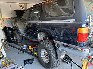

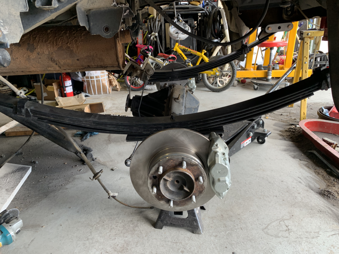

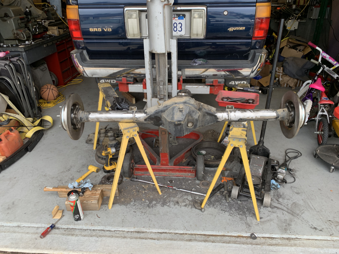

Been away a while I guess. I have still been working on it though. I pulled the rear axle cut off all of the brackets with my new plasma cutter and then all of the frame parts that needed to go. I decided to go with rear disks after the ebrake cables are going to be too short. I'm also putting in a line lock to take its place. I rebuilt Chevy leaf springs off a Tahoe and got the ruff stuff swap kit. Probably another day of work and will have it all back together.

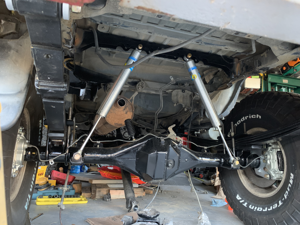

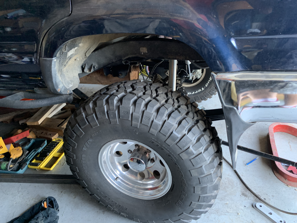

I've finally gotten back around to finishing this project. Ordered drive shafts this week, put the gas tank back in and bled the brakes. The rear is all done I just need to move my steering box forward to be able to drive again.

Old Aug 14, 2019 | 07:16 AM
  #191
Gevo's Avatar
Joined: Sep 2013
Posts: 1,631
Likes: 110
Progress!!! Always feels good to get back into it and make some progress
I have a question related to your rear suspension setup, I may have missed it earlier in your thread, was it purchased as a kit or are you fabricating it? Also, I want to change the shock setup on my nearly stock rear end, but I have springs. I found my shocks limiting travel by atleast 2 inches in both limits. Ofcourse this will also damage shocks.. but more importantly I feel like the stock spring and link system could give me a lot more articulation if I just change the shock layout.
So, what you (or anyone else reading) think about fabricating new shock mounts similar to what you have now but on stock linkage and springs?
Old Aug 14, 2019 | 11:40 AM
  #192
Yotard's Avatar
Joined: Apr 2011
Posts: 457
Likes: 9
From: CA
The link arms especially the upper link arms on the stock coil spring 4 link is the primary limiting factor. Also, You want the lower link to be parallel to the ground as much as possible so the would mean dropping the mounting point lower which ends up hanging up on things off-road. You need longer links and to do that you could go three link with a torque arm and panhard bar. You can't stay four link without moving the gas tank. Either way coil overs and the link kits will cost you some money. The money is what made me go leaf spring swap. I bought the 63" Chevy simple swap kit from ruff stuff, 12" bilsteins that I traded for and leaf spring off a 97 Tahoe from a junkyard that I put an add a leaf on and repainted. I probably have $500.00 in this spring swap and have tons of travel now.

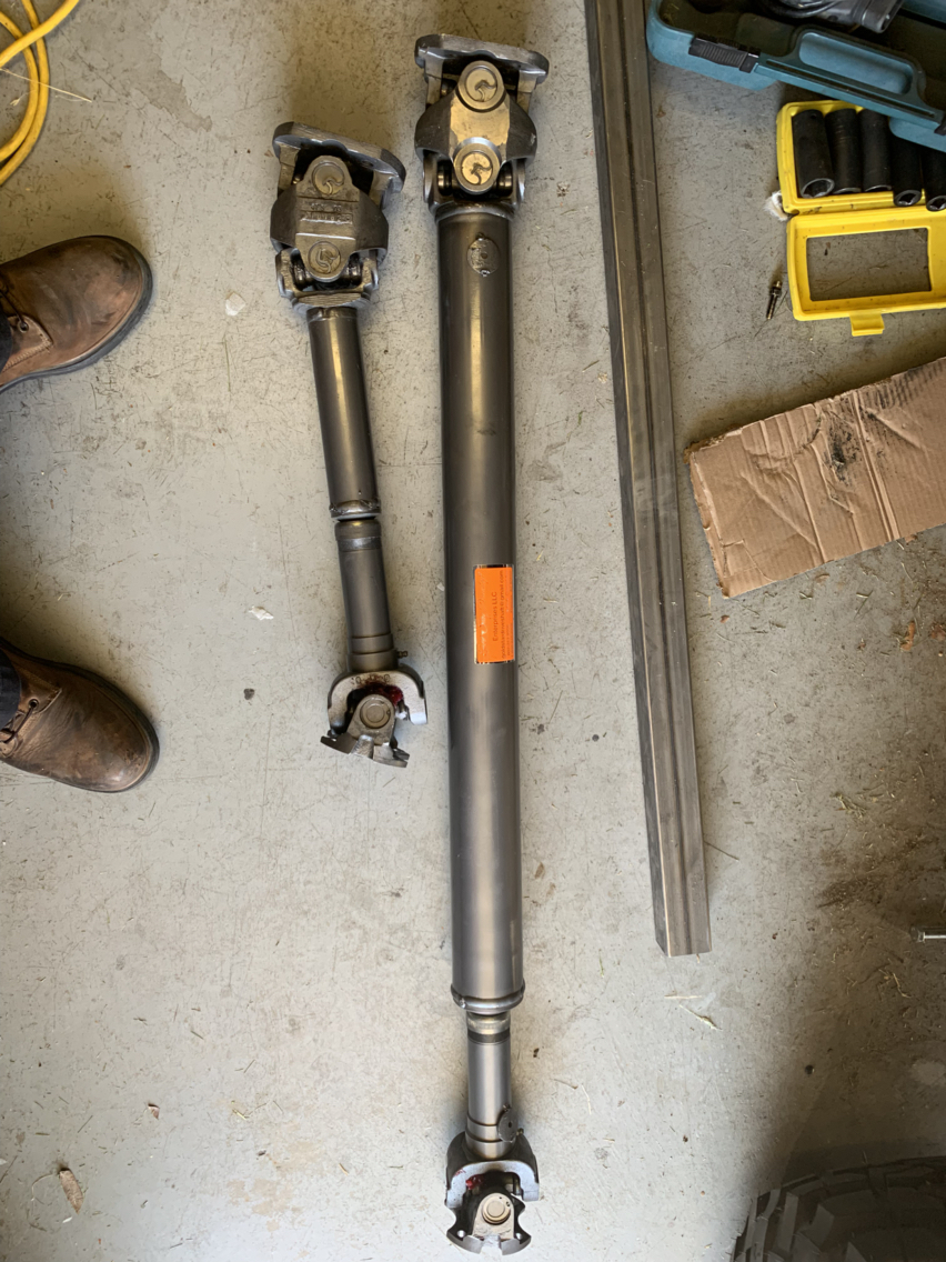

Yes! Beefcake drive shafts showed up today. I pulled the radiator and unbolted the steering box. Tomorrow I will drill the holes and mount it up in the new position and weld it all back up.

Here is a link to the video I made of the issues I had with the trail gear economy disk brake conversion kit. Trail gear was pretty unresponsive about the issues. I fixed them for myself, but that's because I didn't want to wait for their solution. At first they told me it is supposed to be like that. Imagine trying to mount a 35" tire to it with the rotor moving all over the place.
