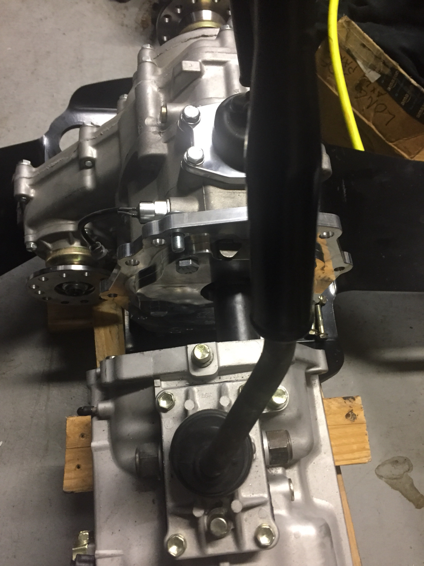

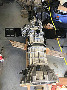

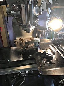

Machined the dual case crossmember so that I can change the oil on the single case that I am running. Mocked up the transfer case to the transmission to make sure everything fits before installing tomorrow.

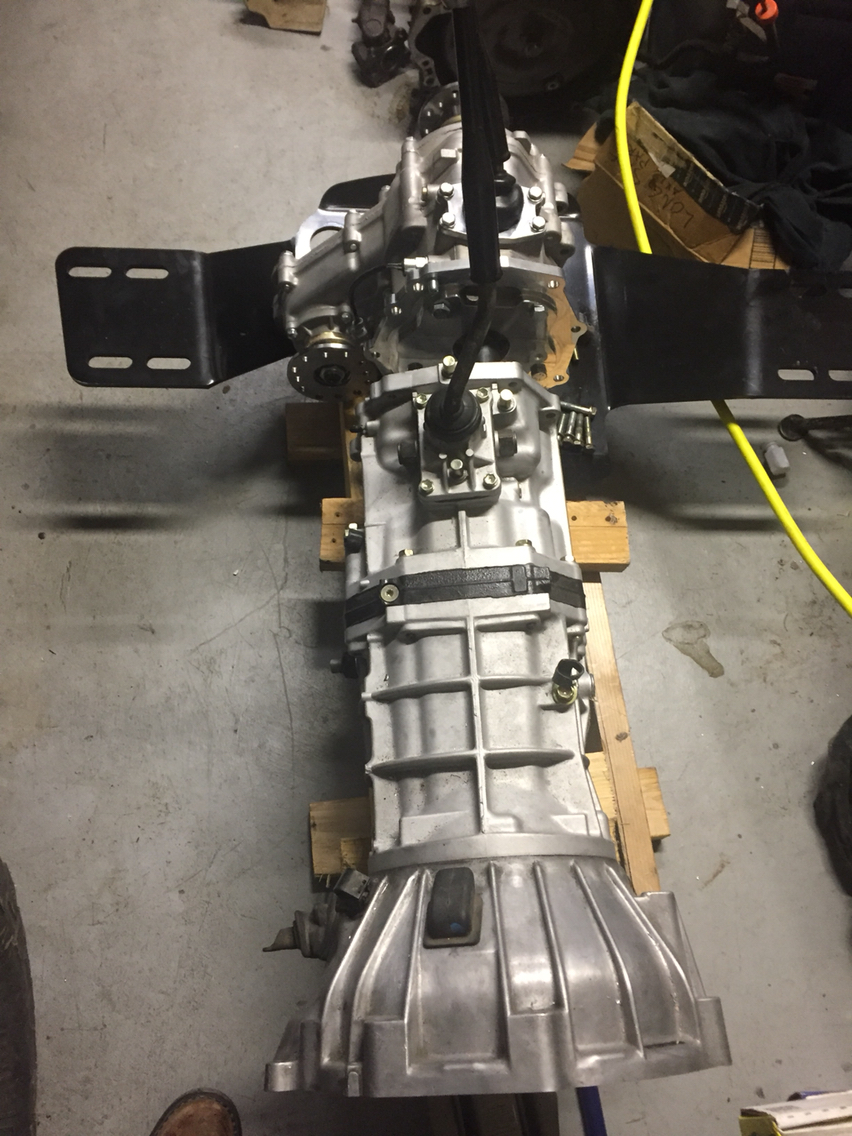

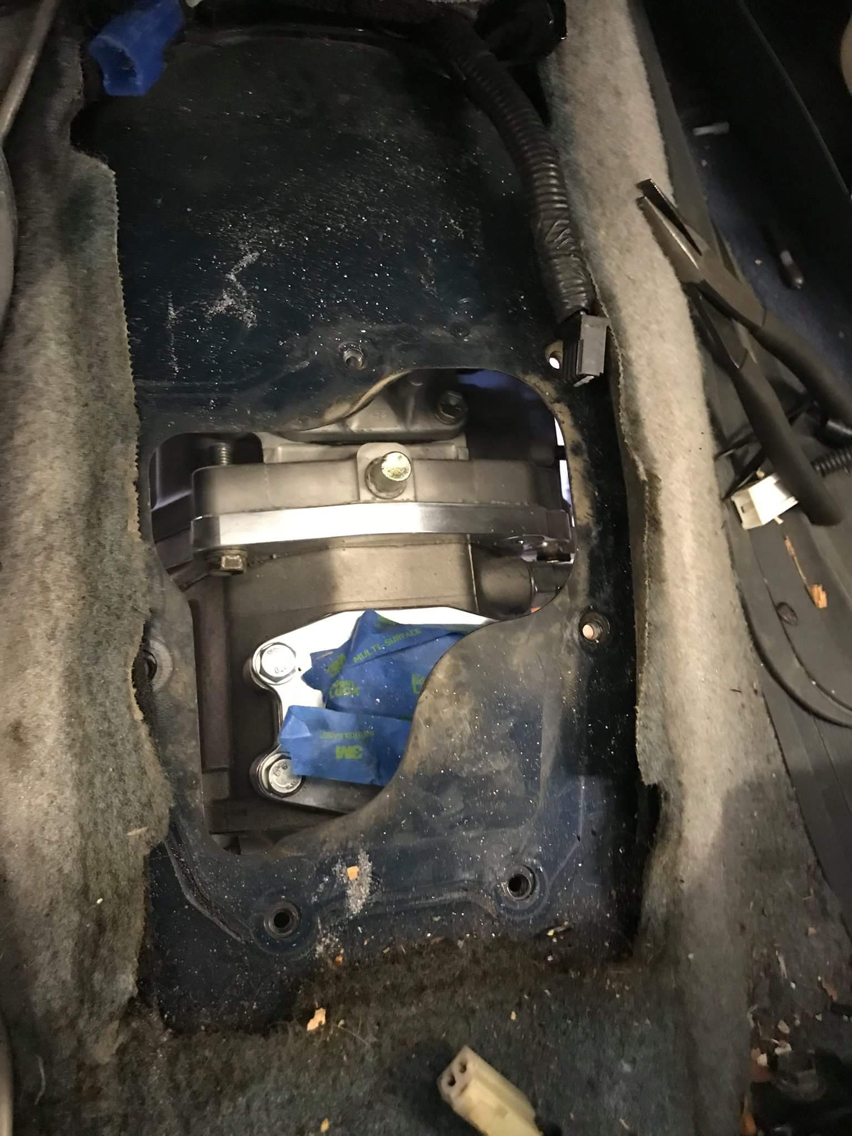

I got the 4.7:1 low range tcase bolted to the transmission and the crossmember. I put it up in the truck and can see where to cut the floor for the shift levers

sweet 2nd gen 4R . I have a 90 . with 4.7 crawl gears . 1 thing I would suggest is to check out the twinstick tcase shifter . before you get it buttoned up . even with a selectable up front its nice to be in 2wd low especially if you run an auto locker ,much easier to drive around steering wise with it in 2wd with hubs locked with no input power the locker just ratchets then pop it in 4wd when you need it . I just have the lunchbox locker in both ends of that one ,and it does great for an ifs front . and 1 more thing to think about for the solid axle is the shackle bushing are a very very high wear item . the OME parts are supposed to be a longer lasting solution . I just got some to try out in my 86 sas 4r .

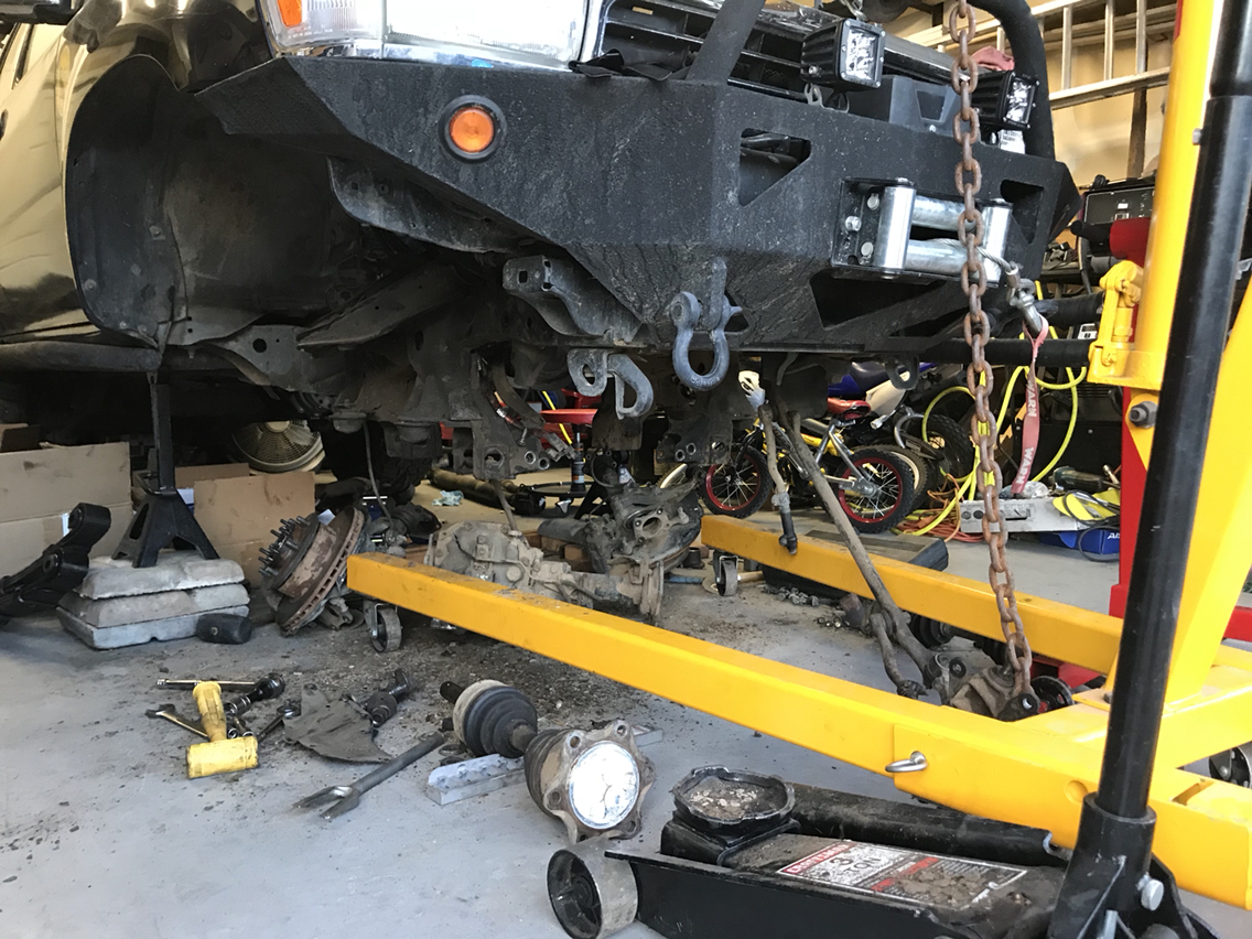

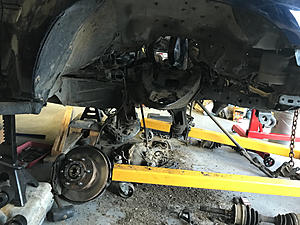

Unbolted most of the ifs just have to get the torsion bars out and then start torching. The bilsteins showed up today and the rest of the swap kit shows up tomorrow! I'm going to have fun this weekend!

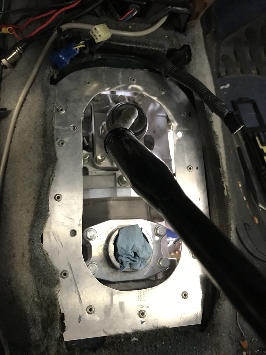

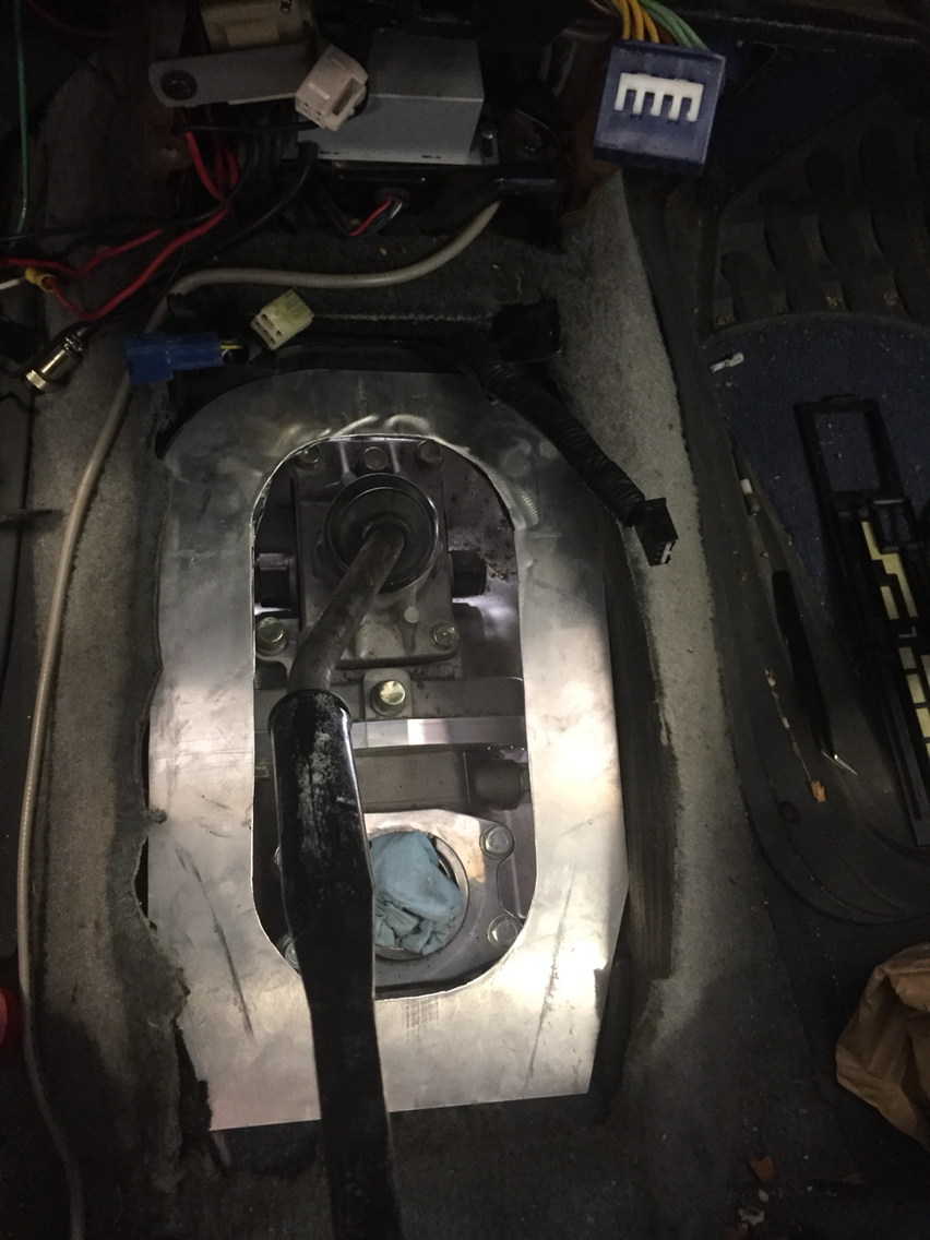

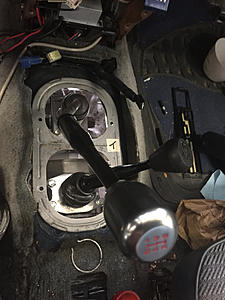

Got a little interior work done on the floor this morning before going over to the family for thanksgiving.

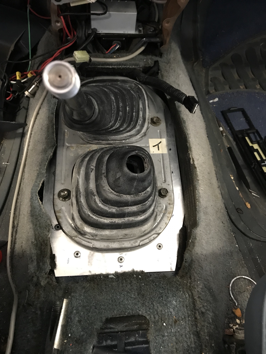

Finished the floor and started cutting off all of the IFS brackets.

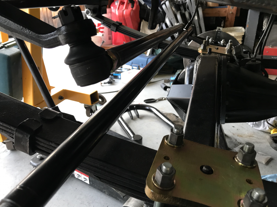

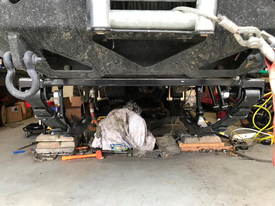

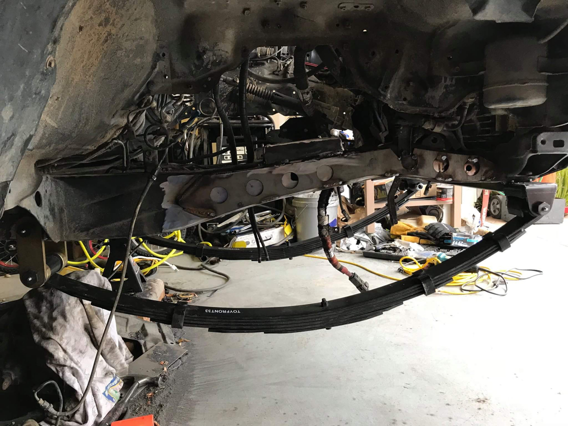

Finally got the springs hung yesterday.

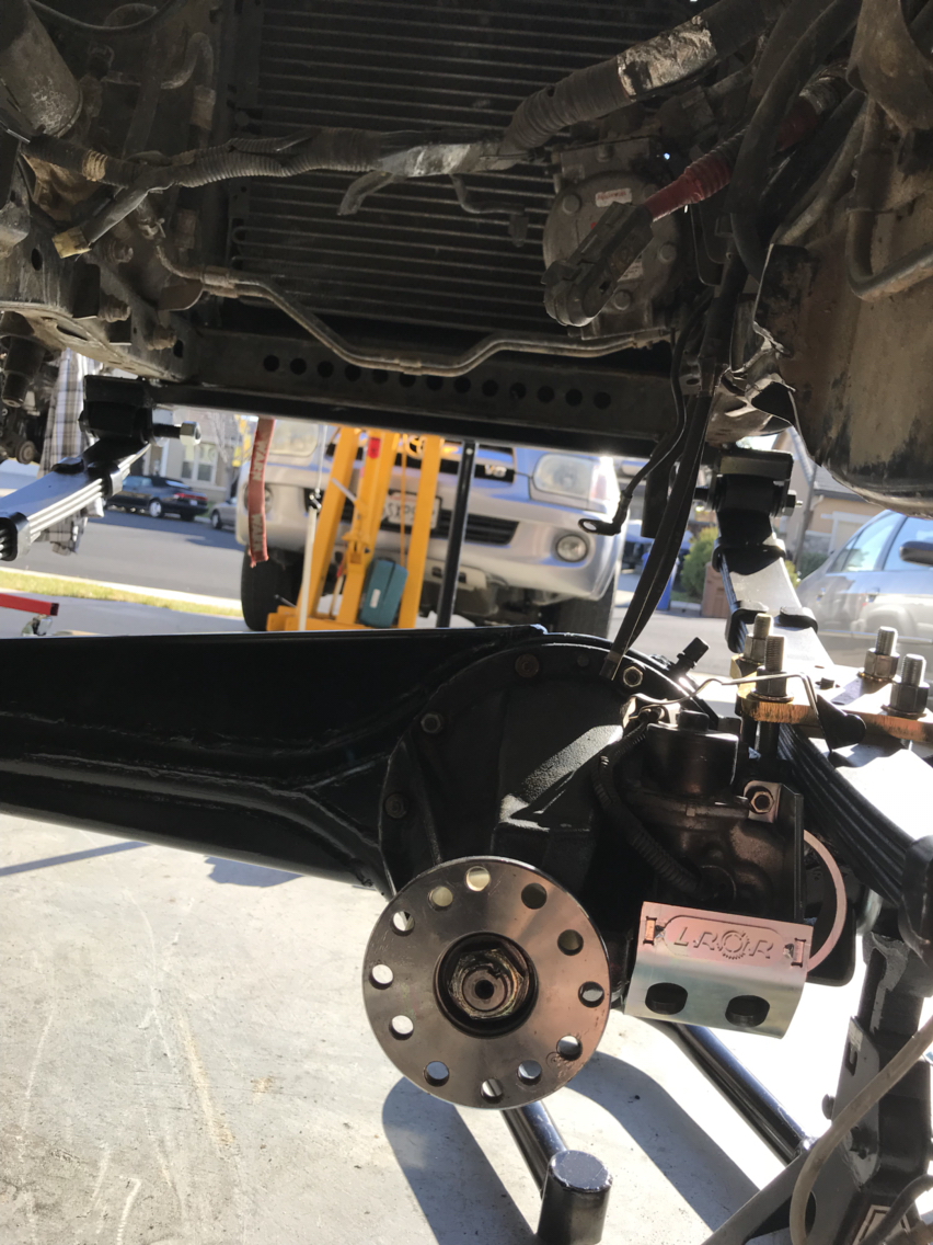

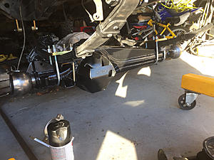

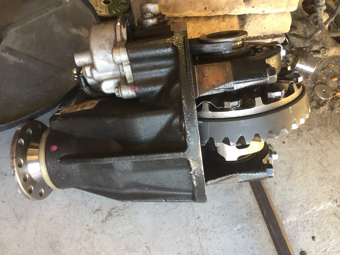

Well I ended up with a piece of steel in my eye from grinding. Doctor got it out and I'm back to building. Axle housing is in place and diff is wired and working and I modified the casting to fit the leaf springs.

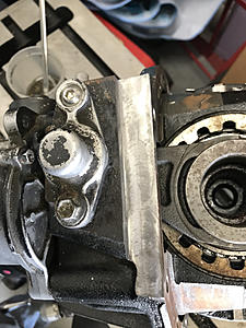

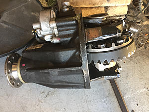

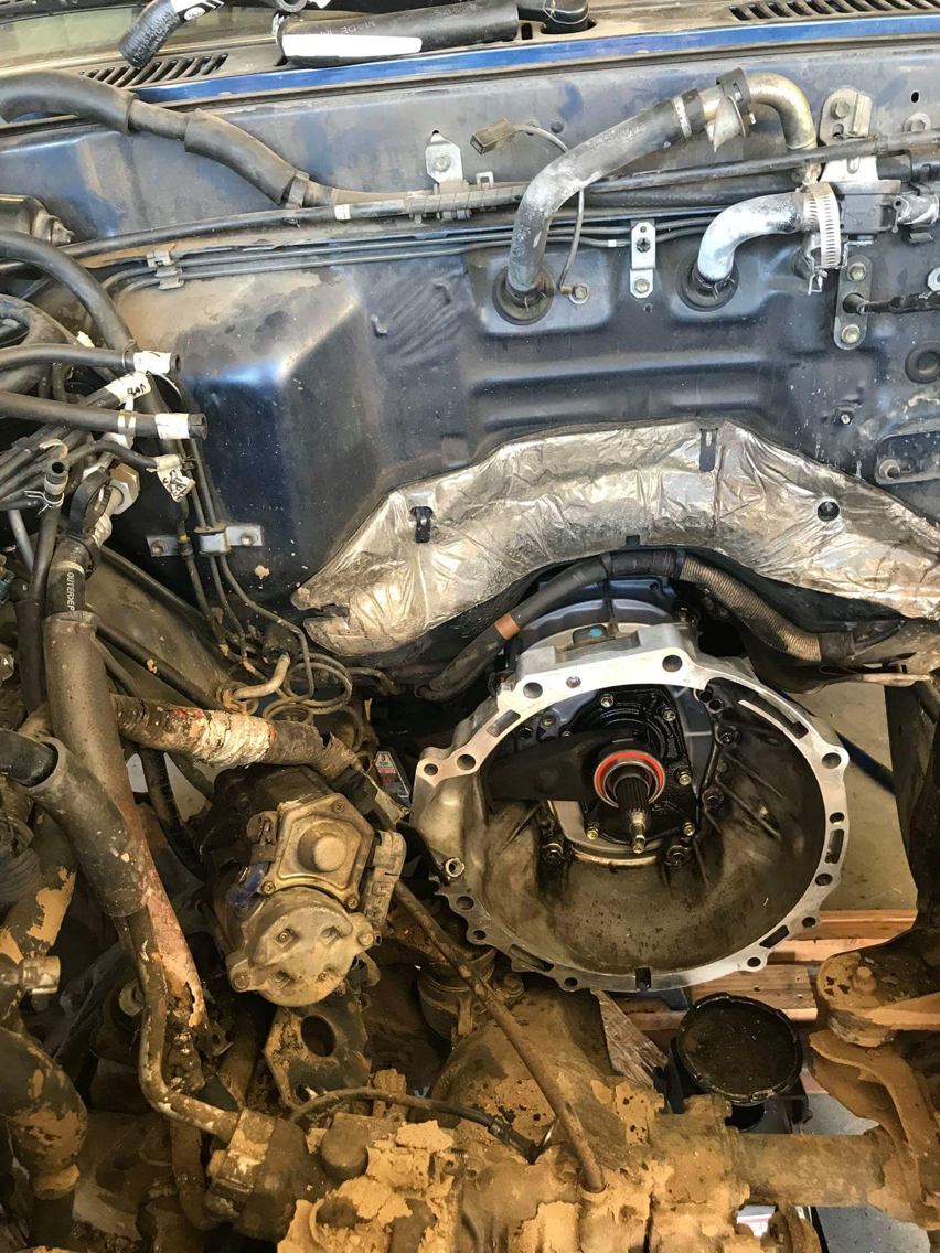

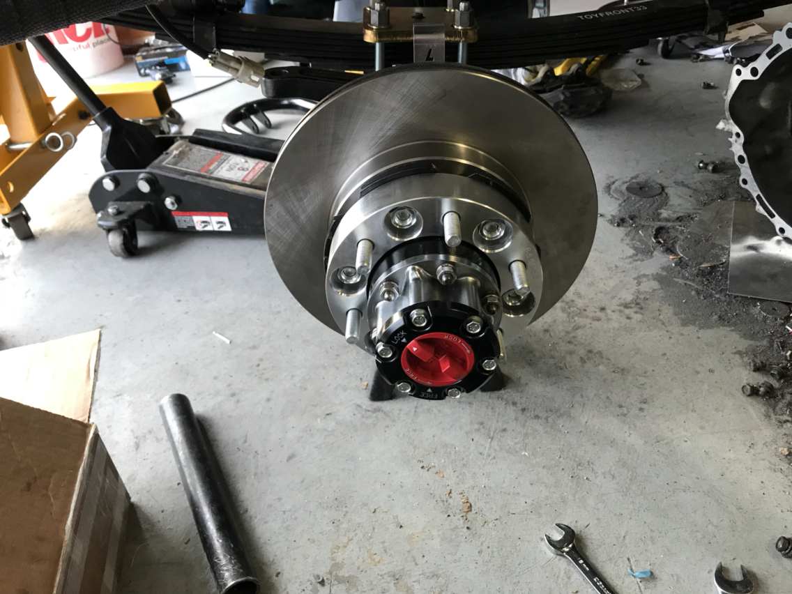

Got the elocker diff mods done today on the Bridgeport mill, had to remove quite a bit of material from the casting to get the diff to clear the ubolt holding the leaf spring. I also counterbored the one bolt that is near the leaf spring and put a button head cap screw in place of the hex. I then rebuilt the hubs with and spindles and installed the RCV axles

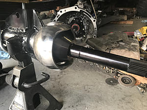

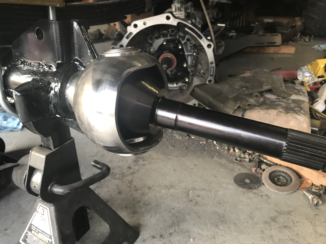

Finished the axle hub to hub and got the high steer arms installed. I need to put the clutch hydraulics in and new heater hoses in and I am ready to put the engine back

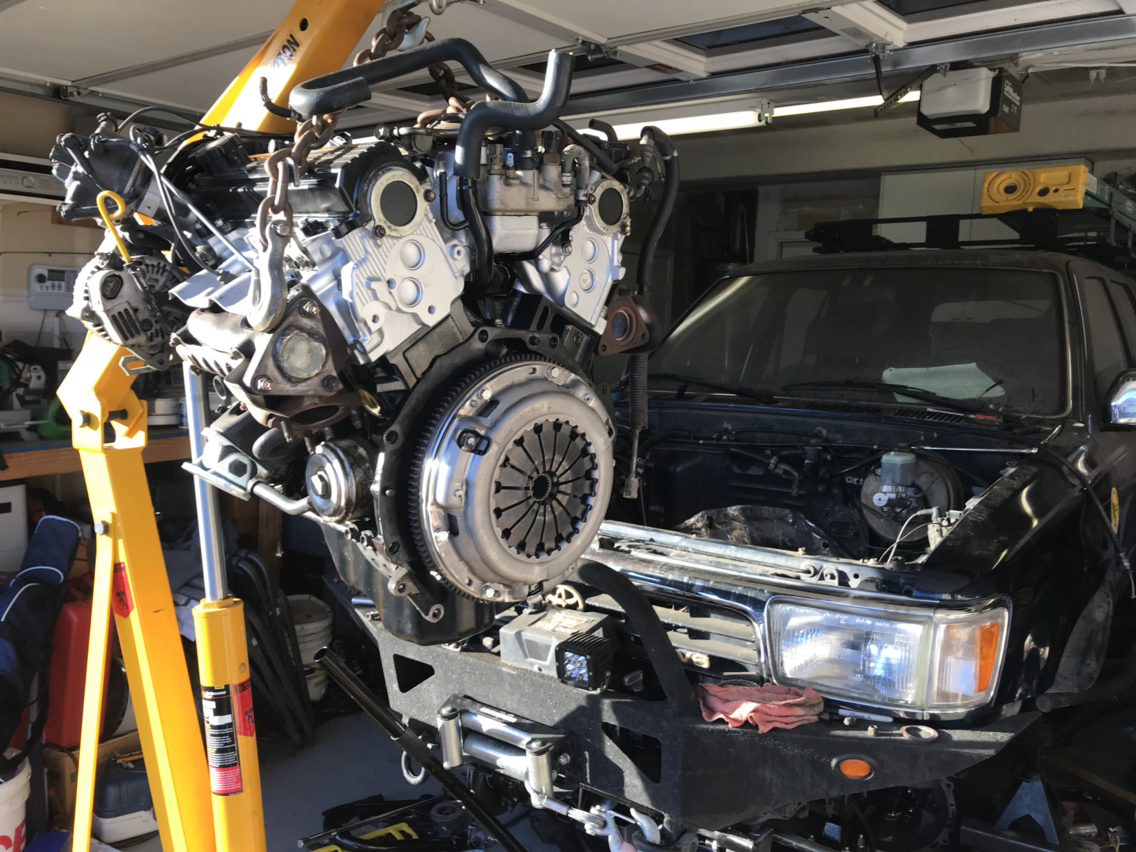

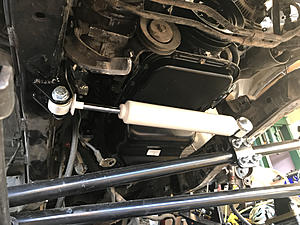

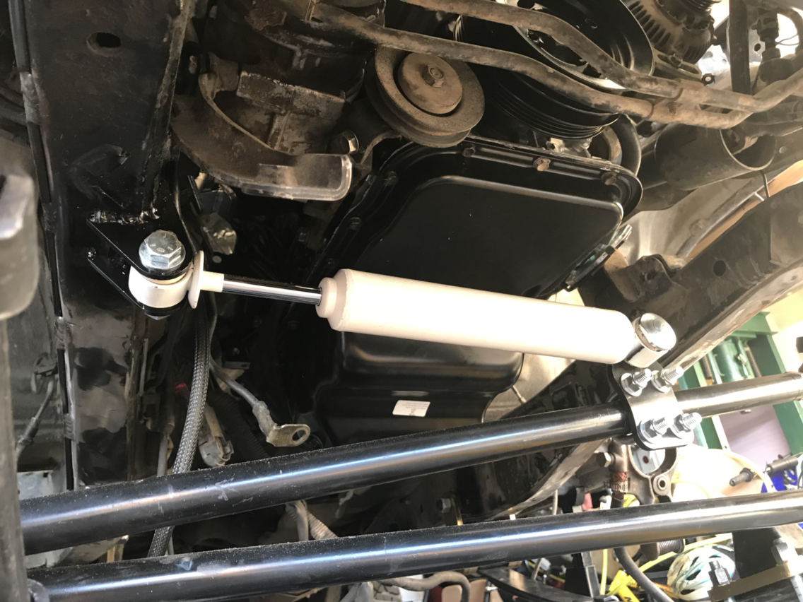

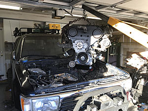

Got the steering stabilizer in. Hard line for the clutch is in along with the master cylinder. Wiring for the locker is through the firewall. Engine going back in
