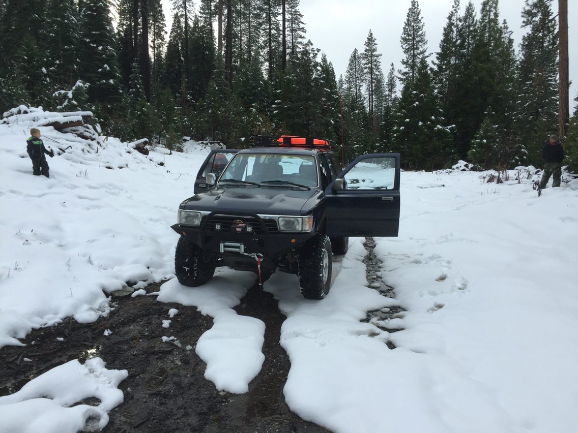

Thanks! Here is a recent pic since we finally got some snow this year in Tahoe.

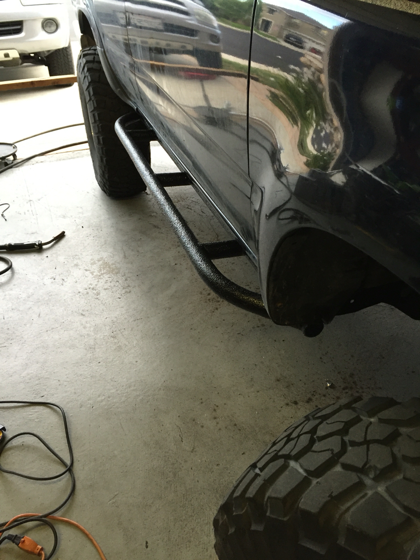

Finally got around to welding up my rock sliders. I got a coat of herculiner curing on them and will weld them to the truck tomorrow
Old Jun 20, 2016 | 07:07 PM
  #112
Yotard's Avatar
Joined: Apr 2011
Posts: 457
Likes: 9
From: CA
Got one side complete this evening
