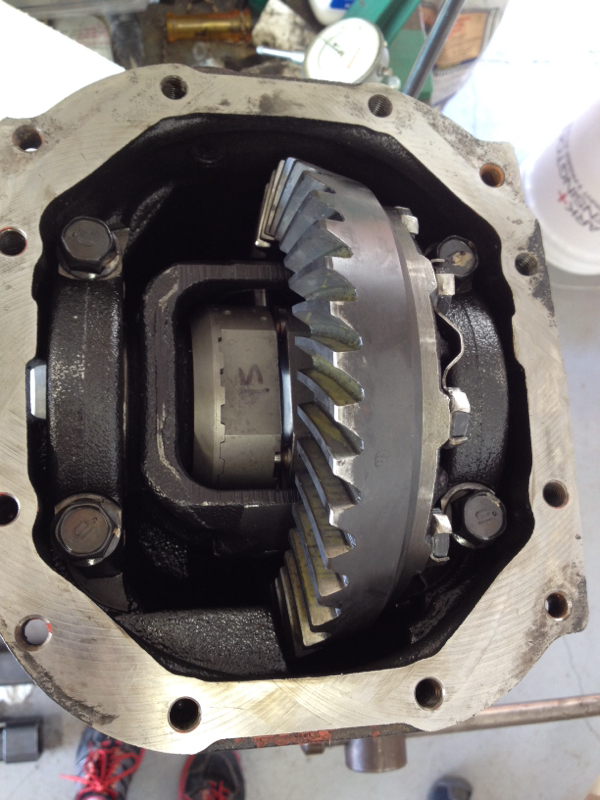

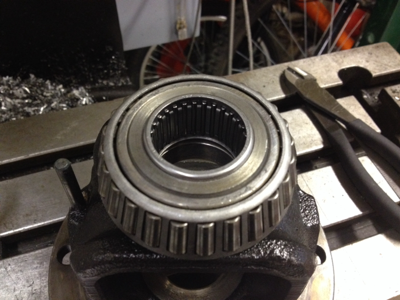

I finished the front differential today. I took the factory 4.88 diff that I bought, tore it down to the carrier. I then bored the non add carrier on my Bridgeport mill to accept the needle bearings for the add setup. I then added in the spartan locker and reassembled the diff. Ready for installation. Yotard's 95 4Runner Build-image-1823162711.jpg
Great work. It's nice to have those tools to machine your own parts.
