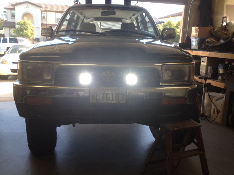

Added some rigid industries dually led lights. I ordered a cbi offroad front plate diy kit but I wanted to use these lights this hunting season so I went ahead and mounted them now.

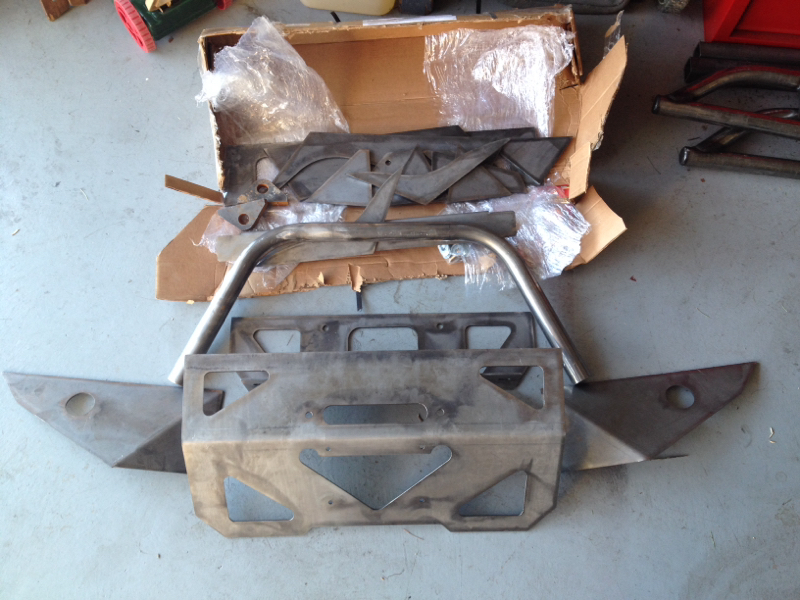

Looky what showed up today. CBI Offroad plate bumper. A little welding and paint and this thing should look pretty good.
