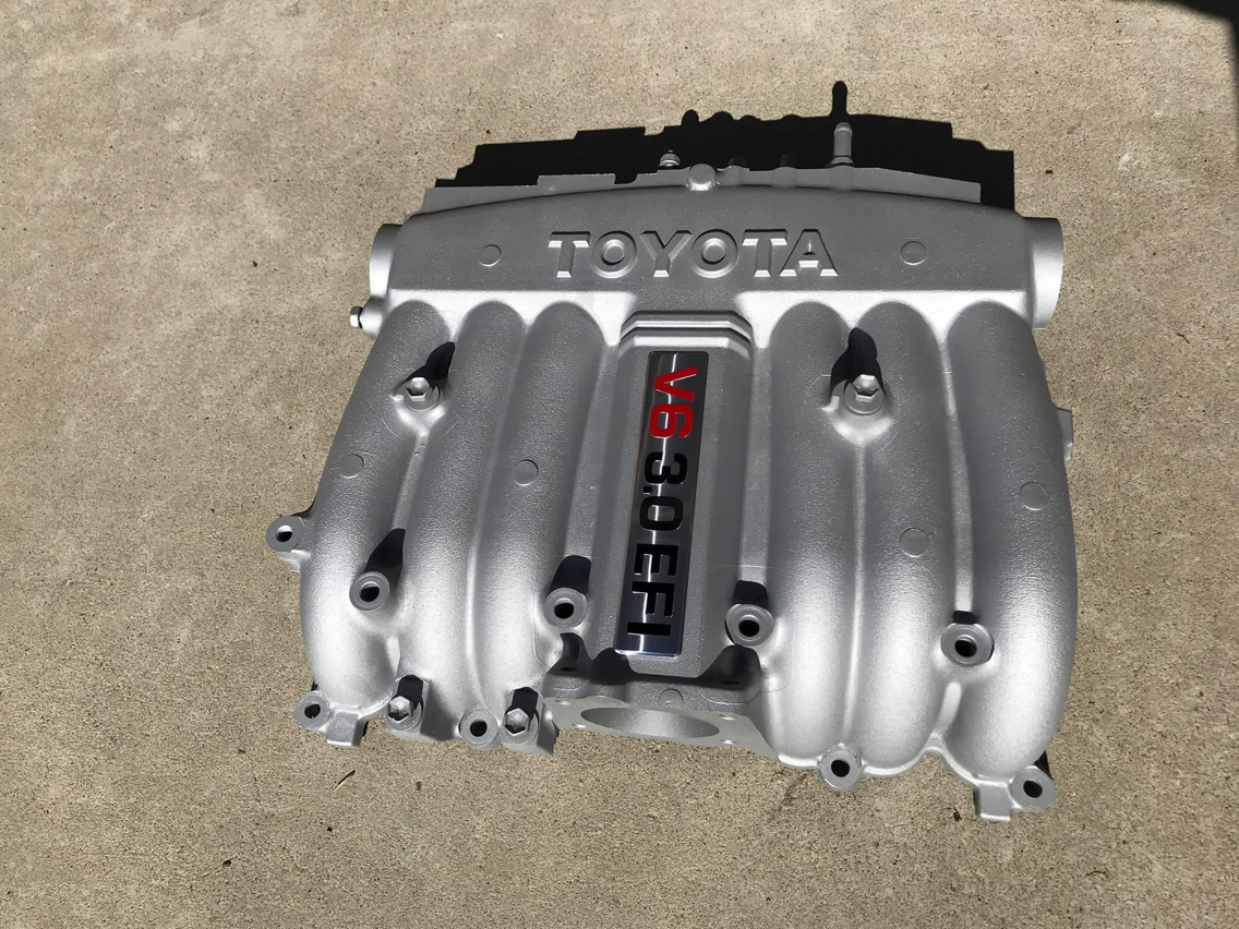

Degreased and painted the intake today. Found a new stock 3.0 sticker for it as well

That intake turned out great, I'm slightly confused though, I thought you were swapping in a 3.4? Sorry if I'm confused, I read a lot of build threads.

No rebuilt 3.0. The smog ref process in ca scared me off of that

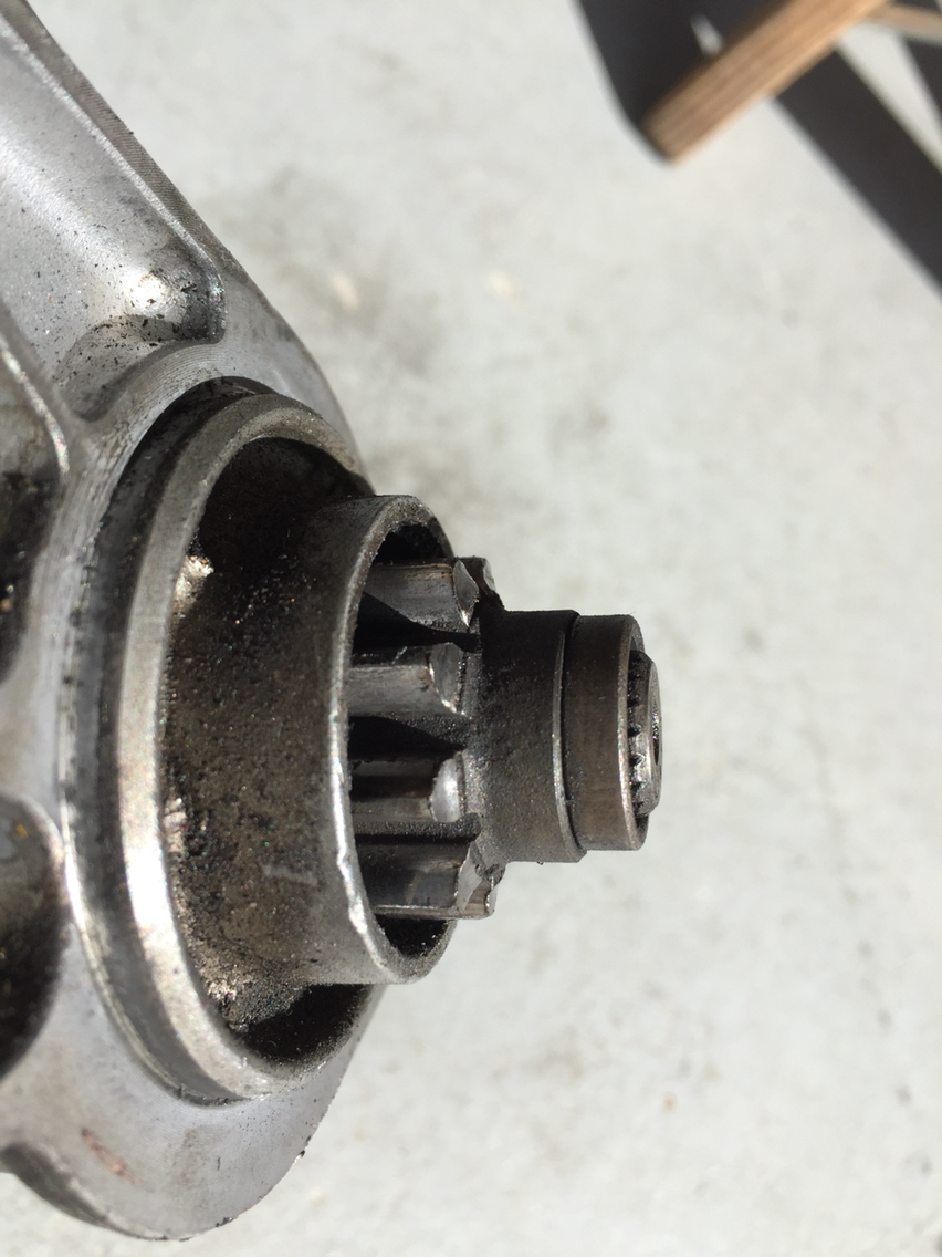

She's back from the dead but has a code 52 so apparently the computer isn't reading the knock sensor. And there is some horrible noise coming from the bellhousing that I can't yet confirm but suspect that the starter gear is stuck on the flywheel. To be continued.

Yep starter gear was rubbing against the flywheel gear. Mostly self clearanced so I just took my angle grinder and finished it. No more awful sound. On to the knock sensor.
