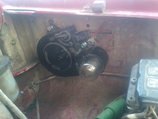

Installed an under hood light in the yota
Its out of a 90's chevy and has 15ft of cabel

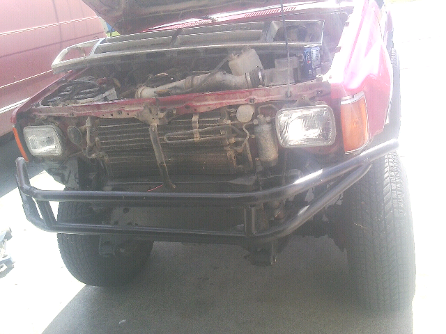

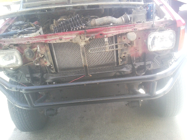

Also decided to finally start taking out some of the A/C parts I'm not gonna need
Before:
After:

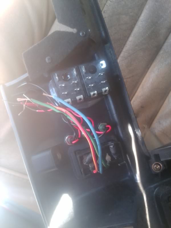

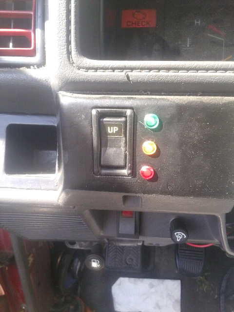

And popped a window switch in where the clutch cancel switch use to be and drill and installed my lights for the E-Locker so when its all done u lock it by pressing up and unlock it by pressing down

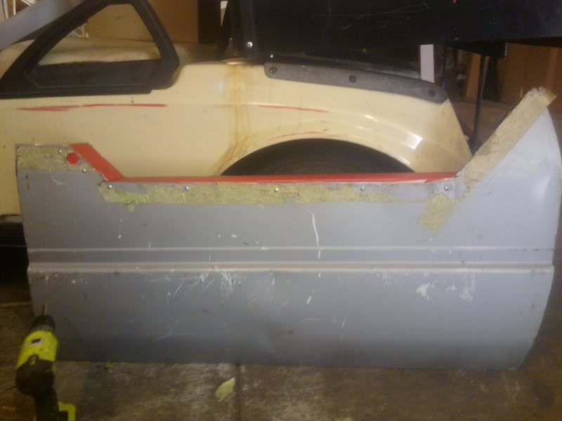

I tried making some half doors a long time ago and stoped half way through them, because a better idea had come up after a cut one door in half so they wouldent match, well after talk to my brother this weekend I came up with a differant route and instead of welding a plate to the top I'm just gonna use a 2x4 I got the passenger side half way done on my lunch, but ran out of long peices of wood so my driver door will have to wait, I was trying to post a couple of pics of it but every pic I have exceeds the max 448kb allowed with this app so srry no pics

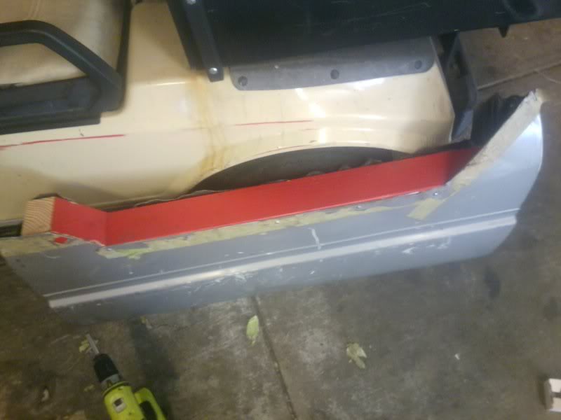

And the progress on my pass door
As u can see in the pics the wood goes allthe way to the front of the door but the metal of the door goes up, thts for looks and for when I add a cup holder wind won't hit the drink

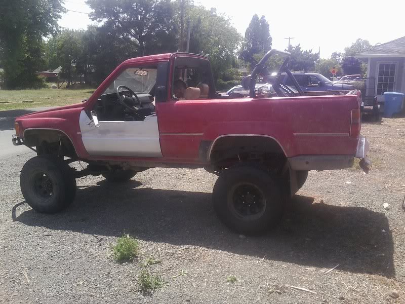

Thanks here is a few more from yesterday, installed the 2x4 on the driver side and mounter them
Still got some work to do but its all little things to fine tune the doors and make them look purdy

i like the simple lines. they compliment the body style very well. so you like driving with 'em?

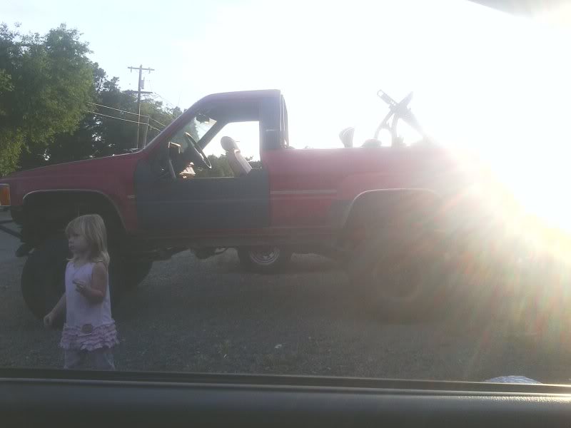

Thanks, I originally wanted to cut more off but decided on tht so tht the would still be a good arm rest, I kinda want to add a plate to the back so where it steps up to another horizontal plane it would just be a triangle all the way back to make it cove up som of the inner door jam but I'm a big fan of the shape they formed
As far as driving with them..... they are awsome all I wanted to do today was just drive around and enjoy the weather was around 75 today so it was great. Now my next project would have to make a lil mirror with a mount to bolt to the truck so I could completely take the doors off but man my I say I got a ˟˟˟˟ ton of looks today, a lot from people as if they never saw anything like tht before

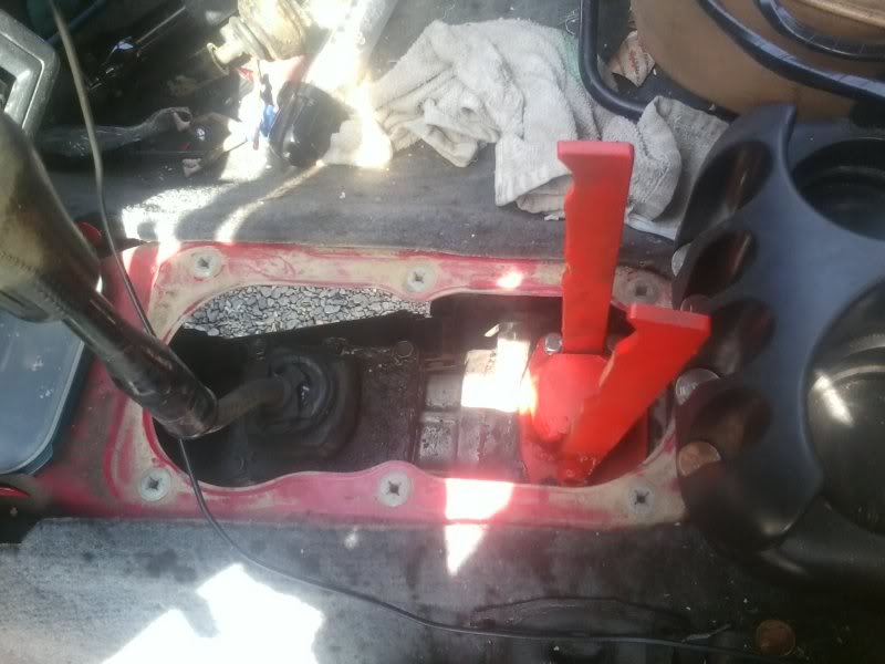

welded tht top to my twin stick then filled the box full of grease to lube eveything, then painted and installed
Almost have to move the center consol, when in 4wd the shifter goes back right into the slot for quartes but it works, the only 2 flaws are tht: 1. My high-low shifter fork is slightly bent so sometimes it will grab both shift rails at the same time, so all I do when it happens is push the shifter to the driverside and shift. And 2. The metal handles hurt ur hands if u shift to much in a small amount of time. But after looking around every site wants around $30 for a rubber boot for the twin stick I found one site tht sells a generic one tht instead of having rectangle holes for the shifters has circle holes, and its like $7 so I'm thinking of buying tht and then cutting my shifter handles then makeing new ones with metal rods plus then it will be easier to put a know on them

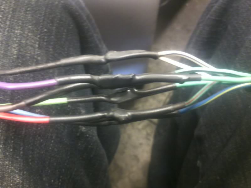

Alsofound out how I want to run my elocker wiring, then cut wires long enough to go from the axle to the pass fram to the driver dash, then taped all 6 wires together and then soldered and heat shrinked one ende of them to my elocker plug
