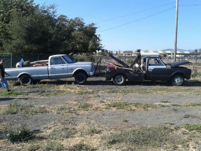

The tow truck moving my dads 67 around the shop field

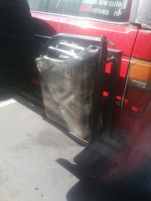

This is the only pic I have right now

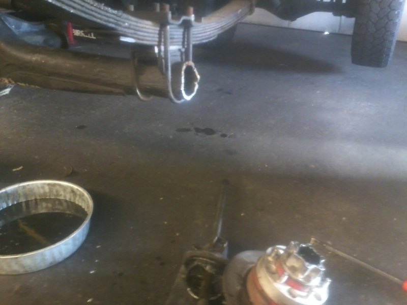

Tearing the old axle down before the trip to put a matching gear diff in it
The only way I was able to get the long axle out

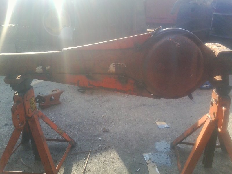

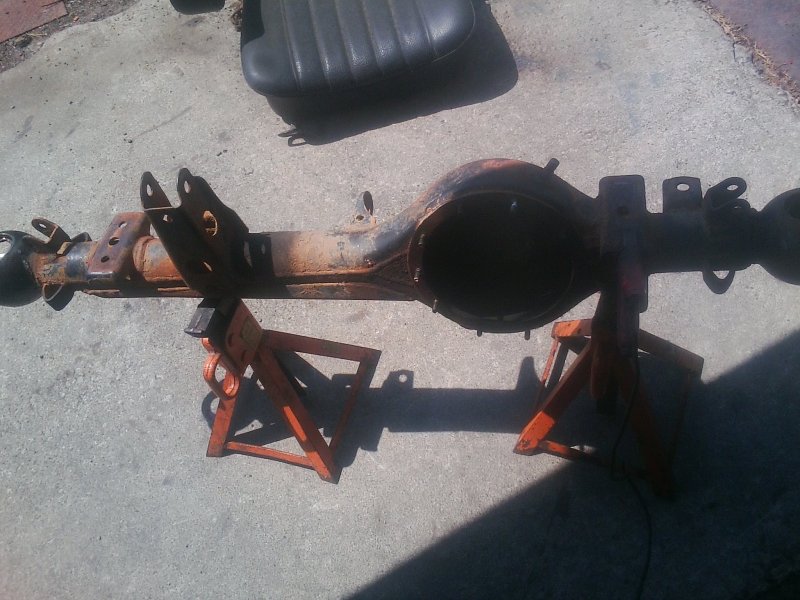

And the start of the new axle

I like the bumper and jerry can holder, looks good! Your front axel is coming along nicely, did you make your own axel trusses for it? Looks great!

Thanks, yea the trusses are from some 3"x3"x.120" square left over from an old cherry picker, now that it is all put together I need to finish welding the 2 trusses pllus make some knuckle ball trusses. I also cut the diff cover off the old axle and will weld it to this axle.
I know the bottom truss I welded on limits my ground clearance and is bad for rock crawling, but I don't plan to do any serious rock crawling, id rather have a housing that I don't need to worry about.
