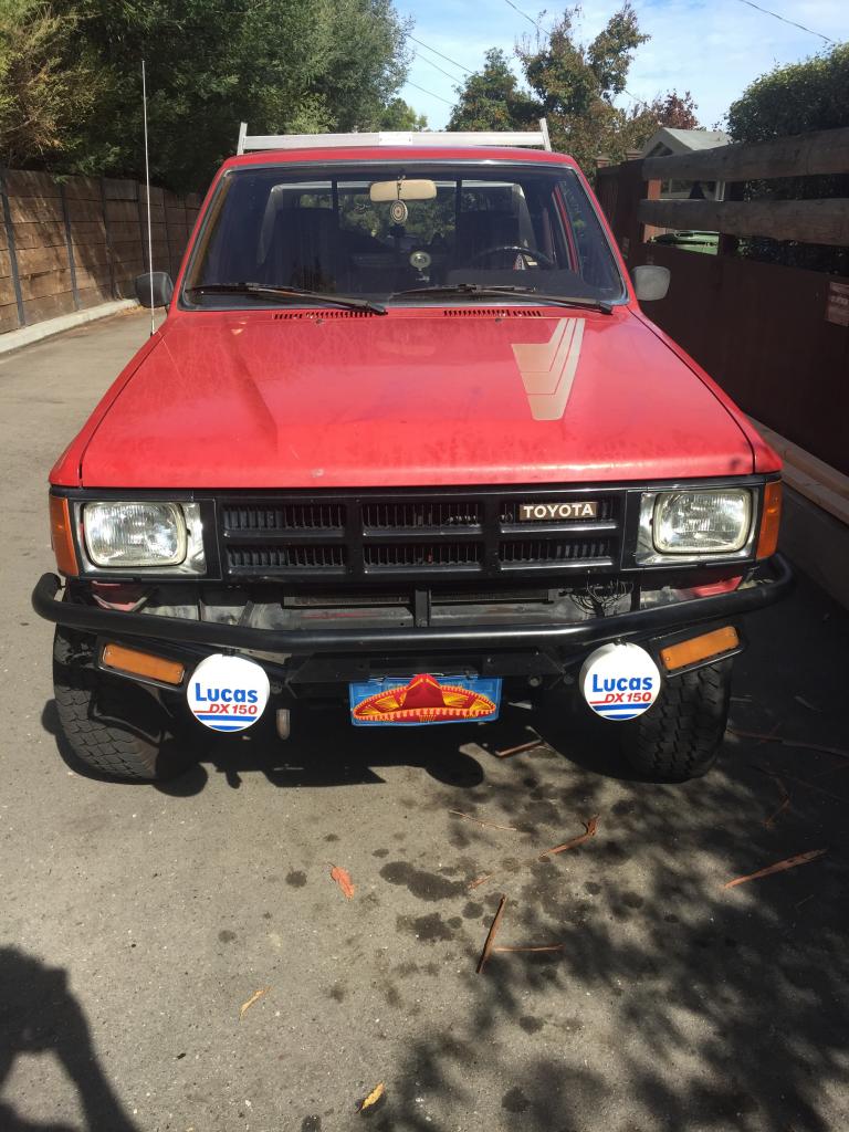

I just bought these 80's fog lights for the truck to replace the cheap Hella lights up front. One of the Hella lights has cracked glass anyways. I think Ill put the Hella thats still good in the back as a work light.
I think these will look tits on the truck
They are about 6" wide

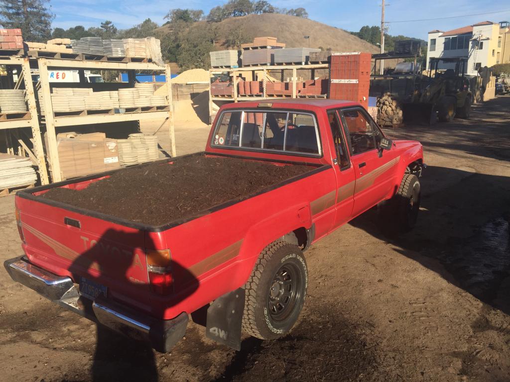

Iv been using the truck a lot for work. I was helping a friend with some landscaping a few months ago and loaded the truck up with a whole bunch of composted top soil. Im always surpised how this truck feels with weight in it. It seams like weight makes no difference. The truck feel just as strong/fast when its empty as when its loaded up with a bunch of weight. Its a strange feeling that I have never experienced with another car/truck.

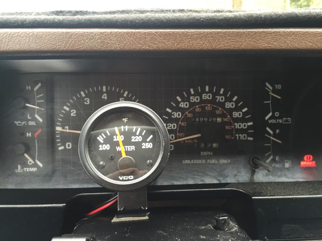

I also finally got my VDO temp gauge mounted and wires in. I still need to finalize a solid mount for it. Its only taped on with 3M outdoor double sided tape right now. The screw hole on the gauge pod is really hard to get a tool to with the gauge all assembled. But it is really good to know what temp the 22re operates at. It runs around 185F and goes up to about 190 when parked and the fan isnt running. That seams like a really good normal temp to me.

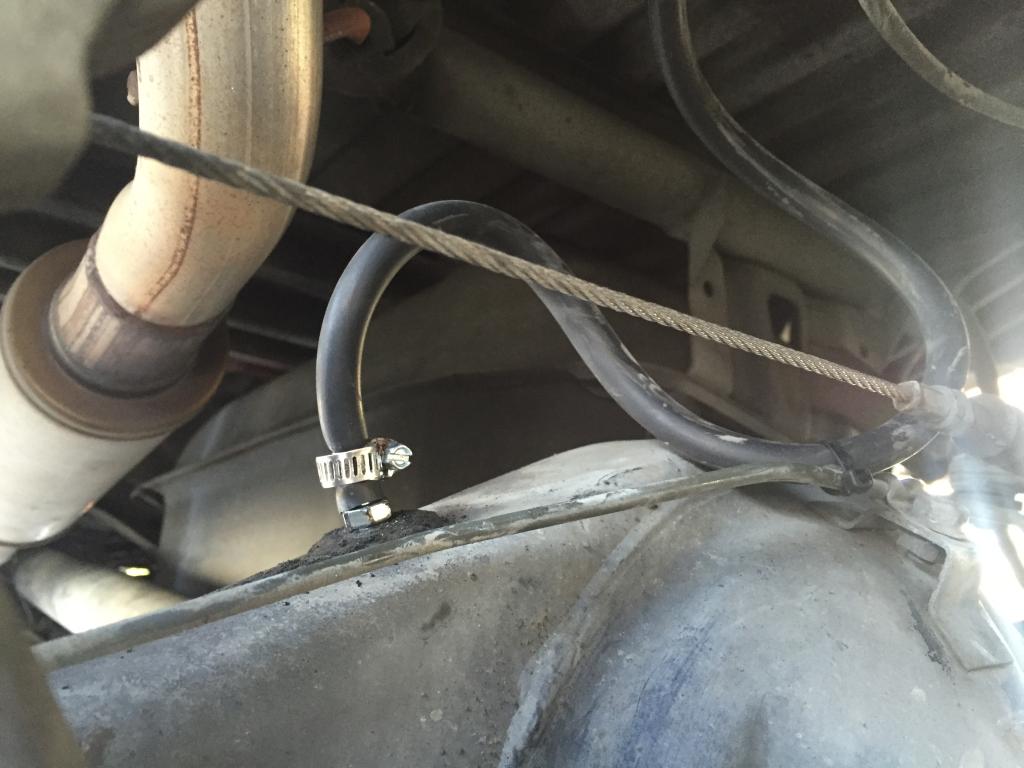

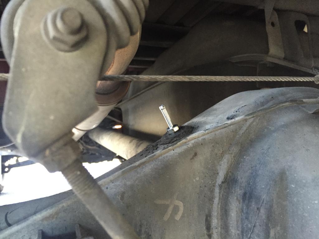

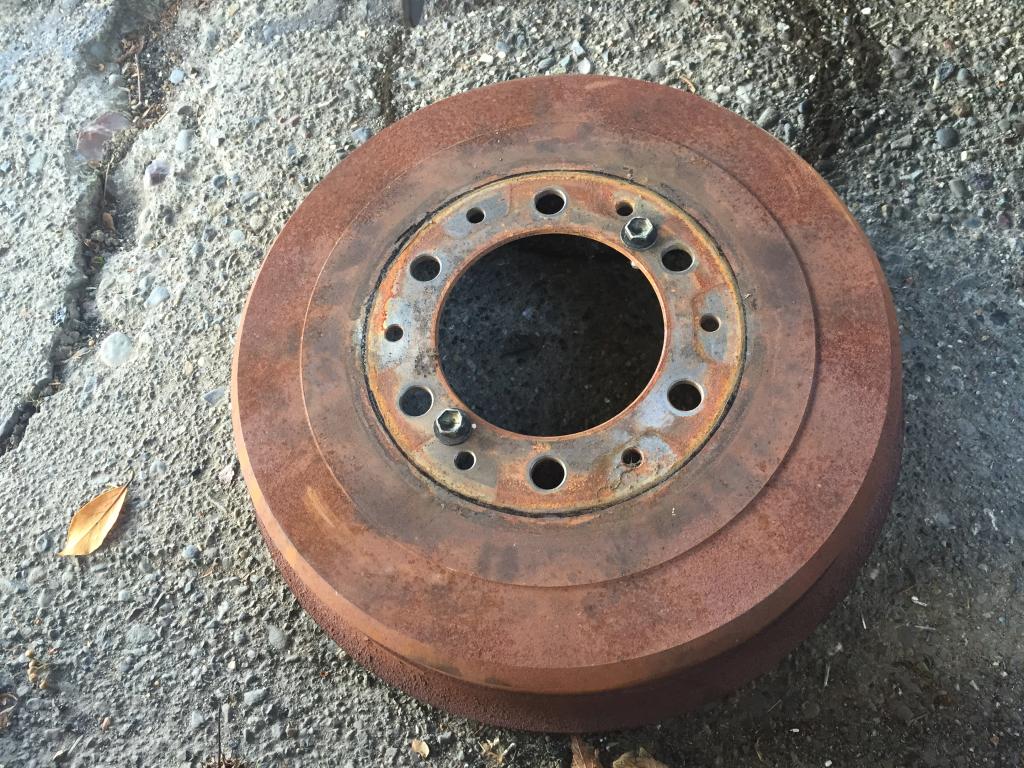

I got to do a bit of work on the truck today.

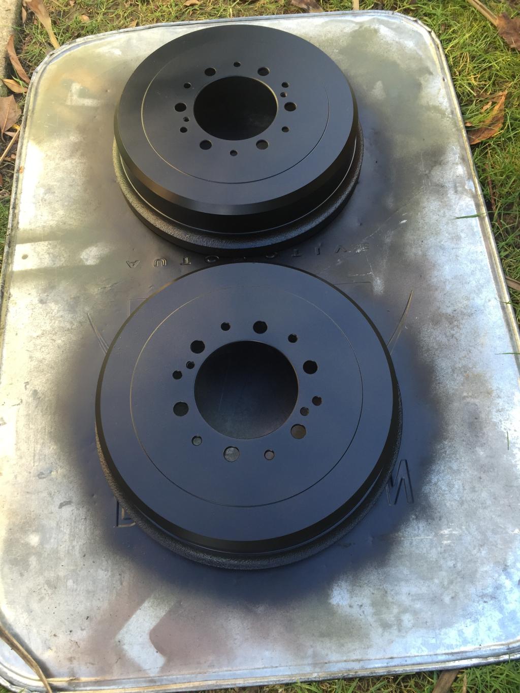

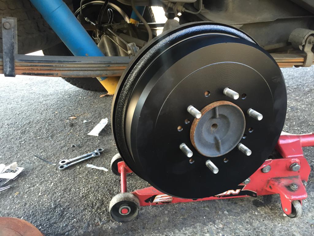

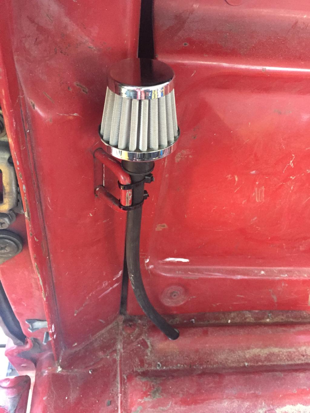

I installed a longer rear case breather in the back to clear any future water crossings. I was going to do the front today as well, but decided to just wait till I can afford the parts for a solid front axle.
I also installed new rear drums, and adjusted the shoes. Man the brakes feel a lot better now. I painted the drums as well just to keep them from rusting and looking nasty.
The zip ties are temperary until I make it to the hardware store for the proper fasteners.

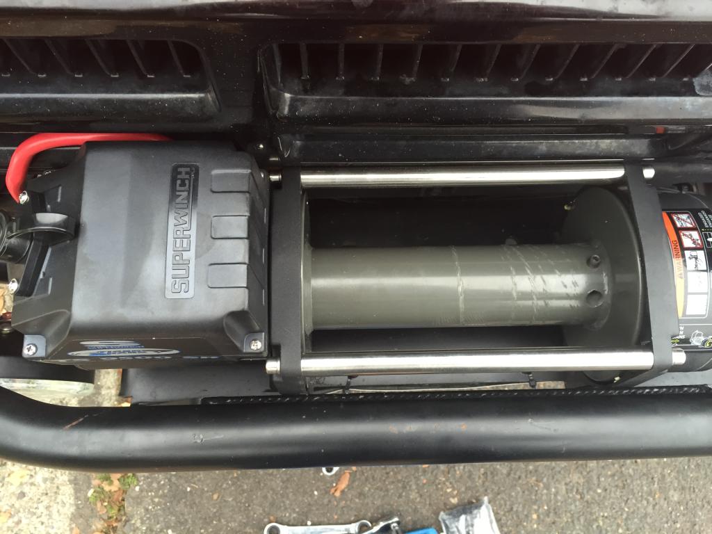

The winch showed up today. I go this Superwinch Tiger Shark 9500 S off of Amazon for $400 because the box was "10% damaged." It seamed like a good deal as the winch usually goes for around $700. Sadly when the winch showed up and I opened the box, it was missing all the install hardware, the controller, and the clevis hook. So I called Amazon and complained, and they refunded me 20% which was $86 !!!!!!! I went to the Superwinch website and ordered the replacement parts for about $36!
This means I got the winch for about $350
Now I just have to wait for the parts to show up to test this bad boy out.
The fit on winch with the Trail Gear bumper is really tight! Its definitely pushing in on the grill a bit. The only way to fix this would be to space the bumper out a bit by extending two of the mounting tabs, and putting thick spacers between the car and the bumper on the rest of the mounting locations. I might do that down the road. It works for now. I just cant get the winch cover over the winch to protect the synthetic line from UV.

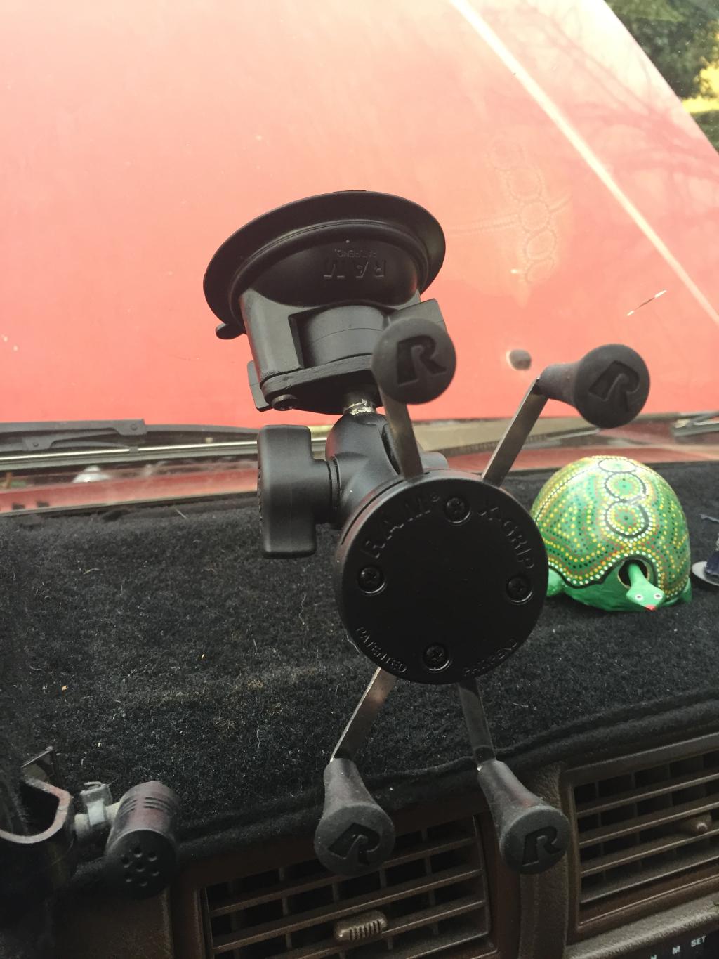

I also upgraded the cell phone holder in the cab. I have a RAM GoPro suction cup mount I used on the out side of my track car when I still did track and autocross events, and I loved it so I got their universal cell phone mount as well. They make super heavy duty stuff the doesn't shake around or fall off. I mean if their suction cup will hold my GoPro to the side of my car while doing 1+ Gs in a corner, I am sure it can hold my iPhone on my window. They also make other mounts for tablets if your running GPS in your rig, other electronics mounts, and even fire arms mounts.

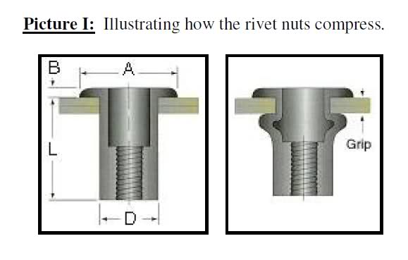

That rivet nut thing is cool Got a picture of what they look like installed?
This is how they install. There are flush fit rivet nuts that need to be counter sunk, and normal rivet nuts that have about a 1/16" lip. I have not used mine yet, but I will soon ether tomorrow or this weekend on my trailer project.

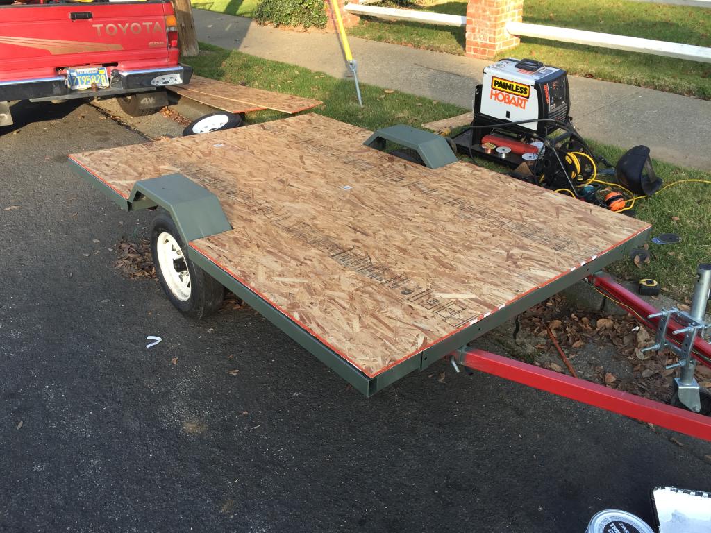

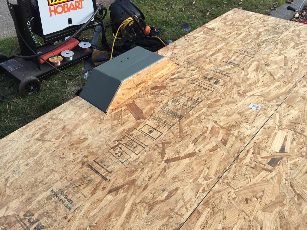

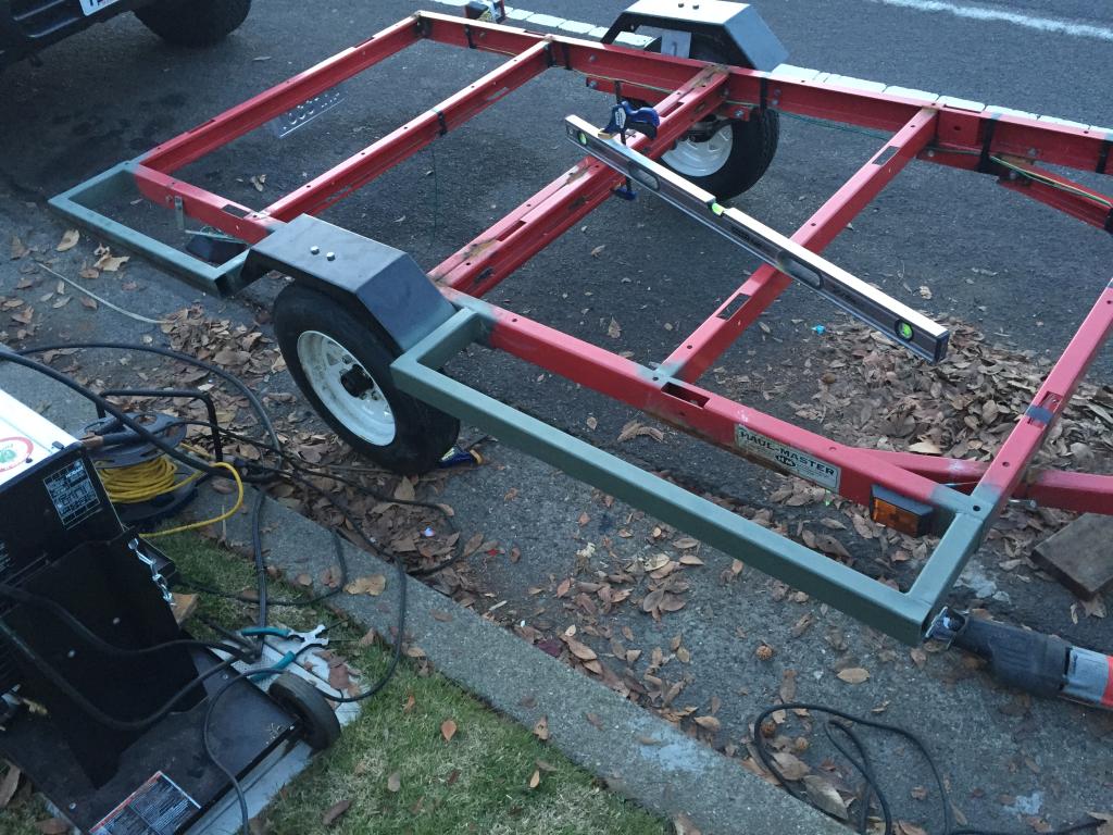

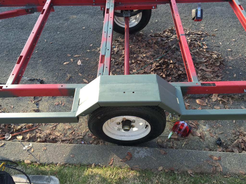

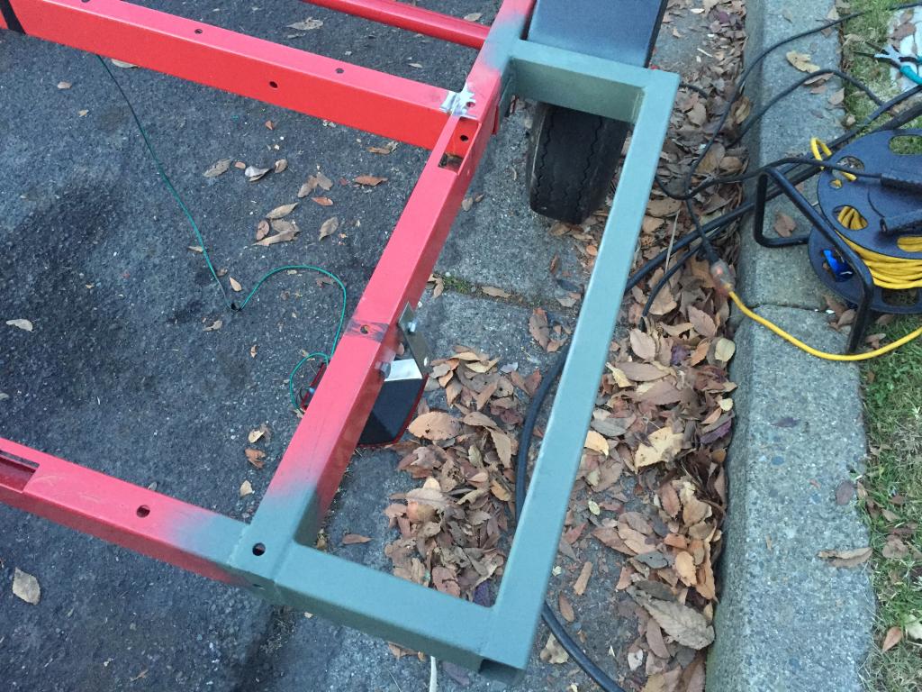

This is my side project. Iv been working on a tool storage trailer I can keep all my tools in and use for my future move up to the PNW. I have some plans for the trailer like on board air and water, as well as a small fold down exterior work bench and a tire carrier. So I can use it for work and auto events.
Its based on one of the larger Harbor Freight trailers. I welded some out riggers on for more interior space, and its going to get an enclosure.
This is where I am as of now.

Then I took the wheel wells off and cut them in half, then added some metal in the middle to make them wider. Excuse the bad welding/fabrication. I literally have to do all my work off of the sidewalk/street because I dont have a garage or work space. Its hard to get things correct with out a flat work surface.

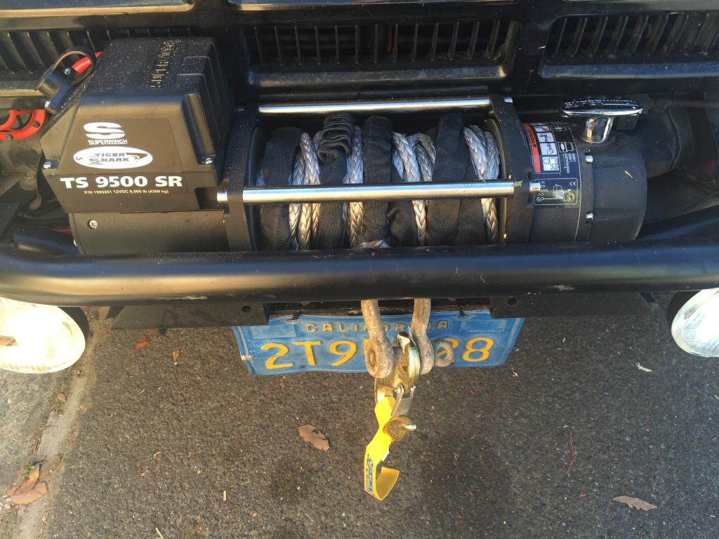

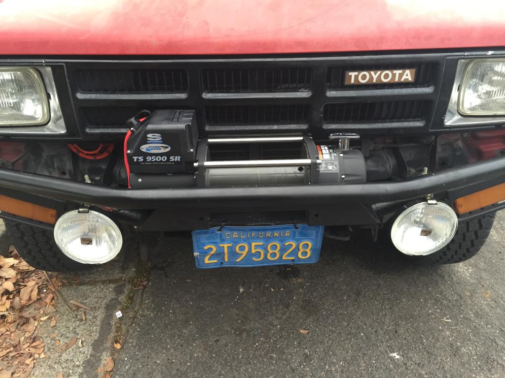

I also finally got my winch working and mounted up with all the correct bolts. I still need to figure out how to mount the fairlead. There is not enough room between the winch and the sheet metal of the winch mounting plate to put the bolts for the fairlead.
It was fun pulling my GF's 4Runner while I was tensioning the rope onto the drum.

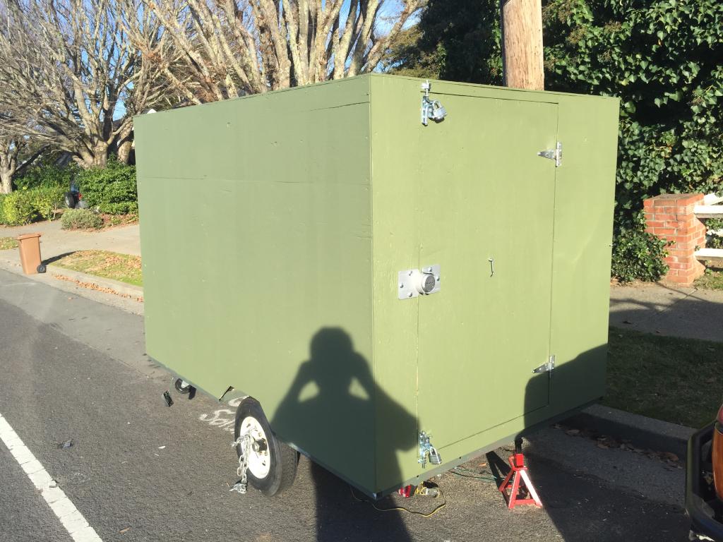

And my trailer made some headway
