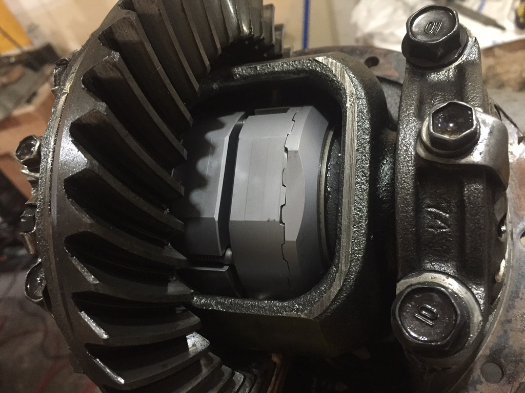

Got my Aussie locker in today. Definately needs some brake in, and I need to learn how to drive with it. Its not as loud as I thought it would be, but doing tight turns like at the end of a dead end is way different then it used to be.

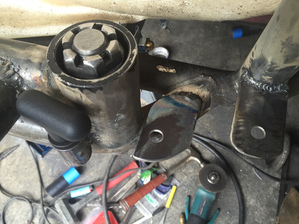

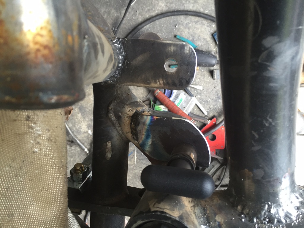

I also got the open position latch all welded up.

Not so happy with the Aussie locker so fare. I think it would be decent for a trail rig, but for a a daily driven truck its not so good.
I think I am going to take it out and save up for an ARB air locker. Maybe the tax refund will help out a bit.

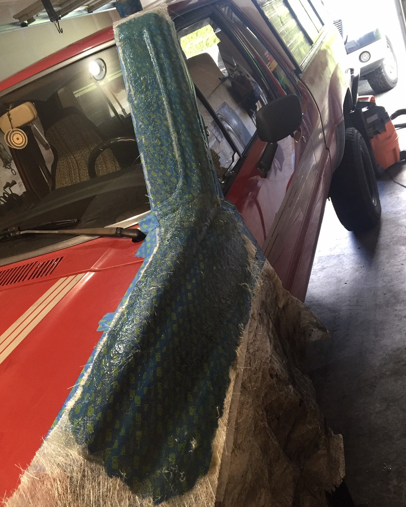

Starting a fiberglass safari snorkel build.

Wow, that's something! How exactly are you planning on making the snorkel? It looks like it will be pretty legit!

I think Ill use a combo of foam tubing and some of the yellow expanding foam for shaping. Then glass over that, split it open when its dry, carve out all the foam, and then stick it all together again with another layer or two of glass.

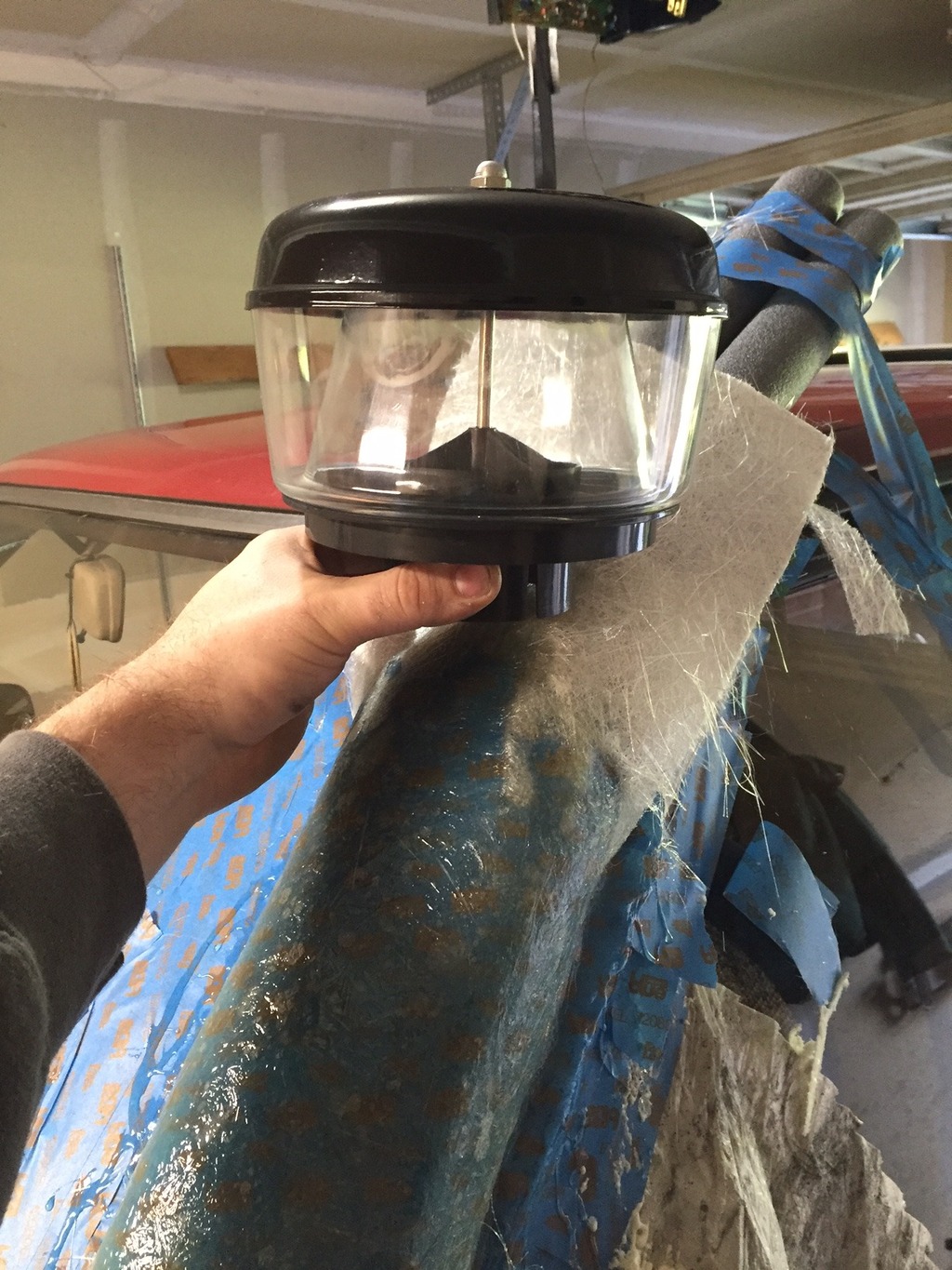

Old Feb 23, 2016 | 01:53 PM
  #132
deutschman's Avatar
Joined: Dec 2013
Posts: 200
From: West Coast

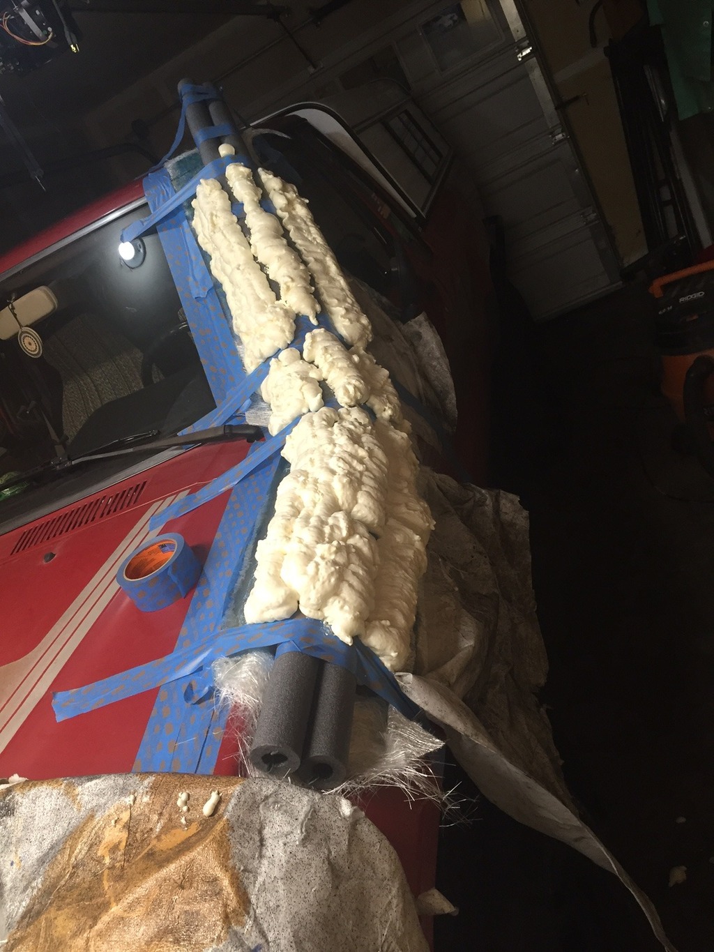

Some more progress on the snorkle.
First I made a sort of foam mold over the original fiberglass I made. Used some pipe insulation and expanding foam used for closing cracks and holes in houses.
Looks messy but that changes.

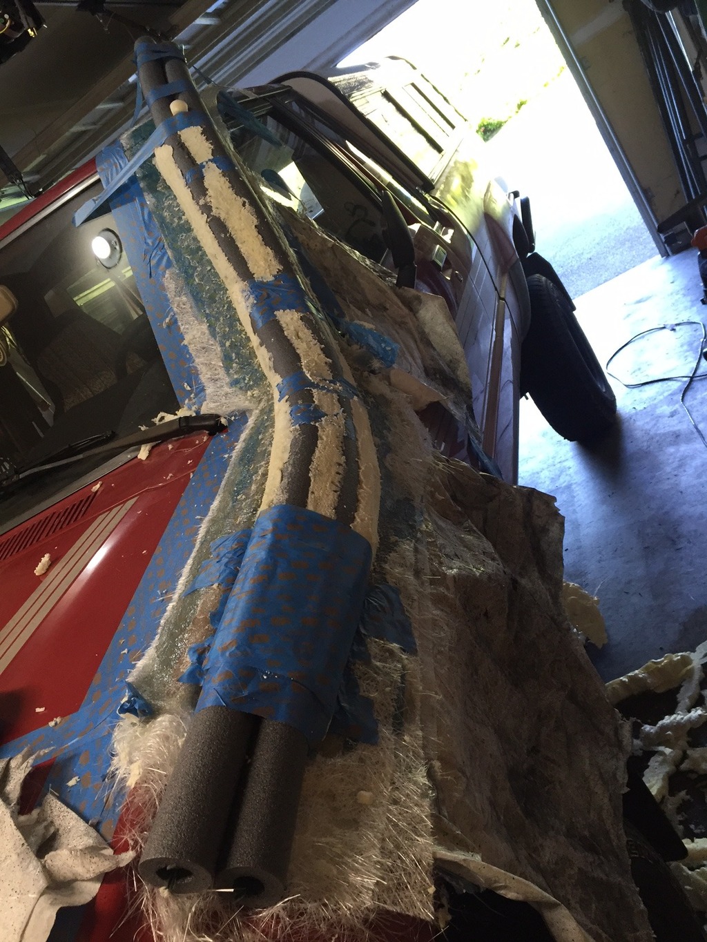

Then a day later when it was all set, I carved it down to the shape I wanted and covered it in some more painters tape to give a more even surface and help with the glass releasing later on.

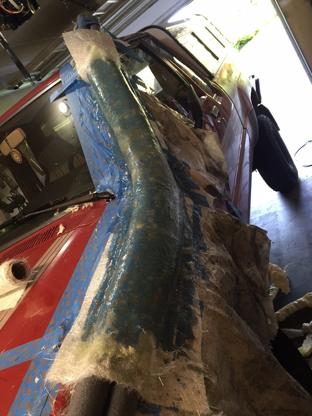

Then I did two layers of glass. Ones this is cured Ill shape the end at the bottom and the end at the top for the pre-filter to sit on. Then Ill pop it all off, split the two pieces apart, mold in some fasteners, and then join the two pieces with some more glass, bondo and paint.
