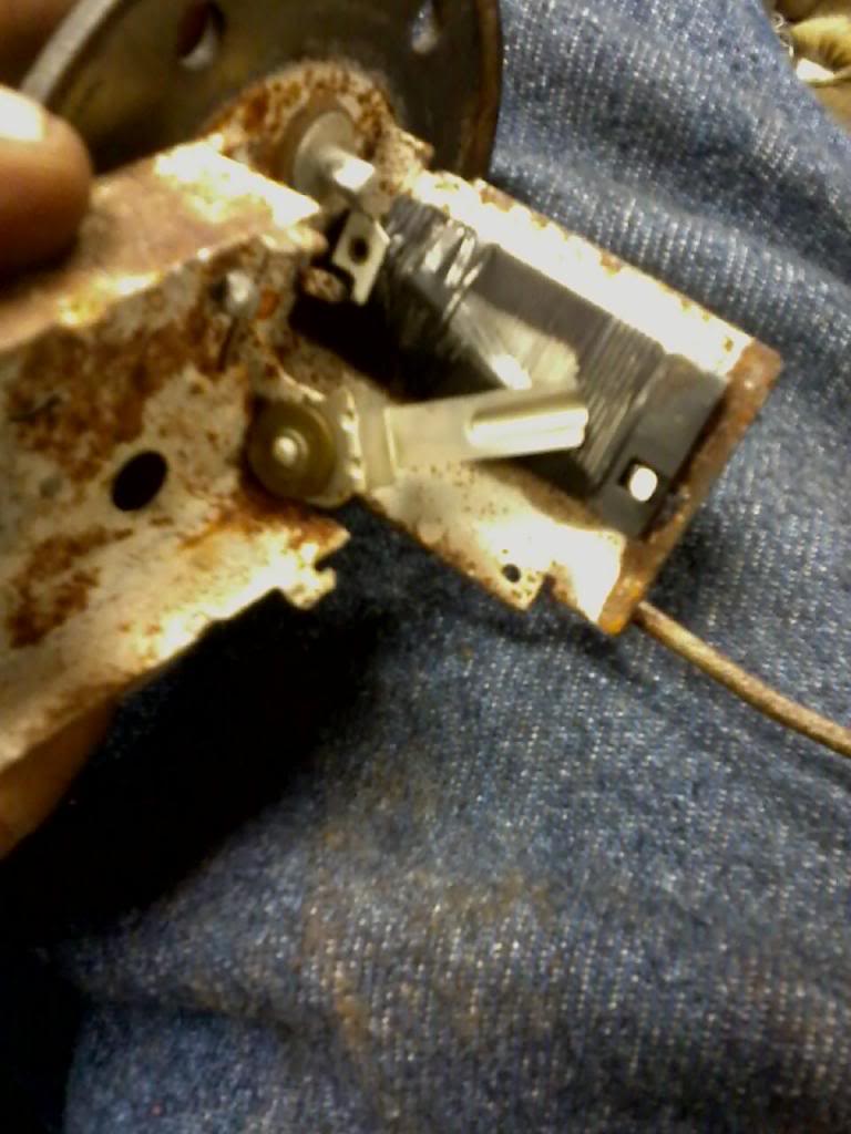

There is a Toyota site that you can put your VIN and see what is on your truck but don't remember the site. Is your truck a base model truck? If very few options I would say it came with no SR5 gauge.
Temp gauge is not the best on these trucks.
The fuel gauge is most likely the sending unit in the tank. The wiper on the resistance in the tank tends to rub the hair like wire in two.
