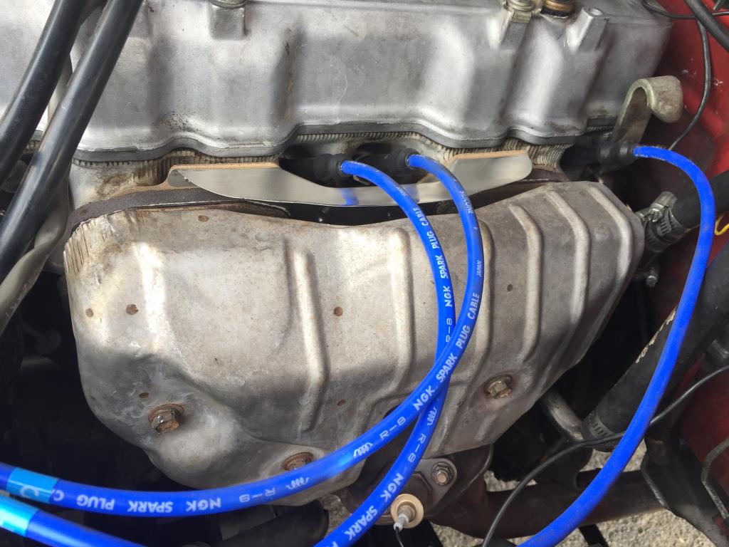

I did a real good coolant flush and refill yesterday with lots of burping. It got rid of the rushing gurgling noise behind the heater consul. So thats good.
Now I still have a slightly high idle after the truck has driven around for a bit, and the truck has a hard time cold starting. But its better then it was. No more 2000rpm with surging idle.
Today I put all new exhaust manifold gaskets on, and it got rid of lots of nasty noises. The engine is a lot quieter now.

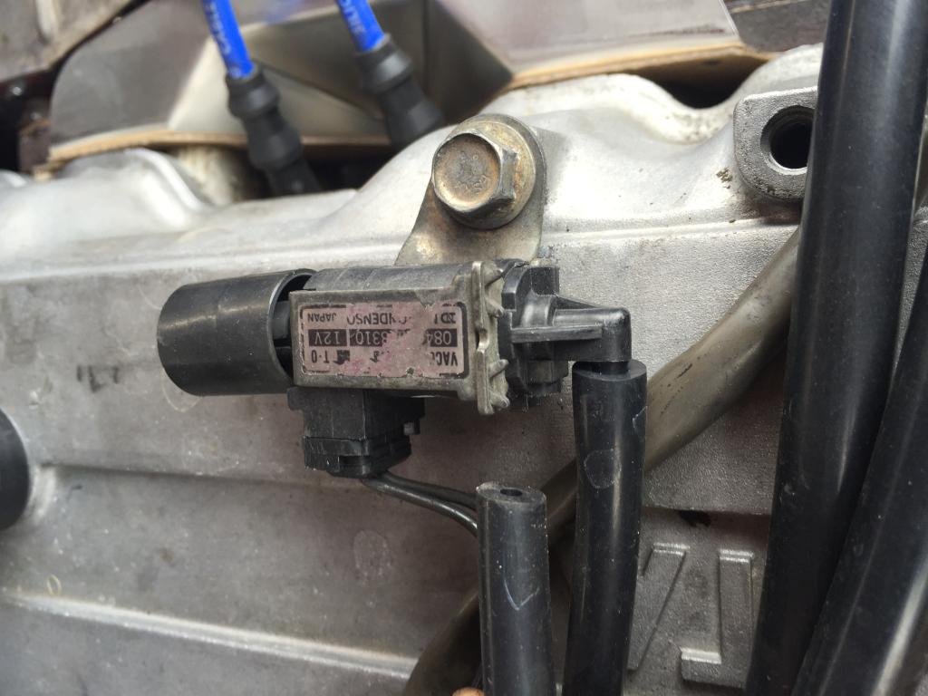

Sadly while I was replacing all the vacuum hoses the other day I broke one of the plastic nipples off of the front black VSV. Does anyone know where I can buy a replacement VSV? I cant find them online.

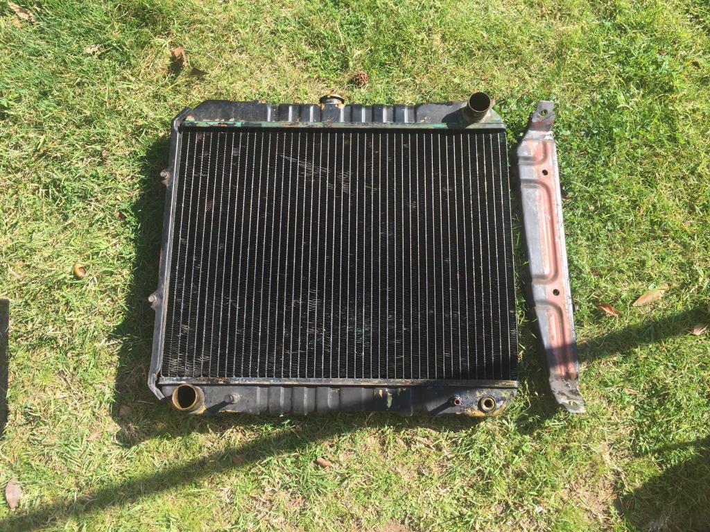

Well I thought I had my bad idle fixed, but it came back. So its not the AAV, vacuum leak, or coolant system at this point. Im going to throw in a new ECU coolant sensor and see if that changes things.

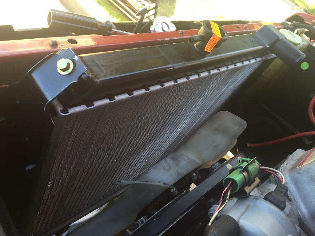

I put in a new radiator and hoses because my old radiator was falling apart and had a leaky coolant drain plug.

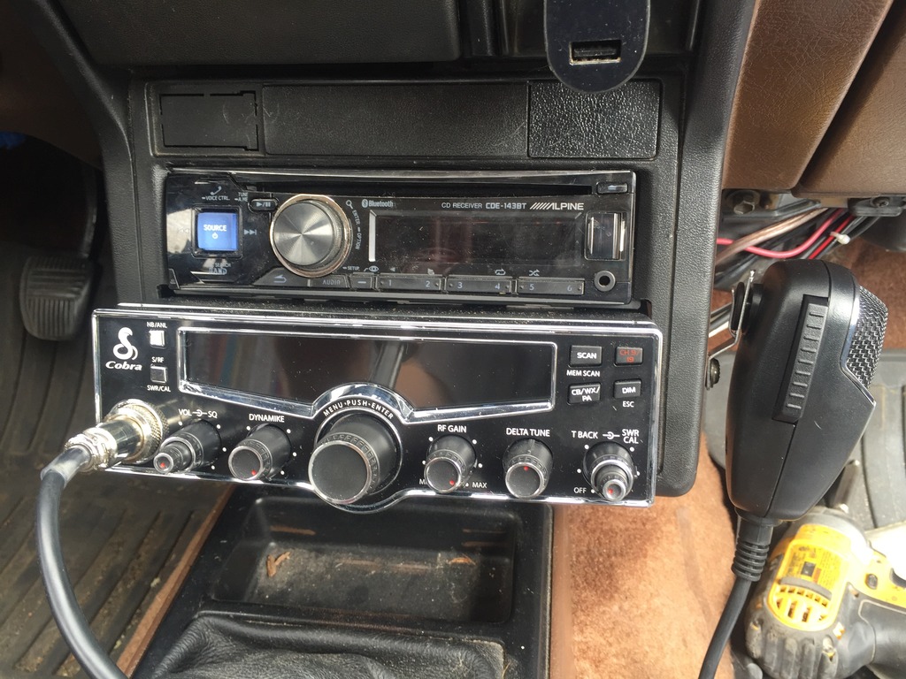

So I did some reading, and bought some CB stuff.
-Cobra 29 LX
-Firestik FS 4' antenna
-Firestik 18' cable with Fire-ring connections
-Firestik 3-way bracket
-Firestik HD antenna spring

The radio has been in for a bit now. Very happy with it, but I havent had much opportunity to really use it for anything hahaha

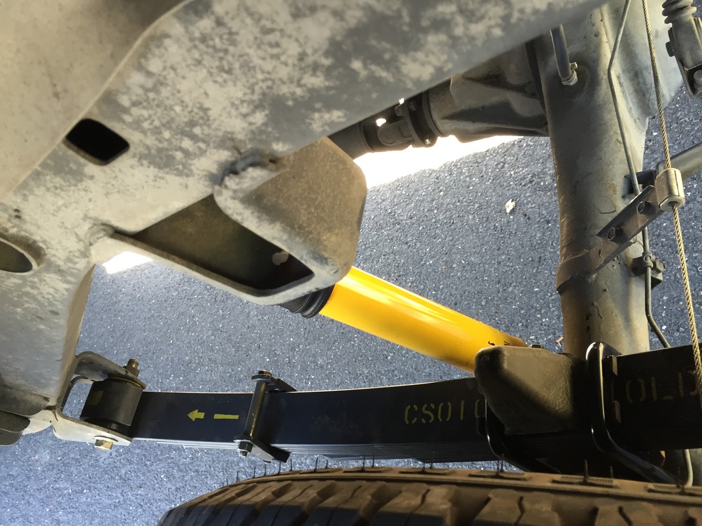

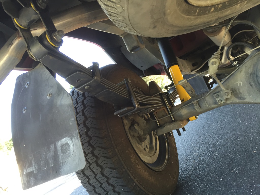

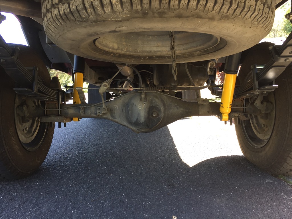

I put OME shocks and springs in the back. I went with the heavy duty springs because I haul a lot of heavy stuff and also plan on doing a heavy overland bumper with a spare wheel and Jerry cans. Its a bit bumpy, so I have to keep some bags of concrete back there till I add some permanent weight. The advertised lift was only 2.5" but it seams like I got a lot more.
I have some new torsion bar adjustment bolts, as well as some OME shocks to go in the front. Im planning on doing that tomorrow. Id like to try and level the ride out a bit.

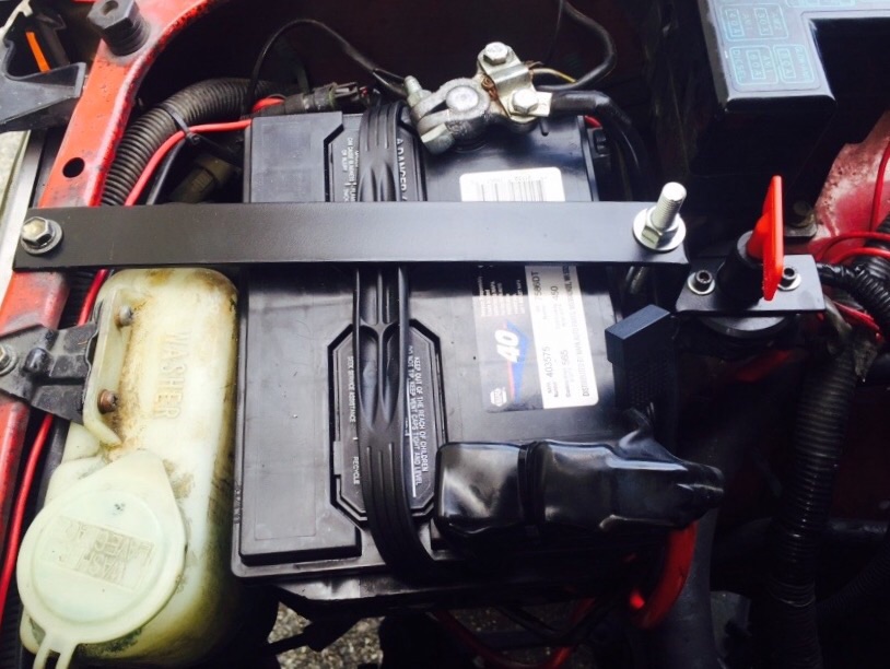

I made my self a new battery tie down today with my new to me drill press. I integrated a mount for a battery cut off switch.

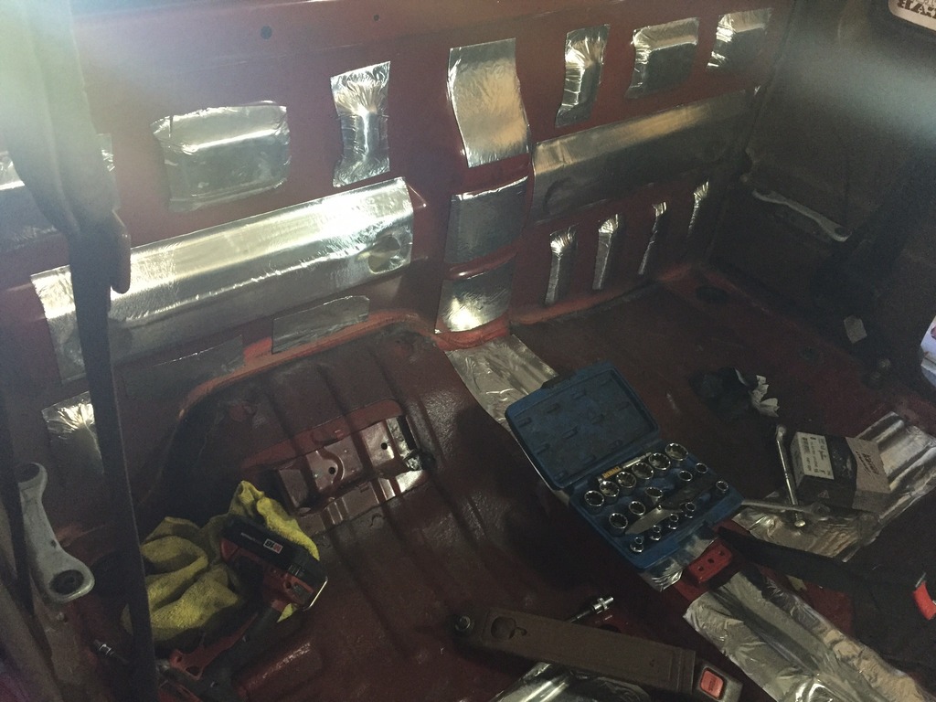

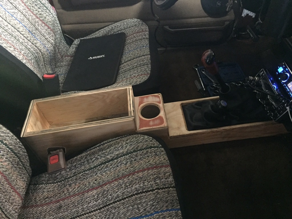

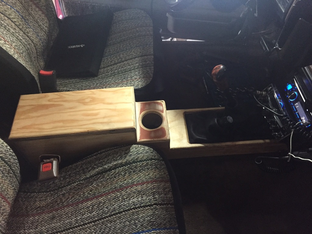

I did some sound isolation/vibration damping with some quick roof patch from the Home Cheapo. $7 a roll and it took maybe a roll and a half to do the cab floor, wall, and inside of doors. Its basically the same stuff as products like Dynamat just way way way cheaper. Tar based mat with aluminum backing.
Now the doors go thunk, instead of clang and it has cut down on some cabin noise and metallic vibrations. Still no where near Lexus or BMW quiet of cores hahahahaha
I also cut out the loud ass Magnaflow glass pack and replaced it with a cheap OEM stile muffler. That REALLY cut down on noise.
Then I made my self a new center consul out of some plywood. I still need to grab some piano hinge for the lid, and maybe some foam and leather for the lid to make an arm rest. Added a cup holder that fits paper coffee cups very nicely. Might make it a bit bigger for larger drinks.

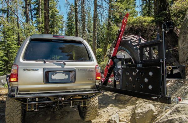

Just ordered my first part for my rear bumper build.
A Trail Gear rear bumper.
I would have loved to build everything my self, but I cant afford a pipe bender right now. Kinda crazy that just the die from JD2 is almost $400!!!!
I know its a great bender, but I cant spend that kind of money and not make money back from the tool. At some point when I own my own house and garage Ill buy one. Id like to produce limited numbers of DIY bumper build kits for people that can fit and weld, but dont have the space or tools to bend and notch for them selves.
So my plan right now is to use the Trail Gear bumper as a base platform to build something like this. With the tire on one side, jerry cans on the other, and a small fold down table on the back that can be used in camp when the truck bed is open.

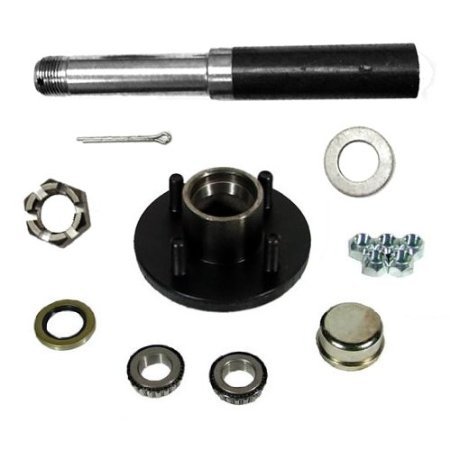

Im going to use a 2000lb weld on trailer axle and hub for the pivot point.
I kind of have a very broad idea of what I want and how to put it together. I need to come up with a solid plan, do some drawings and find all the hardware I want to use.
