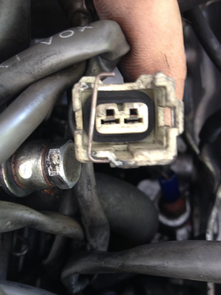

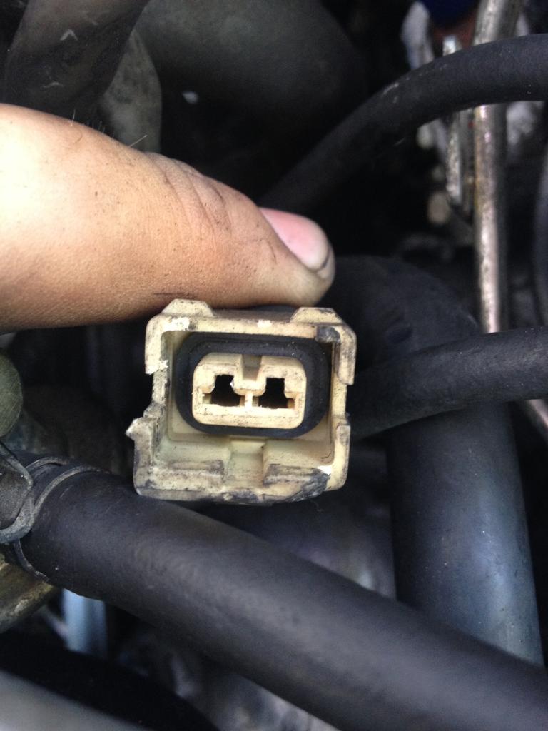

I think I found the problem. The friend who helped me out was the guy who disconnected the fuel rail harness and he broke the fuel injector plugs badly. Never mind the plastic being broken, one of them does not even have the spade connectors in it anymore.
Plug for injector #4 with spade connectors intact

Plug for injector #2 missing spade connectors

So my question is this. If the plug for injector #2 is not making an electrical connection, would that stop injector #4 from working? I think it would sins the probably fire in banks ha?

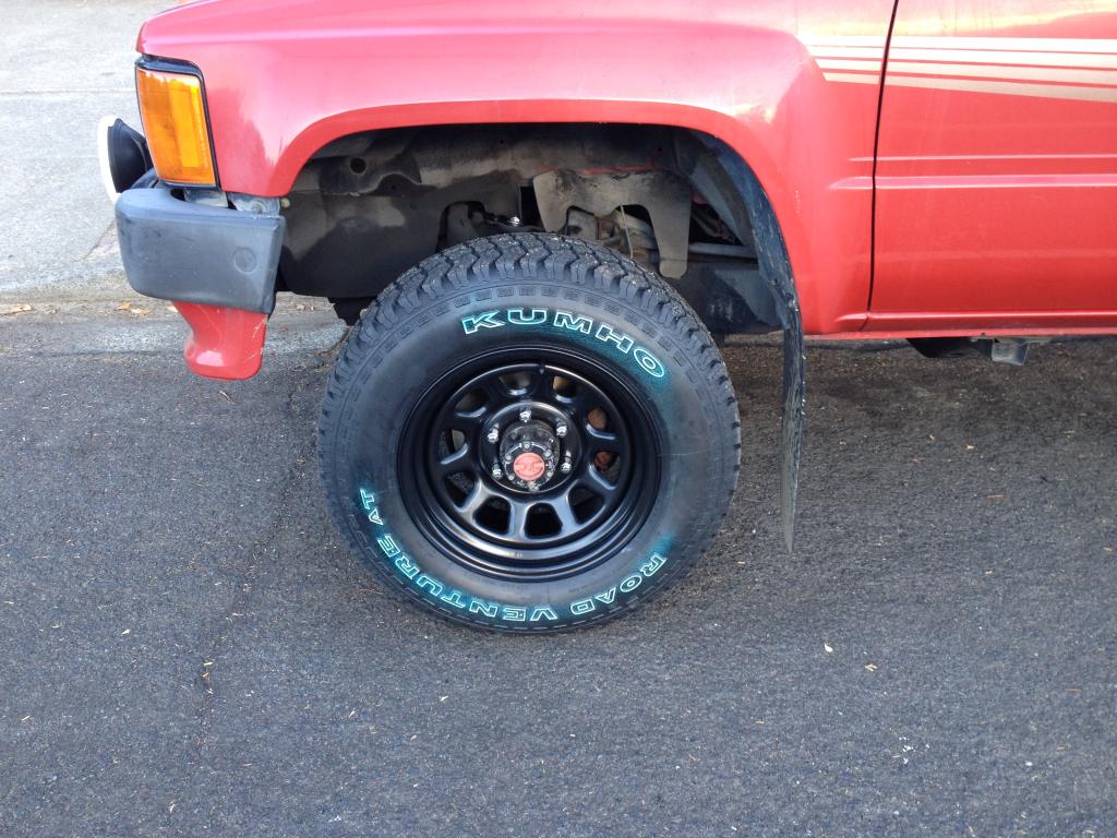

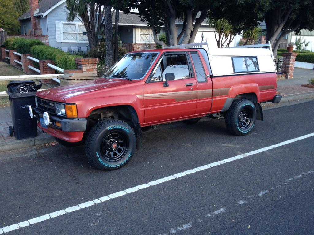

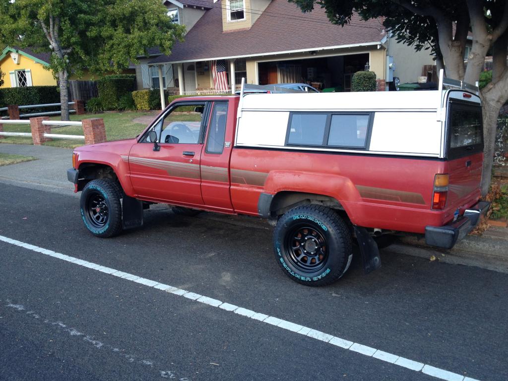

Got my new wheels and tires a day early
Not so happy about the lettering. I thought the letters would be white so I had them mounted facing out. Instead they were a weird turquoise and the paint is everywhere. I am going to have to clean that up some how.

That blue is a protective coating that will scrub right off.

Oh good. Iv never had a tire with that stuff on it before.

Often the place that mounts the tires washes the blue off for you.

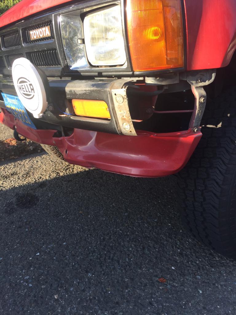

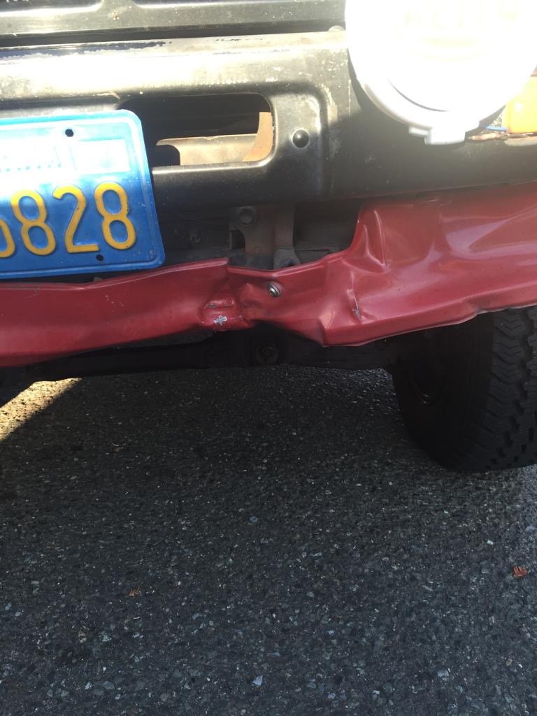

Well a bit more bad luck with the truck, mixed with bad driving on my part.
I had a bit of a fender bender in traffic. No huge damage to ether truck (I hit a Chevy) besides a bent ball hitch on his end and a round dent in my lower valance and hurt pride on my part. He never reported anything to his insurance company ether.
I should off had an ever bigger space in between my truck and his. I already had a good space, but it just was not enough braking distance for the truck. Would have been for my tiny BMW. Now I know.
Anyways I ordered a nice tube bumper from Trail-Gear. I need to get it painted and mounted tomorrow. Should spiff things up a bit.
The engine is running great. Only strange thing is it seams to be drinking coolant. I cant find any leaks. Its not bad, but I have to add a bit every 3-4 weeks. Oil is doing fine, I check it all the time now hahaha

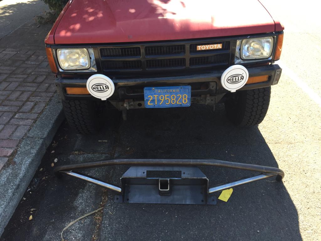

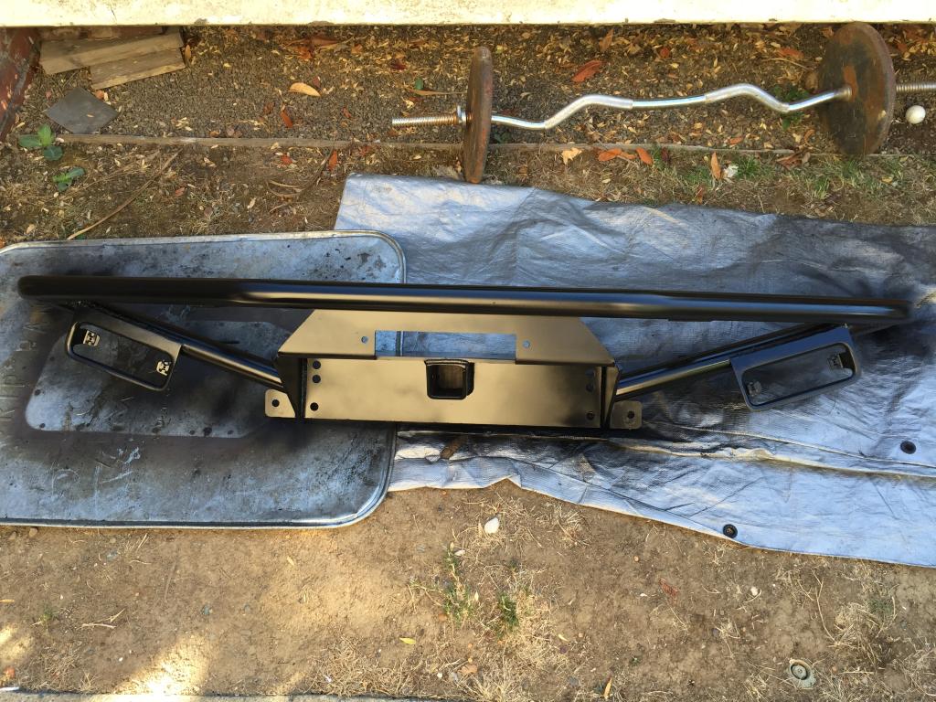

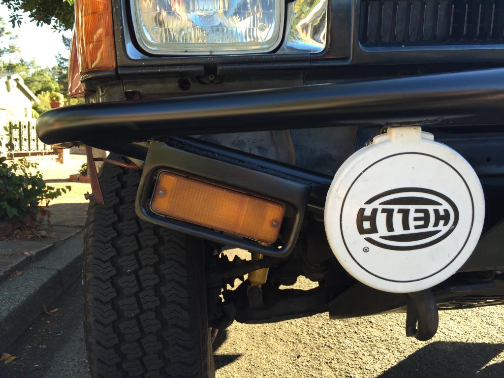

I did some work on the new bumper today. I like it.

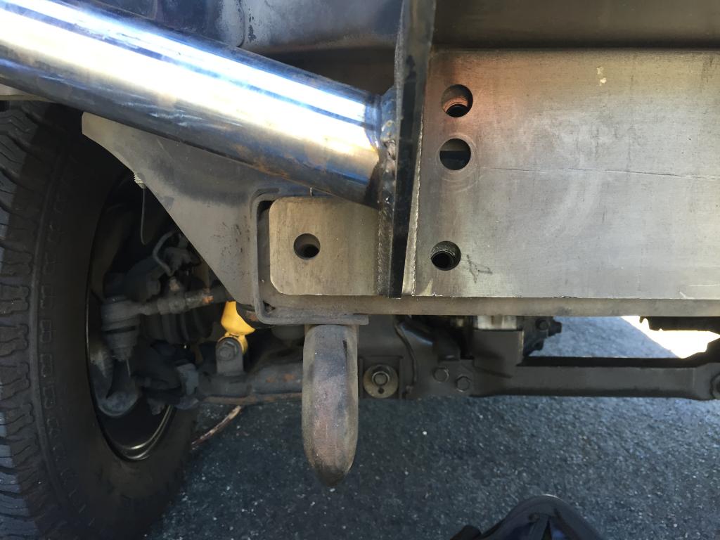

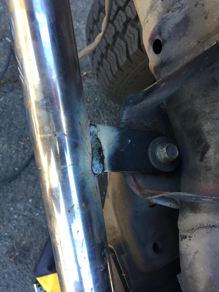

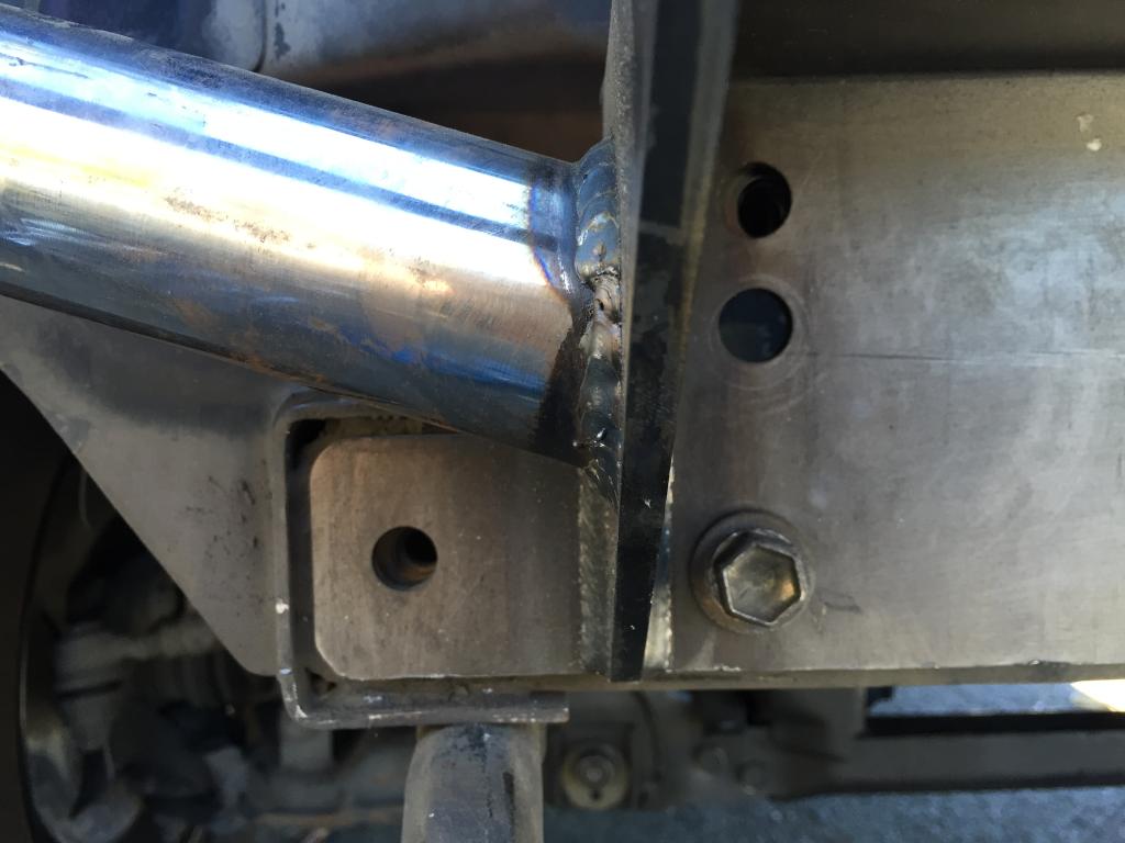

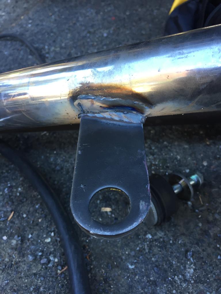

Its a Trail-Gear bumper. All the welds are really nice, but the mounting hole locations are a bit off. I dont know if its my truck or their work. Some of the holes line up fine, but others are off by a lot. The two tabs that stuck off of the back and mounted to two point above where the old bumper used to be were so off I had to cut them off and weld them back on again. This got all the holes a lot closer, but I still have to take my die grinder to a few of them to get the bolts to fit through correctly.

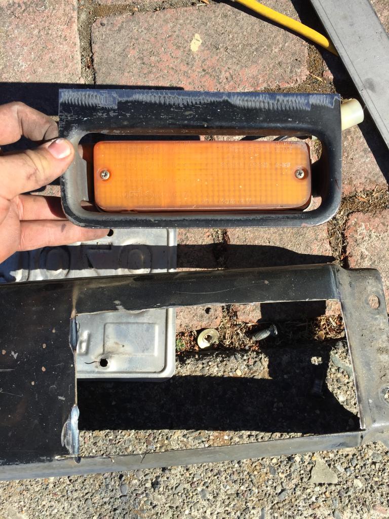

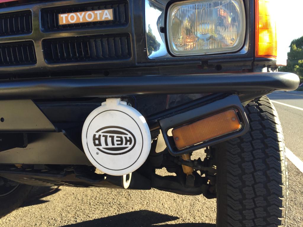

I cut the mounting locations for the turn signals out of the bumper, modified them a bit, and welded them to the bumper. I also added mounting tabs for the fog lights. I think it turned out well.
These are the tabs I had to cut off and relocate.
Here you can kind of see where they used to be. They moved up about 3/8" Id say. Excuse the messy welds I only had flux care around because my friend left my tank on and all the gas leaked out. Not happy about that.

This was after. Definitely closer.

Here are the turn indicator brackets I made out of the original bumper.

Also, that weird bluish lettering will wear away, leaving the white you wanted.
To speed the process, wash the tires with warm soap and water, pat dry, then scrub them with a brush coated in bathroom bleach! Not straight up bleach, but bathroom bleach, the stuff that comes in the spray bottle. That should do the trick.. Repeat later on for BRIGHT WHITE.
