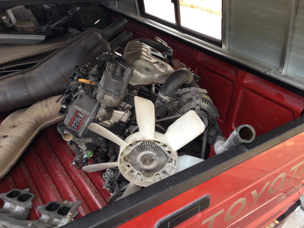

I picked up my replacement 22re today. Looks clean. Havent done any tests on it yet.
Who makes good replacement gaskets? Preferred brand?
Not not going to do the head gasket but Ill do the oil pan, valve cove, and a few other easy ones while the motor is out.
I managed to slide the 22re into the truck from the back of my BMW station wagon with some 2x4 haha

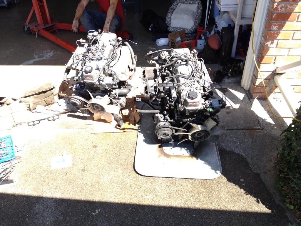

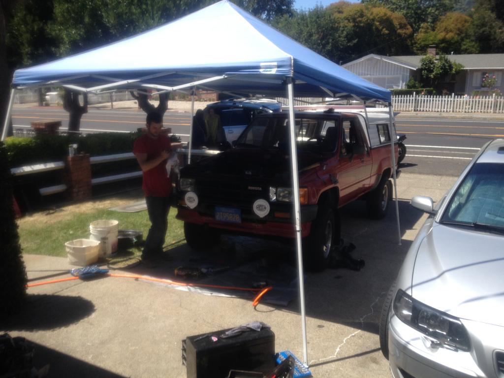

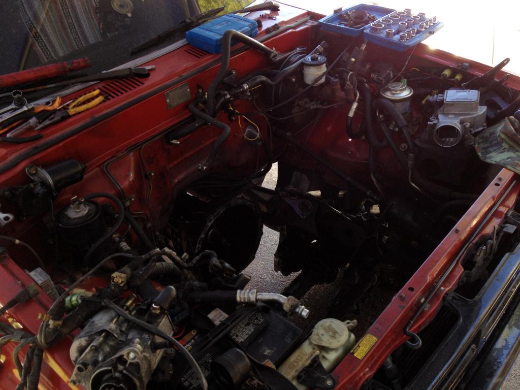

My friend and I got a lot of work done on the Yota today. Yanked the dead motor, and moved the manifolds and the accessories from the dead motor to the newer motor sins the '93 stuff does not match the wiring harness on my truck.
We should get the newer motor in and running tomorrow. Today went smoothly.
I didnt really take any pictures sins I got into the work. You guys have seen it before anyways.

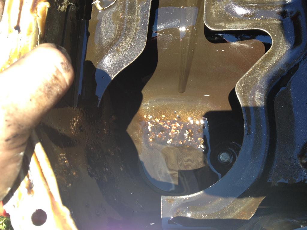

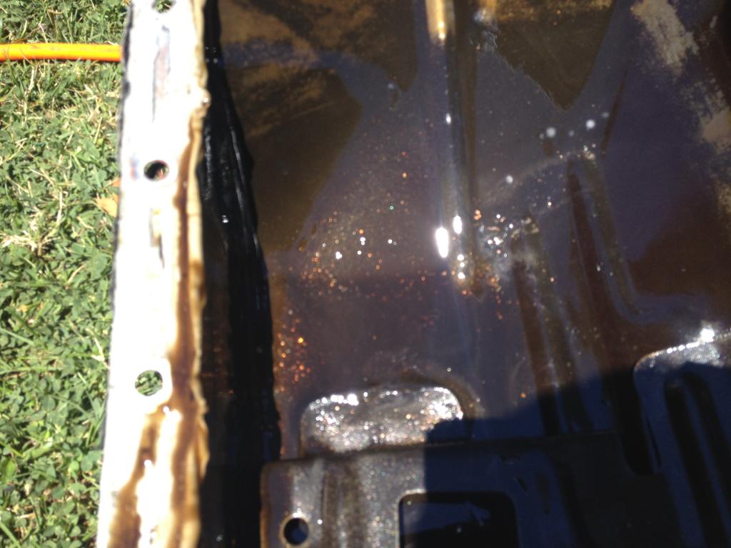

Here are some metal flakes I found in the old oil pan. Looks like I struck gold.
