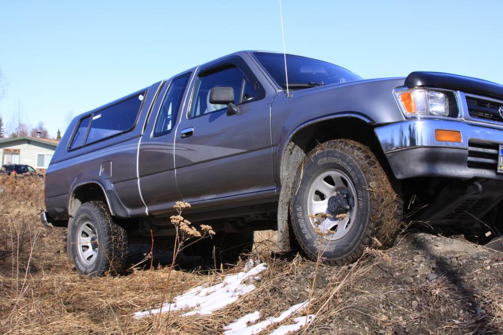

hey everyone, dont expect too much. but im plannning to sloooowly build it. lots of research and what to add on to my new truck.
93 toyota pickup v6, auto tranny.

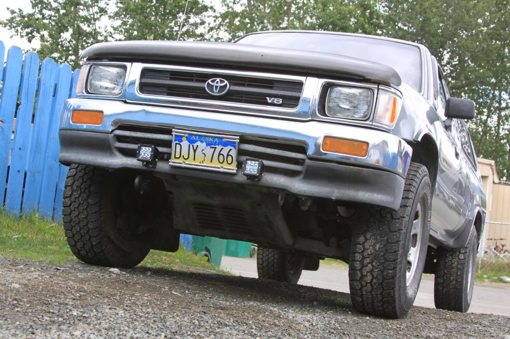

Talking Dually d2- RIGID INDUSTRIES LED LIGHTS INSTALLED

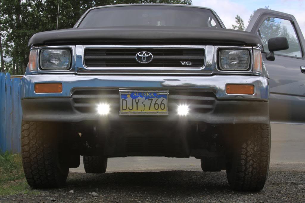

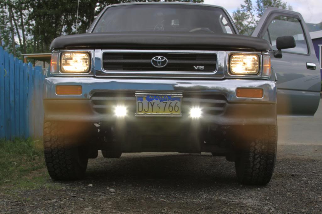

So after replacing the rusted old muffler, today i purchase some new lights.
I want to start with Mods that well be more of performance rather than cosmetic looks.
these little lights are sweet....well tested during daylight so far.
they're the Dually D2. 2600 lumens.
just mounted them on the bottom bumper rails.
Installation was easy, basic plug n play and fishing wires around..
although i took about three hours, taking my sweet time, and a quick lunch break.
$360 for the pairs.
you guy have any good recommendation for replacing the Regular headlights, would like something brighter, pure white ..about 5000k
pics for now, maybe a video soon,, if Alaska gets dark!

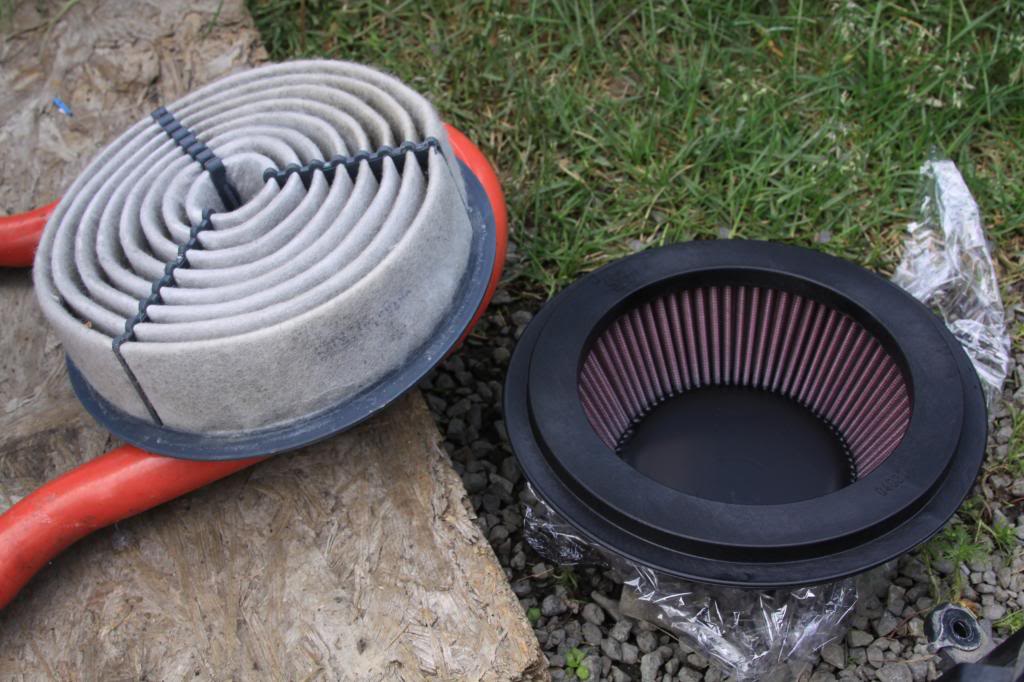

Update: had free time agian ,& decided to do the free air box mod. Removed the sleeve ,drilled a few holes and installed a K&N.
much more better throttle response now.
I really really would love to lift the truck , but at the moment I'm still learning on what to get and where,brands and such.
Anyone point me into the right direction?
I have a handy brother who can help me install a full kit,
Budget would about $1k on a full lift kit.
Looking to lift no more than 3-4"
No crazy rock climbing or anything. Just something lift enough for some bigger tire for some offroad hunting ,mud & potholes that may encounter and get stuck. Small creeks,river that may have to cross.
The truck an automatic, so I don't plan to put any to big tires. 33 shall be fine ey ?

Just an idea for the lift (what I would do) BJ spacers in the front, either Zuk mod or 3" to 4" lift leaves in the rear with new shocks, this will fit 33's. Then source some factory 4.88 gears from a junk yard (door code G144). Also wouldn't hurt to add an aux tranny cooler.

Tested the lights yesterday & they were really nice and Brigten the streets. Could be position a bit higher , but oh we'll for now.

Dont lift it, get some 33X10.50s. Use a BFH to pound out some of the pinch welds. Or if you want 12.50s buy some wheel spacers.
488 gears would be great if you can find them.
Buy good shocks, bilstien or foxs. Low pro poly bump stops.
This will improve you ride and you will get a small lift from the tires.

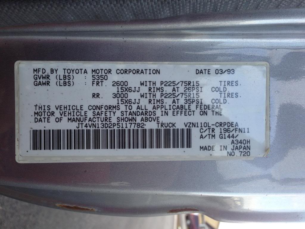

Her birth Certificate
There it is. Tell me what I have .

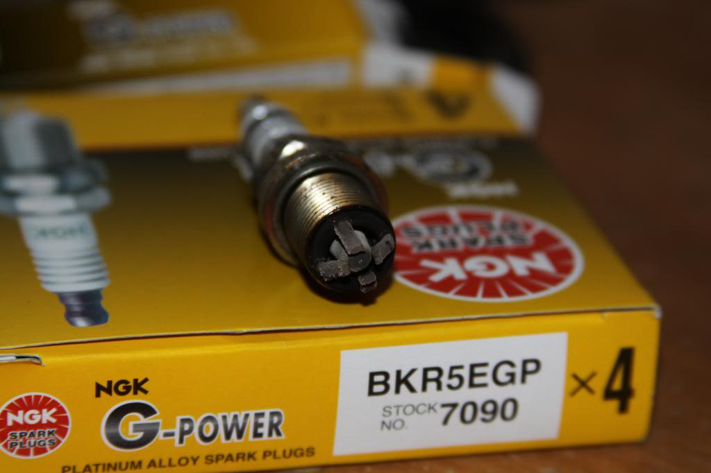

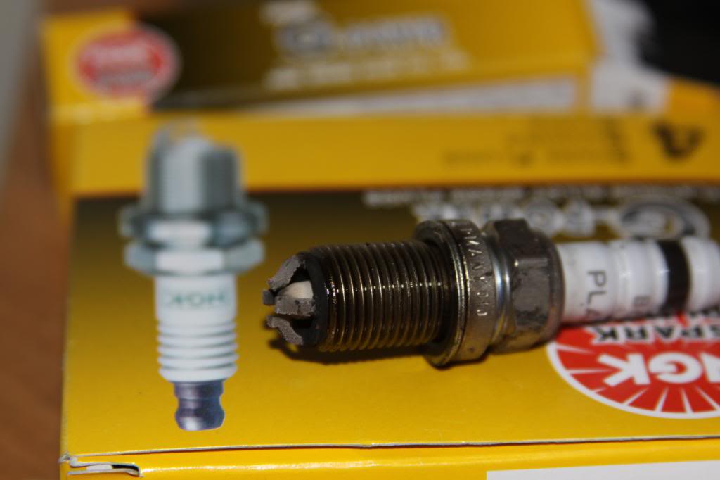

Also changed out my plugs yesterday. The Bosch were toast. Threw in so new NGK, she felt a bit better on the throttle response-. Also thinking about doing a coolant flush and brake fluid flush.

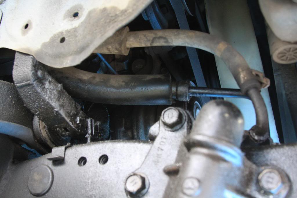

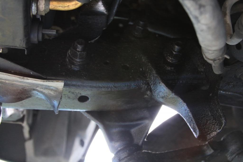

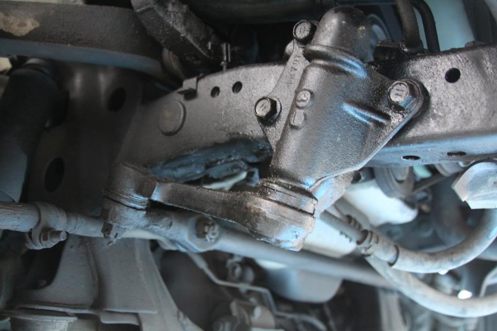

here is that leak i am talking about, front left side?...
anyone know what it can be? doesnt smell like transmission fluid.
could it be the power steering fluid?

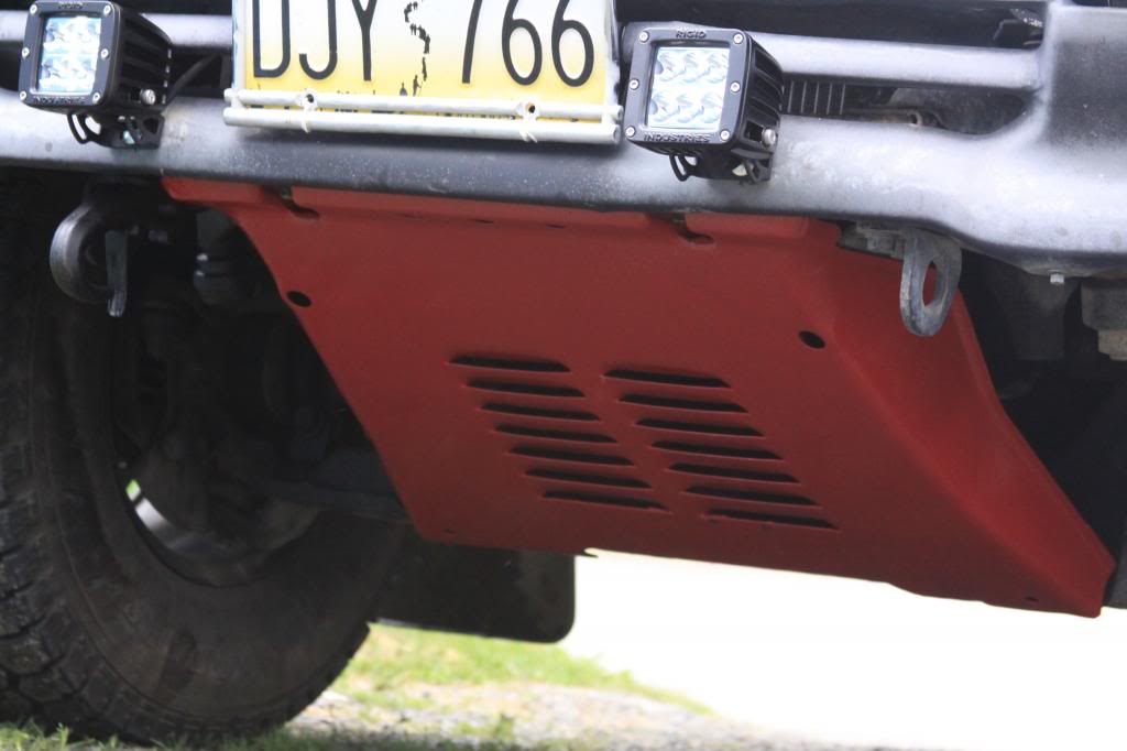

meanwhile taking out the sway bar, a red rattle can on the skid plate. for a nice touch up.

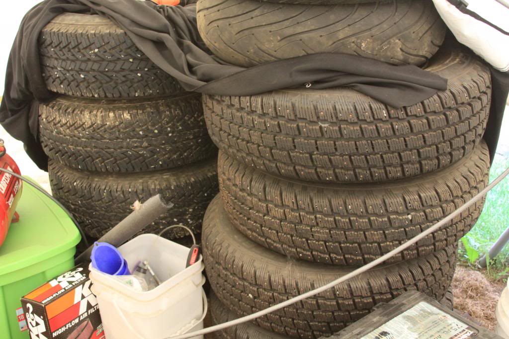

my stash of tires, set of reg tires & set of studded tires.

what the old plugs looked like..

I don't think there's anything over there that could leak besides the tranny lines to the radiator. I could be wrong, specially if its a manual. But I don't think ps is on that side, and there shouldn't be anything else. Unless mayyybe the charcoal can?

OK
A/M
G144
G 8 in diff, 14= 4.875gears, 4 = 4pinon open diff
so 33x 10.50 should have no problem
all the diff info you could ever want
http://www.brian894x4.com/Gearratiosanddiffs.html

That's awesome that you got 4.88s from the factory. I thought only 4Runners got them.
