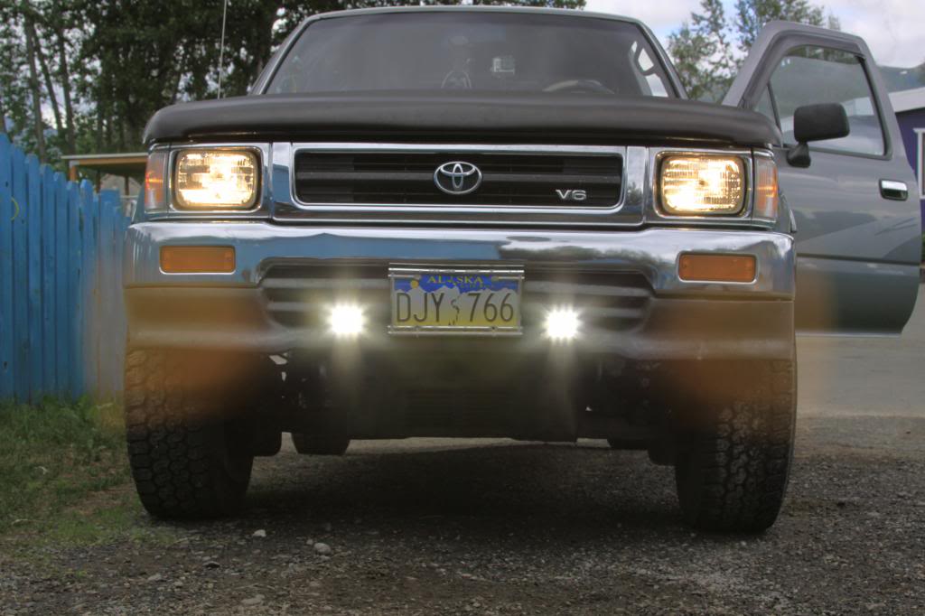

finally some pictures to add to this thread.
well my new 33x12.50 tires came in.(m.t baja claws tic)
$937 SHIPPPd to Alaska in 3 days. love Amazon
had to cancel the OME sd33 stabilizer cause they were on back order for like 6 weeks, so i think ill just wait till Jan or something.
the Blistein HD shocks will be here this friday, and i be installing them this sunday, if the shocks somewhat helps clear the 33's then, i wont be lifting it, but if they don't.
I'll or oder the springs and do the Zuk and 1.5" bj spacers..
what cha think? and yes need to find a BFH to do some pounding.
20% tinted
