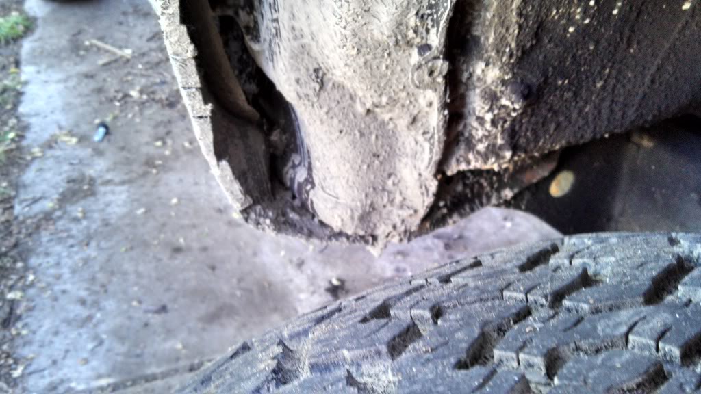

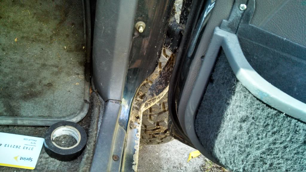

Just sharing with you the reason recommend getting some inner liner for your front wheel wells.

Yup. That's what mines look like right now. I'll deff find something to line it up.
