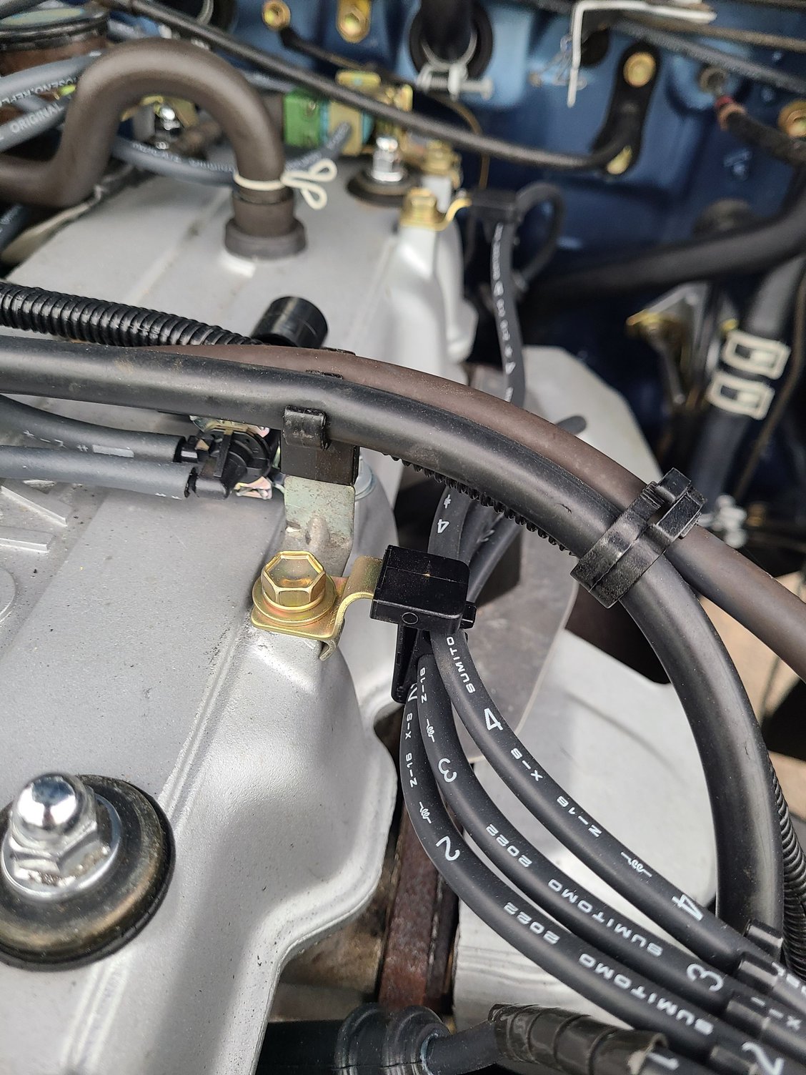

The engine bay is finally looking good:
I'm still taking care of a few other miscellaneous things with the parts I have on hand, while waiting for my $700 order to ship from Amayama...
Thanks to some awesome tips from @SomedayJ about how things were originally routed under the hood, I installed this clamp to hold the two idle up hoses together:
Next I replaced the aftermarket cruise control vacuum line with an OEM piece, and used a clamp to attach it to the air hose. Before:
Hose:
Clamp:
After:

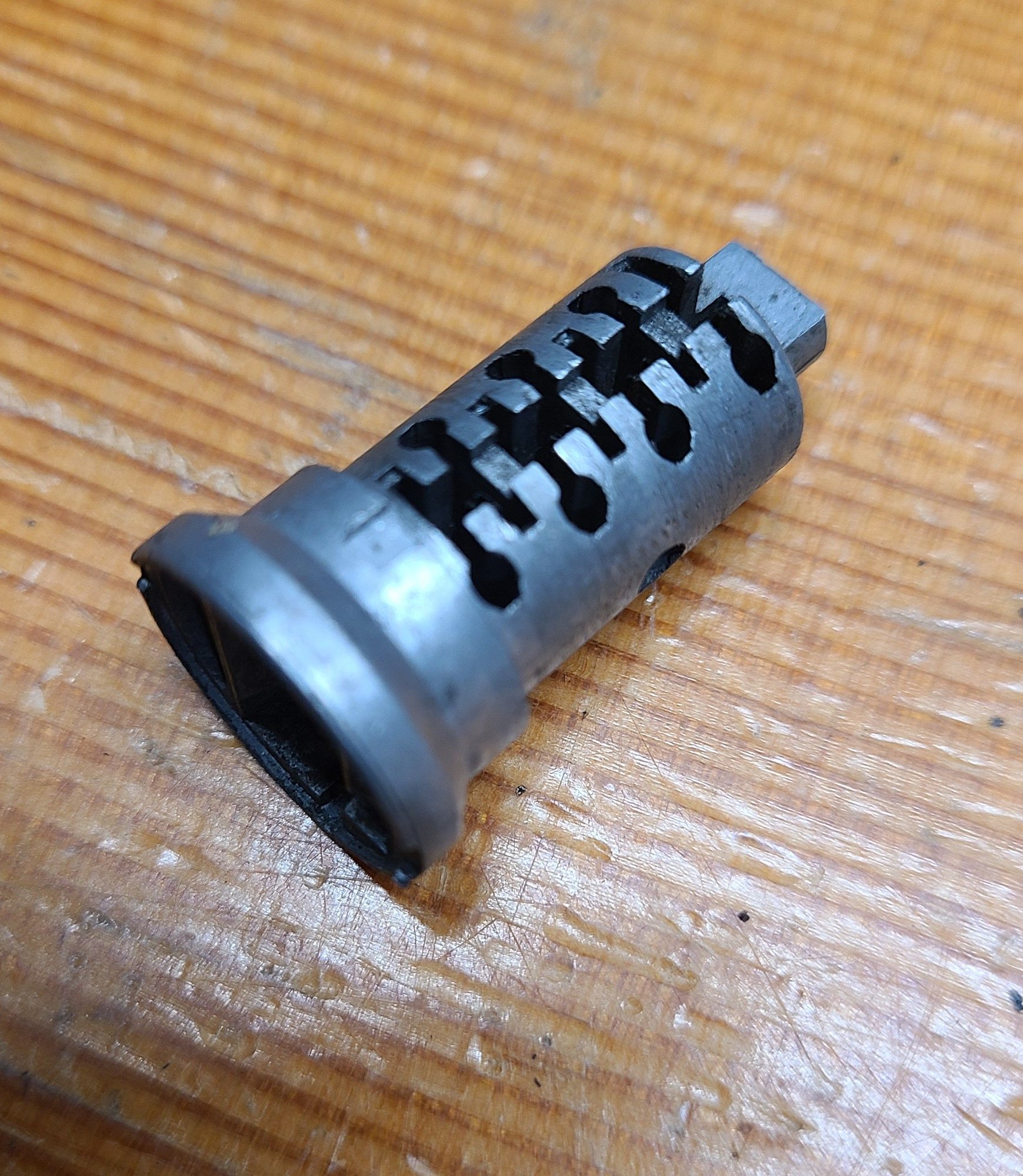

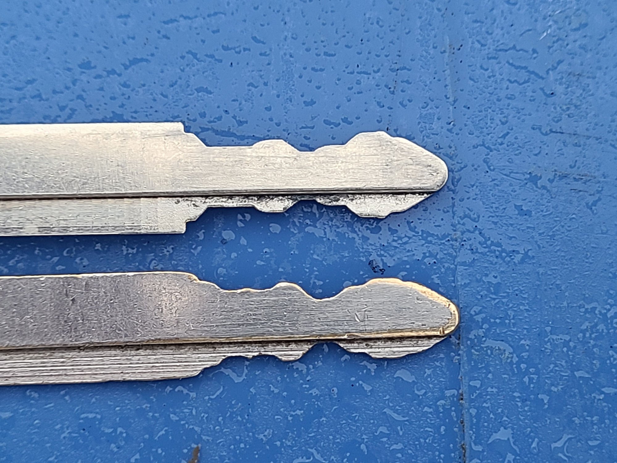

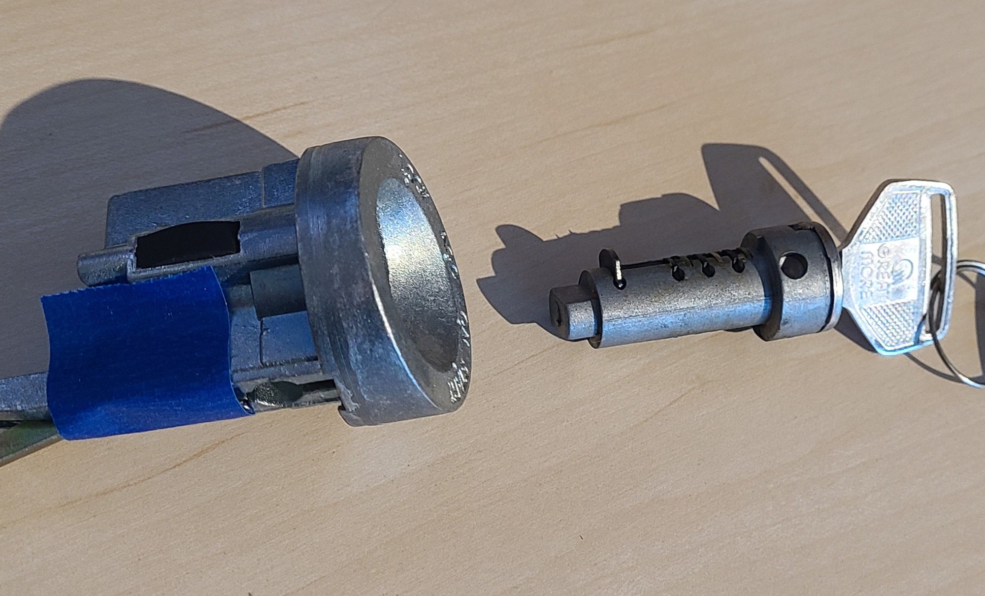

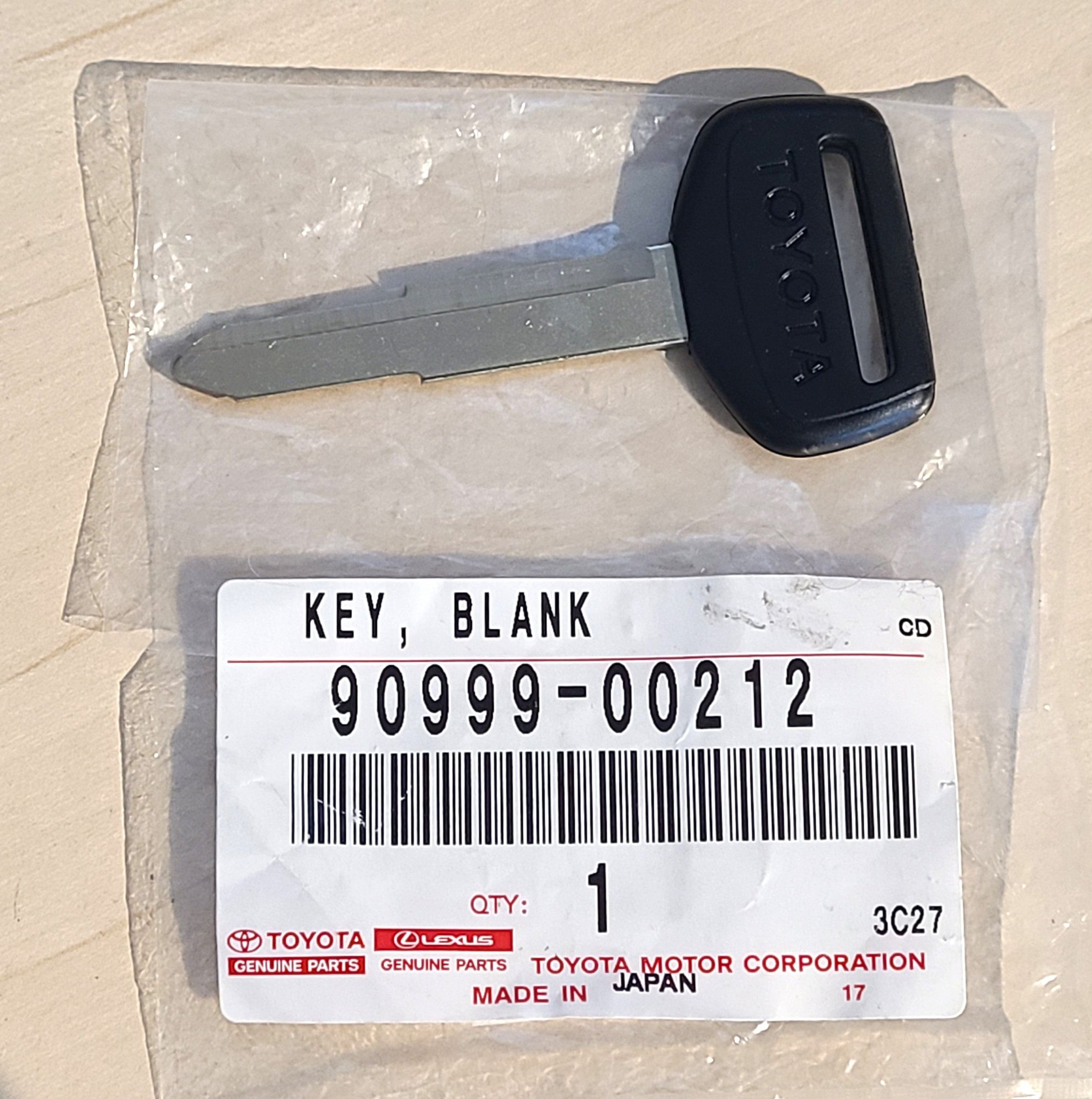

Without a garage, I'm limiting my work to benchtop projects. I decided to do something about having two different keys, one for ignition and a different one for the doors, tailgate, and fuel lid. In addition to not wanting to have two separate keys, I didn't like that could pull the ignition key out at any position - ACC, RUN, etc, which told me that the key or the lock was really worn out.
Here are the two keys, the worn one is for ignition:
I assumed that the worn key was original, but @Jimkola pointed out that it was an "S" series key, with an extra groove, and was introduced in 1988. My 1987 came with "K" keys, like the second one in the photo, without the groove. So that second key must have been the original.
Thanks to @Jimkola 's guidance, I bought a replacement ignition lock for my "K" key, ASP C-30-110:
But if I wanted the original key to work with this lock, I would need to recode it, using ASP A-30-104 rekeying kit. I bought one on Ebay:

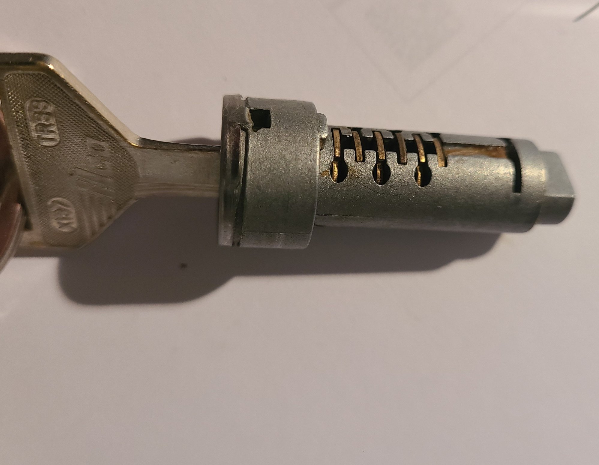

To disassemble the lock cylinder, push down on that lock wafer in the back of the cylinder, and slide the lock out:
I removed the wafers that the ASP lock came with, here are all the parts just for illustration (except the little plunger springs):
Now comes the fun exercise of trying different wafers with the key inserted, to see which one goes in each location. There are four wafer sizes in the kit, so you just need to find one that is flush on both top and bottom when inserted into a location. So for example, this wafer is too low:
And this one is just right:
Do this for each location, until all the wafers are in place and flush:
Now I knew what wafer numbers went into each location. So I took my brand new uncut Toyota key to the locksmith, armed with the wafer numbers, and the key code from the passenger door lock cylinder, just in case:
He cut the key to the code I provided, and it worked smooth as butter in the newly wafered ignition lock. But, I was surprised to find that the new key did not work well in any of the other locks - door, tailgate, fuel lid. In fact, the key did not work in them at all. More on that in the next post.

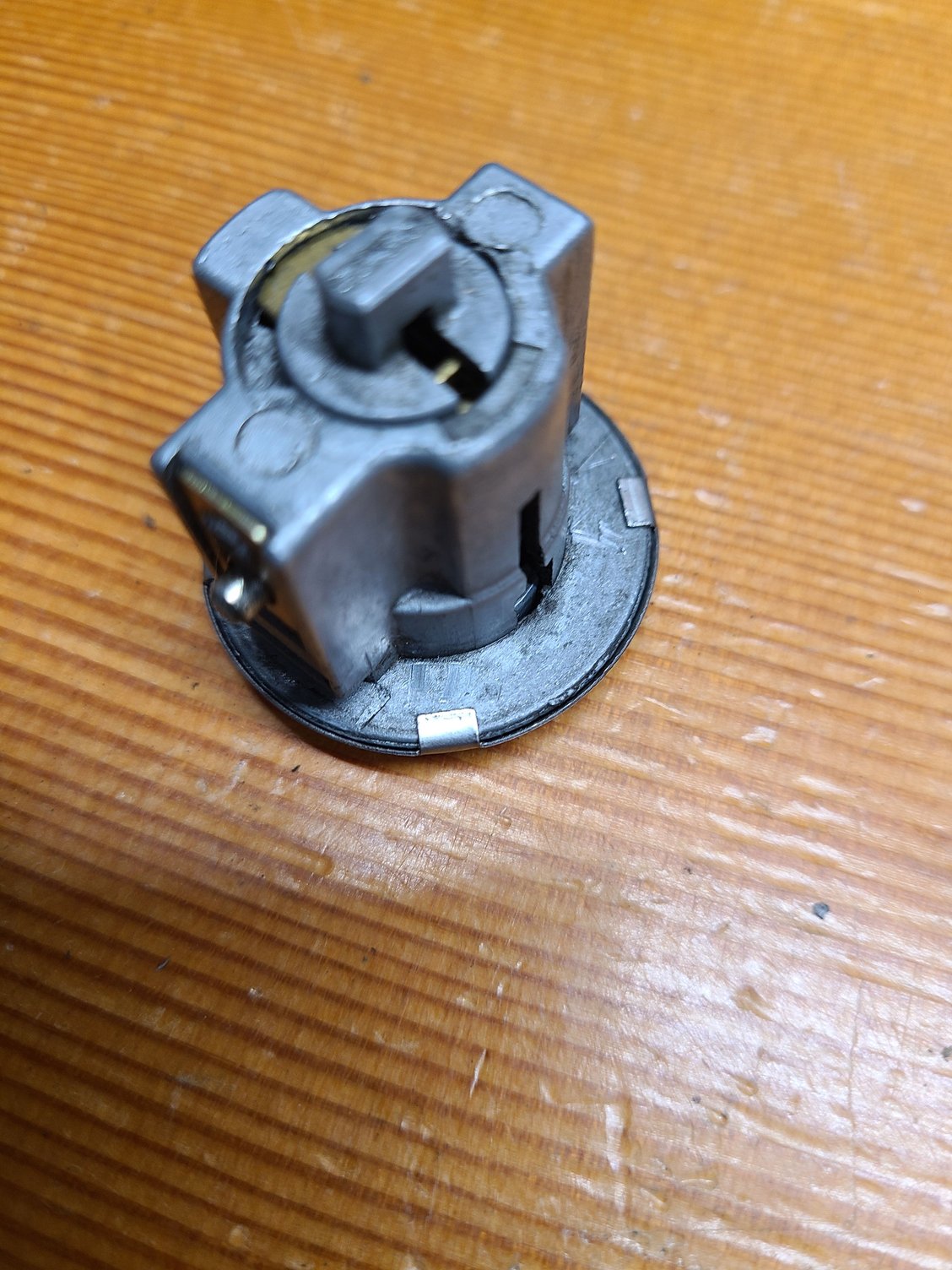

So as I mentioned in the previous post, the new key worked perfectly in the newly wafered ignition lock, but not in the door and tailgate locks. Looking closely at the new key and the old one I had for the door locks, they were clearly different:

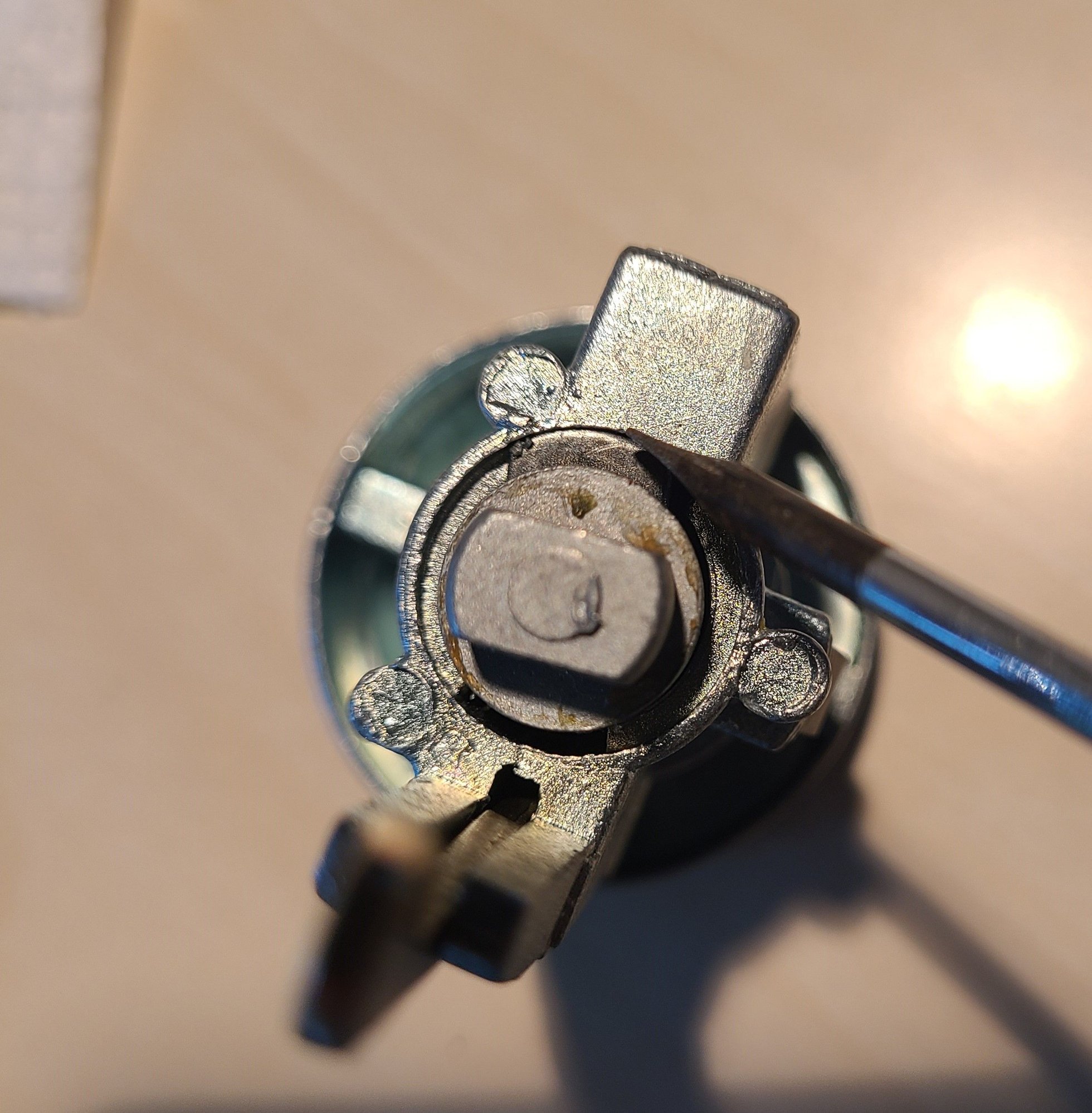

So I went back to the locksmith to complain, but he told me that this happens often, because the old cylinders wear down, along with the old key, so they sort of "wear in" together over time. But a brand new key does not have the same wear pattern as the old wafers, and thus would have trouble opening the old locks.
I was skeptical, but decided to try it out by re-wafering an old door lock. Lo and behold, the new key worked perfectly with the new wafers. So now I need to re-wafer all the other locks, and unintended consequence of getting a brand new key. Oh well, what else should I expect .
I pulled out the old ignition lock and noticed that it had a longer lever than the replacement, so the new ignition lock would not fit into the steering column:
I swapped the levers, and all was good. But I wonder why the levers were different length?
Regardless, I buttoned everything up, and started enjoying a new key/lock. and a key that does not pull out from every position. Life is good.

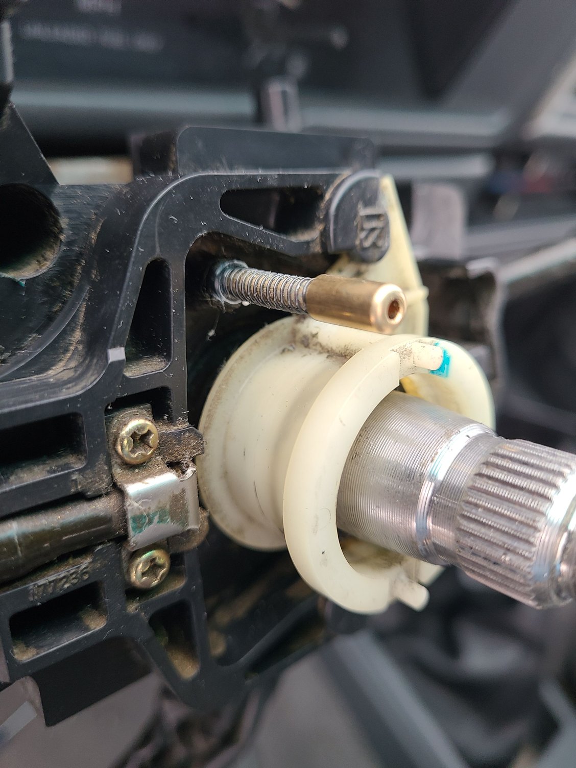

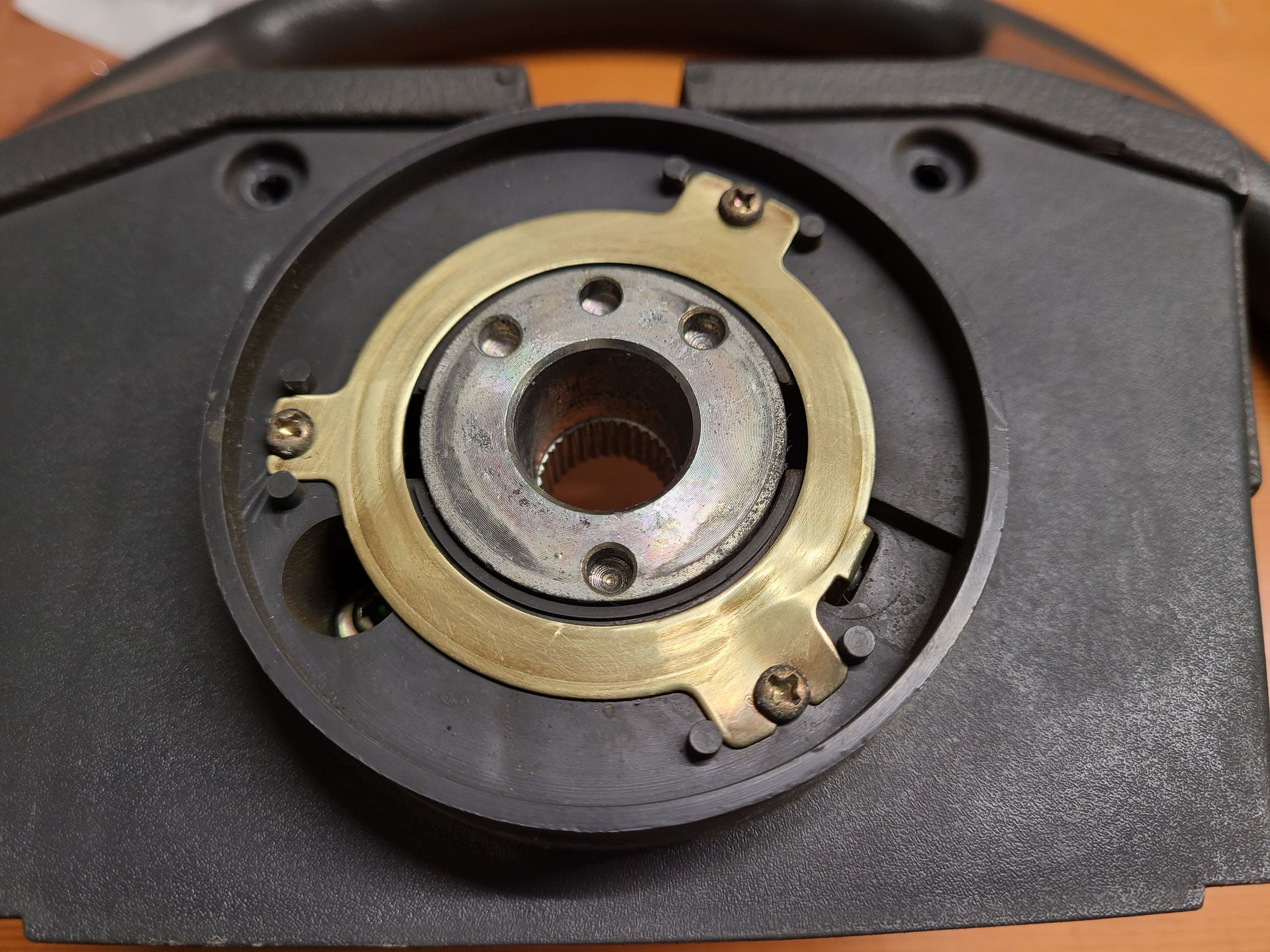

After a recent short drive where some idiot pulled out from a driveway in front of me, and I found myself pushing uselessly on a non-functioning horn button, i decided it was time to fix the horn.
Using @RAD4Runner awesome post on horn diagnostics, I quickly determined that the culprit was the horn contact plunger. So, I pulled off the steering wheel, after making matching marks on steering wheel and shaft:
I know one can remove the wheel by hitting/rocking it, but given how everything else on this truck breaks when I look at it (or even if I don't look at it), I decided to do it right and use a puller:
With the wheel off, I confirmed that the horn works by shorting the plunger to ground.
Sure enough, that resulted in the horn working, as anemic as it might be:
I previously purchased the replacement horn contact:
But the replacement turned out to be quite a project. With the steering column covers removed, you can see the back of the plunger, along with the e-clip that needs to be removed:
I considered briefly using needle nose pliers to remove the e-clip, but figured that I will most likely drop the clip and end up with a mess on my hands. So, I did it the hard way, removing the combination switch, then disassembling it until the back of the plunger was accessible:
After removing the wire from the stem, and the e-clip, the old plunger came right out:
Comparing it to the new one, yeah, I guess it shows some wear:
I also cleaned to contact ring on the back of the steering wheel:
Then I noticed that the terminal on the steering wheel wire was cracked, so I replaced it with a new one:
Here's the new plunger with the combination switch reinstalled:
Old Apr 4, 2024 | 07:29 AM
  #131
4Runner4Leon's Avatar
5 Year Member
Joined: Dec 2017
Posts: 231
Likes: 192
From: Portland
With everything back in place, I found that I can use the horn but... only when I press on certain areas of the horn pad. So I examined the horn pad a little closer, and found that it was severely deformed, probably from someone desperately pushing hard on a non-working horn. So some of the four contacts were too far apart to close when pushing on the horn pad, leading to one side of the pad not working:
I don't have any photos of the process, but I straightened the plate, and the horn now works with a light touch anywhere on the horn pad. Yay! So now I know confidently that I can honk in an emergency (I hate using my horn in general), and will get some attention - if not in awe, at least in amusement.
On to bigger and better things.

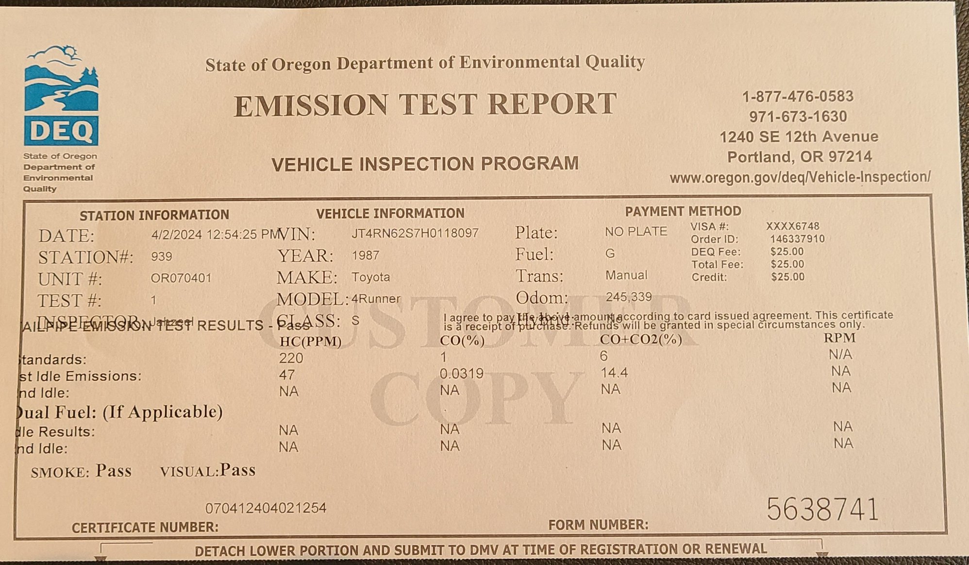

Went to the Oregon Department of Environmental Quality station last week to get the truck smogged, no issues. What a pleasant surprise .

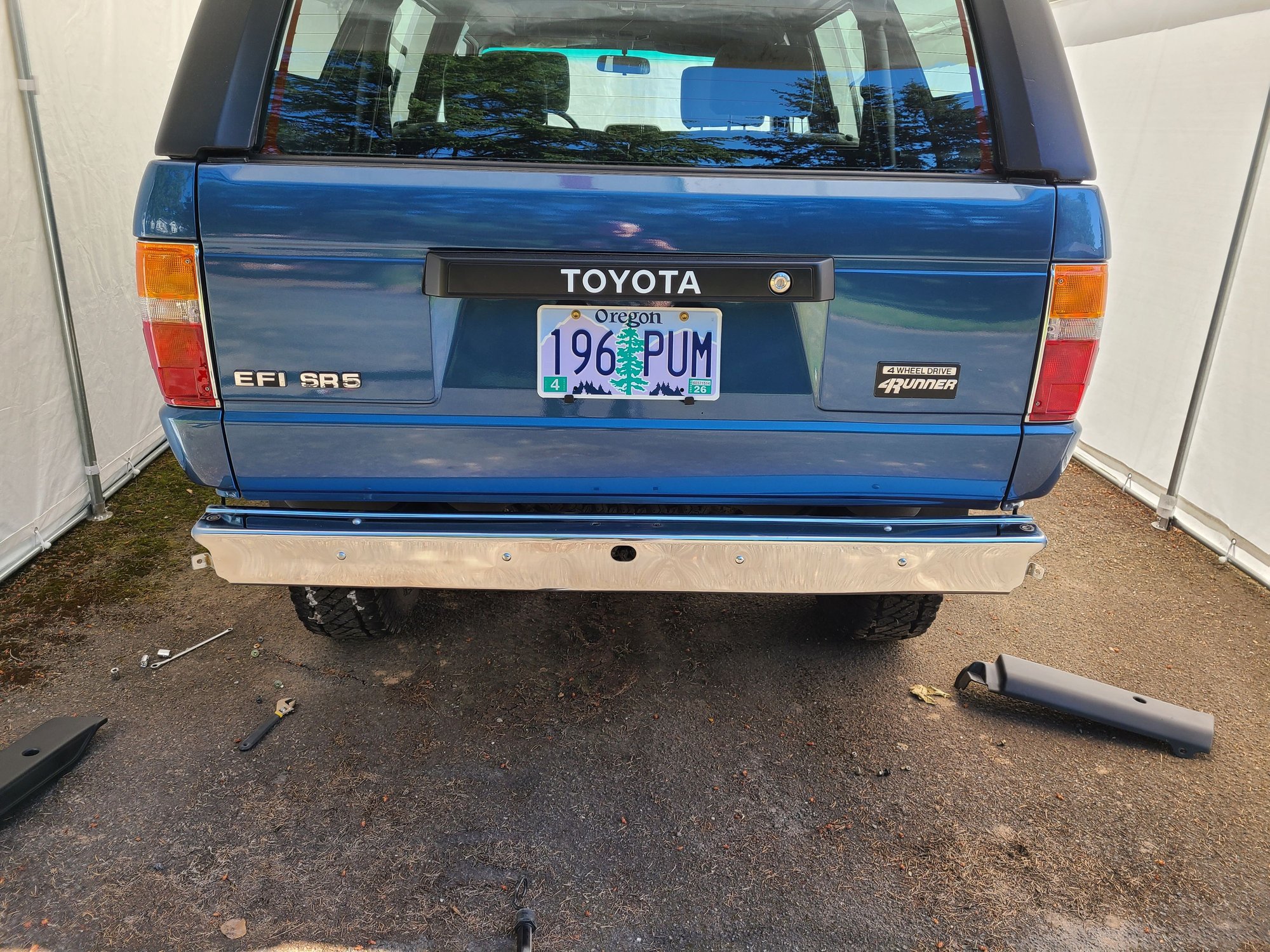

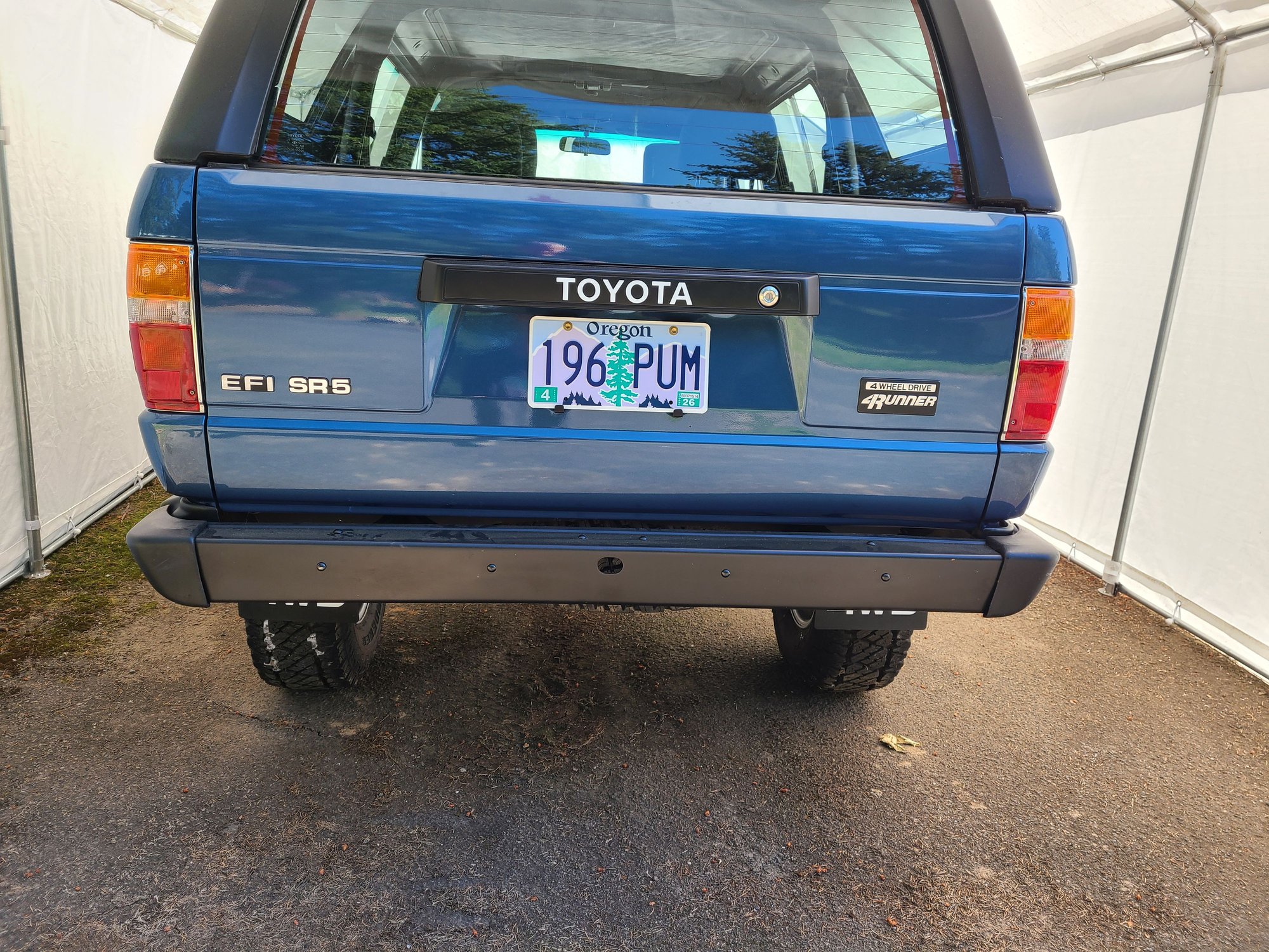

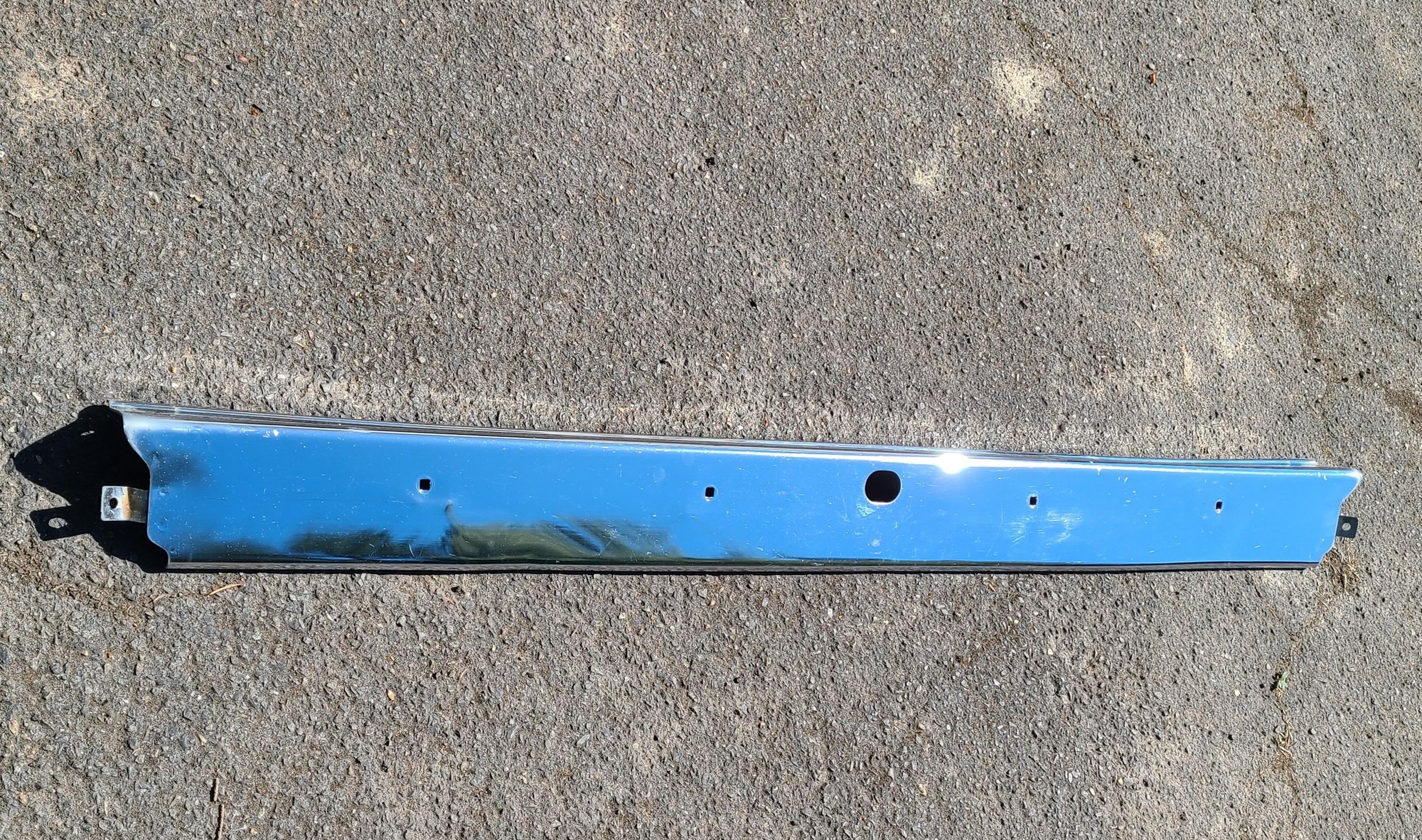

Picked up a nice OEM rear bumper from a great guy up here in Portland. Not perfect, but good enough as a placeholder, and way better than that fiberglass bumper the truck came with. Very happy with the chrome look!

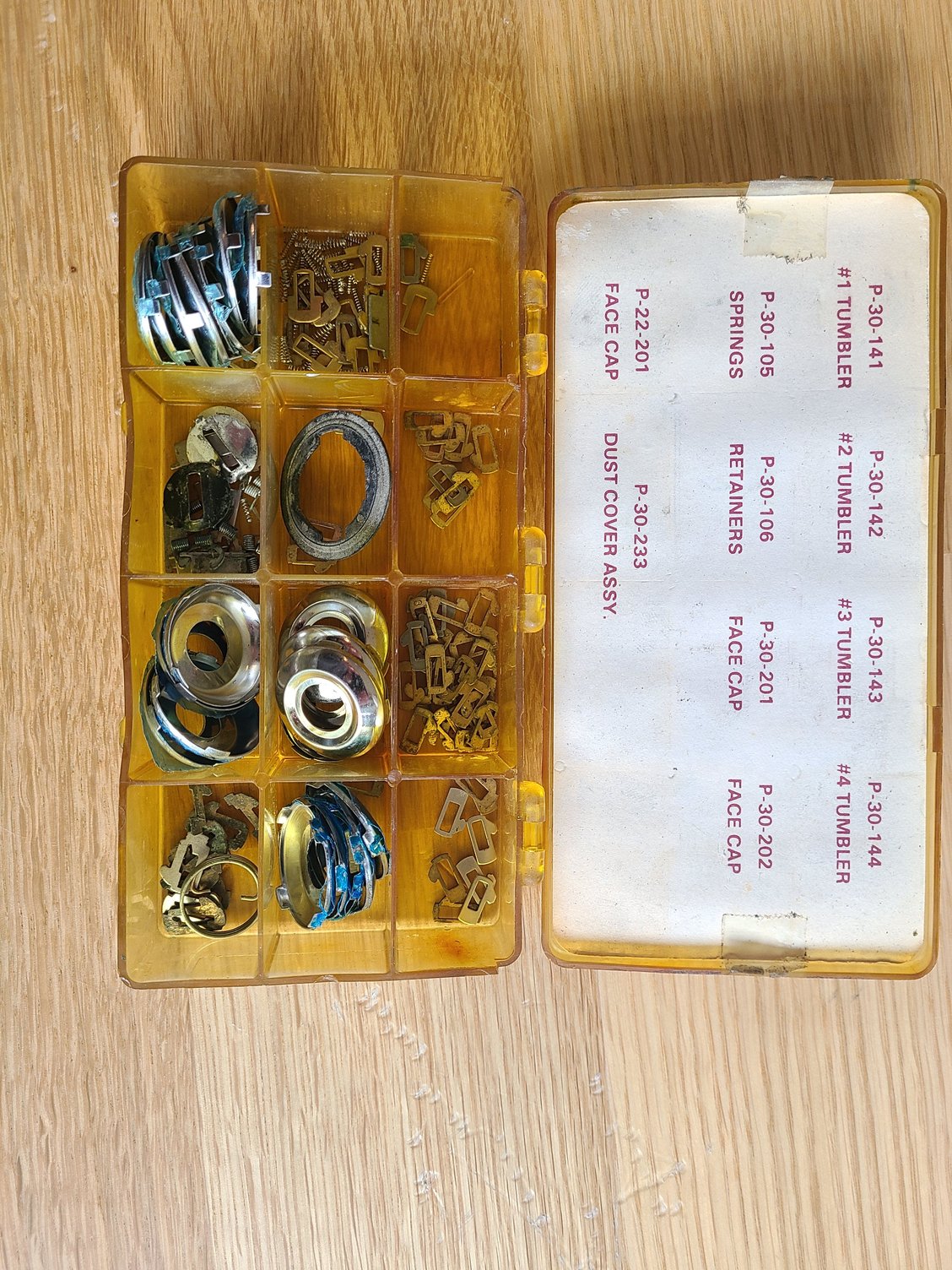

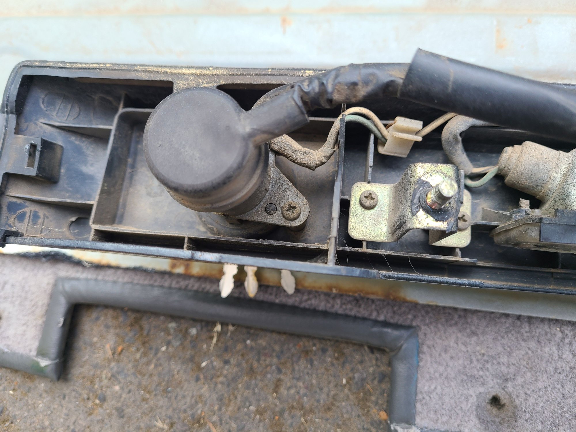

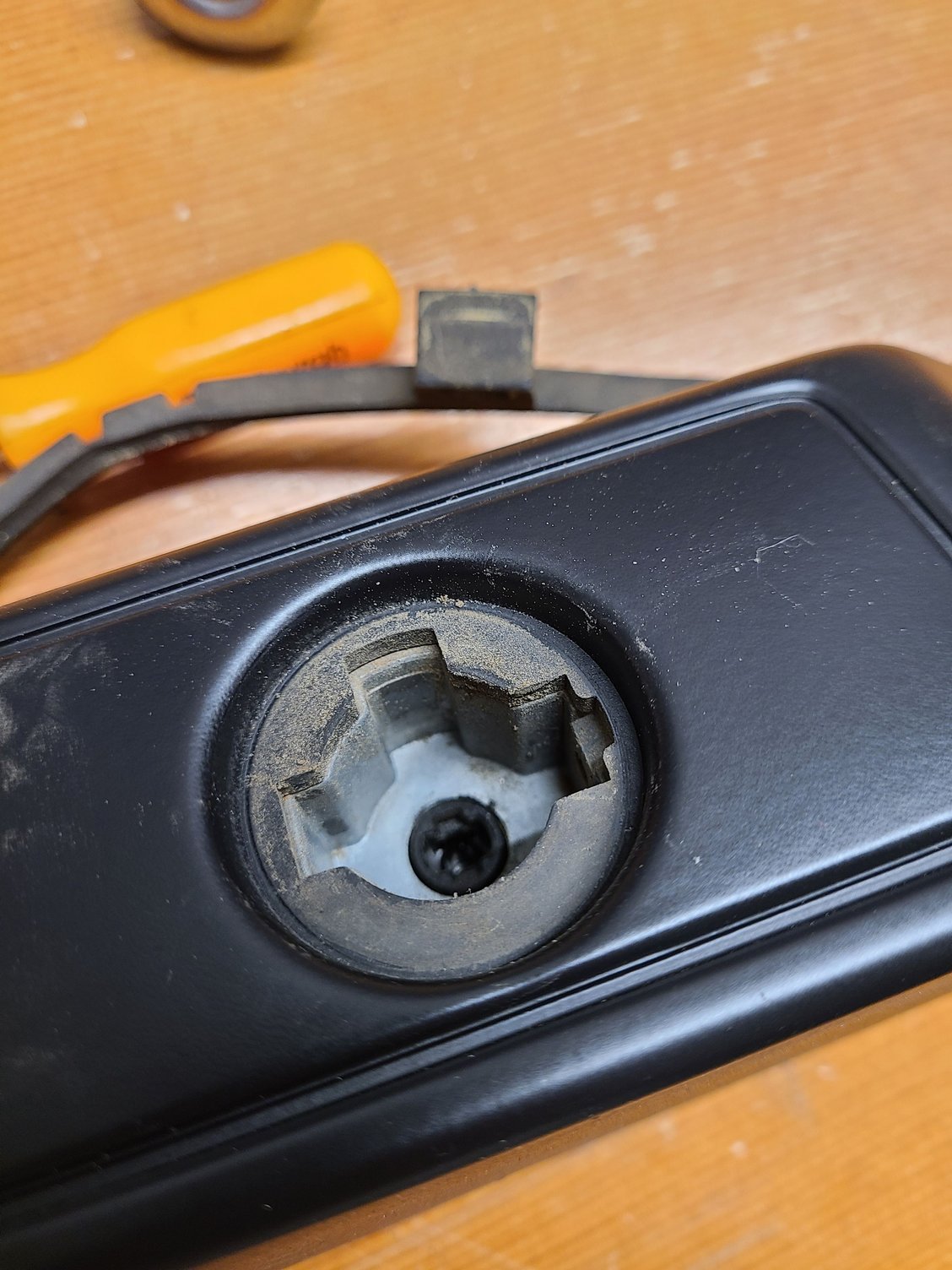

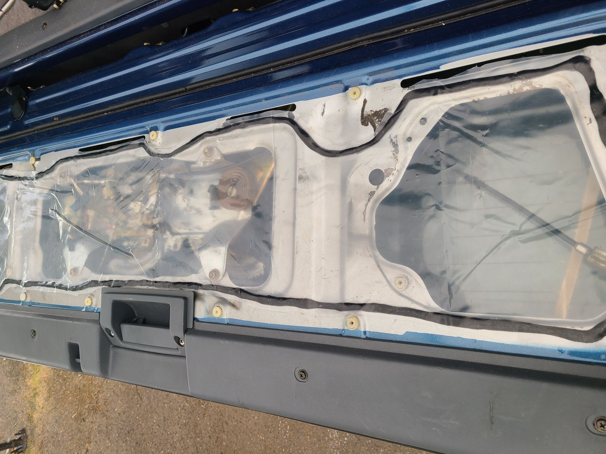

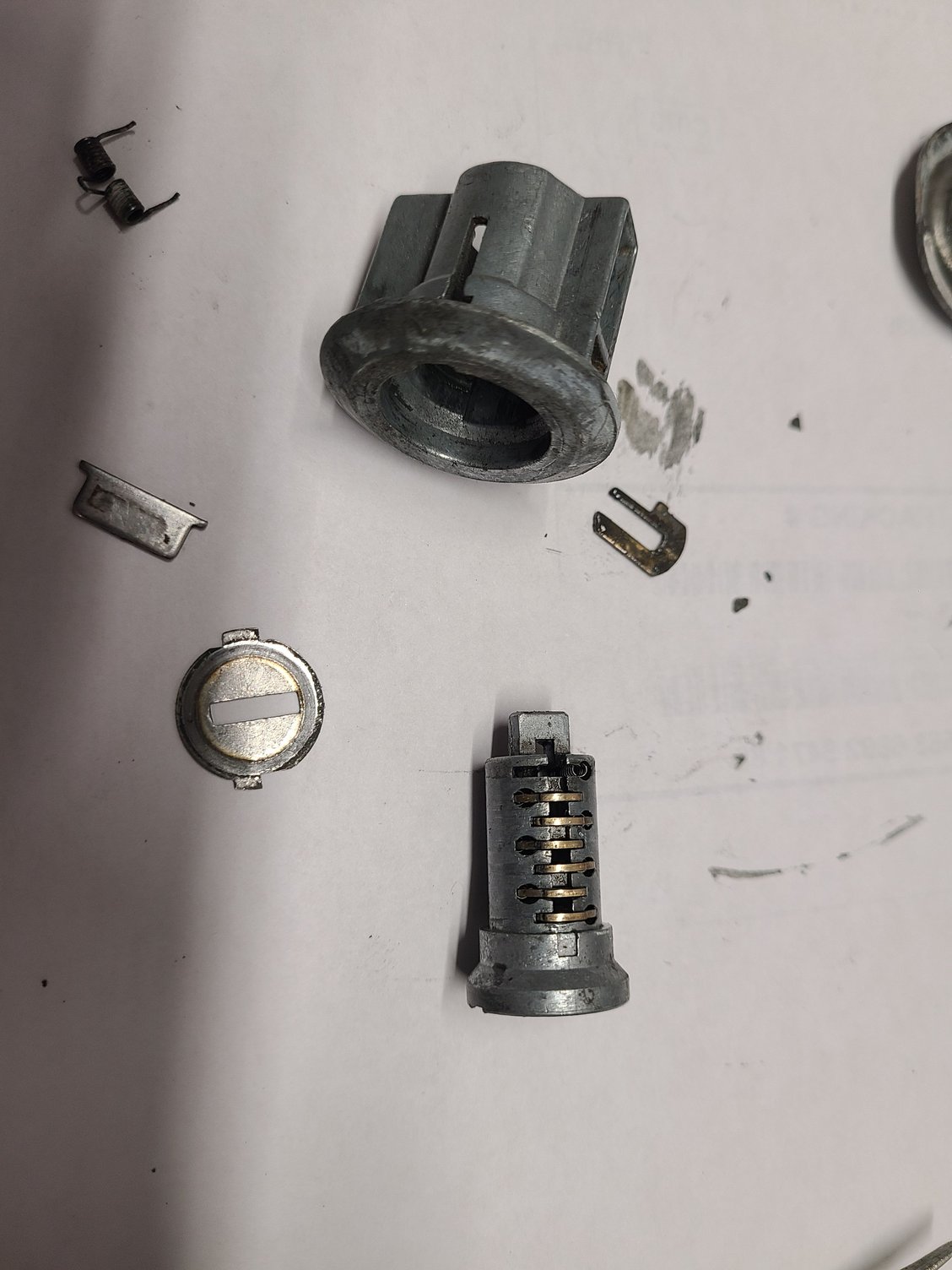

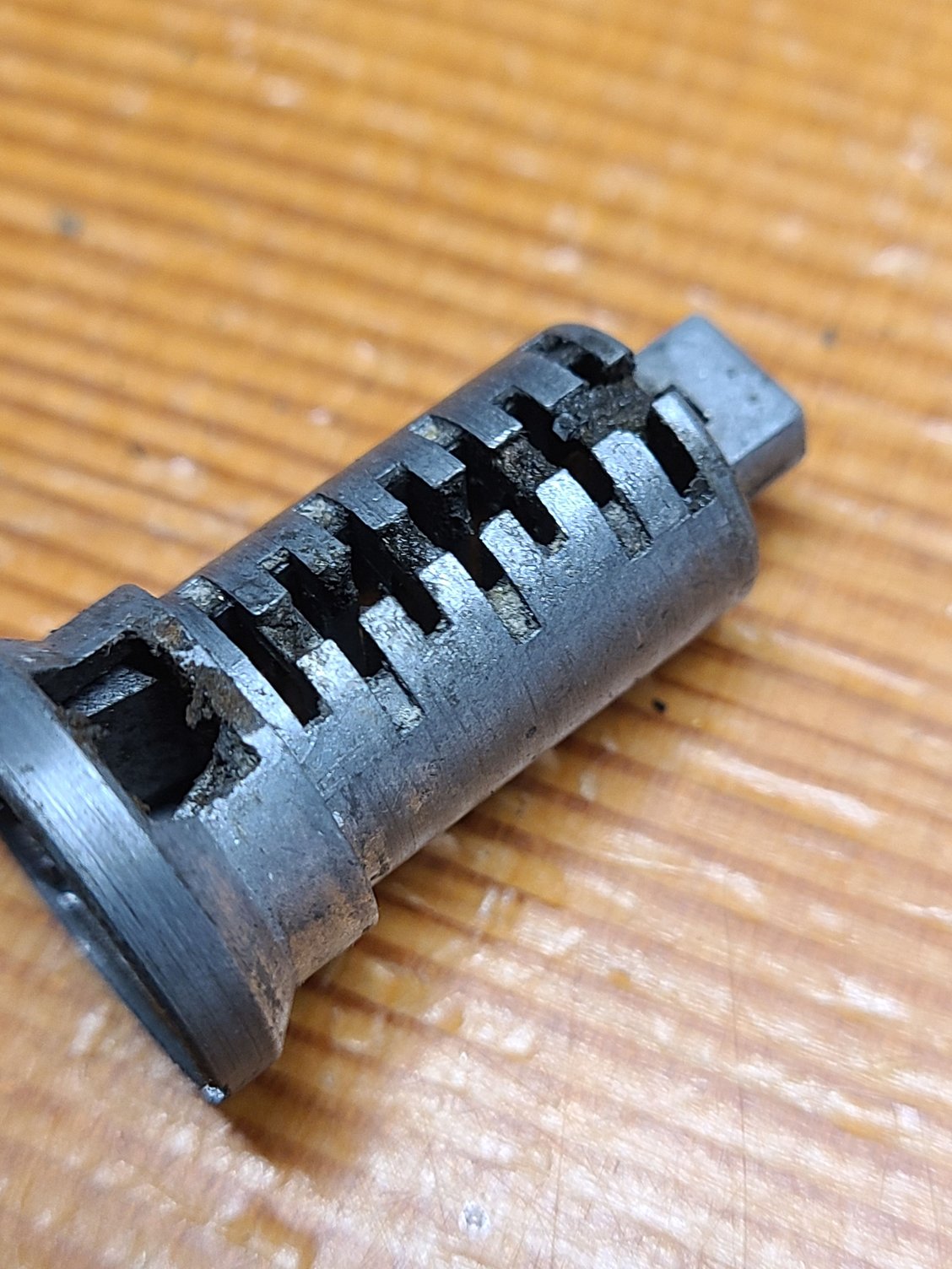

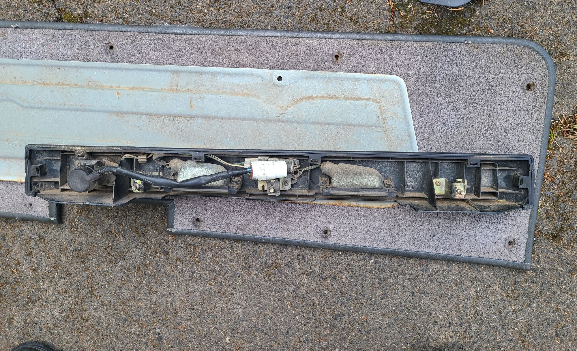

I finally finished my quest to rekey all the locks in the truck, and have one key that operates them all. Last on the agenda was the tailgate lock. Thanks to @Jimkola 's guidance, I disassembled the tailgate and removed the lock (not an entirely intuitive process):
Then I disassembled the lock cylinder, and cleaned everything:
Reassembled everything with new wafers, and a new tailgate lock bezel that @Jimkola was kind enough to send me:

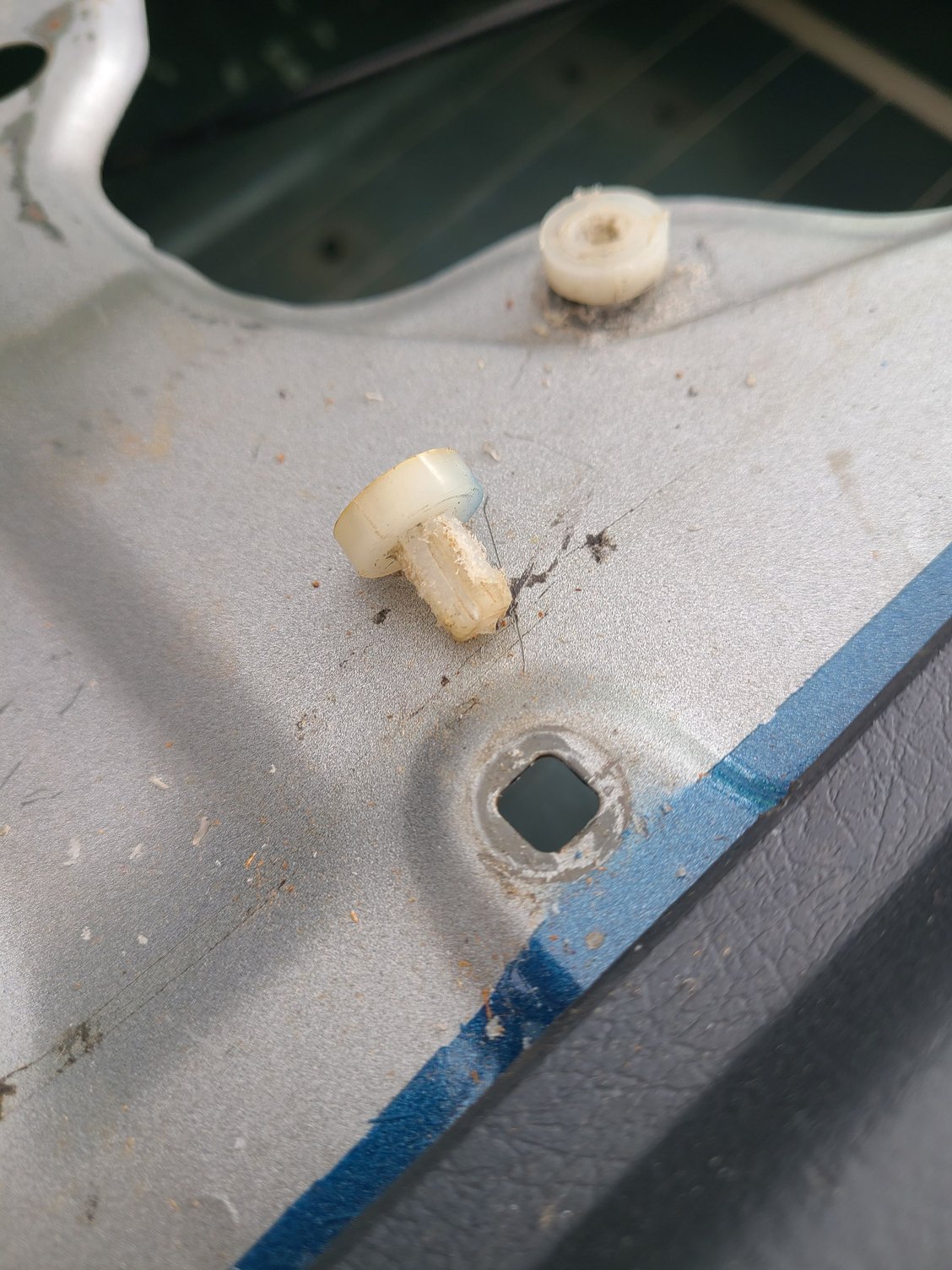

Cleaned and lubricated all the window crank mechanisms, and installed a new water shield:
A couple of these inserts have stripped and are now spinning, anyone know the part number for them?

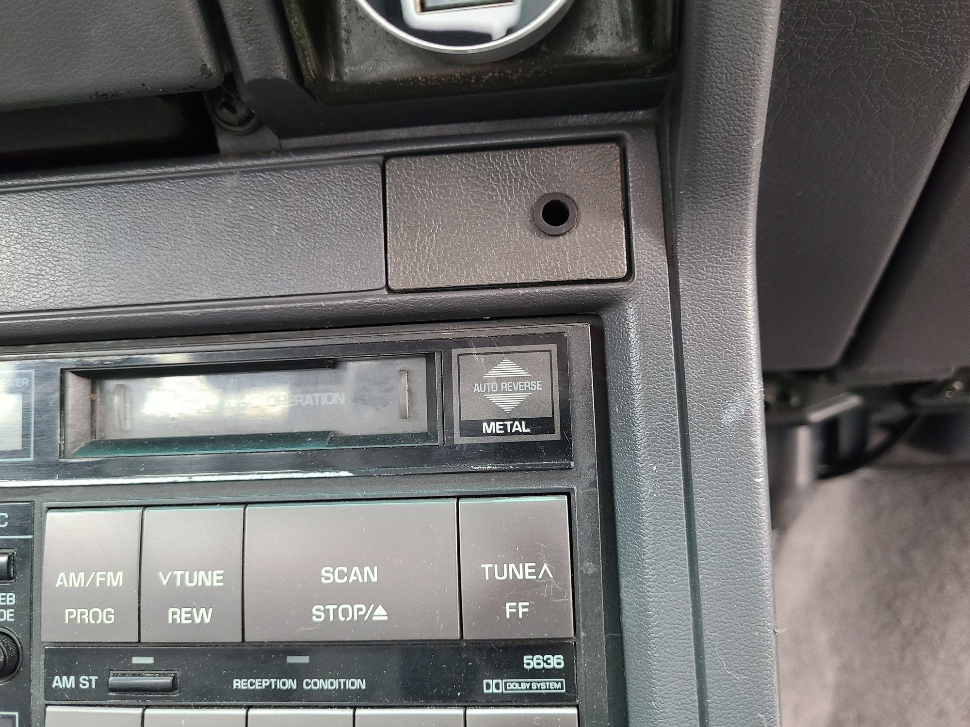

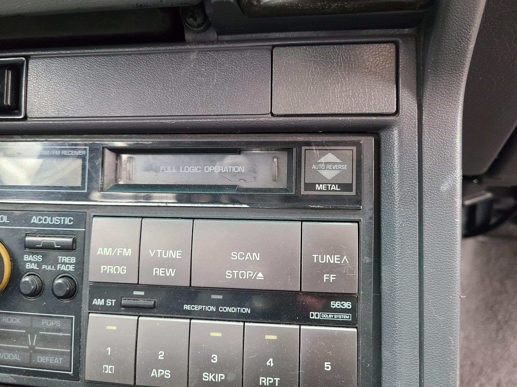

I was able to source some replacements for missing/butchered parts - radio bezel filler plug, rear seat hinge covers, and a vacuum hose bracket on the valve cover:
Before:
After:
Much better:
Vacuum Hose bracket installed:

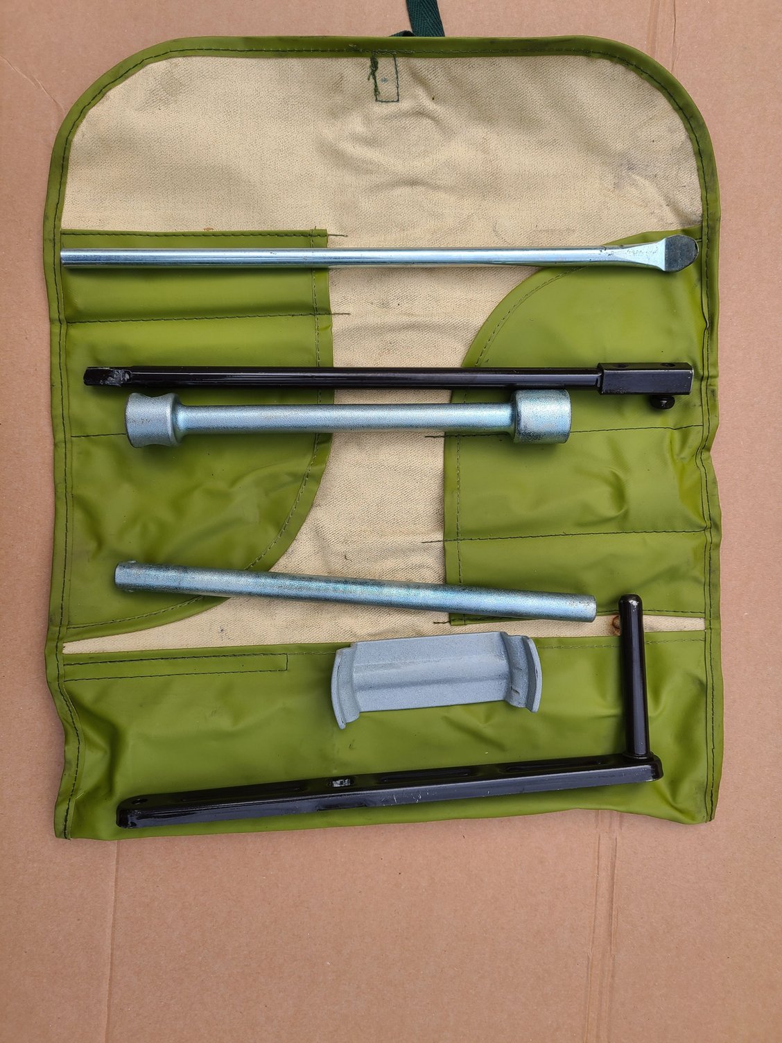

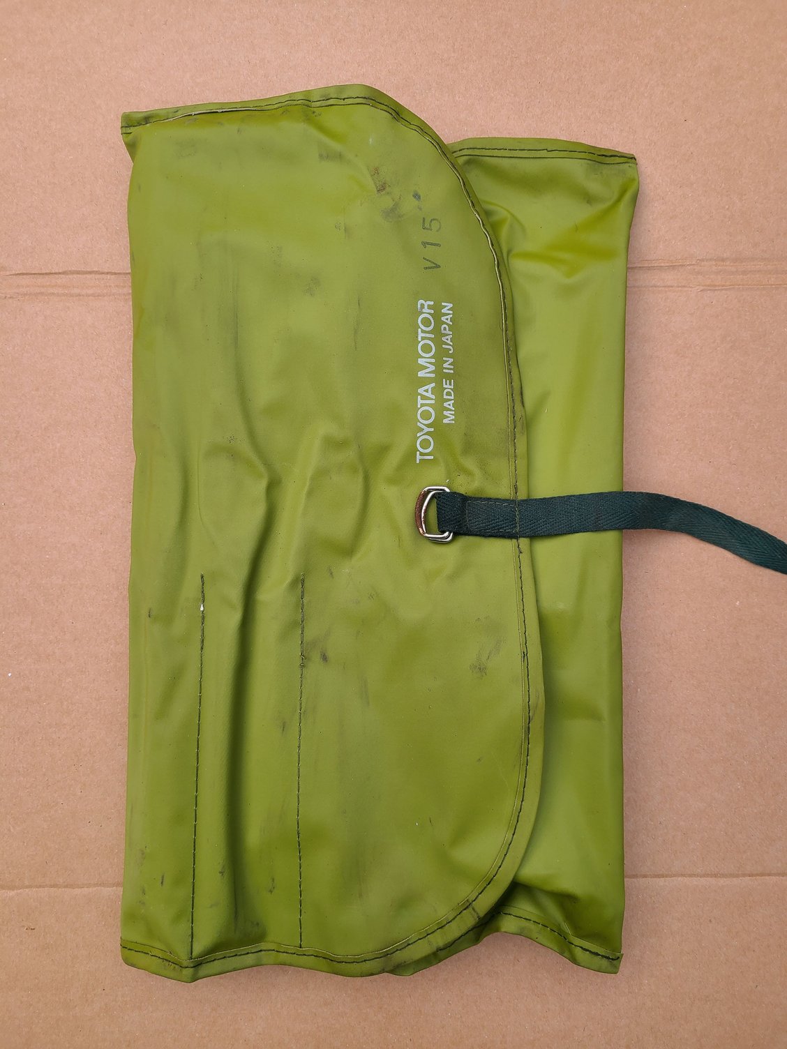

I also got an OEM tool set that looks to have been used once or twice at most:

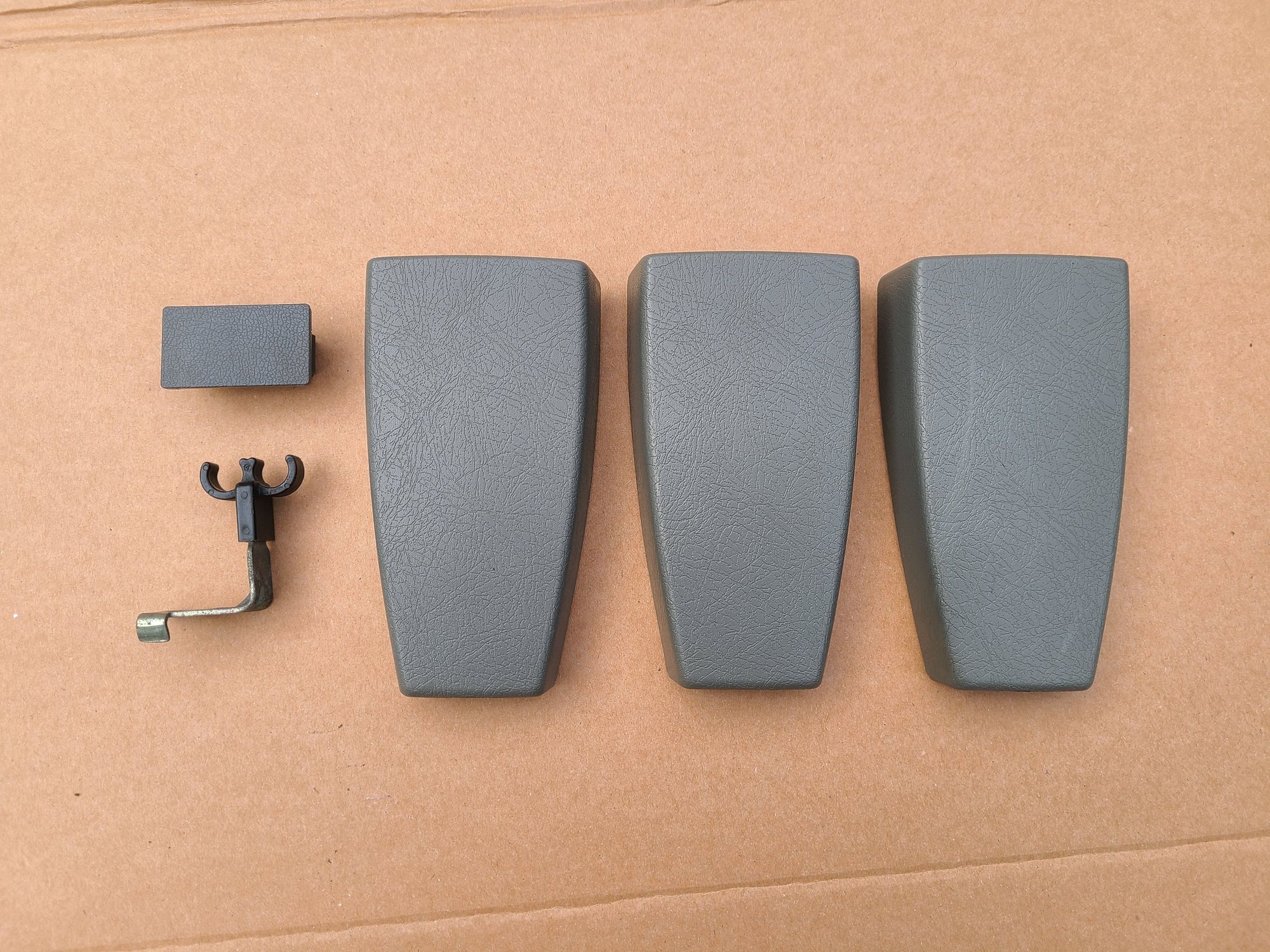

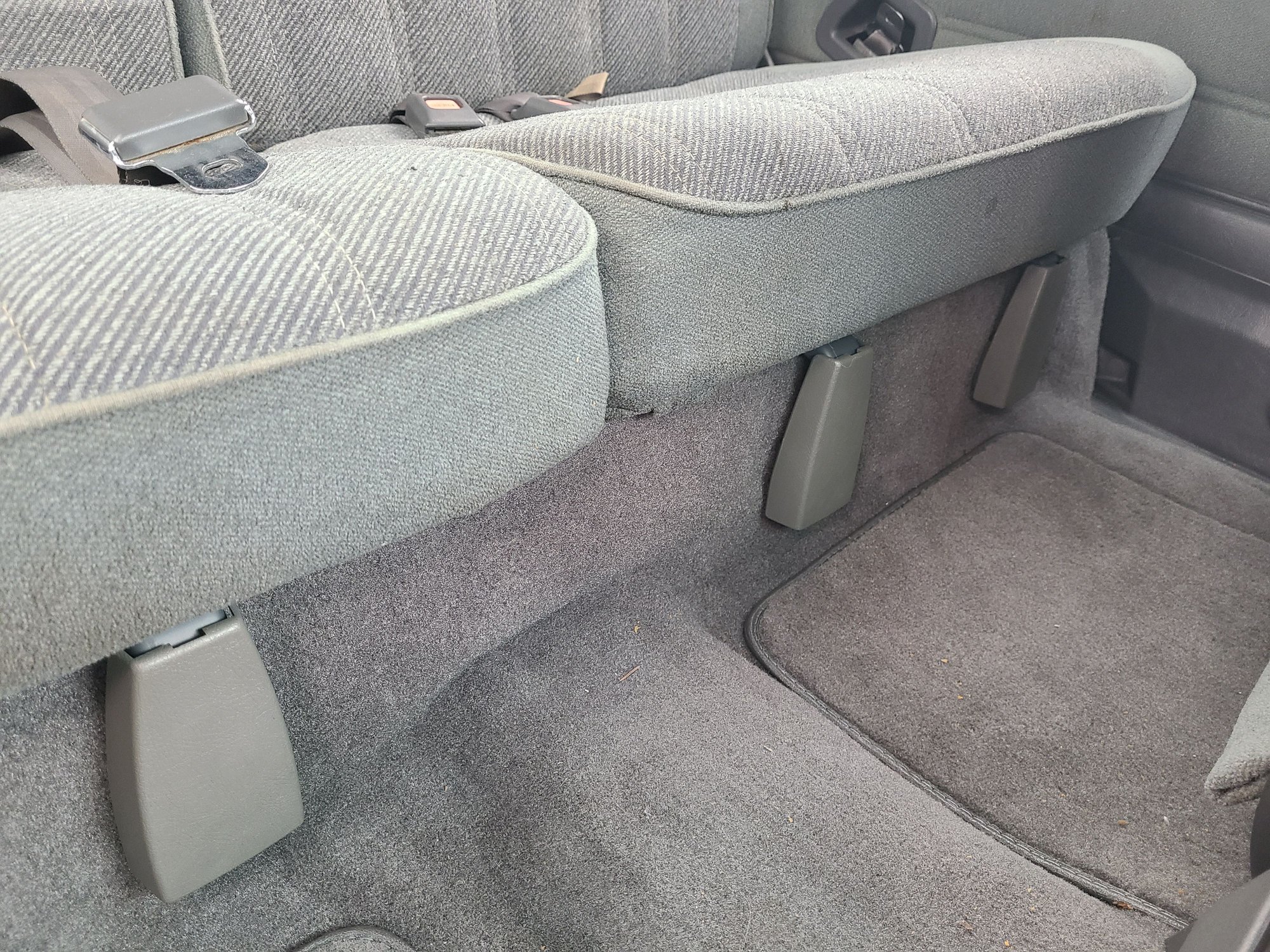

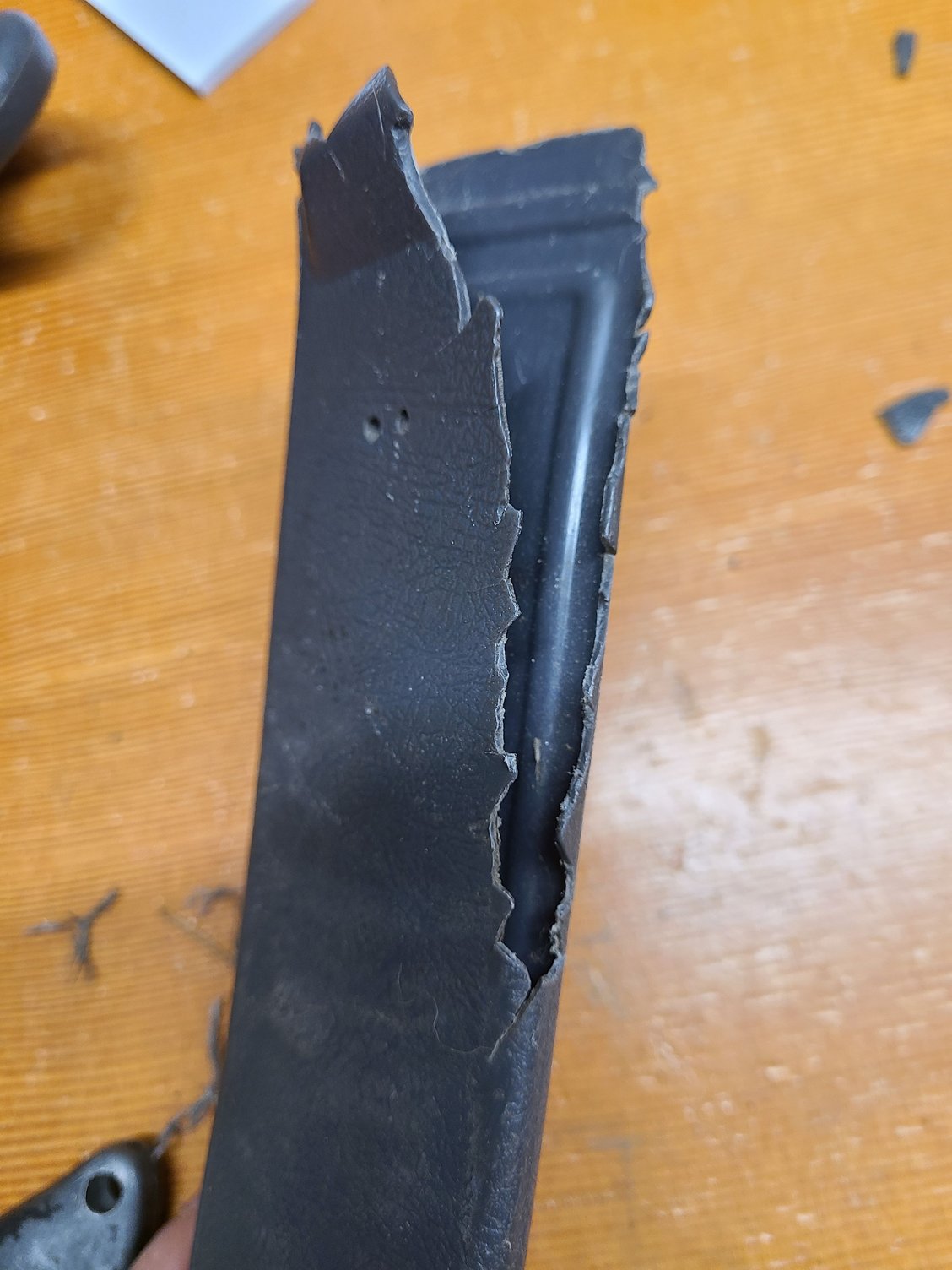

And a pair of seat belt receivers to replace my "slightly worn" ones:

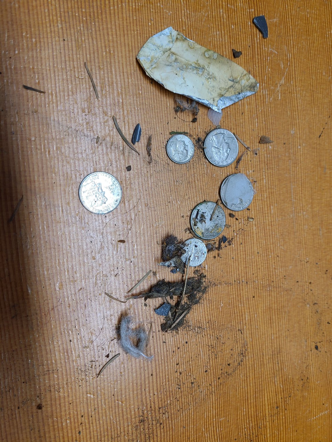

I almost got rich when I removed the cracked seat belt receiver and all this fell out:
