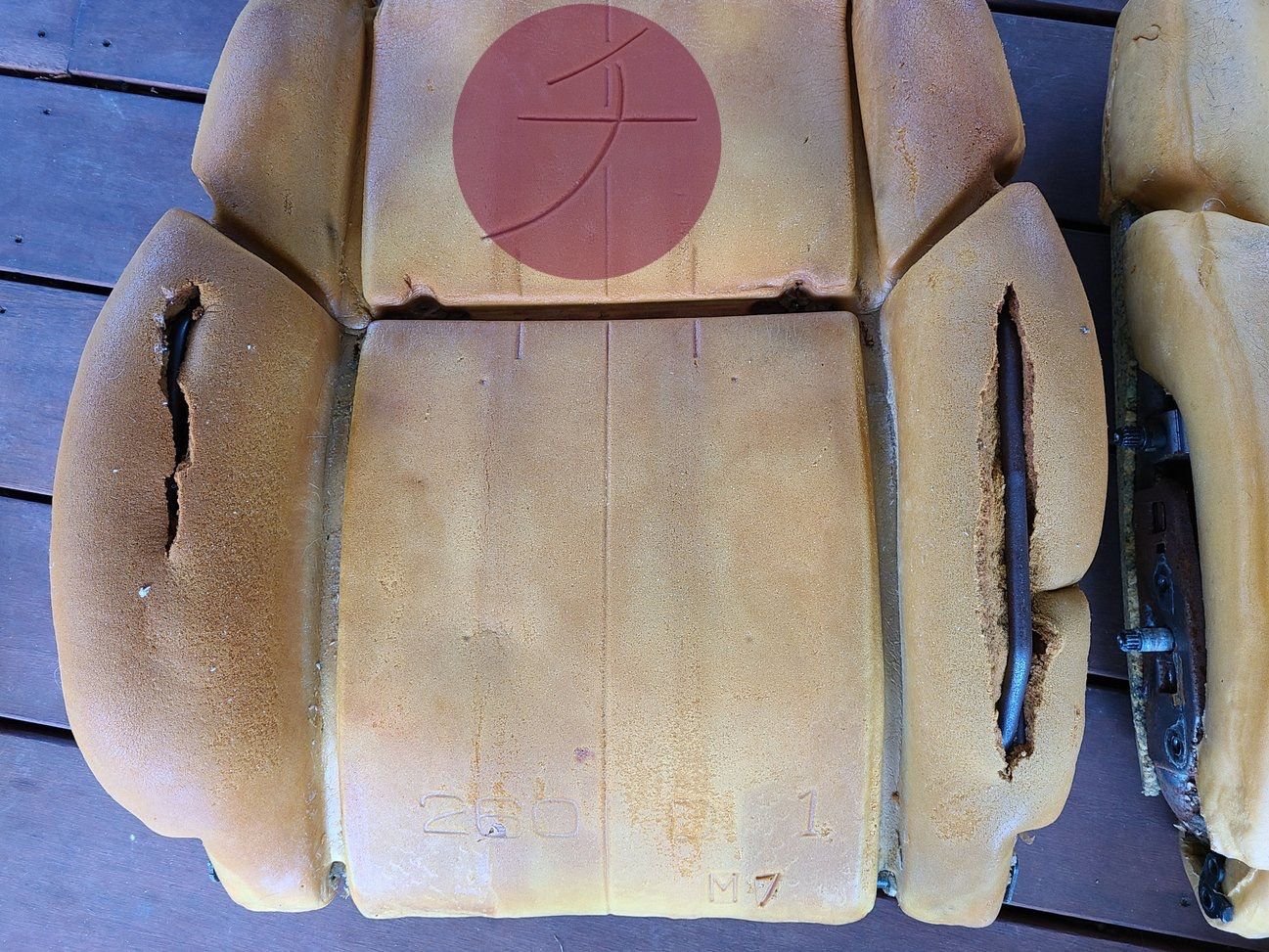

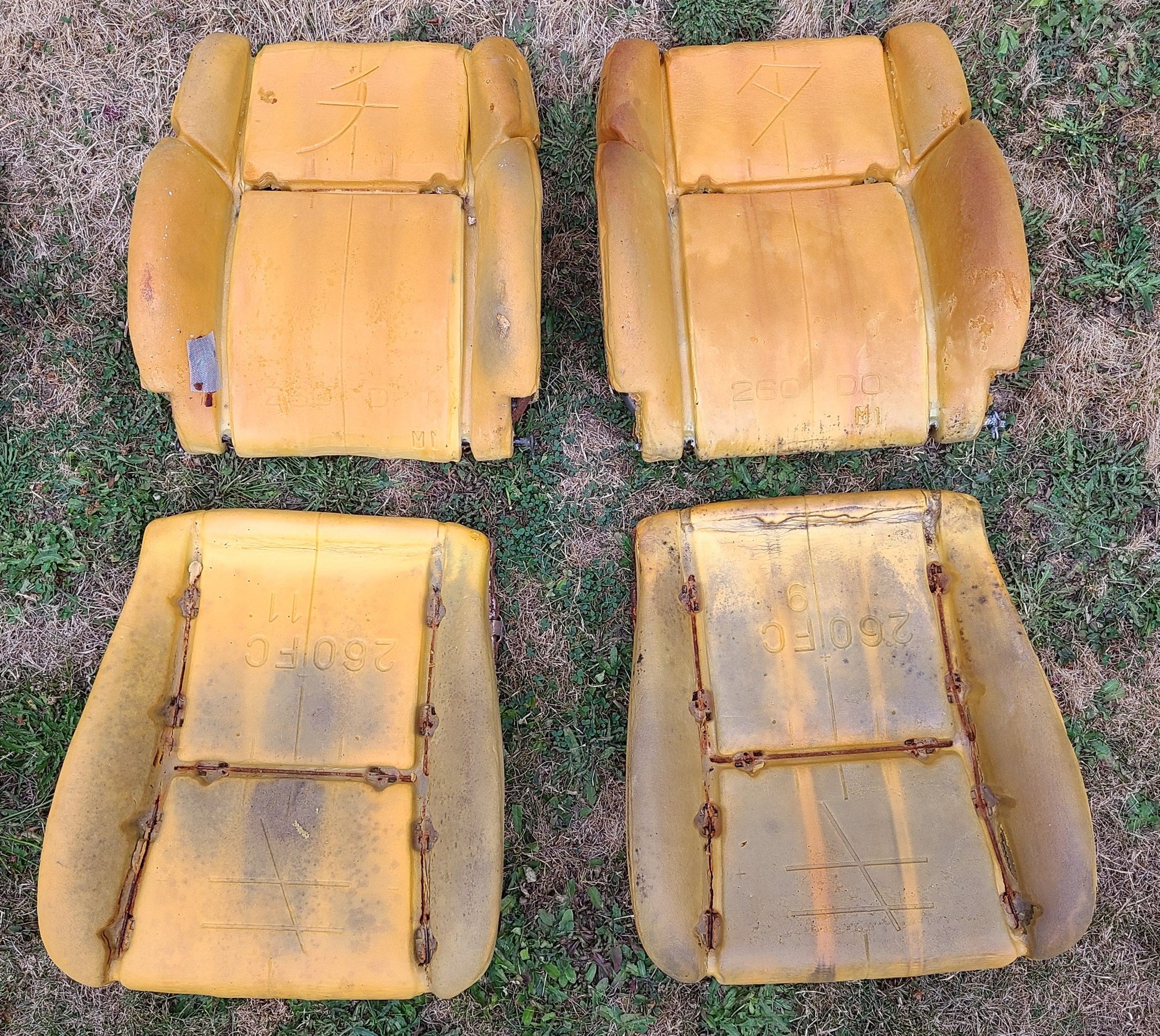

Originally Posted by Melrose 4r
Interesting mark on the foam. Can anyone here tell us what it says?
I certainly don't know - the markings on left and right side foams were different (on all sets of seats I worked on), so perhaps "left" and "right"? Though the markings on the lower cushions are the same, so go figure.

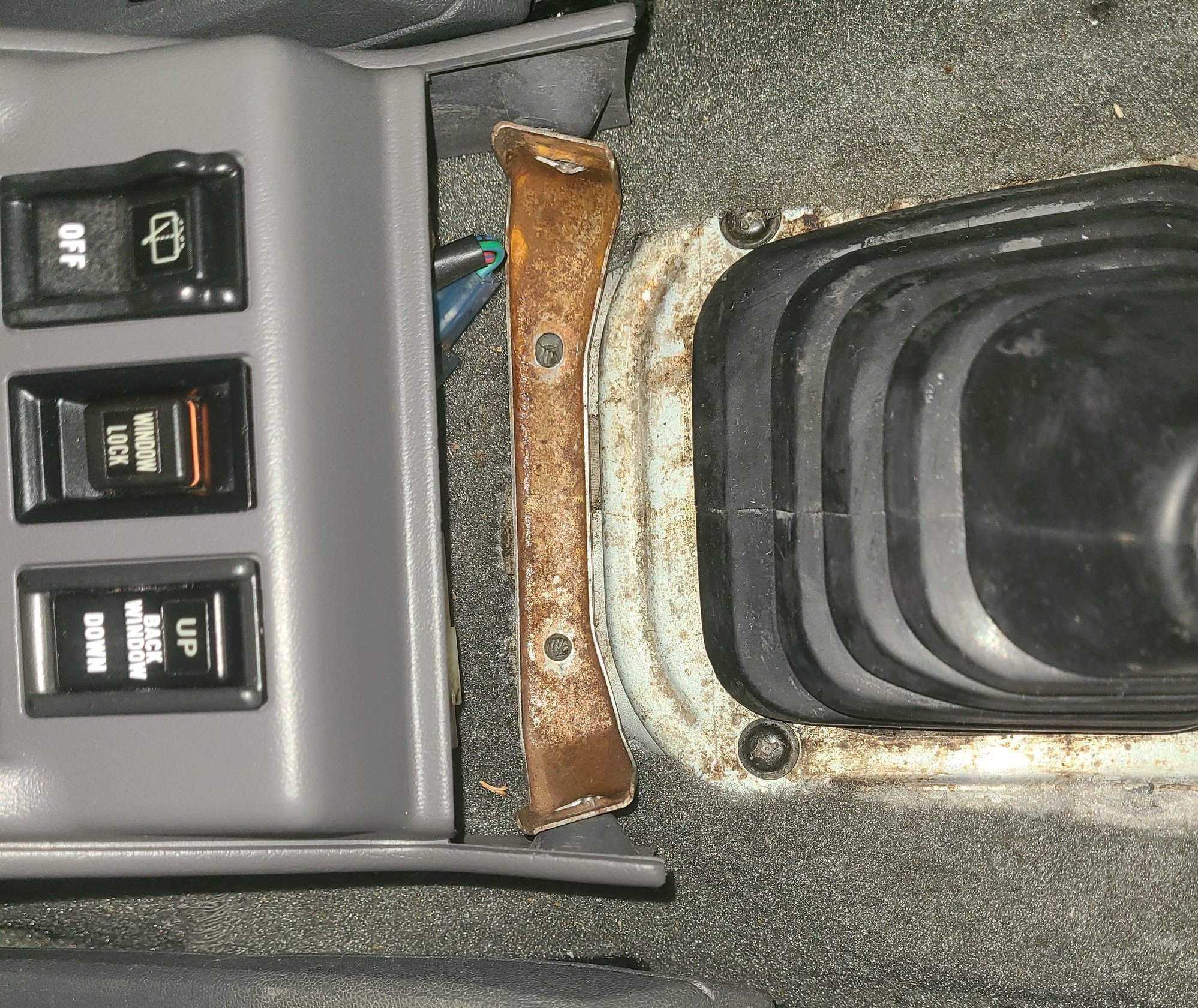

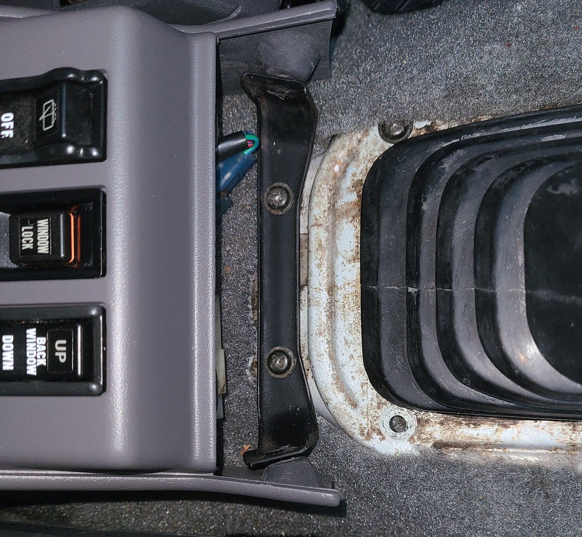

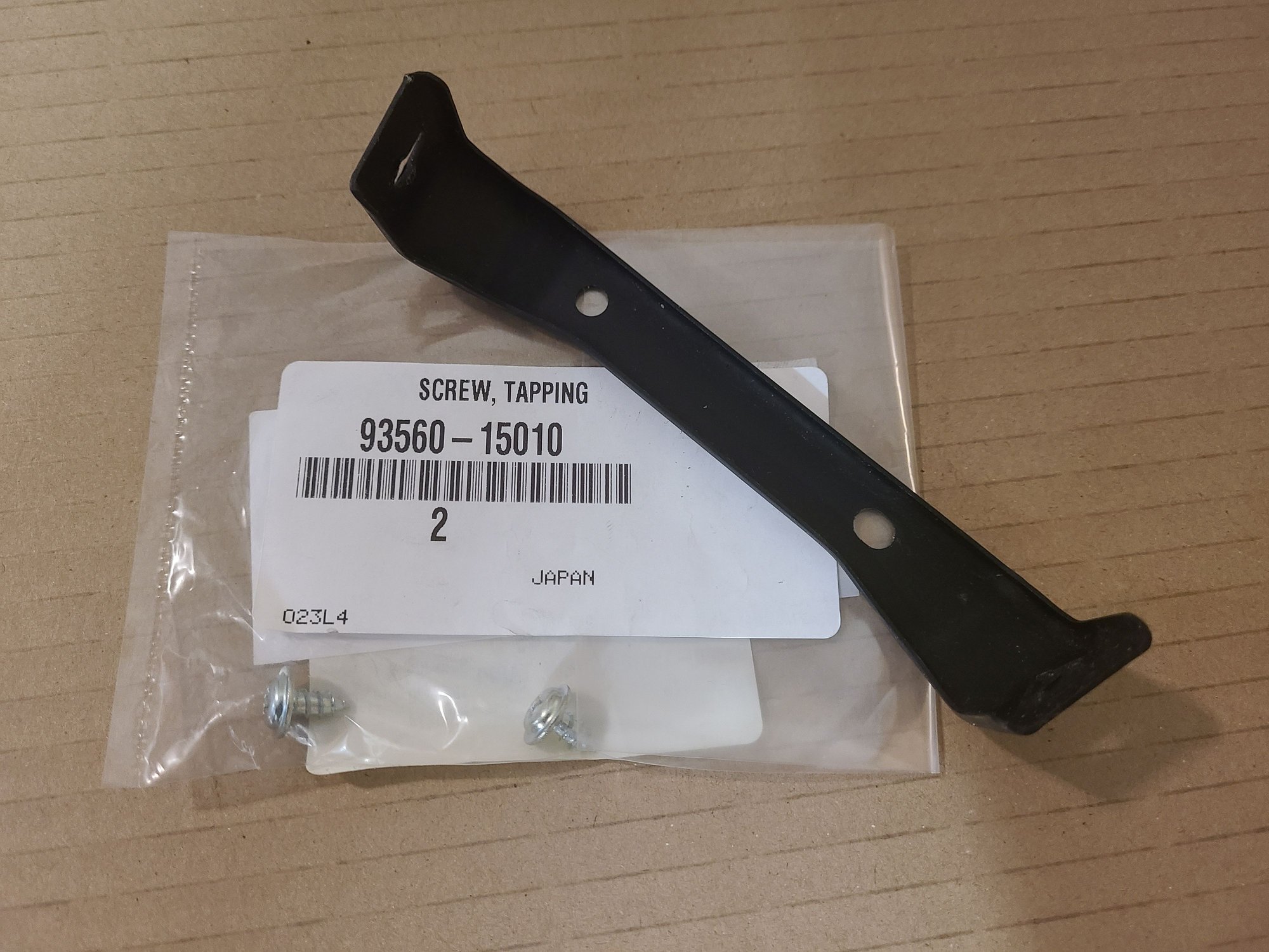

I rounded up the missing console bracket from a fellow Facebook member:
After some cleaning and painting it was ready to go in, using some new screws:
Unfortunately the screws were too small for the plastic inserts in the floor, so I used the screws that attach the shifter boot to the floor, 93560-56020, which fit perfectly:
Now I just need to finish my shifter boot installation in the shifter bezel (it is currently too "fat" for the tabs), then I can button up the console project.

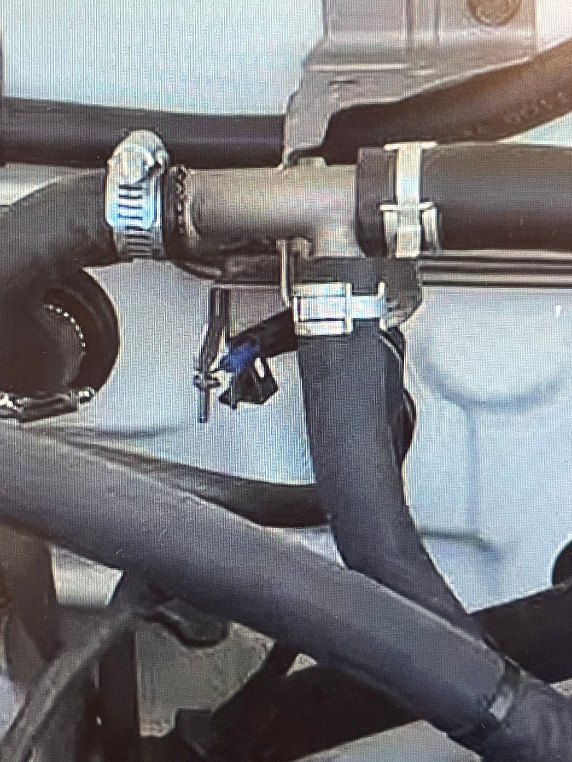

And that’s the thing- it really shouldn’t be that subjective when making the claims he does. A four year, frame off, nut and bolt “restoration” on his soon to be listed ‘84, and he has incorrect worm gear clamps at one of the heater hoses. Such an inexpensive detail to miss that’s staring you right in the face in that preview video. And the aftermarket stereo too, can’t stand them when someone is claiming restoration. Just such silly things to miss, especially since his reserve is most likely going to be well north of 25k. But you already know that.
