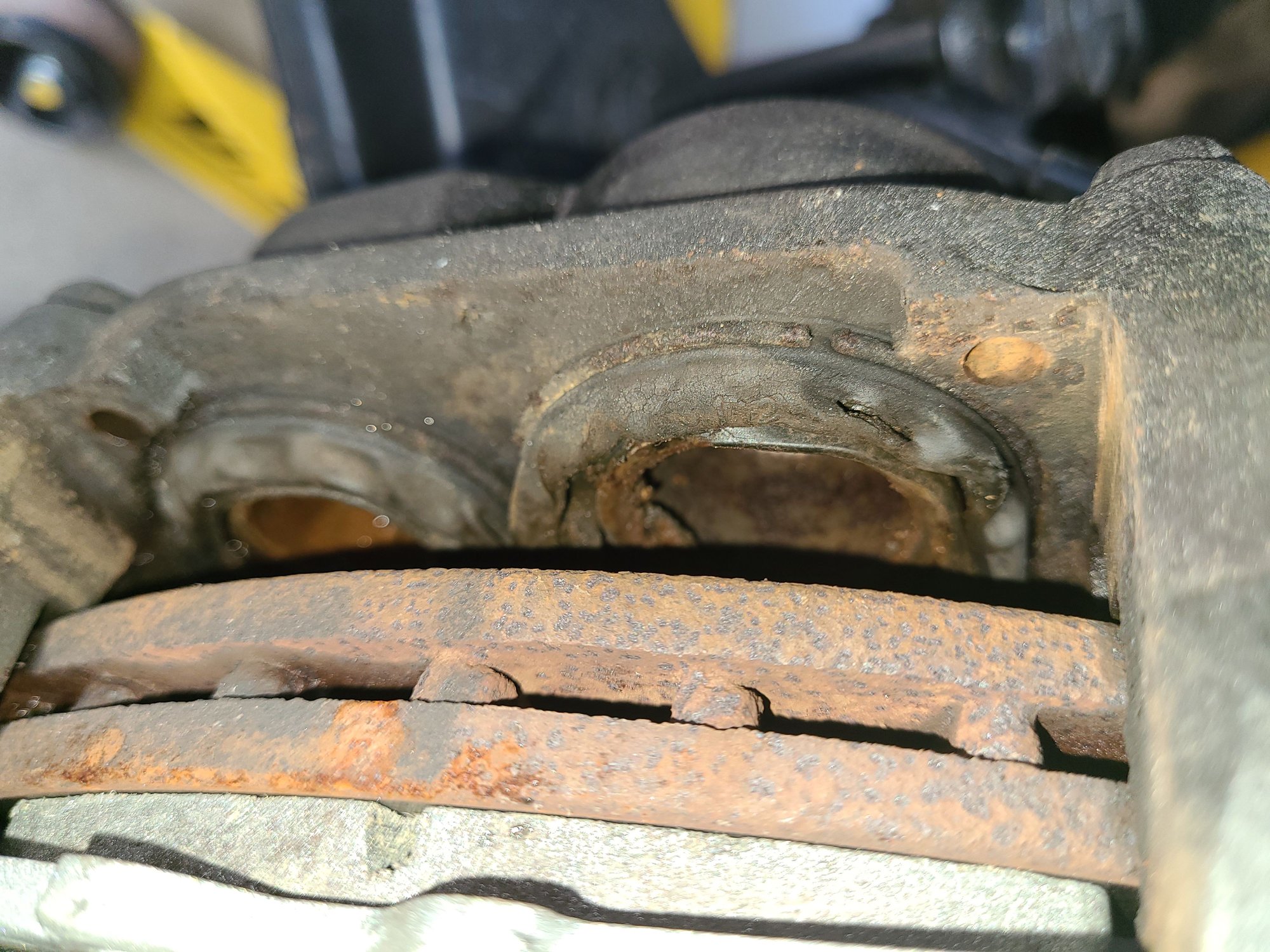

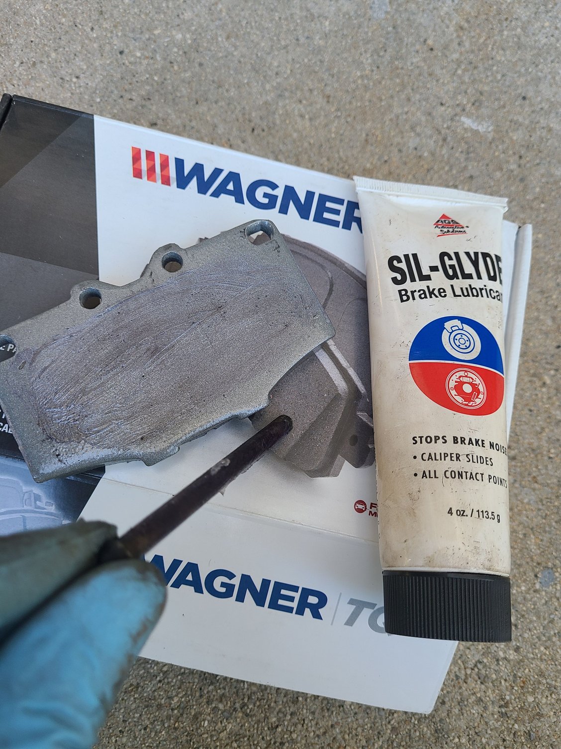

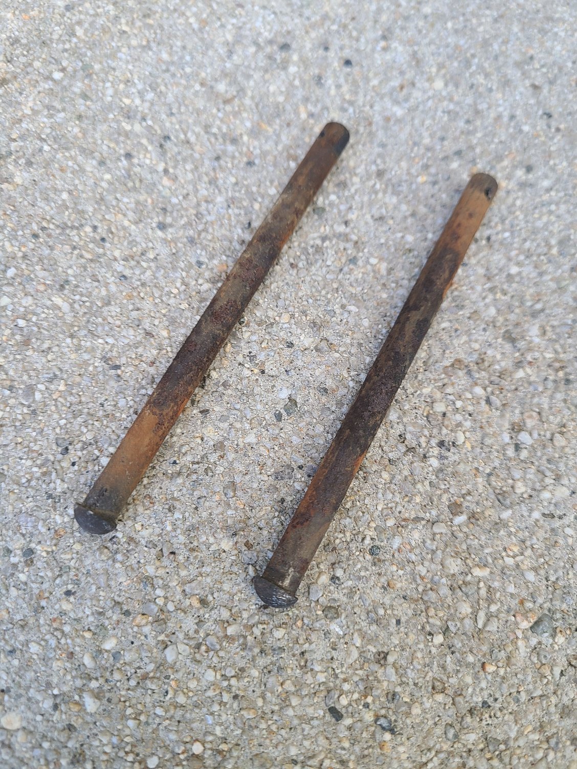

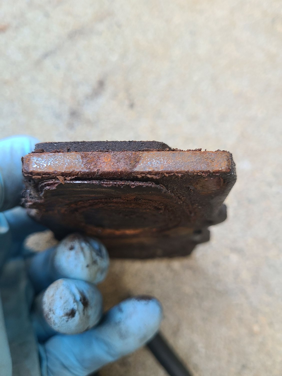

The brakes in this truck were horrible, despite the seller stating that "the brakes are great". So I bought some Wagner ThermoQuiet pads and installed them. The seller apparently did not believe in lubricating brake hardware. The pins and pads were completely dry and rusty. With most of my tools packed up for the move, I did the best I could to remove the rust and apply some lube to the pads and the pins. The caliper dust seal looked very suspect, so I'll probably replace them down the line, after the move.
Pins and pads, with no lube:
Caliper dust boots look a little sad:
Pins and new pads lubed and ready for installation:

Wow, the way that truck was presented on BAT I sure wouldn’t have anticipated the problems you’ve discovered so far! Like how you’re chipping away at everything…no stone unturned. Great work!
