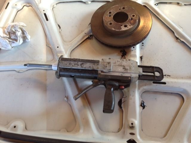

very expensive goo and gun for bonding body parts. Loaner from auto body supply store. Rotor for weight.

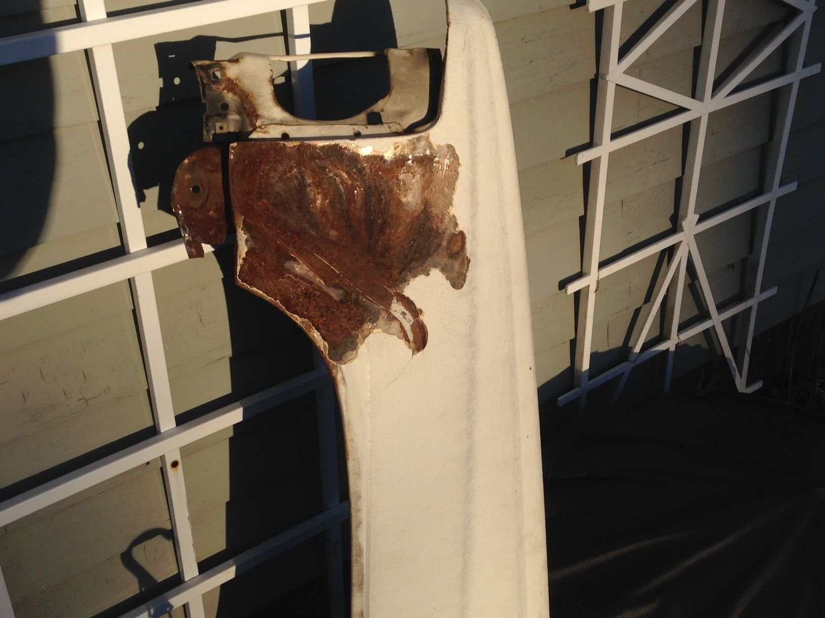

I think I'll sandblast this and then see how I feel about it. It was covered by thick bondo that was cracking off.

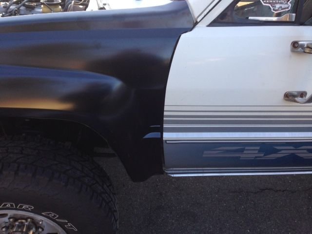

New fender trial fit. Need some work at the bottom bolts.
