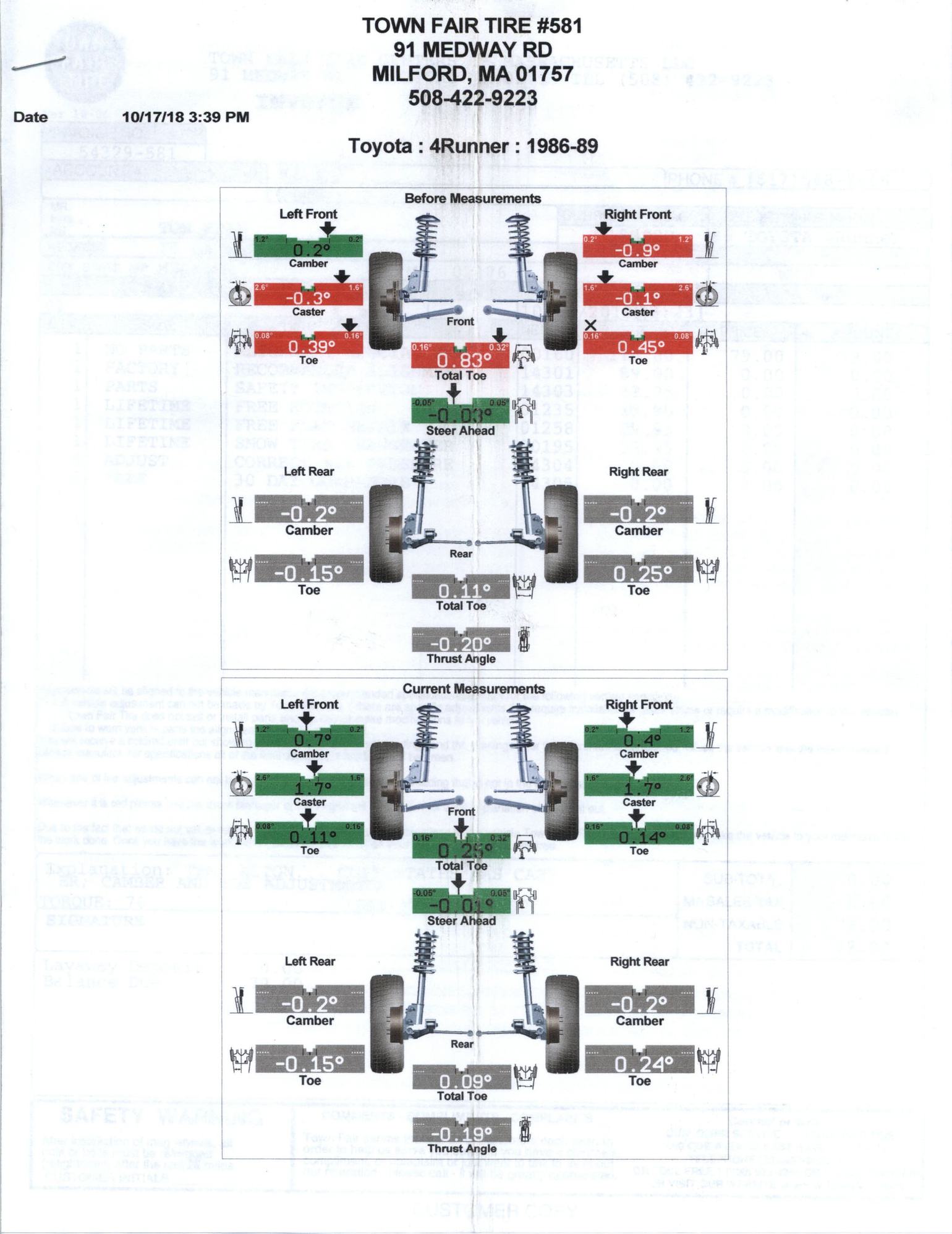

Drove in to the office today and along the way, decided to try to get an alignment done today. Town Faire Tire got me in during lunch break and here's the results. The "Before" numbers were my eyeball alignment. Much more caster now which means better highway stability. It drove great back to the office, can't wait for the evening commute and our road trip to NH this weekend. Looking at the rear toe numbers it appears my rear axle is skewed a little, probably due to the leaf spring replacement performed by a previous owner. Oh well, another future project.

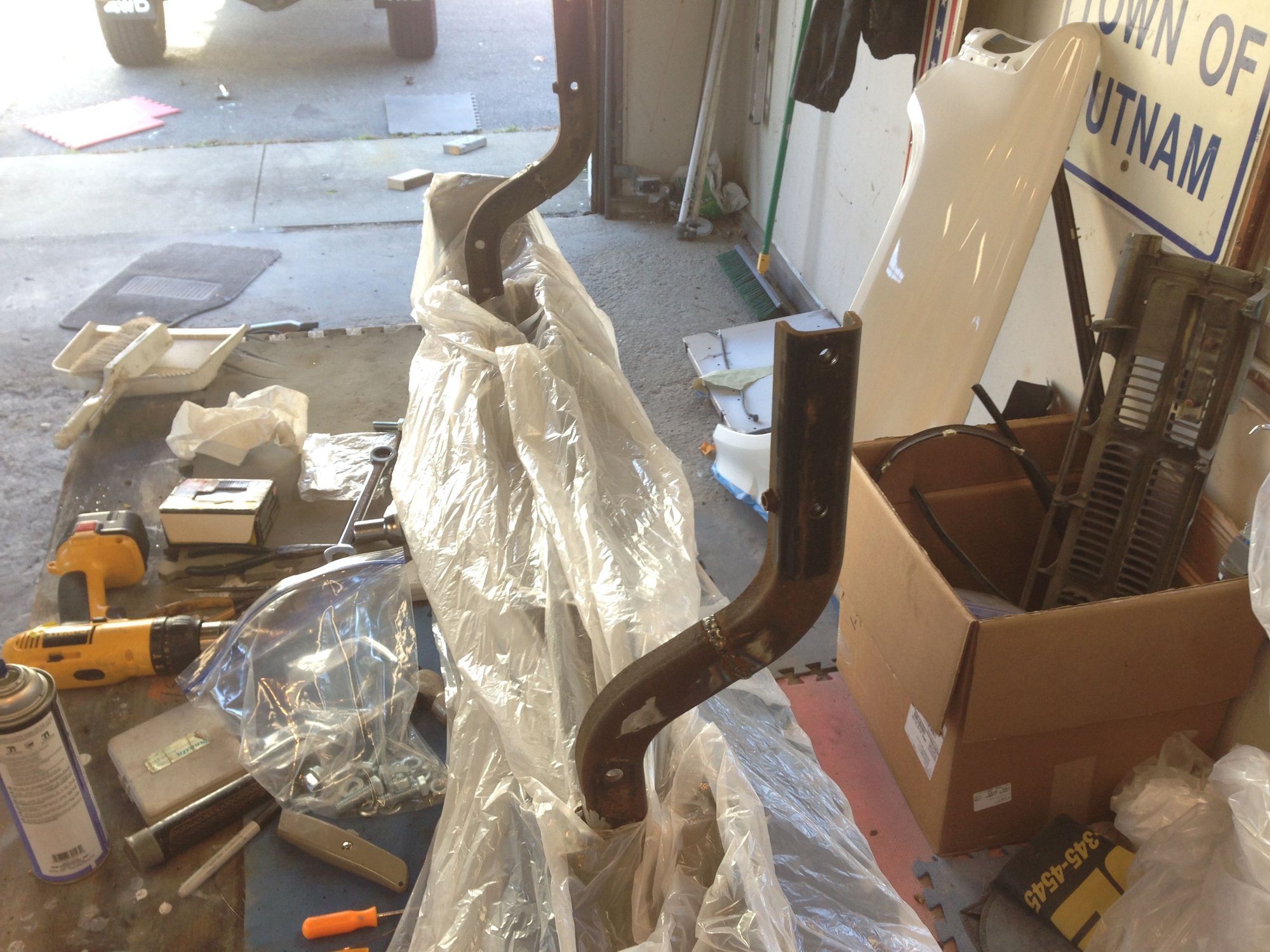

Took the day off work to mount up the new rear bumper and begin the road trip.

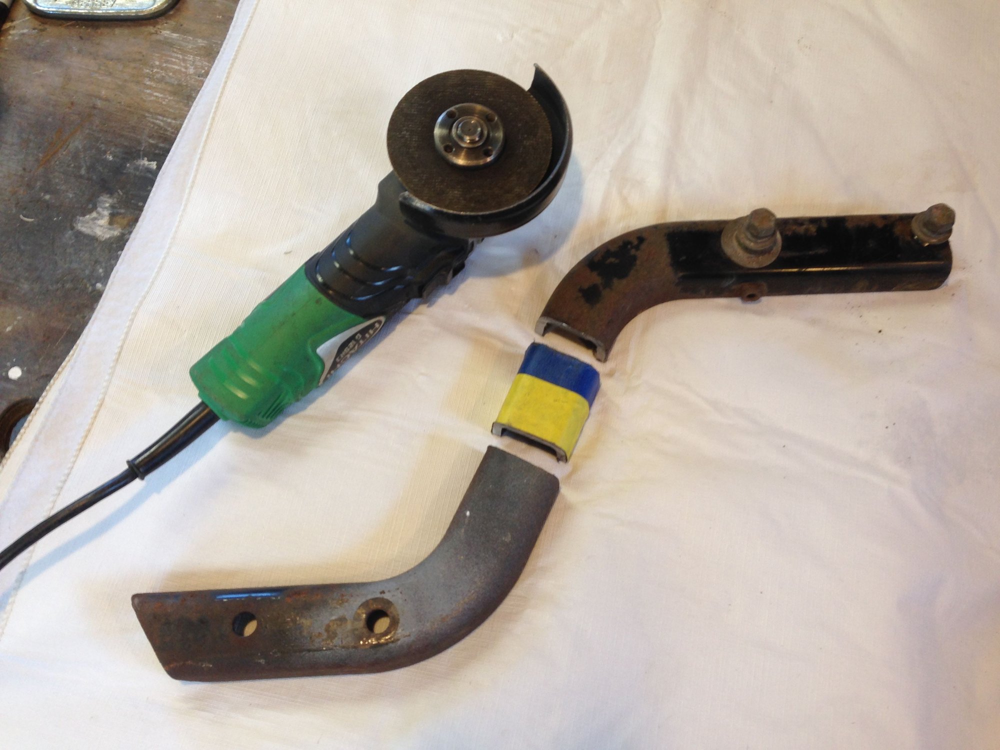

i had tried the bumper last weekend and decided I could use the original 1986 step bumper mounts with some modification.
so I cut 2.5” out of each one and welded them back together.
this is a crappy job to do alone, fitting the bumper on and off.
i used one of the existing holes in the bumper itself and drilled another hole between the leftmost one in the photo and the end of each mounting bracket.
also wound up mig welding the bumper to the brackets.
These bumpers seem pretty flimsy to me and my end goal was to mount a bike rack with two mountain bikes and hit the road. So I felt it would flex less if I welded it.
After fitting and welding I needed to paint the rusty looking mounts so the plastic drop cloth was a quick and dirty way to mask it.
Here it is Ready for the road.

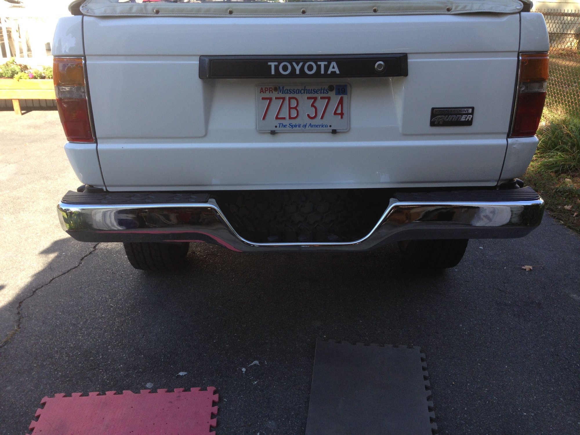

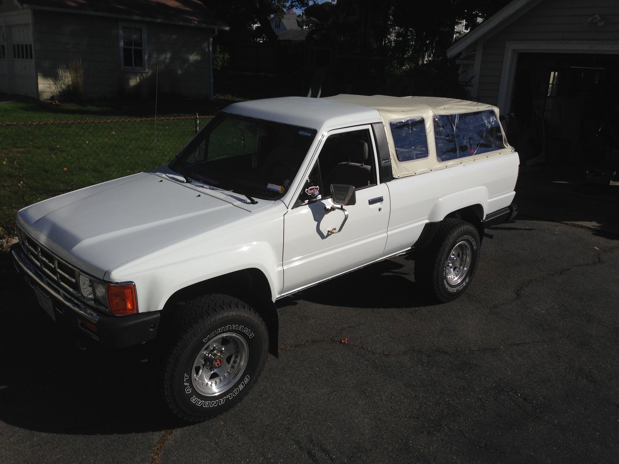

Nice truck!
The body and paint job look amazing.
First time I see a white soft top.
The bumper looks good. If I install that one, I'll put the license plate in the step, and I'd modify the tail gate, truck flat style, with the big 'TOYOTA' decal, I love the truck tailgate.

We made it back from NH without so much as a flicker from the CHARGE light but I promised the truck I’d look into it and have ordered some new alternator brushes for it. In my family’s Toyota history alternator brushes didn’t last beyond 125k miles and this one might have 182k on it, I don’t know for sure if it’s the original alternator or not.
Really glad I got the alignment before this road trip! It’s a bit tiring to drive at 70+ mph in traffic but the alignment sure has helped.

Originally Posted by SomedayJ
Nice truck!
that bumper looks a lot sturdier than my chrome one.
i thought the off-white soft top would look strange with the bright white paint but I like the contrast.
I’d really like to see it with a denim blue top, though. Maybe I’ll get some quotes on it.
