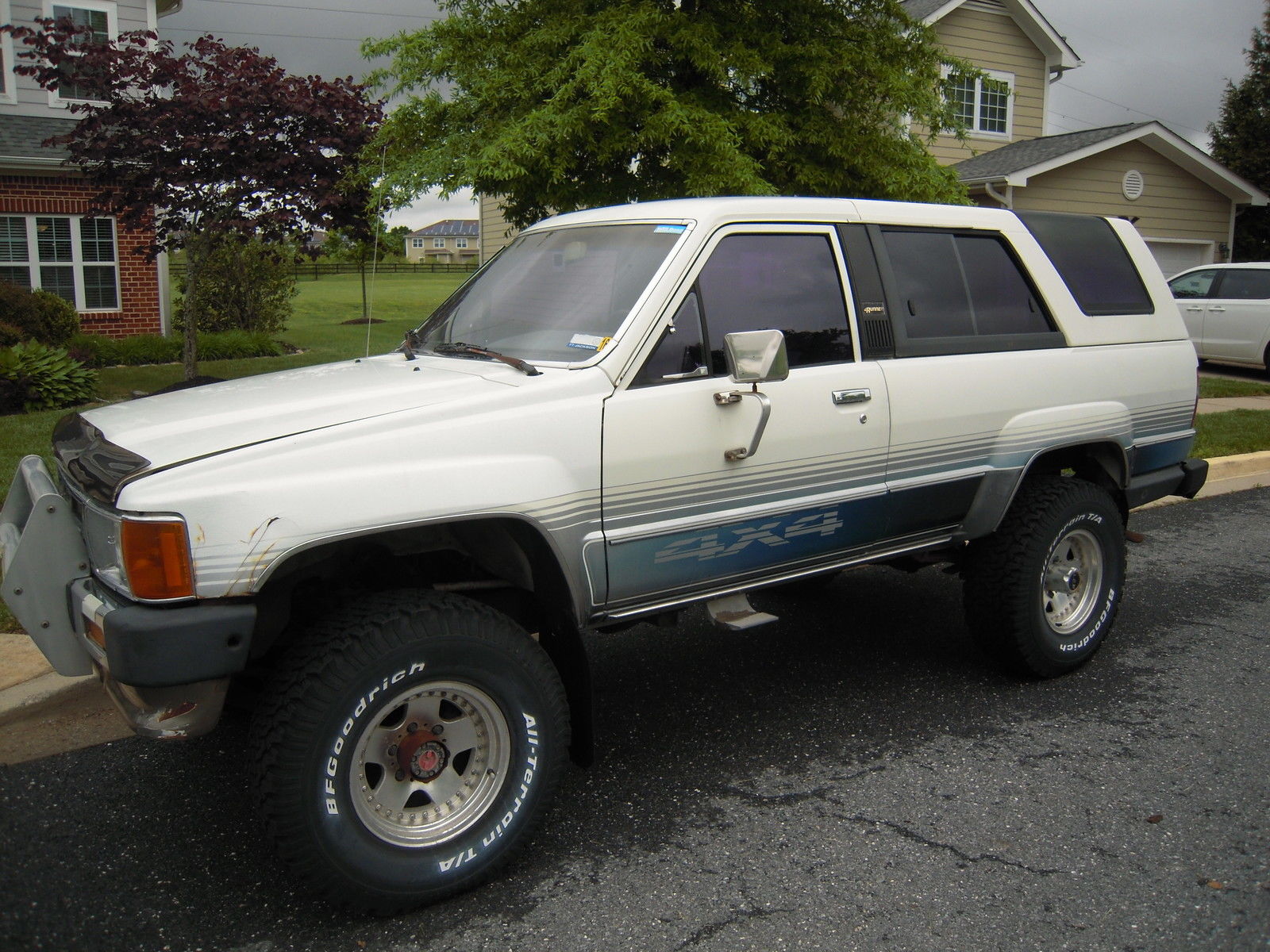

HI All,
Coming at you from Melrose MA, right near Boston. Just bought my 1986 in MAY and towed it back to CT from Maryland on Roadkill-inspired road trip. Then put a new battery, plates and slave cylinder in and proudly rolled from CT back to Boston under it's own power for the first time since the PO garaged it 6 months ago in MD. PO is in the US ARMY and the truck was brought in from Korea at some point about 6 years ago. I picked up a never-installed KAYLINE soft top in Pennsylvania and that install will be completed tonight(time permitting).
Back in the 90's I had an '84 4runner that I resurrected from the dead, installed a soft top etc., and today I'm doing the same with the help of my 13 year old son. He calls it my "deja-vu" truck because I keep talking about doing the same repairs on this one that I did on the other many years ago.
The plan is to fix the mechanicals first, so it passes MA state inspection, then drive it as a summer fun vehicle to the beach...then eventually fix the body up.
The short list includes lower ball joints, tie rod ends, idler arm, wheel bearing, window tint removal(too dark for state inspection)
All easy stuff.
I've already used the forum for lots of inquiries.
Items already fixed - rear door cable, seat cables, top removed, pushbar removed, side steps removed.
I'll post a video and more photos soon! Happy to be here!

I like the paint scheme! Please post more pics.

Beautiful truck, cool that you get to relive it all again with your son.

With the exception of the tires, that beast looks like it rolled right off the dealership floor. Nice find. Can't wait to see the interior.

thanks! It's very '80s. I didn't like it at first but it's growing on me. It is actual paint, and stays for now.
Some of the body panels have a strange coating like a bedliner but there is very little rust through and the frame and underside are mint. it has never seen a salty winter road.
interior is gray, was very gross. I spent 3 hours with a rented rug doctor to get the upholstery presentable.more work to be done.all the plastic parts are good and it looks like the top had never been off. Even the back window worked!
runs very well but idles lower than it should when cold. Any ideas on what to check?
