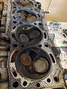

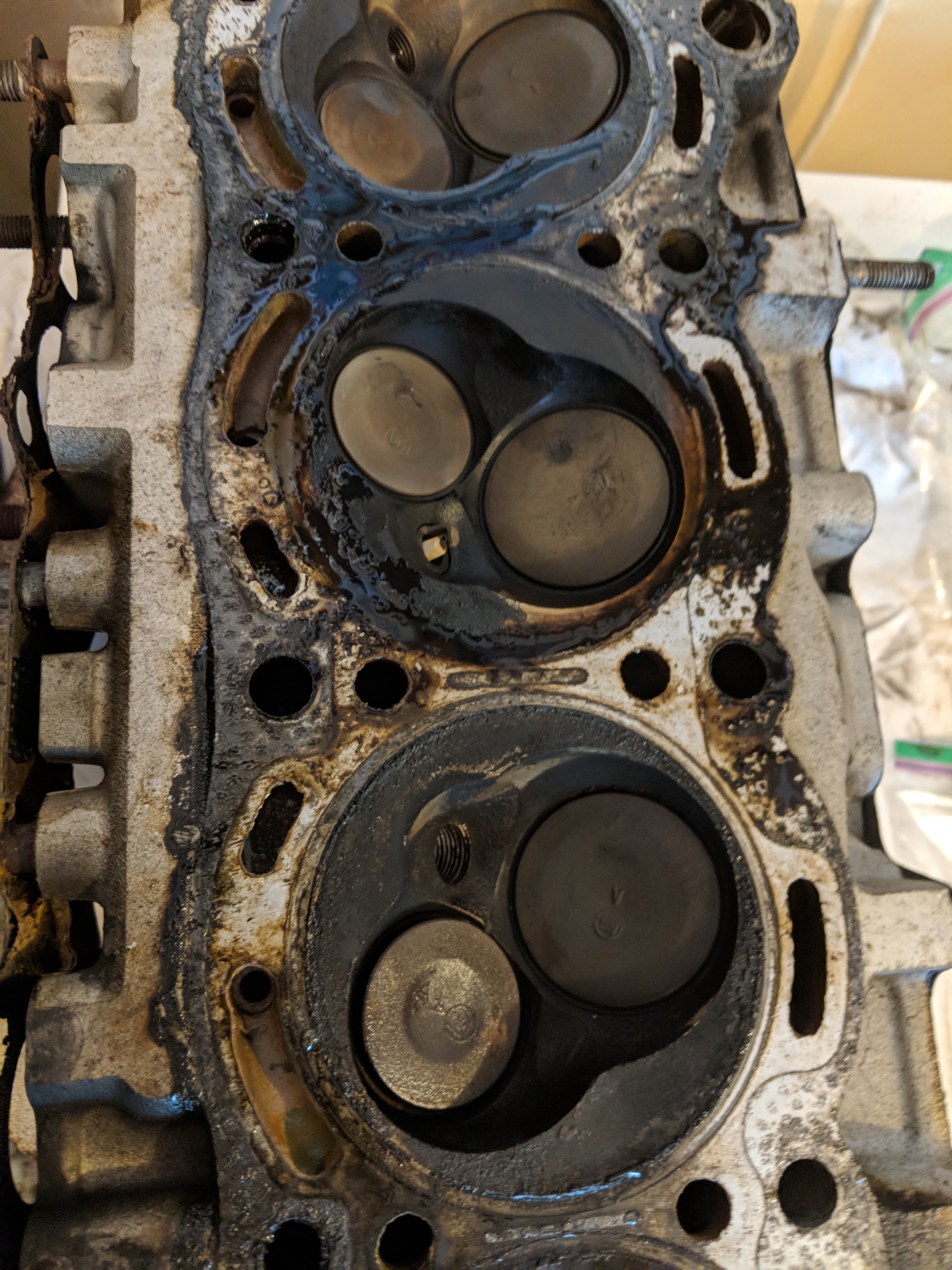

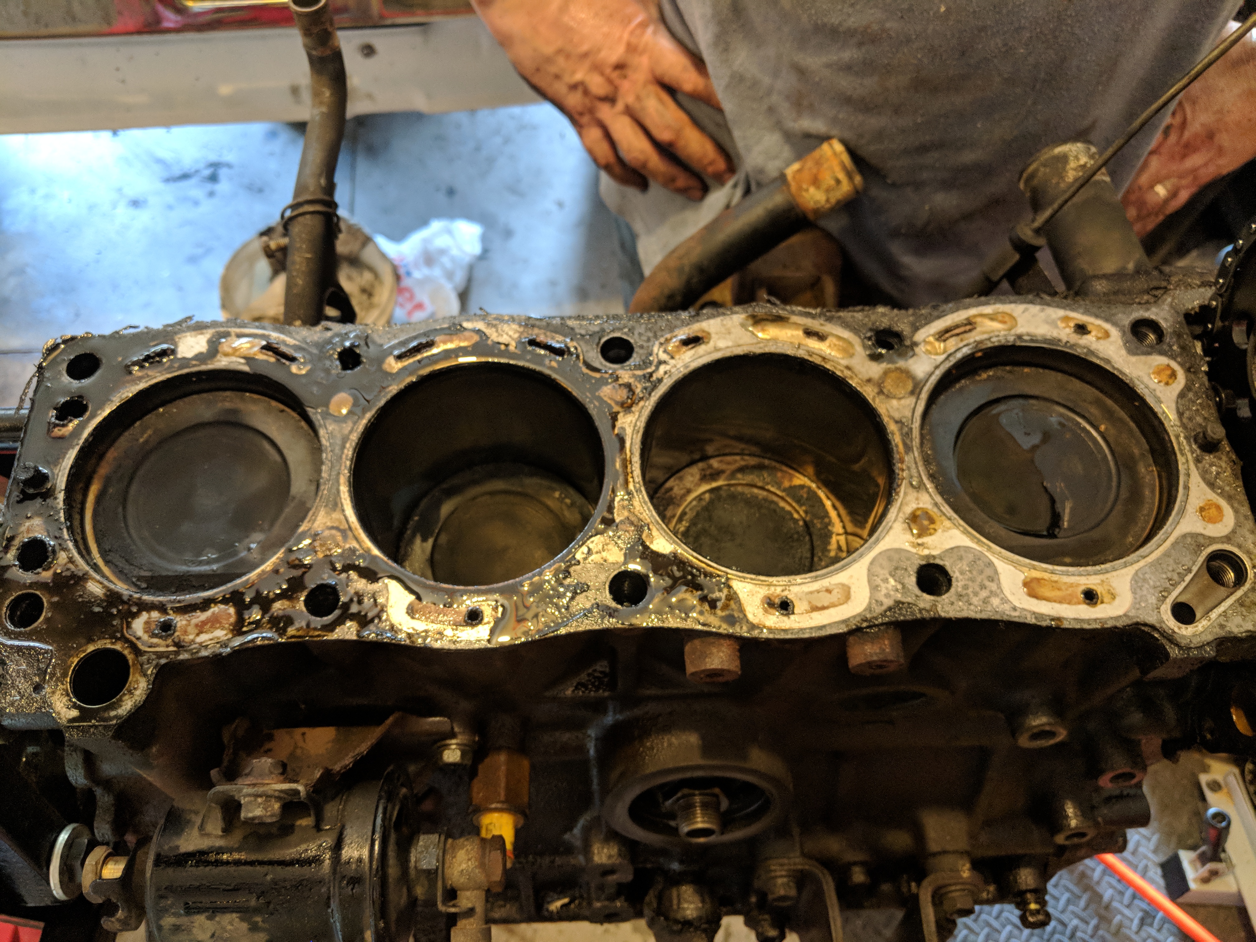

My plan is still to do a very light hone, stock size piston rings, new valves, seats, and seals, and leave the rest of the internals alone. The cam looks fine to me, and unless the rod bearings I see look like they had a shaving stuck in them I'll leave them alone. Most of the parts in this engine are good to 400K from what I've read, It's only at 180, I'm pretty sure me attempting to wield plastigauge is riskier to the truck than just leaving everything alone.
Got the engine out an on the stand and the head off yesterday, no obvious signs of HG failure, no obvious piston cracks, the #2 piston that is least covered in carbon was also the one with zero compression. Hopefully I'll get the valves out this afternoon, need to find the spring compressor

Number two looks like the exhaust valve is open...how can that be?

#2 exhaust valve is open, good eye, will look, guess that's why I have no compression!
i didn't look close yesterday, just pulled it then had to run off
Will take a look, valve must be siezed

Bent valve, broken spring or mismatched parts maybe.

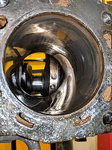

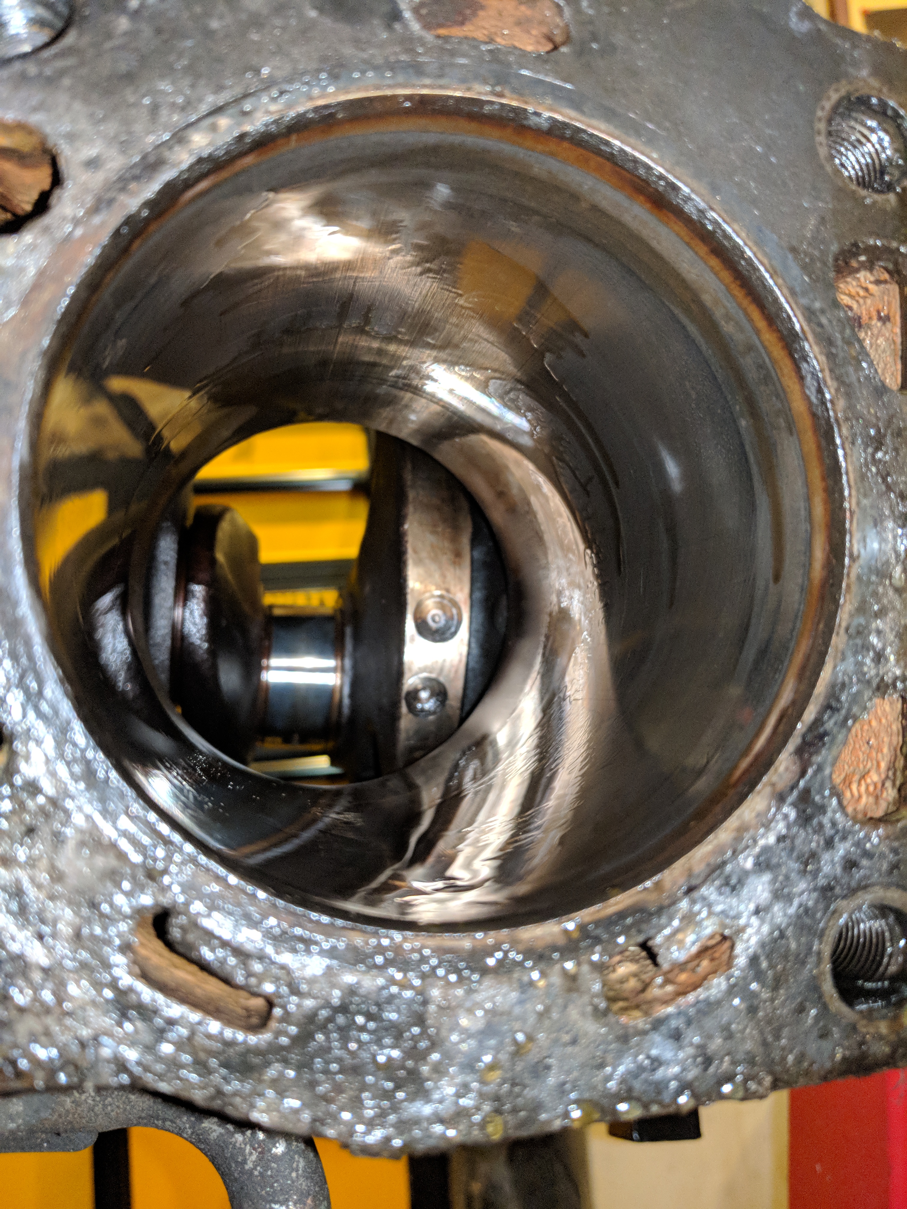

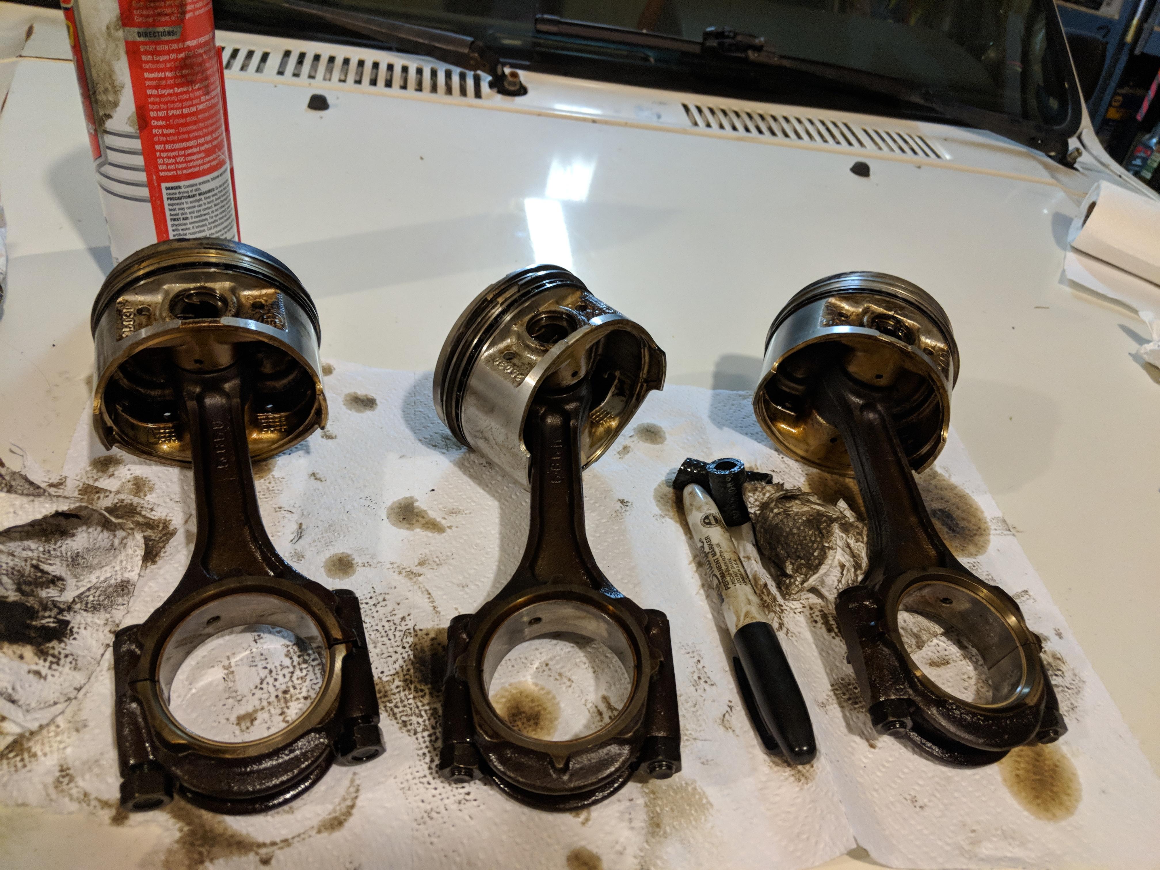

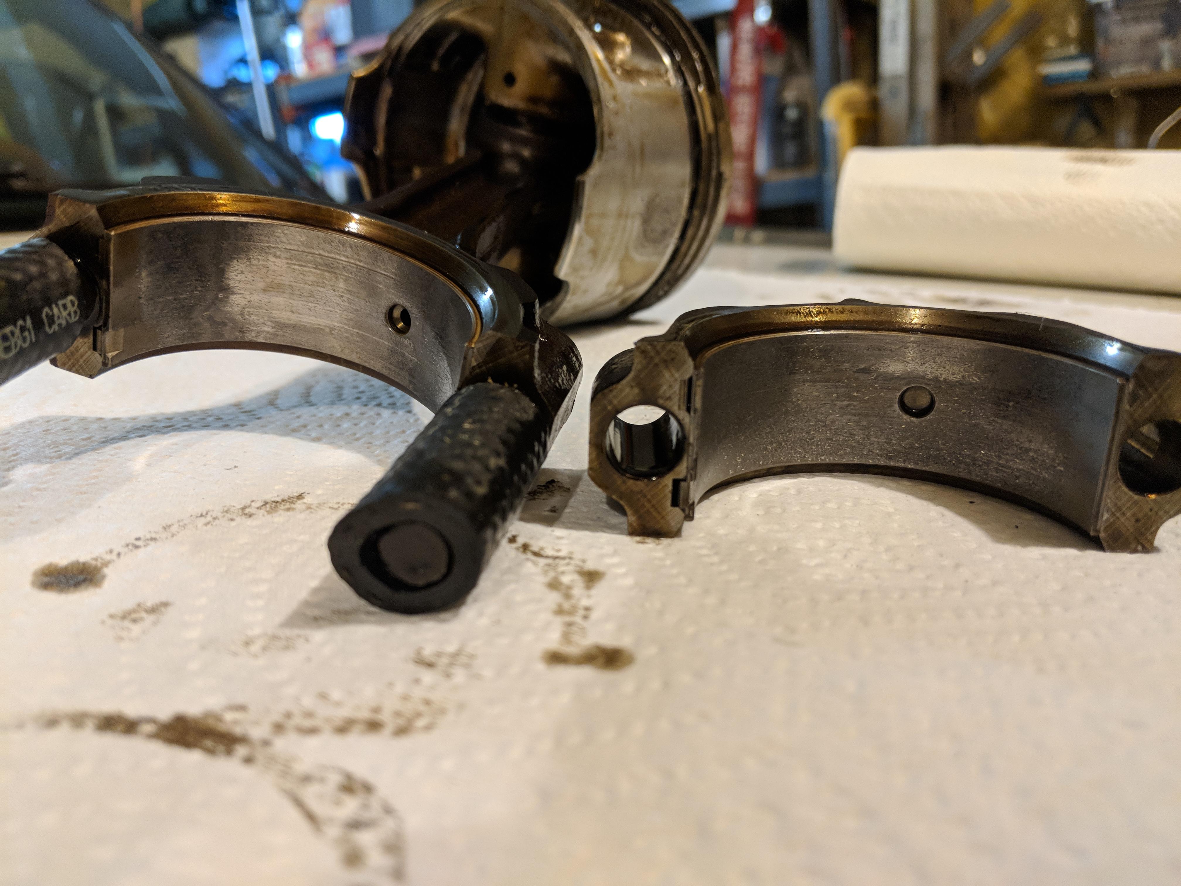

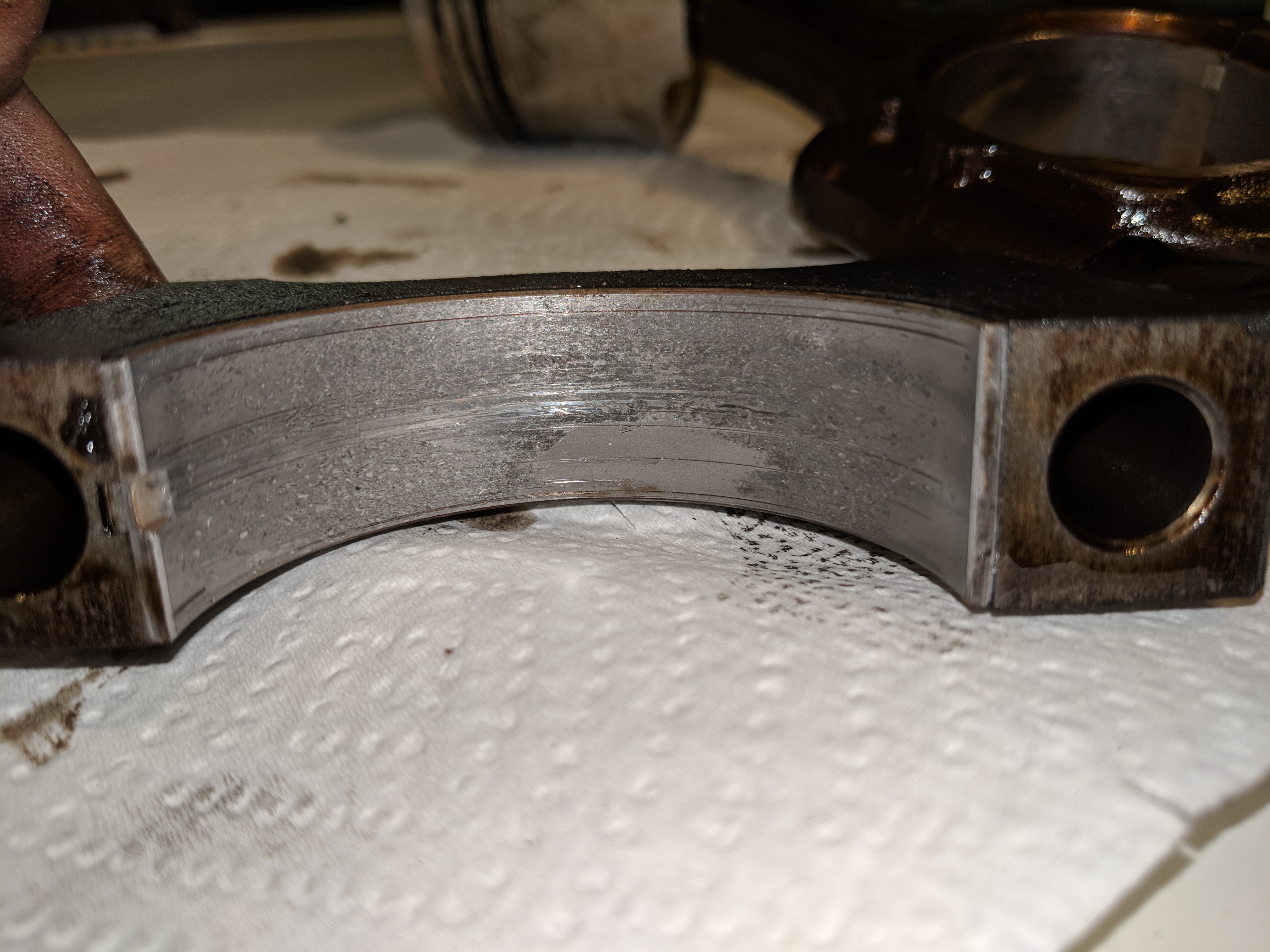

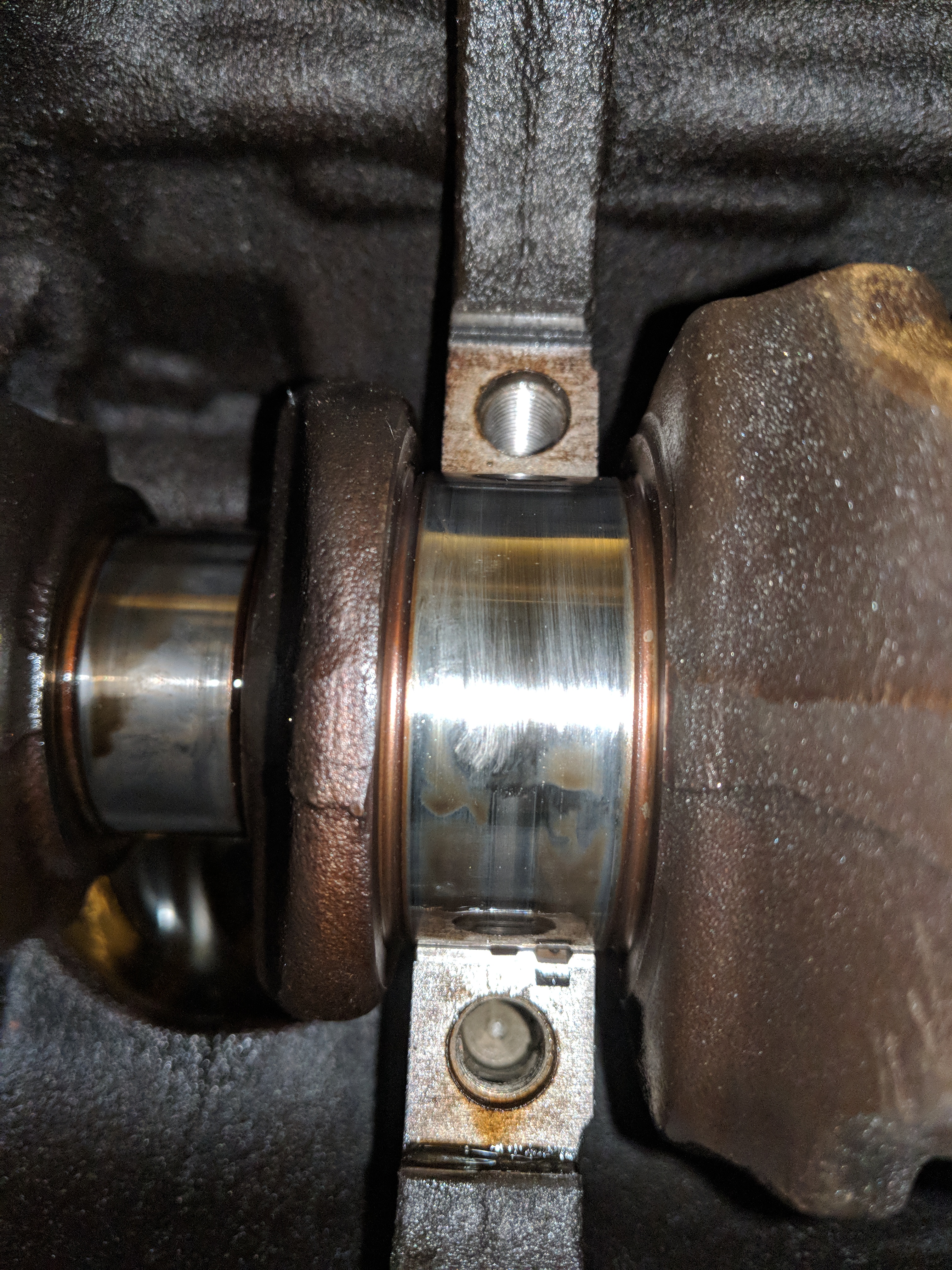

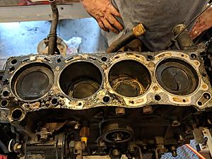

Alright, finally got a look at the bearings, they look like 180K miles and a broken timing chain guide. Crank looks OK
Also no broken rings, surprisingly, pressure loss must've all been in the head
This is all new to me, but my plan of attack after showing it to some people that know a lot more about engines than me is:
-Lightly hone the bores with a handhold drill type
-Lightly polish the crank by hand with emery paper
-Throw in stock size bearings (check with plastigauge)
-Throw in stock size piston rings
And reassemble with the new head (and seals, gaskets, bolts, clutch, blah blah blah)
Thoughts?

Sounds like a plan to me!
Grab some videos off YouTube for pointers on the honing.
