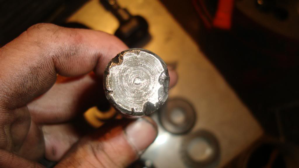

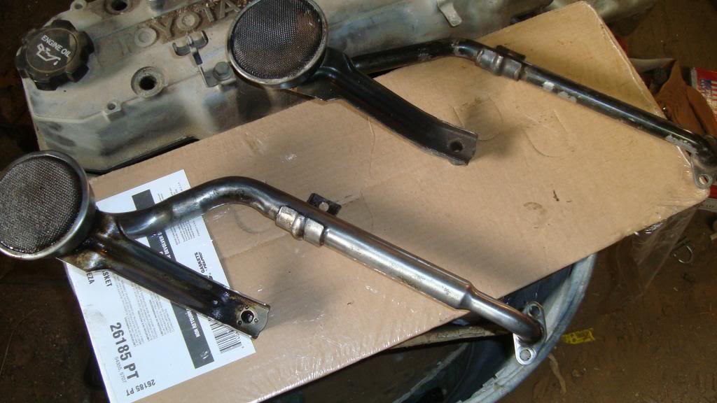

Noticed that my larger pickup tube off the 4runner engine is a larger diameter than another one of one of my other engines?? Never ran into this before and beins the one that came off the 4runner whas extremely full of sludge and dirty i was going to use the other one until i realized the 4runner one was larger, more oil flow?? makes sense so i cleaned it up and ran endless cups of diesel and compressed air through it. I also installed my rear main housing, pickup tube, and oil pan. I did some research on sealing the oil pan and found the early 22r used a gasket later 22re uses toyota fipg. It sucks cause i always hear people saying " ya i just ran down to the local toyota dealer and got what i needed" however the closest toyota dealer from my house is over an hour away. Anyways i ended up using a fel pro cork gasket and was easy on the tourqe of it. Ive also been cleaning up brackets and painting some of them too, takes forever!! Wire wheel on the bench grinder helps too. Have the day off paid today so im gonna throw some more logs in the stove beins the thermometer says its 9 degrees out now with a high of 12. Bring it on!

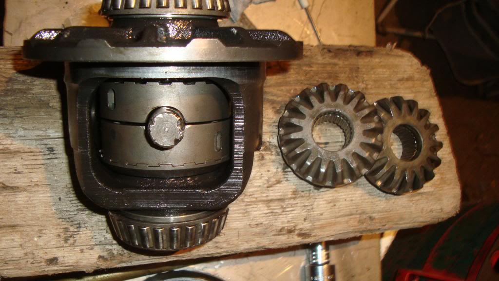

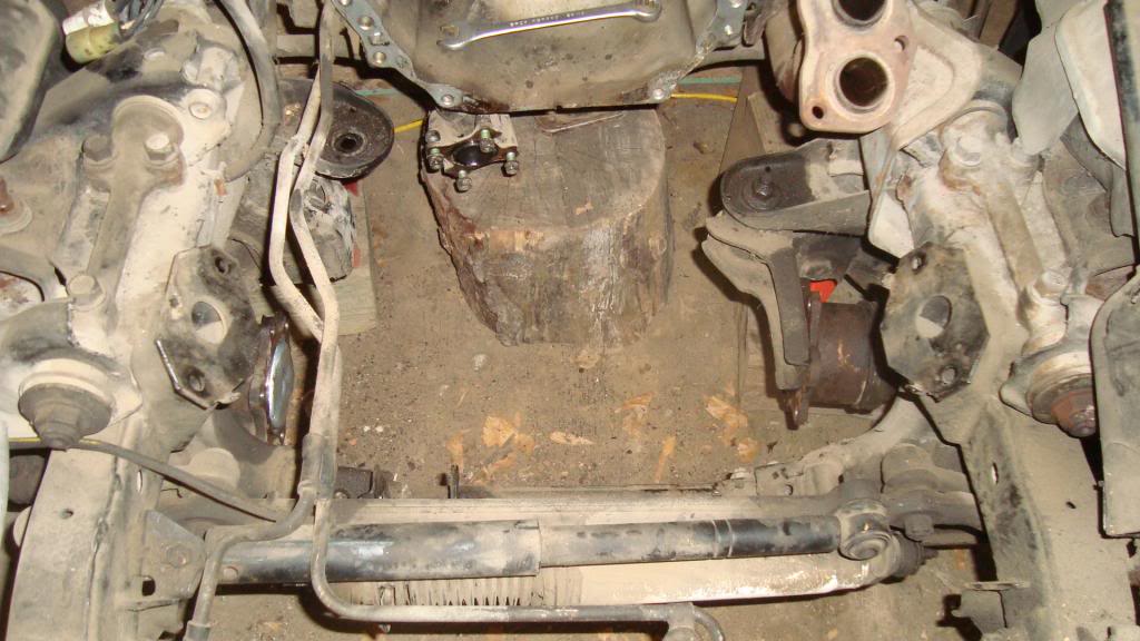

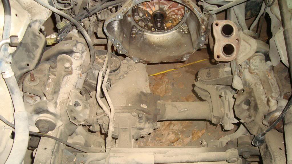

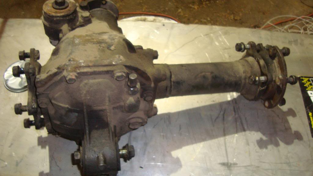

Took the front axle out. You can tell none of this hardware (bolts n what not) have been untouched which is probalbly why my impact wouldnt even break the cv flange bolts loose. Also popped the drivers cv cap off when i had a prybar in there seperating it from the axle. Hopefully i can reuse it. Gonna take it to the powerwasher along with some engine accesories to be cleaned up. Hopefully this locker wont be to tough to install. Also tryin to find some identification as to what gears is in it. Im assuming as long as im correct on the rear whick KelvinB says is 4.30s due to the blue paint on the 3rd member. The pinion on the front axle nut has no paint color indication but there is a purple paint mark on the drivers side axle flange??Hmmmmm?

ChefYota put a tad bit of locktite on the cap and put it right back on. Not sure if he had any issues with it.

I meant the water pipe. Not sure what I was thinking when I said plate. Not sure on identifying the gears.
The way I get the cv bolts broke loose is to take a long wrench and get it on the bolts and nuts to where the wrenchs get against the body in just a particular way and I roll the the truck in the right direction to break them loose. I do have some chalk blocks to keep it from rolling to far. They can be a bear to break loose. Little late now but that might help out on the next time you have to do it if the impact wont break them loose.
Never seen different sized pick up tubes. Dont think it will cause you any problems though.

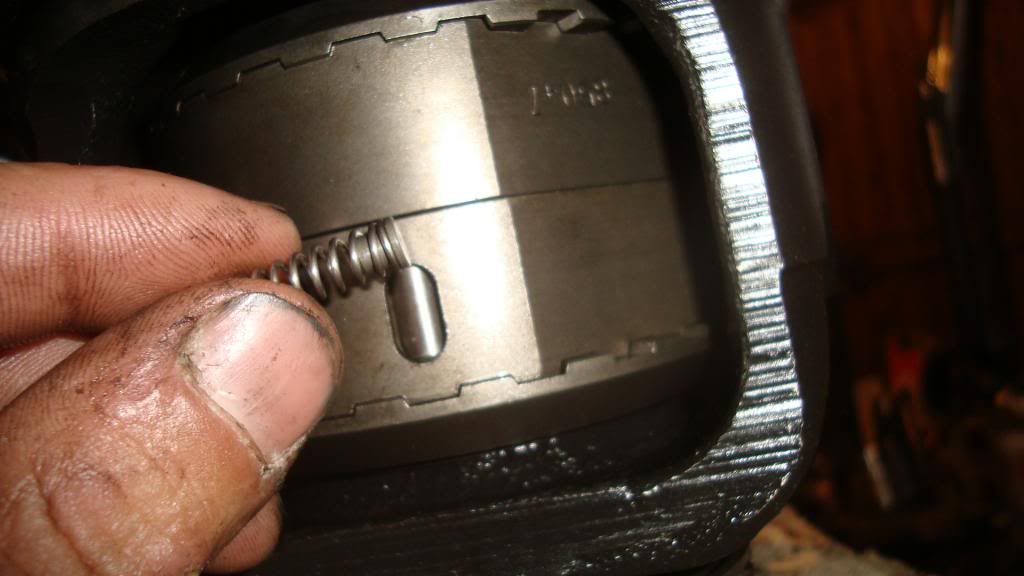

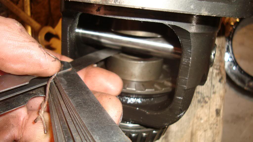

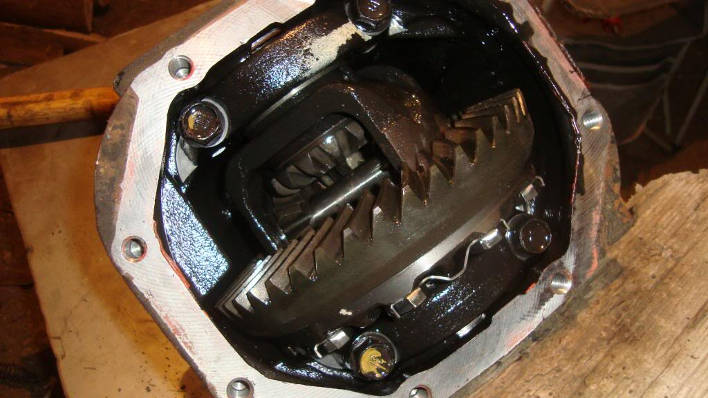

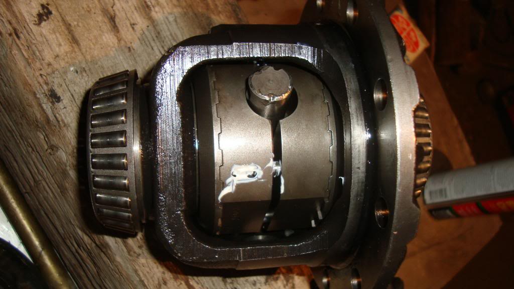

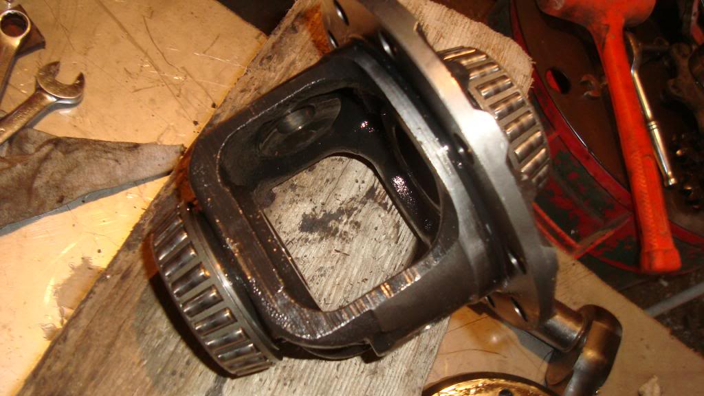

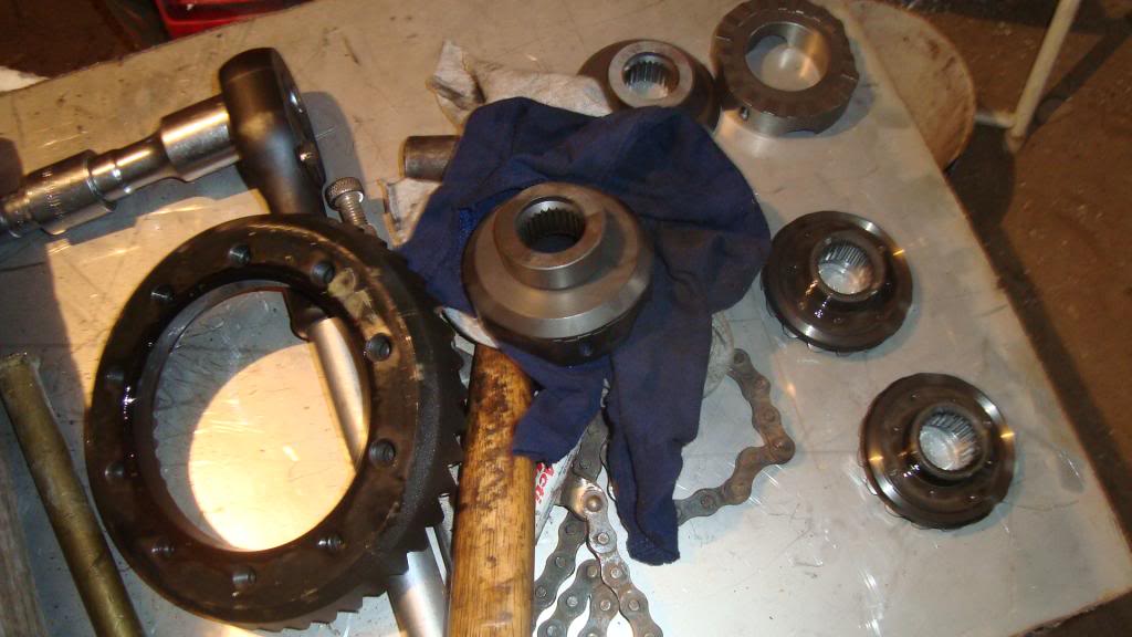

Thanks for the input Terry, snowin here now. good day to have fun in the garage!! Anyways yea i had my jackstands rockin when i brokem loose with a breaker bar ratchet and a wrench against the frame, i was like i can see it now.. man gets crushed by toyota on his day off!! that would suck. So i took the front axle out and tore it down starting by taking the drivers axle tobe off, 3 bolts... then i took the front diff cover off and used a small chisel to lightly bump the axles out. I then removed the bearing caps and identifed there positions with a paint marker ( keep all parts in same order and direction!!) I then pulled the bearing caps marked the races and put zip tes around my shims on the housing to keep them in place. After that I realized one end of my pinion shaft was dinged up and I HAVE NO PINION SHAFT RETAINING PIN!! what the heck??!! So i looked in the case and found nothing. I see no damage other than one end of the pinion shaft in the picture you can see, but i should be able to reuse it. Then i removed my ring gear, and took the pinion shaft out to allow me to take spiders and side gears out. Dont lose the thrust washers, you will need to reuse the side gear washers with the locker, the spiders and washers will not be used again. After this i inspected my carrier and bearings, ok... So then i installed the new locker internals which is pretty easy, i didnt even really use the directions which is pretty sad for a guy that would only accomplish a rubiks cube by peeling off and repplying the stickers, after you get the new internals in i checked for clearance between the pinion shaft and locker and had .008 of a inch, specs say .006 - .020. I then installed the four dowel pins and then the springs and caps, be careful... they dont send extras in the kit. All together so far its taken me about a 1hr to get the axle out of the 4runner, and a little over 1hr to put the locker in the carrier. Just need to tourque the ring gear and caps, put the diff cover on and axles in, put it back in the 4runner

As far as "setting up" i would call that doing your preload and setting backlash and checking ring gear to pinion gear mesh. However i didnt mess with any of that. There is a knack to doing that and usually only do that when installing a ring and pinion. What i did didnt require touching any of that so this type of locker you could easily do Terry. If i did do a ring and pinion or a locker that requires what i explained i would need some special tools to check measurements. My girlfreind made me come inside last night or otherwise i would have the frontend assembled back together, Only thing left is the drivers axle housing drivers axle which pops in with a c clip (easy) and the diff cover. This (lunchbox) locker on a scale of 1-10 to INSTALL was about a 3, NOW the PERFORMANCE and DURABILITY ?? he he dunno yet!! Ive heard people knocking the detroit ez locker but i got a good deal on it and i dont plan on abusing this rig just a camping vehicle with a envision of a old town canoe strapped to the top and a six pack in the cooler.
