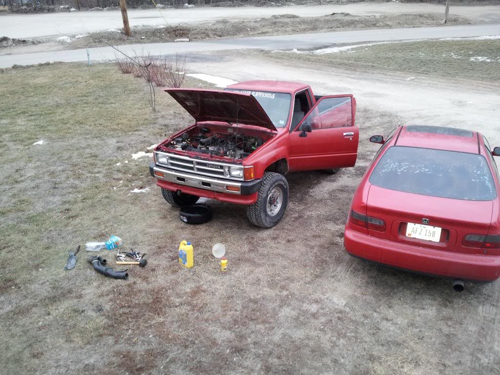

Hey guys and gals,
Just bought this 1988 pickup 4x4 last night and drove it 250 miles home. Vehicle is originally from Arizona, 22RE, 223,000 miles.
I'm new to off-road but not new to fixing automobiles by myself. When I turned 16 I purchased a 1994 honda civic ex manual and turbocharged it, rebuilt the trans and later cut out the rear quarter panels and made it rust free with new paint. i've done fuel system, brakes, trans, motor rebuilds, head rebuilds, turbos, clutch, axels, ball joints, interior, electrical, you name it. My Ag Engineering degree from U of Illinois also exposed me to quite a bit of diesel and now I'm starting as a diesel engineer for John Deere.
I'm here to read, learn and get opinions. Enough talk here are the pictures...
and my Honda civic journey...
I think i'm going to first tackle the interior with new carpet, door panels, and seats. Any suggestions are welcome and appreciated.

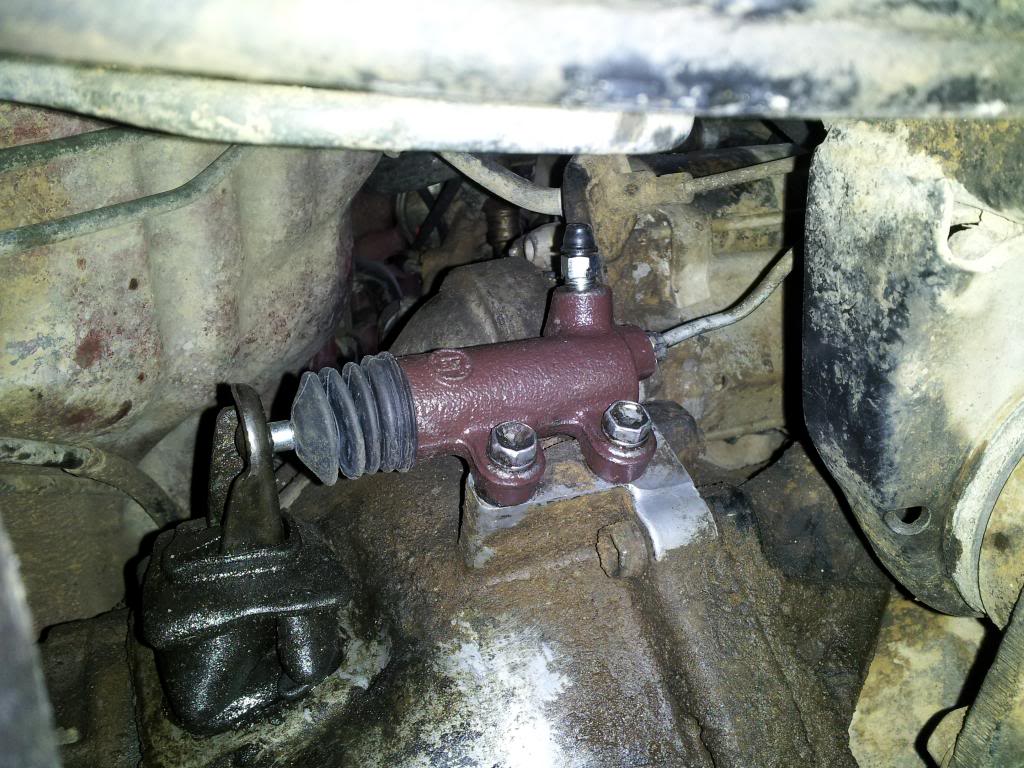

new slave cylinder

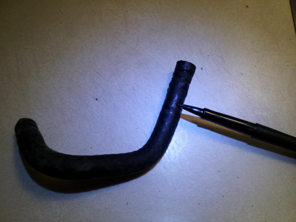

found this pin hole (video)
began the repair

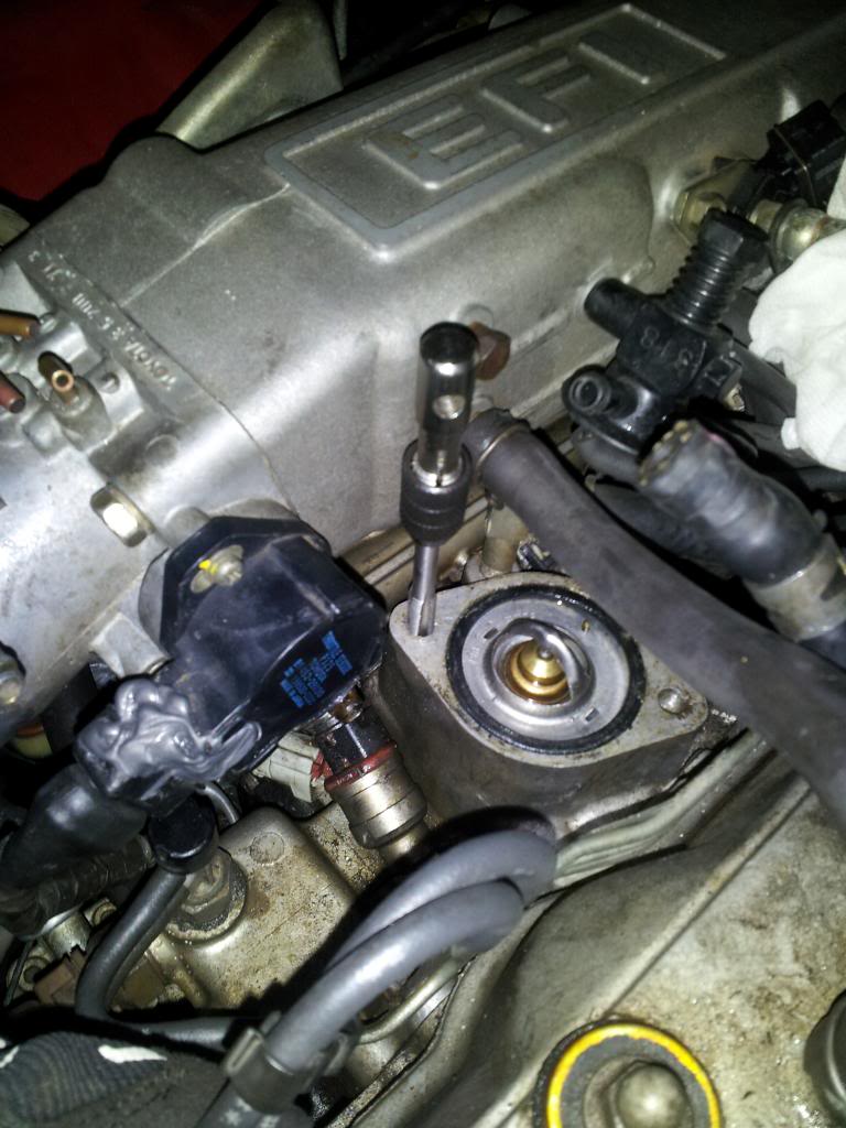

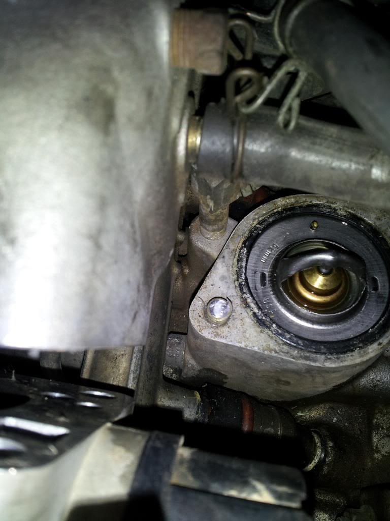

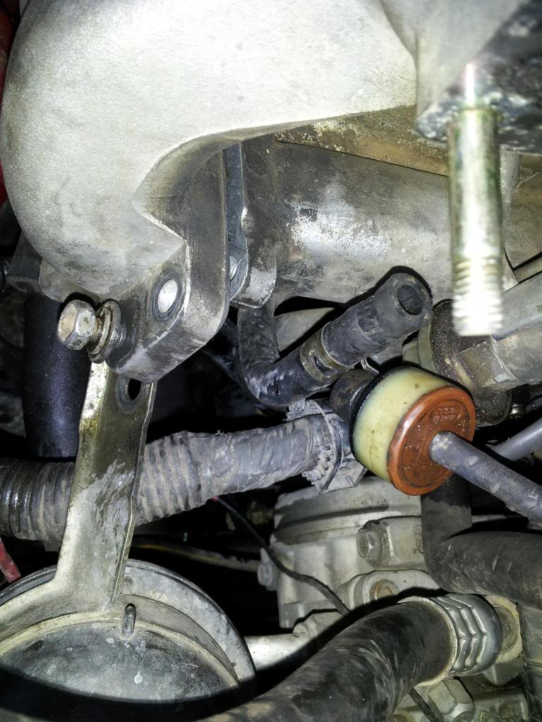

5 hours later I have the hose removed, a new one installed and figured I'd replace the thermostat while I'm at it and then...
luckily some of the bolt is sticking out, but it was 15 degrees out and I got tired of working so i'll worry about it later

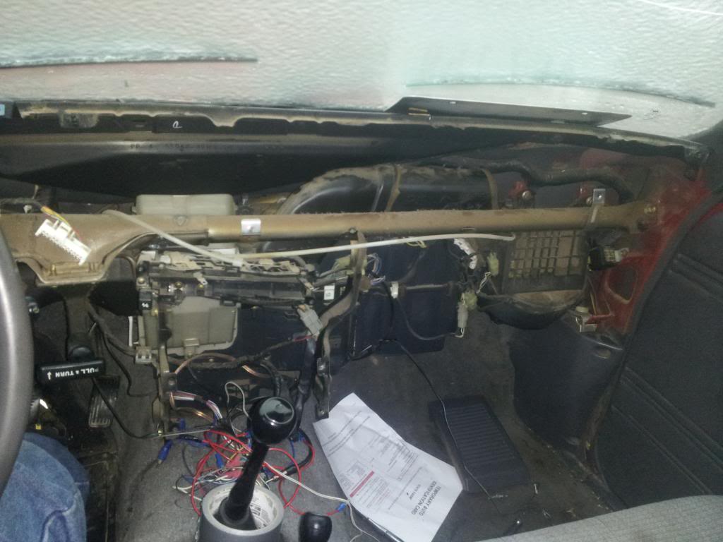

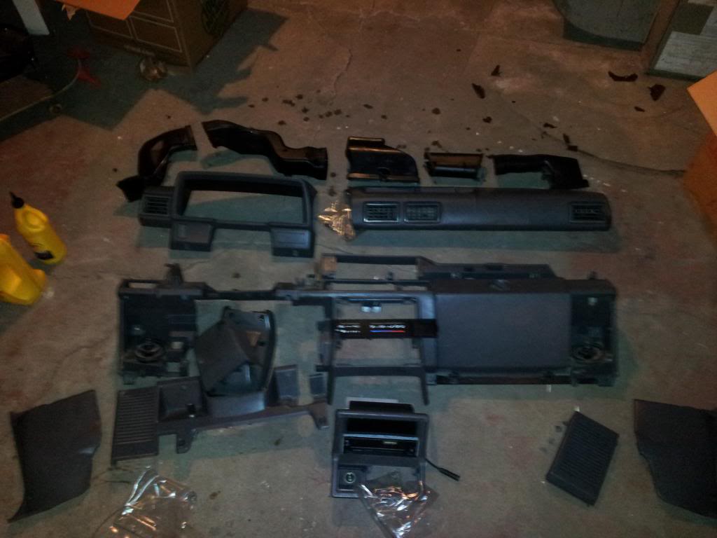

also started taking apart the dash to get a new cluster, go amber bulbs for everything, and start the restoration of dash/seats/carpet/door panels

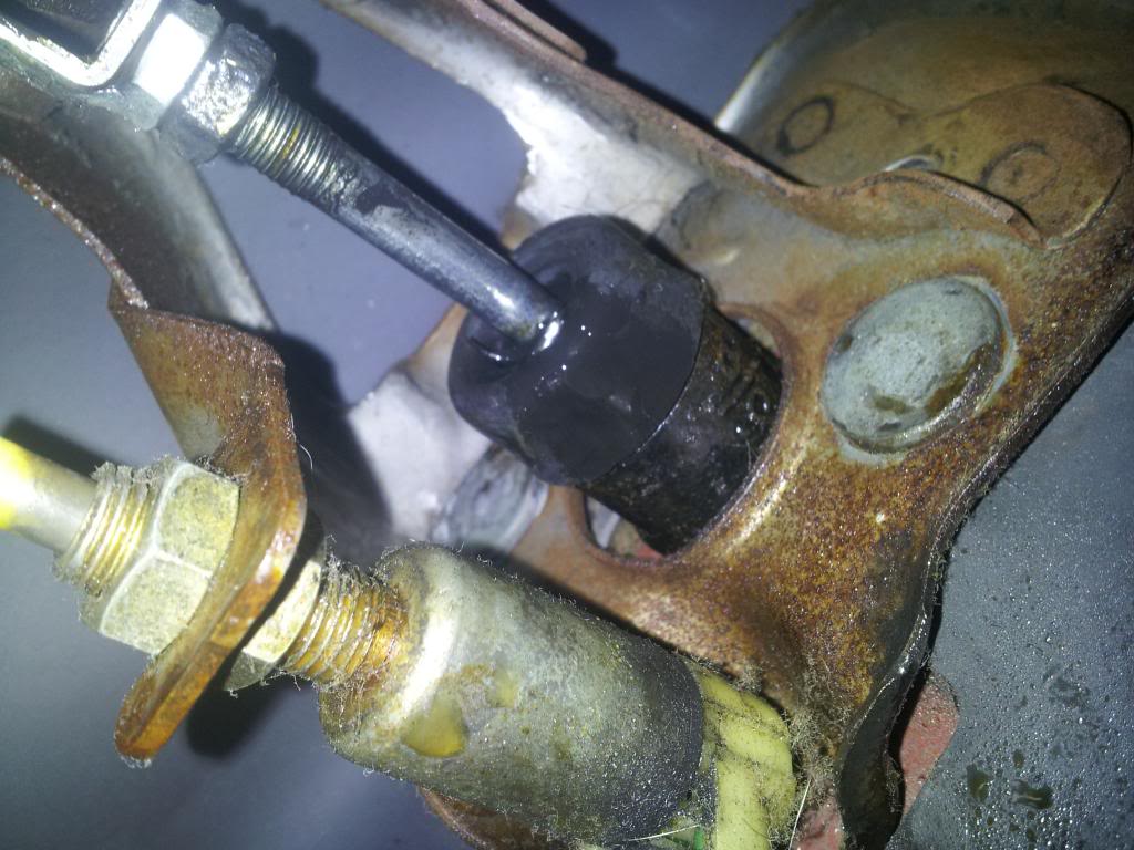

removed the broken stud.
started going deeper into the interior for cleaning.

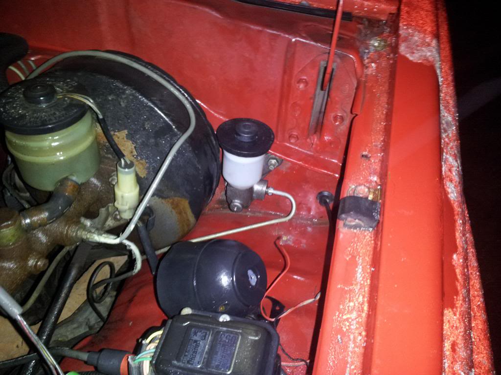

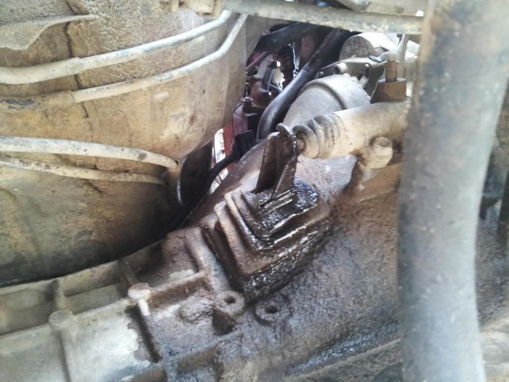

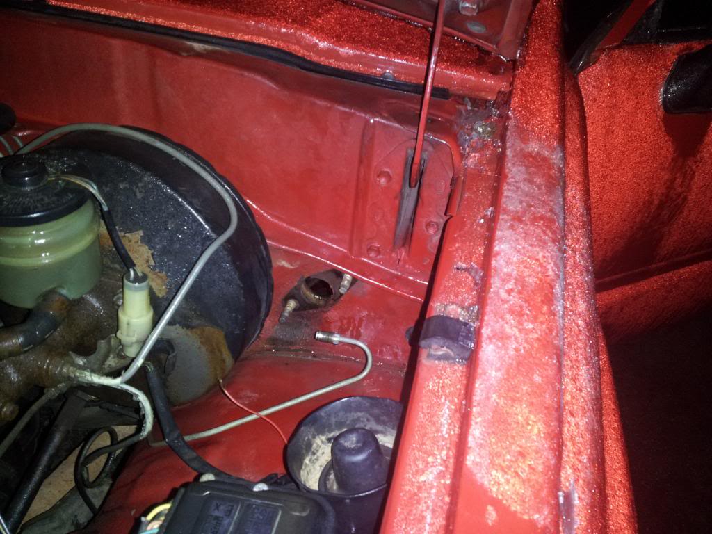

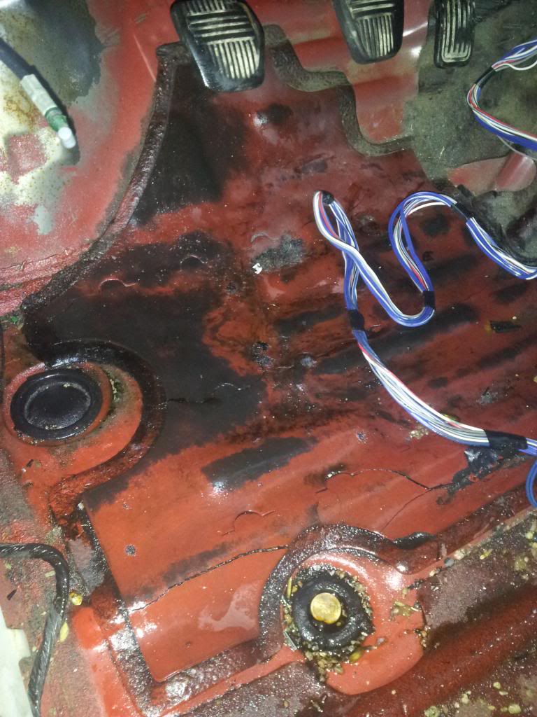

brought up the carpet and noticed a lot of fluid. clutch master cylinder leaking at the rod end into the cab. Floor board has been soaking in brake fluid for who knows how long.

out with the old
in with the new

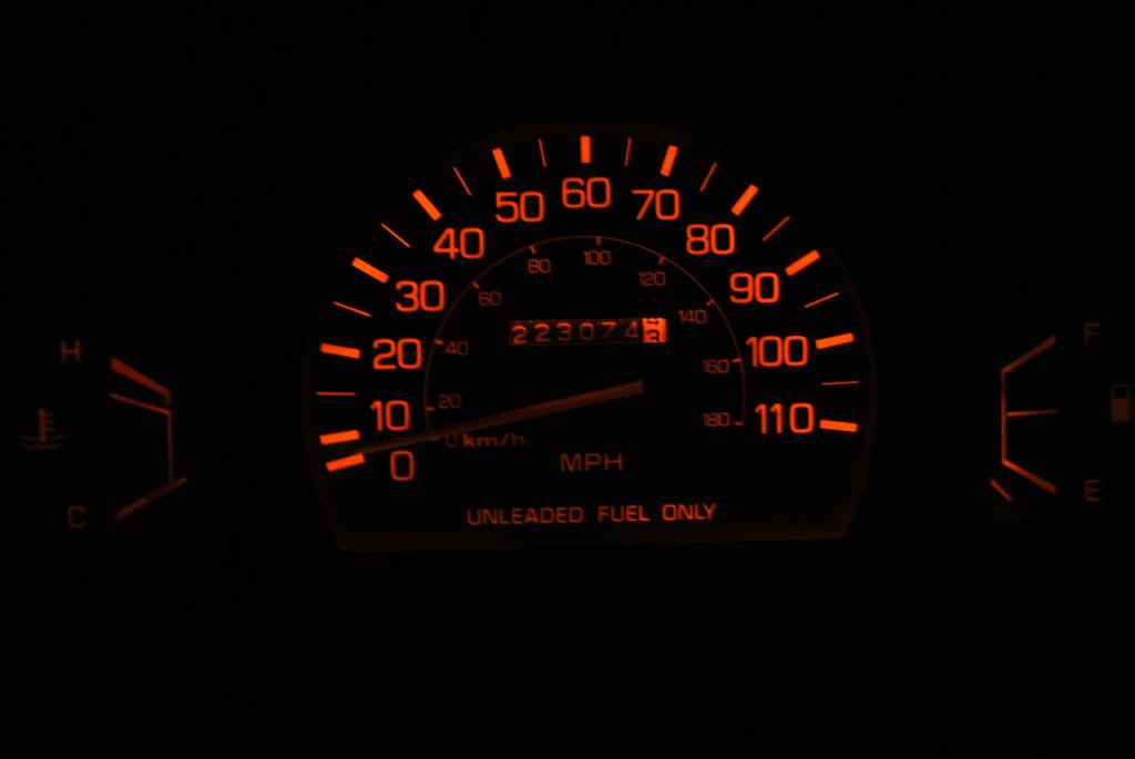

amber like the color orange. 196 for the cluster and 74 for the heater controls.
to match the civic

fixing the thermostat threads.
previous owner epoxying the broken connector to the sensor :/

before
after
i'll get a dash picture once I decide to put it back together
