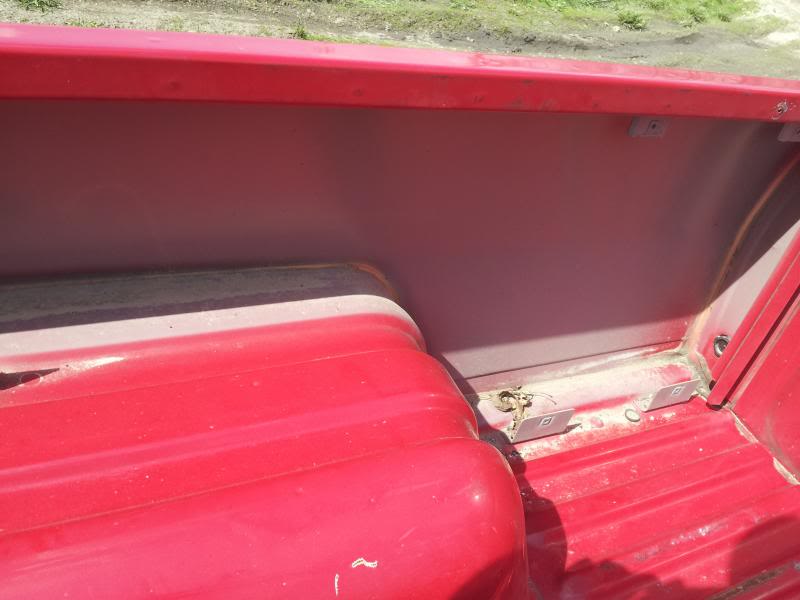

small update.
oh the joys of working with a rust free vehicle! 0 broken bolts and more rust free-ness

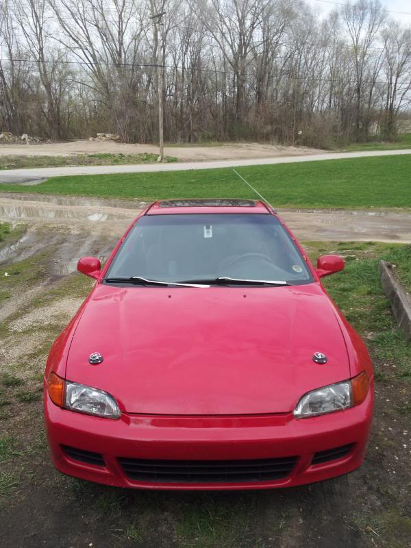

hood latch decided to let go on the civic at 65mph on the highway. invested in some hood pins and now i am embarrassed to drive around with a civic that is slow. people don't know that they are actually functional :/

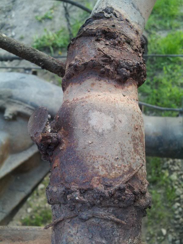

Previous owner welds like poop on a log

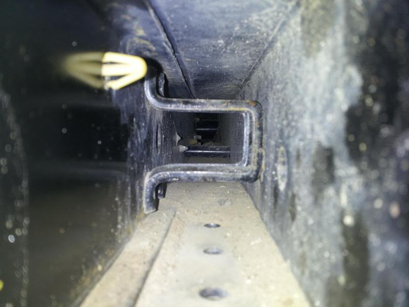

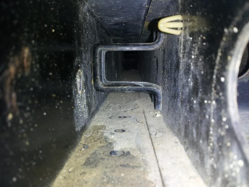

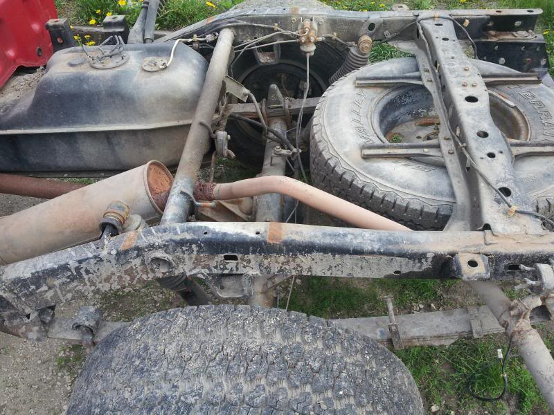

the frame rails rust from the inside out right?

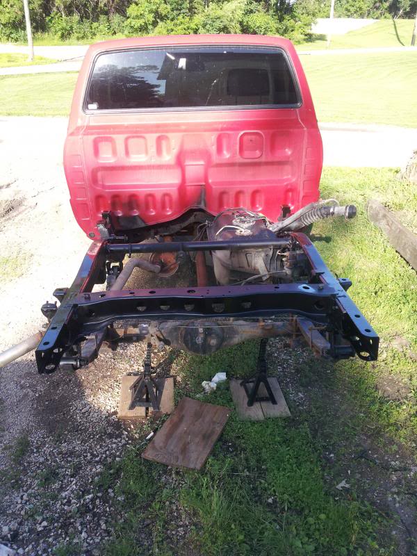

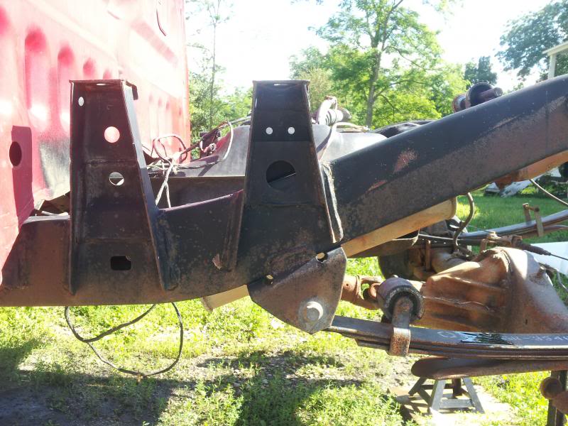

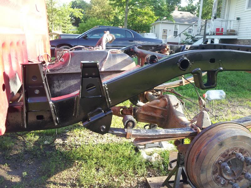

Marine-clean, Prep&ready, 2 coats POR15, 2 coats krylon rust tough enamel

Just beautiful, man. Gotta love POR 15. Thats my next project, actually. How difficult is it to take the bed off?
Old Jun 18, 2013 | 03:56 AM
  #66
Kevin88's Avatar
Joined: Jan 2013
Posts: 43
From: Iowa
not hard at all. took all of 30 minutes.
unclip the tail lights.
unscrew the flange that holds the tank fill tube onto the bed and then push it through with the cap removed.
8 sets of double nuts that hold the bed down, if i remember correctly they were 19mm.
I let them soak in PBblaster for a few minutes and they came right off.
have a friend around to grab an end and lift straight up.
i set mine down on 4 saw horses set up as a mock truck frame.

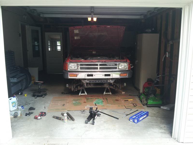

bought a house, finally have a garage to work in

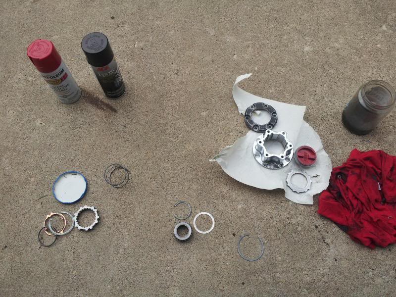

rebuilding hubs

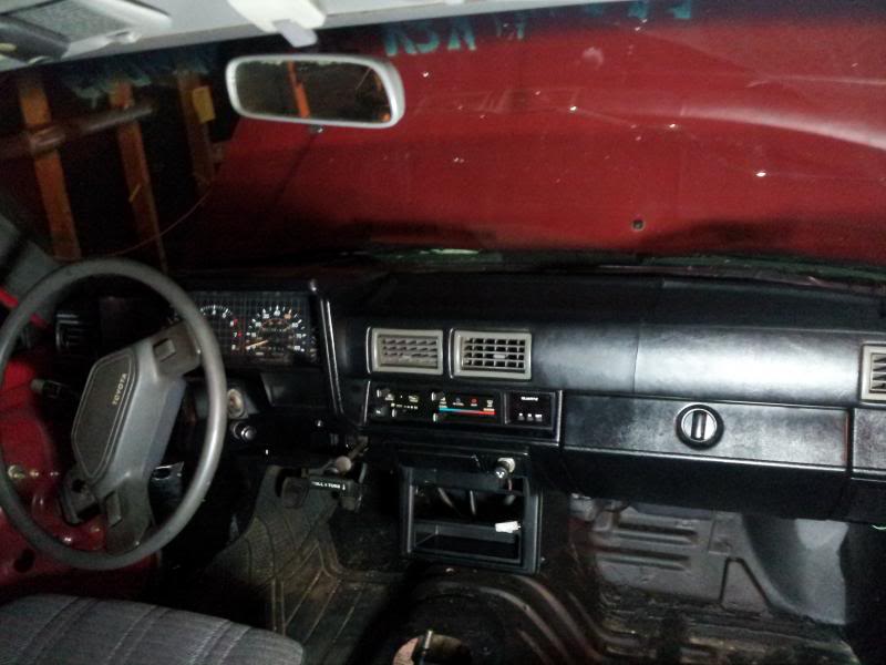

finished the interior, minus a radio

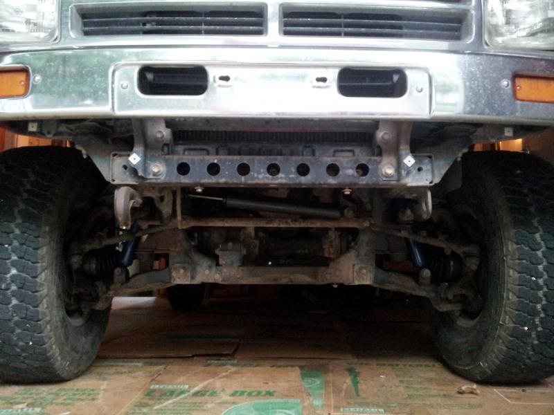

new shocks (O'Reilly's generic lifetime warranty), steering stabilizer, and axles

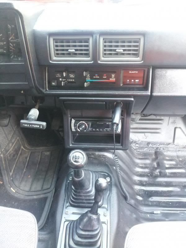

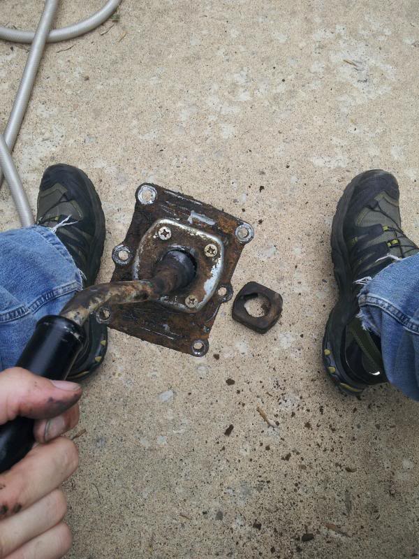

new shifter goodies
