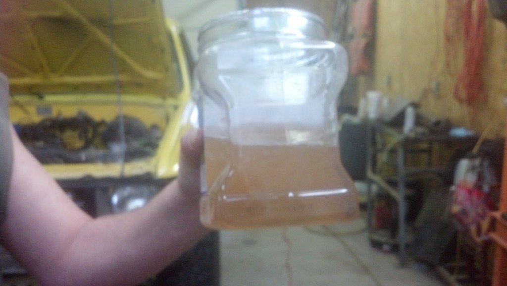

Update. I have not been able to remove the supply line from the tank, the last thing I want to do is break it so I decided to try the next best thing. I pulled the drain plug out of the tank, drained the gas out and filled and drained with water several times, then and viniger per Terrys advice I'm letting it soak I hope this does the trick.
Some of the orange gas I drained out

well good news thats about how bad my gas looked from sitting for a year+ gas should be clearish faintly yellow
the vinegar is slow so dont rush it too much slosh the truck every so often LOL

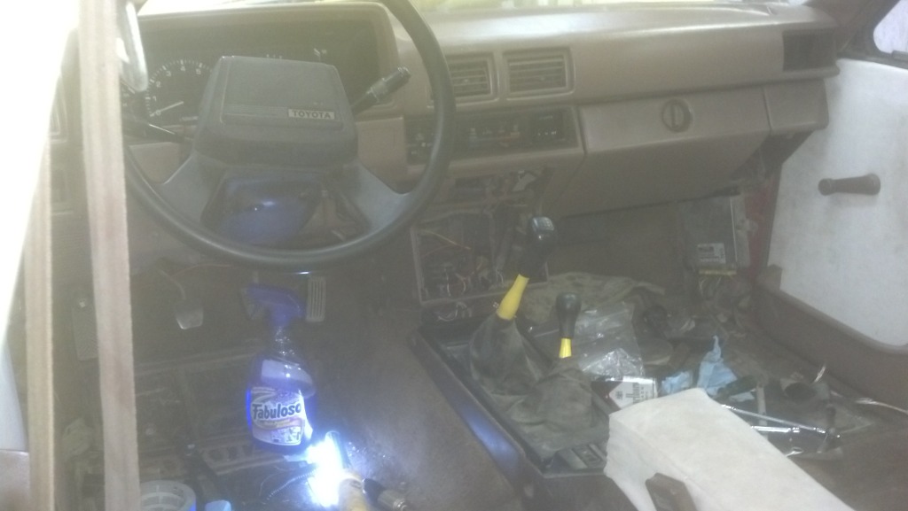

I got most of the dash painted and reassembled, also spent a little time working on the cigarette lighter working at least now I can charge my phone. I have to finish up my sterio install before the rest of the dash can go together and I will have that finished up soon.

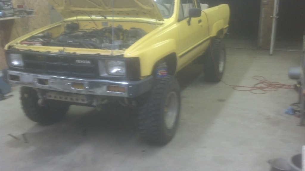

Terry and I did some tire swapping awhile back I traded him a set of 31/10.5 for his 31/10.5 mud terrains, finally got them mounted up. I don't intend to wheel this truck but I really like the more aggressive stance.
