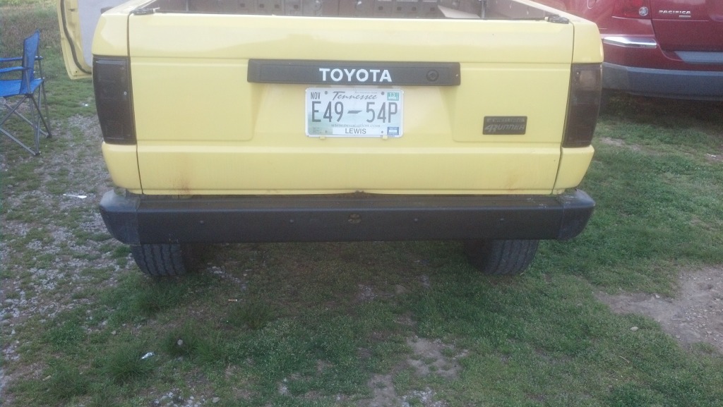

wanted to thro up a pic of the new to me rear bumper
you can really see the dent from the hydrant crash.

to be honest i was dang! lookit that awesome bumper an how good it looks with the truck!
didnt see the dent till after i read more

You've got a nice group of kids, I'm very sorry for the circumstances that brought you all together but I'm glad you had their support and they, yours.
Your new bumper looks good. Glad to hear about the crud infested injectors. Even if you do have to pull the tank and do a lot to deal with them it's nice to know what it is. Nothing's more annoying than trying to figure some elusive thing out.

Thanks man, I guess the flaws stand out to me because I know where they're at lol.

The rear bumper really helped the looks out alot. The dent is almost in the center, are you sure that isnt a factory body mod?? lol.. Those hydrants can be a little viscious. It could of been worse and that might be something you could work out at a slow steady pace. Truck is looking better each time you work on it.

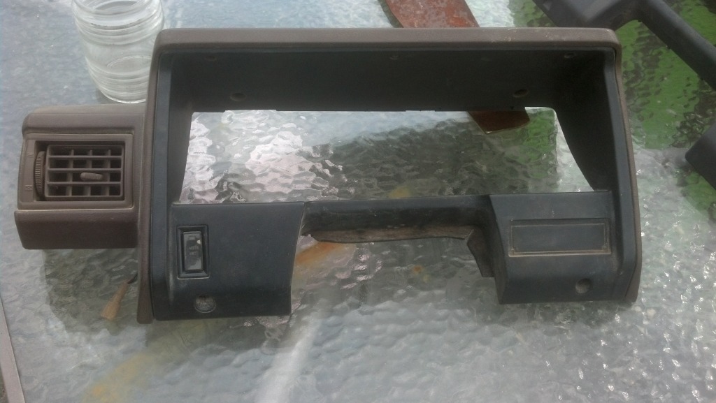

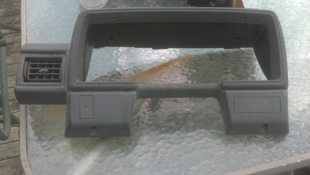

got out and tinkered a little today. pulled the cover under the seat and started trying to get the pump assembly out, the small bolts the hold the assembly in the tank came out fine no issues at all, however the main fuel line would not budge so I soaked it down and will try it again next time Im home. another project Ive been wanting to get to is swaping dash pads with the one in the 84 pu, its not perfect but much better than the one in mine. Not nearly as big a project as I thought it might be managed to do it with out breking the a/c vent on either truck yeah me LOL.got the one put back in the pu but want to paint the one going back in the runner so it will have to wait. another thing that since I noticed the last time I was at terrys I noticed something differant about the dash in both his runners, the bezel around the gauge cluster was diferant than mine. more rounded edges and just a softer look, I really wanted that for mine. well the salvage yard across the road from my house is going to crush out a close up so I wanted to just see what they had and low and behold they had one of the bezels I was looking for. the old man that used to own the place past away a few months ago and his son took over and he doesnt want the salvage part he just wants the wrecker bussiness anyway he told me if it wasnt engine or metal parts just take it so score for me.
old one

have to paint it but the grey covers really well with the brown so no biggie.
