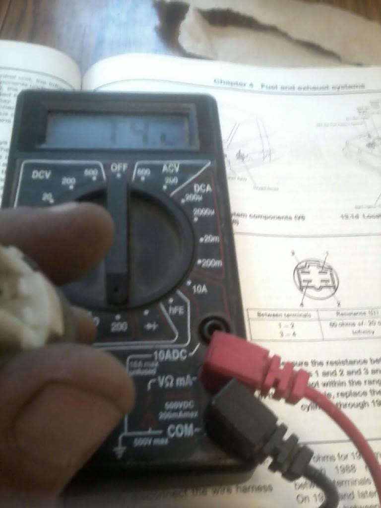

Jasons starting with the CSI loose is confusing. To me it says it is getting fuel, fire to the plugs, and injectors are operating. Then tightening it back down it wont start?? Could this be a vacuum problem like the fuel not flowing?, not the vacuum hoses at this time.
Below is a post I am adding to for no start problems and is what I talked to Jason over the phone on. We also compared vacuum lines over the phone and his matched up to mine. We also verified all of his electrical connections as in sensor plugs etc...
I will be searching the internet for some more troubleshooting ideas. We did go thru the troubleshooting section in the Haynes Manual. I have an 85 FSM that I will go thru and see if I can find something in it as well. Any suggestions???
Copied....
Injectors looked clean. I cant see all 4 failing at once.
Swapped with spare AFM. Will run more test if suggested, but it will run on starting fluid.
Swapped coil and igniter. Will run more test if suggested but it will run on starting fluid. I feel the ignition is working.
Fuel pump is pumping. Also jumpered Fuel Pump and it would operate.
Changed Fuel Filter.
Ohmed out Main Relay. Mine you can hear and feel the relay operating. Ohmed out at 74, book has 60 +/_ 20. Two other relays had same results.
Visual and metered all fuses under hood. Will do kick panel later.
Have checked all grounds and they are good.

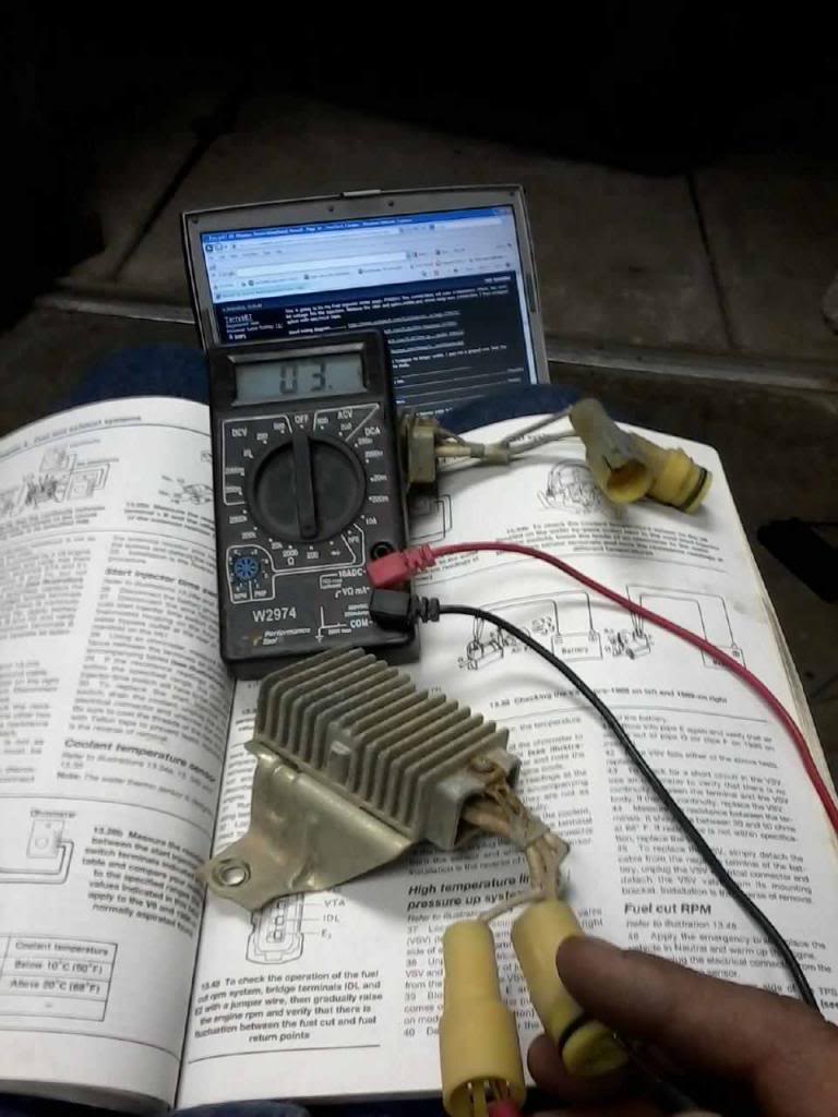

Checked Solenoid Resistor. Book says 2-3 Ohms, Mine was 3 Ohms same on another Solenoid Resistor. With key on I have 12 volts, key off I have 0 volts. I believe this is correct.
I trust my soldering and removed crimps in harness some time ago.
The Solenoid Resistor passed it test. So I will be giving some of the suggestions you guys have mentioned a try and also start looking into my fuel regulator and dampener. I have been looking at the Haynes and the FSM as well. I like having information from previous problems as a reference as to where to look in the manuals. That is my reference page in the back ground. It actuallys saves some time.

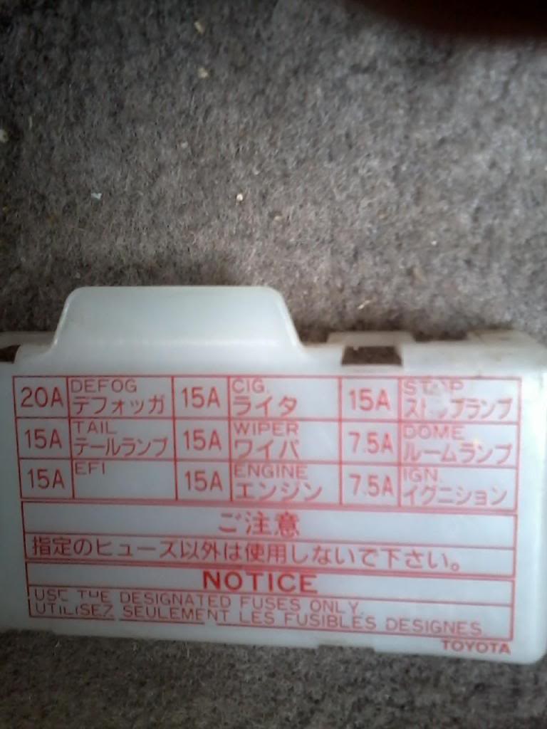

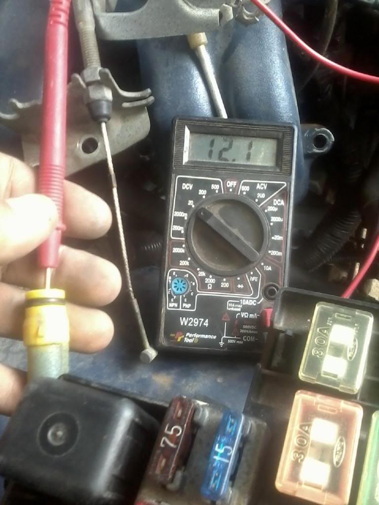

Check EFI Fuse

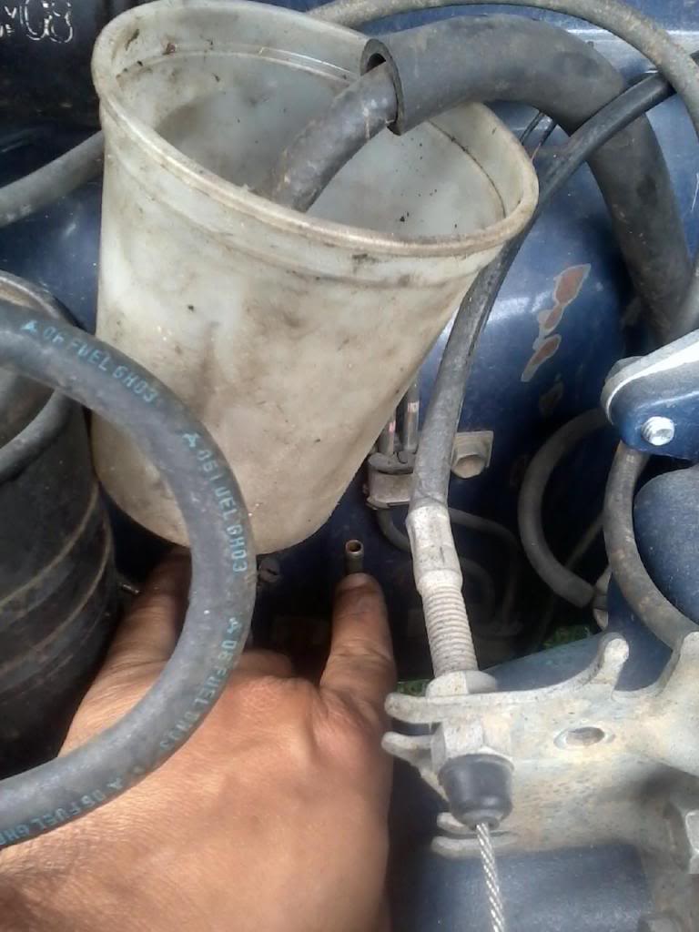

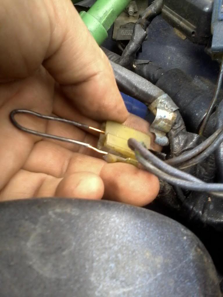

Here is how you do a Fuel Pump Bypass on the 85/86.
Jumper wire the Yellow Plug on Drivers side. ( Jumper wire should be in both contacts for testing, I just didnt have it in for picture purposes and mostly a referece for me at a later time.)
With the jumper wire in and the key turned on, I was able to fill the cup up in about a minute or so. The return hose goes to where my finger is pointing. This is the metal line that I suggest taking an air hose and seeing if it is clear all the way to the fuel pump bracket. I have seen this line and the "J" line on the bracket clogged several times.

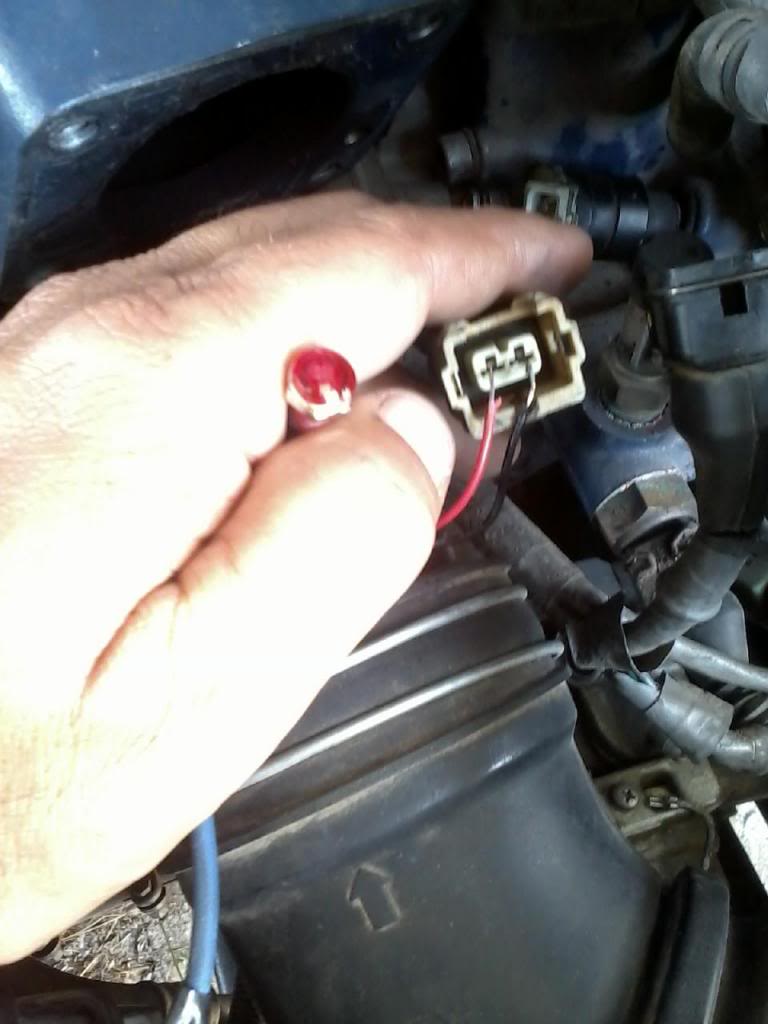

My $3 noid light. I wasnt able to find one anywhere and this worked great. It flickered each time I cranked it. I just couldnt get any pictures of it lighted.
I used the 12 Volt red one. Radio Shack Part Number #276-0270 Name:  airleak4_zps660af941.jpg

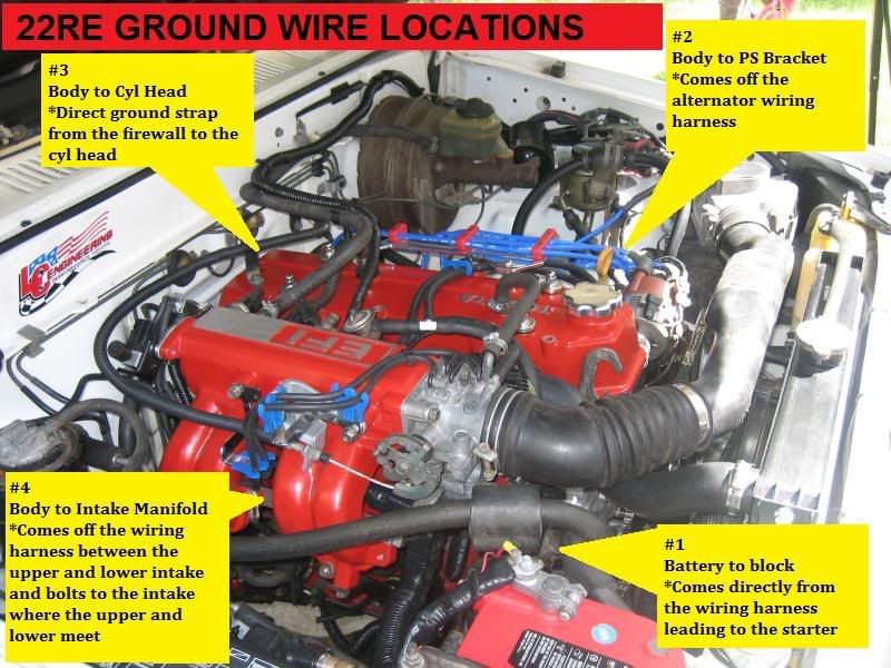

2.Check the Ground on the far rear of the intake nut.
3.Check all grounds. https://www.yotatech.com/forums/f116...-guide-194413/

7.Run Resistance checks on Fuel injectors. There are atleast 3 different types of injectors. Do Not put wrong ones in. Could ruin computer. Pg 4-2
Link to different injectors.. https://www.yotatech.com/forums/f116...ectors-127606/
