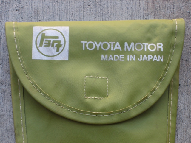

Forgot to post this yesterday....found a really cool TEQ bottle jack tool bag. It's used to hold the extension and handle portion in that 82' Supra.

Wow, that bag is in unheard of good cond! Nice find!

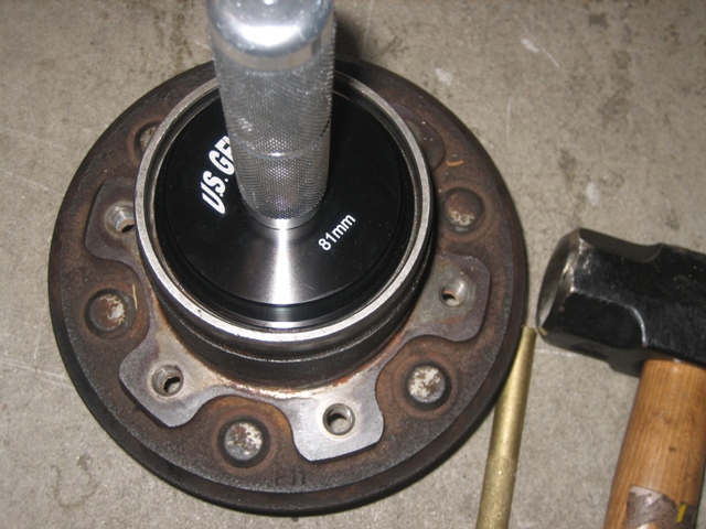

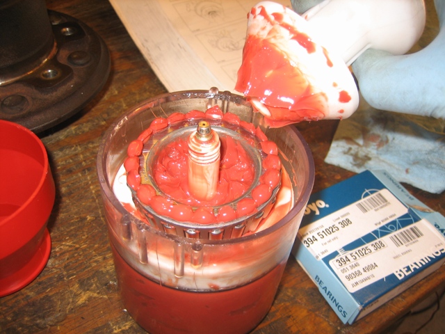

Anyhow, finally replaced my front rotors, brake pads, inner/outer hub bearings, and re-built my manual hubs! I have a lot of pictures and thinking of doing a How To, but there are so many steps. If I hear there is a use for one I'll start working on it.
Some notable mention tools during the process is a bearing packer and bearing race driver kit from harbor freight. The kit was on sale for $29.99 and I also had a 20% coupon off of that. It sure made punching those bearing races in real easy.
Lisle bearing packer, made it real quick and easy. Notice the koyo bearing? If you look close you will see a part No. 90368 49084, that is the EXACT same part no. that Toyota uses for the bearing. So like I and others have mentioned on other threads/posts, purchase koyo bearings (if you want OEM equipment) from a regular online parts store rather that the dealer and you'll save yourself a lot of money!

The inner bearing race uses the 81mm from the kit

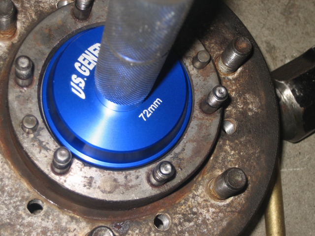

The outer bearing uses the 72mm

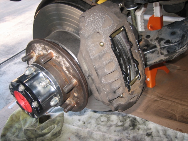

Done! if anyone needs a write up let me know

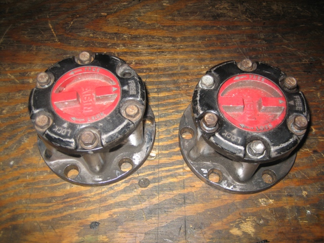

Also stopped by the yard this morning and found an extra set of Aisin manual hubs for spares.

Nice work on the front end. Good deal on the tools.

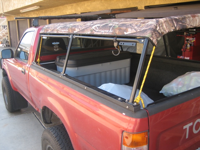

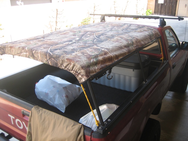

What ya think? Original isn't it?? hahahhha
Working with a girl at work who's taking sewing classes and does stuff on the side. Just the top so far, going to come up with a better anchoring system than the factory can-back did and use some black rope.

Dang grego. That looks really sweet. Totally digging the look. She outta open up a mini business. I'd be down to buy a bikini top version for my 4Runner.

Very much agree with Richard, nice! Your Co-worker Wanna make a gray leather shift boot? Haha, I know, that is a whole diff pain in the butt and..... she's not for random hire, haha. I will be calling that uk biz that does that.

Nice, Grego; Both on the top and the kayak shot.

You are right about using the factory bearings and they are available at a much better price. Sometimes just got to do a little shopping around. I try and put the part number into ebay and have some luck with that every once in awhile. I am trying to assemble a list of different suppliers.

sweet top. i would have gone with this pattern for your red truck

Toyo....that's a cool pattern! but too "techno" for me....

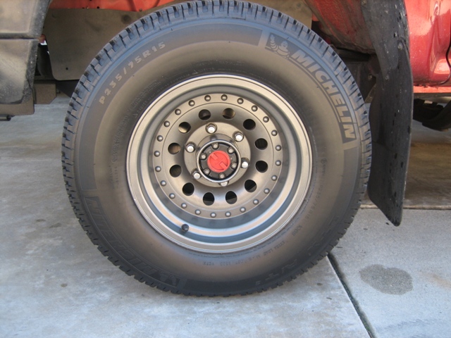

Richard! I missed your last post! F'man...I would've given you those things! Actually, I don't think I would cuz I wouldn't want that burden of guilt. They had a lot of tread but were 8 years and 6 weeks old from mfg. date, cracking, and lopsided. Three of the tires needed weights covering about 1/4 the diameter of the tire and 1 needed nearly half the diameter filled with weights....AND they still weren't fully balanced. Just as a joke I asked the guy at America's Tire if they wanted to buy them, he got really wide-eyed and said "I wouldn't touch those with a 10ft. pole! that's just a liability waiting to happen! The mfg. date alone would prevent him from buying and installing them on someone's truck. In the past they've given me like $12 for a couple of my used tires because they sell them to people who just want something to last a few more months until they replace them all.

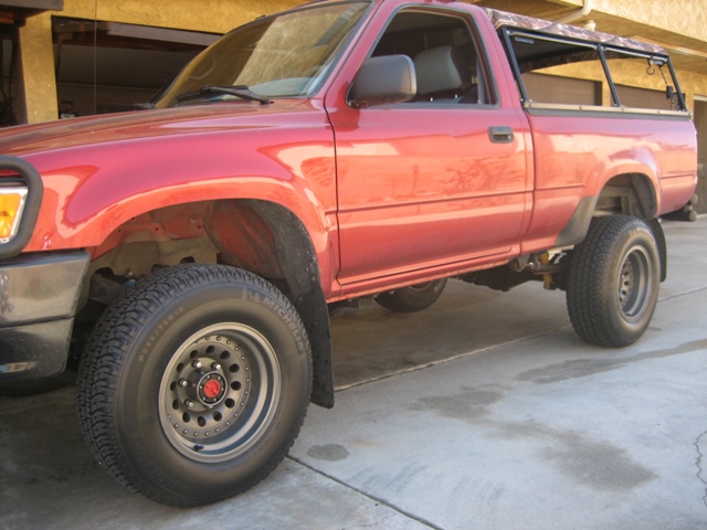

So here's my new tire, just put on yesterday. Michellin LTX AT2's - P235-75-15, they're a light truck on/off road tire. Perfect for my needs of mostly highway and the occasional dirt road and semi-wet sand. I really like them. Extremely quieter and smoother than my previous, but that's not saying much I guess!

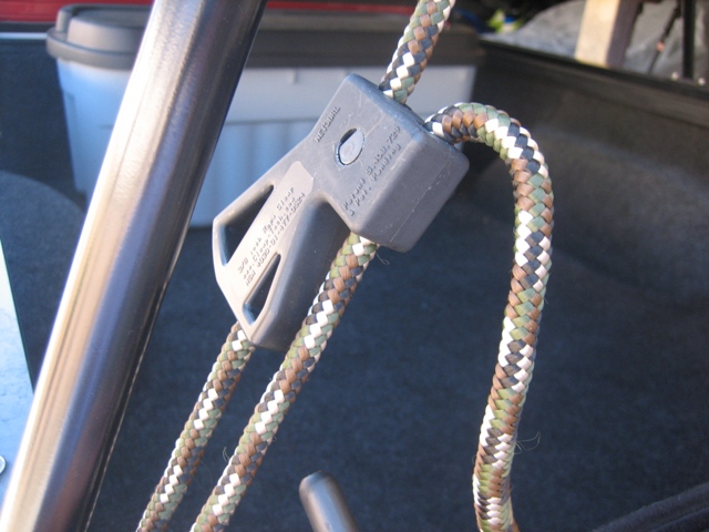

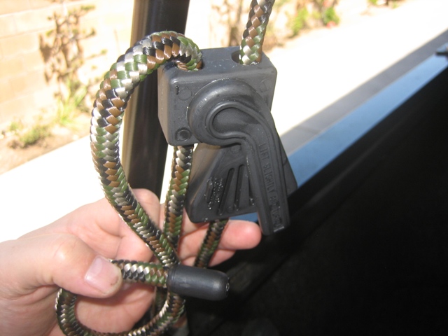

And here is my new 3/8" camo rope and rope clamps. These work great!

I want rope clamps! Haha.... Lost mine... Would Sportmart or HF or something be best? REI? Tires are nice, have nearly the same on my moms CRV..... 40k and look like new.... handle great too. Nice choice!

Those are toughman clamps....http://theropeclamp.com/store/camo-rope-clamp/
I got the 19.95 3/8" camo rope combo pack. The 10Ft. pieces were exactly what I measured to need for each side. I saw some figure 8 type clamps at HF today but they were $8 each. $25 delivered to my door was just in my price range!
