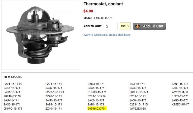

I'll be the guinea pig and order some of these and try and do a comparison. I'll likely contact Roger from the 4crawler site after receiving them and see what he thinks.
I just ordered this two minutes ago from miparts.com. $21.78 ($8 for two thermos and $13.78 for shipping) including shipping for two of them. Comes from China and takes 25-45 days for delivery. I also got 3 of the Kia ones off ebay for $24 shipped (new in box made in Korea). I haven't ordered the gates one yet, they have them at rockauto, but the cost is close enough for me to spend the extra $7 on a Toyota one. I'll take a south korean made part over a china made part all things being equal.
We shall see....

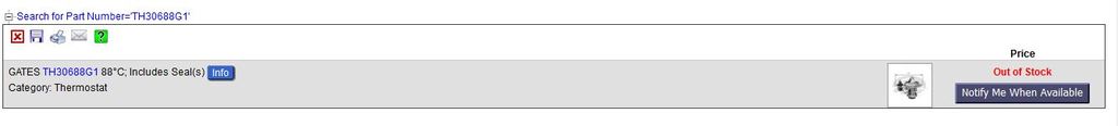

I think people are reading my thread, which is a good thing. There were 4 Gates thermostats last night on Rockauto.....now they are out of stock!

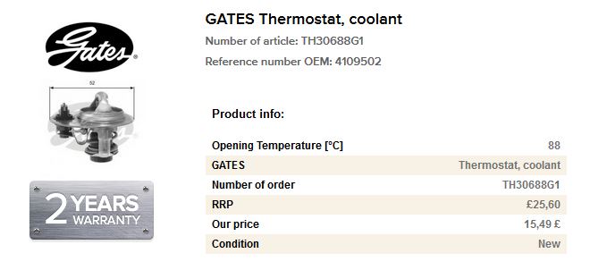

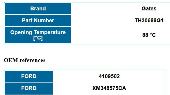

Found out that Ford uses the same thermo also. The Ford part # 4109502 and Hella has a branded thermo for it.....

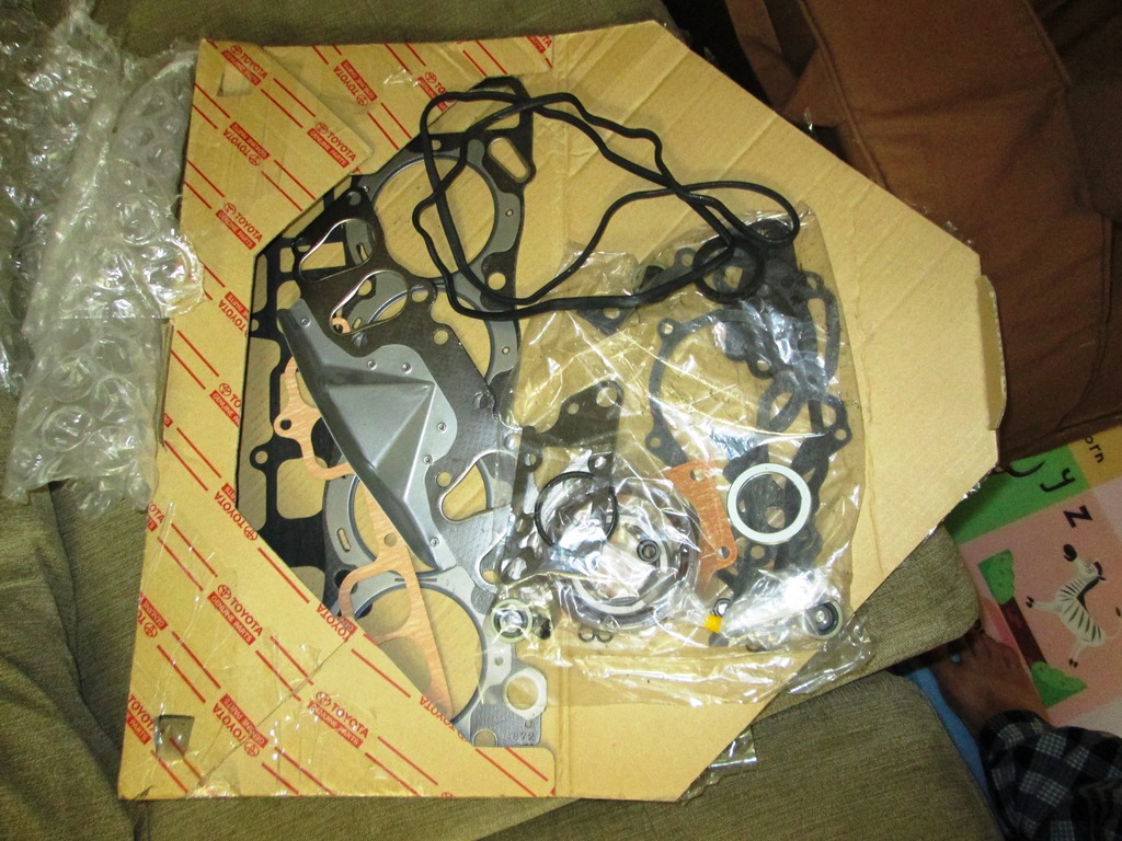

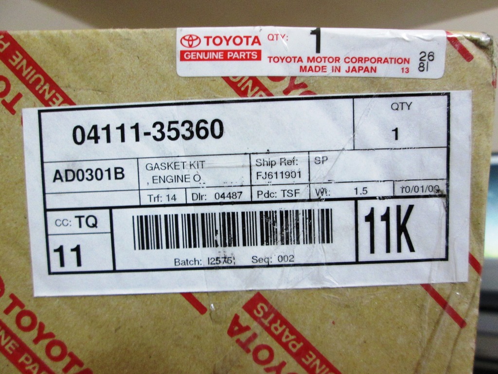

Thanks guys! My latest update is the DEAL OF THE CENTURY!!!! I picked up a brand new in the box Toyota 22RE full engine gasket kit for the once in a lifetime price of less than $24 ! Unbelievable, I got it from Goodwill of all the places in the world..who would've ever thought. I'm ready for my timing chain replacement in about 8-9 years!...
Before this, my best purchase from goodwill was a slightly used Smokin-it Smoker ($330 shipped) for $60

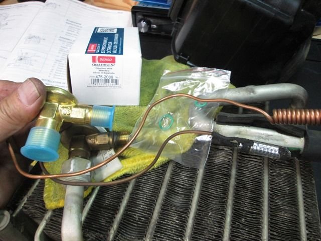

Looooonnggg time since I've posted anything. My truck still continues to run great, and some things I recall doing was changing out the ORIGINAL 02 sensors with Denso ones from Rock Auto. It was a little confusing trying to figure out which ones I needed, but figured out the upstream and downstream (Cali emission) is now the same part number. They were not when the truck was originally built back in 92', so I wasted some time trying to match the numbers on the my original 02 sensors. What I needed were two of the following:
DENSO 2344052
Fits Upstream
or Downstream
or Downstream; RWD; Calif.; Short Bed
My truck sure seems to idle better now! guess I waited a bit long and probably lost some mpg's along the way.

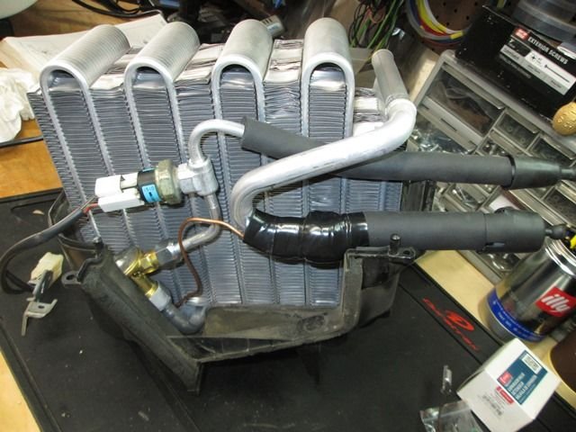

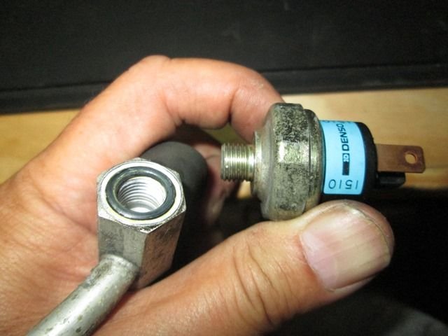

The only major issue I've had was that my A/C finally went out on me! I still had R-12 in the system, no leak, but there was no cold air, just fan blowing. My smog check guy also did some general mechanic work and he told me it had to be the expansion valve. He had the license to refill it with R-12 and it would be expensive, but he could do it. I decided to have him evacuate the R-12 from the system, and I would do the repair. Luckily our evaporators are not a pain to get to. Since I was changing out the expansion valve, I decided to just replace the evaporator at the same time. I received a made in Japan Denso 476-0048 evaporator from Rock Auto but the expansion valve was Denso 475-2086 and made in China. The expansion valve is for both R-12 and R-134, they no longer make same part that my truck came with. It was easy peasy.....using denso products means perfect fit. A little bit of following the factory manual to move things over and one hiccup with the pipe that I replaced after mangling the aluminum nut. The replacement pipe was in-stock from the following from Long Beach Toyota:
88716-89156 - $27.21 PIPE, COOLER REFRIGERANT LIQUID, F
90099-14056 - $ 2.38 O-RING - This was to replace the o-ring on the switch that I re-used (see pic below)
Cost me $200!!! to have the air evacuated out, pressure tested, and then filled back up with R-12. He was going to charge me almost $700 to do everything, it ended up costing me about $380 to do most of it myself and with a brand new evaporator!
OLD EVAPORATOR OUT
MANGLED ALUMINUM NUT
NEW EXPANSION VALVE
REPLACING O-RING FOR SWITCH
EVAPORATOR PART NUMBER
ASSEMBLED AND READY TO GO BACK IN

Nice work fixing the A/C yourself. I am in the process of a r134a conversion now. Not only did you save a lot you know it was done right
Enjoy the cold air!
