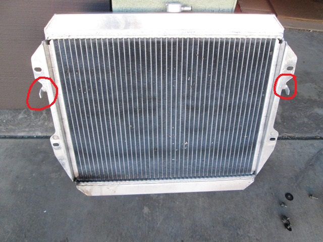

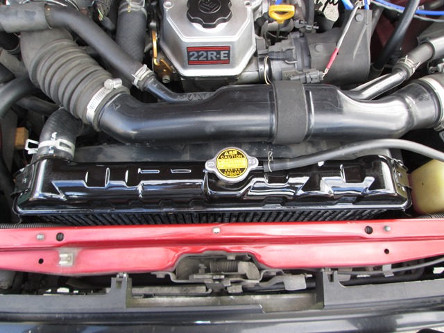

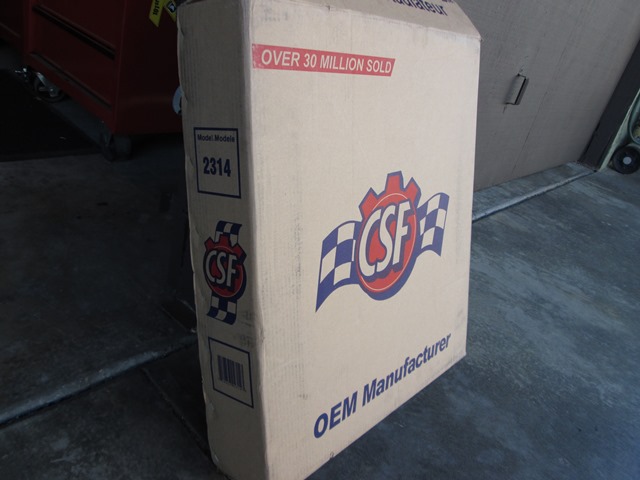

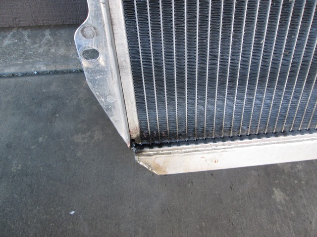

The CSF 2314 radiator arrived and in a few hours I had the truck back up and running. The radiator fit my OEM cap, a Futaba R134, and Stant 10227. I read other posts where they said the OEM cap didn't fit, no idea what happen to theirs or maybe they made some changes so it now fits. I re-used my Toyota OEM cap, kept the Futaba as a spare to use with the Aluminum radiator when I hopefully get a new one back, and returned the Stant.
One thing of note; Unlike the Toyota OEM and this aluminum radiator, the CSF 2314 radiator does not have the hanging tabs incorporated into the design. For the price of a 3-row all metal/brass, why skimp out on the design? The lack of these tabs is a minor inconvenience during install, instead of hanging and walking away to grab the bolts and wrench, you need to be more mindful of holding it up while simultaneously hand starting the bolts. Potential for damaging the fins during install increases.
My dash temp gauge sits in the same place as the aluminum, the only difference I can tell is the weight between the two radiators. Aluminum one was significantly lighter.

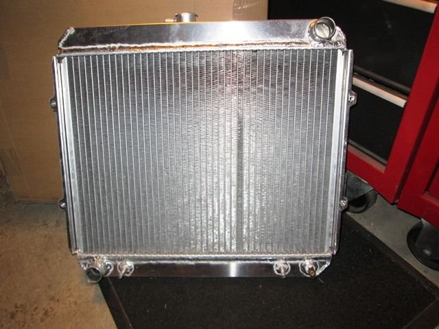

Per their instructions I typed up a short letter telling them the problem with the leak and even attached photos even though the radiator is being sent, included a copy of the receipt, email with the ebay seller, and a UPS return shipping label. The cost for me was only ~$20 each way so it saved me $10 in total. So the total cost of this warranty return will be my time, inconvenience, and $40. I'm going to call it a total of $100 in economic costs.
I had some bubble wrap and put it in a trash bag in case any fluid is still in the radiator. I also re-used the CSF radiator box to ship it back to them...maybe they will get the message of where their sales go when one gets past quality control.

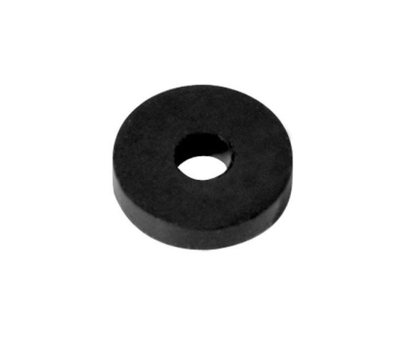

I believe the seller is referring to these washers, although I'm sure any equivalent rubber washer or vibration reducer would give the same result. I suspect the added washers may require longer bolts. If this in in fact effective, this could be a good cheap practice for installing any radiator, specially for those who added a header which increased vibration (me being one of them with an LCE header)
http://www.homedepot.com/p/DANCO-1-2...8569/203231998
Home Depot
Model # 88569
Internet # 203231998
Store SKU # 794735
1/2 in. Flat Washers (10-Pack)

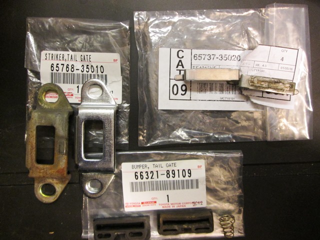

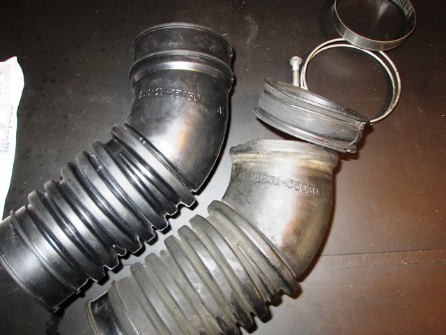

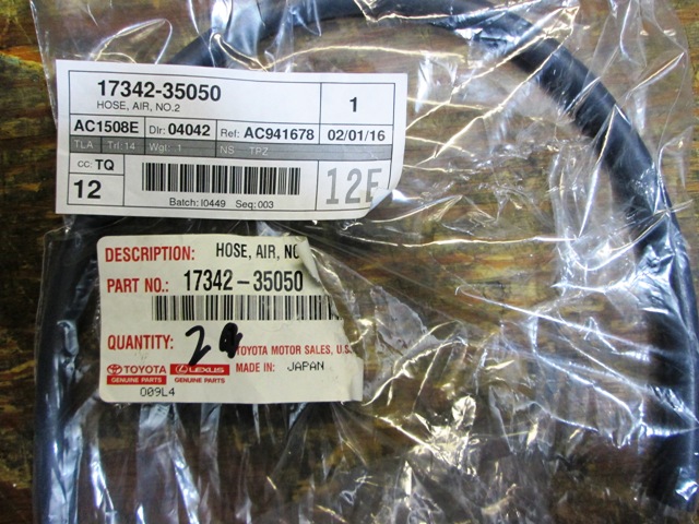

Well, I purchased some of the rubber washers from Home Depot and used them on the already installed CSF radiator, kind of pain to go back and put them on when the radiator is already installed. NOTE: I did need to use longer bolts, I have a ton of them from the junk yard so just used some that were about a 1/2" longer. We'll see what happens in the long-run.
Also replaced an original hose that goes from the throttle body to the air box. It's the one that actually attaches to the throttle body. I've wrapped the cracked one a few times with silicone tape and electrical tape and the crack would just keep getting larger and larger and then it finally came apart. I made that hose last 24 years, and it felt more like hard plastic than soft rubber! Dorman makes an aftermarket piece, but I went with Toyota.
Replaced the tailgate latching hardware, the rubber loses its elasticity, but the metal pieces I didn't need to really change. They were cheap so did it all. I had already tried inserting a spring to help support the worn out rubber like I've read on a post, but it didn't seem to help much. Included pics with part numbers for future reference and others convenience.

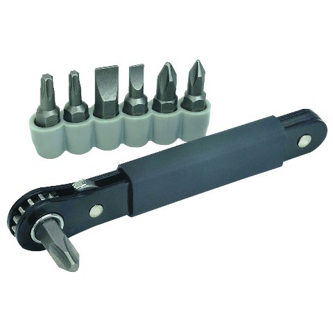

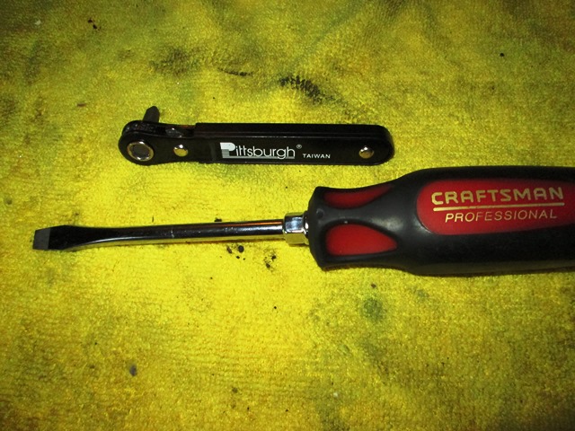

i couldn't get my timing set, I was showing about 40 BTDC jumpered and 30 BTDC without the paper clip plugged in. I spent morning to evening focused on the TPS but got nowhere. Next morning I adjust my rockers and bam! I'm spot on with my timing again. My rockers were waaayyy out of spec. Those that should have been tight at TDC were loose and likewise when I did the full rotation to do the others...both intake and exhaust were out of spec. The worse was the #4 piston exhaust side.
I guess driving it everyday I didn't notice how loud the ticking was getting, and I never noticed any hard starts or loss of power? I did notice once in a while my idle would fluctuate.
So anyhow....this two day ordeal came to an end but ruined a weekend. There were some comical events during my troubleshooting, searching, running to the auto parts store and then repeat over and over and over and over again..... but I'll save everyone the details.
What I did become was an expert at loosening and/or removing the bottom TPS screw I came up with a method of using a little $3 ratcheting right angle screwdriver from harbor freight and a standard tip screwdriver to apply pressure.

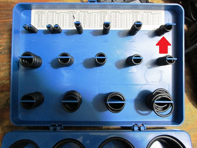

Idle kept changing and noticed my idle adjustment screw kept moving after driving around. Had to use an X-acto knife to carefully cut mine out, it was hard and flat, and gave no resistance to the screw.
I found this thread in the open forum: https://www.yotatech.com/forums/f116...g-size-250451/
I had a Storehouse metric size kit on-hand from Harbor Freight and after finding this post I was surprised to find the dimension that Mudhippy had stated in the post as the correct size: 7.8 x 11.6 x 1.9
The screw is nice and snug again

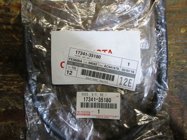

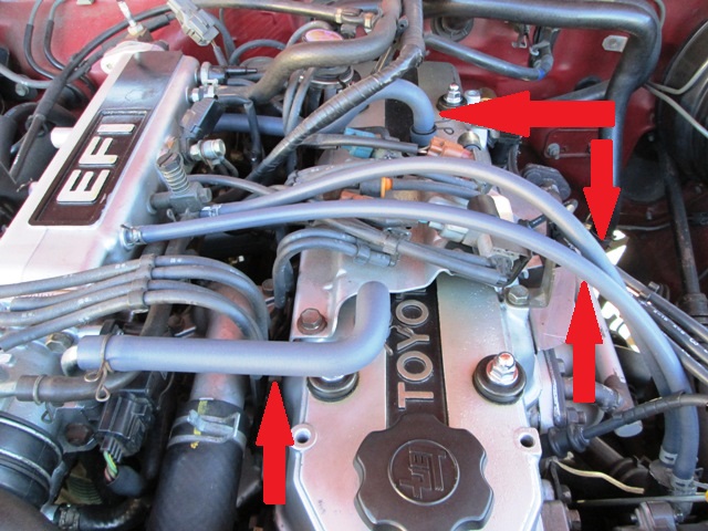

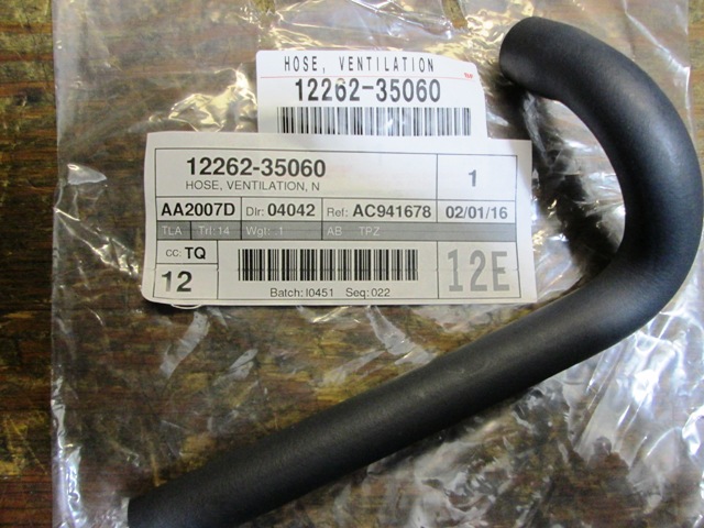

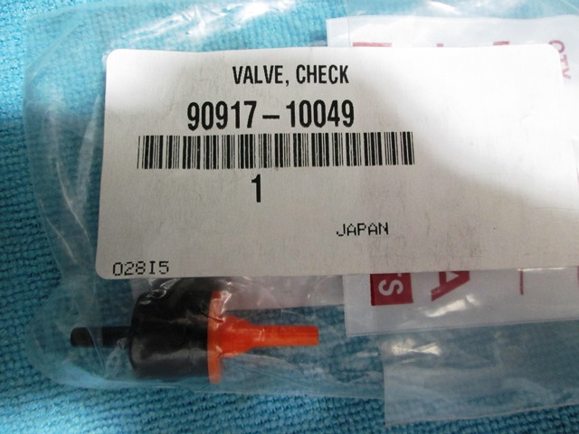

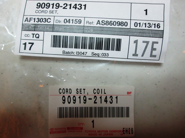

I also received some new hoses that are starting to crack and/or are hard like plastic. So I will do that in the morning also. For my own sake I'm posting pics of my part numbers I recently purchased for future reference.
This one is connected to the valve connected to the power steering unit and goes to the AC idle up screw valve.
This one is connected to the same power steering valve and goes to the manifold.

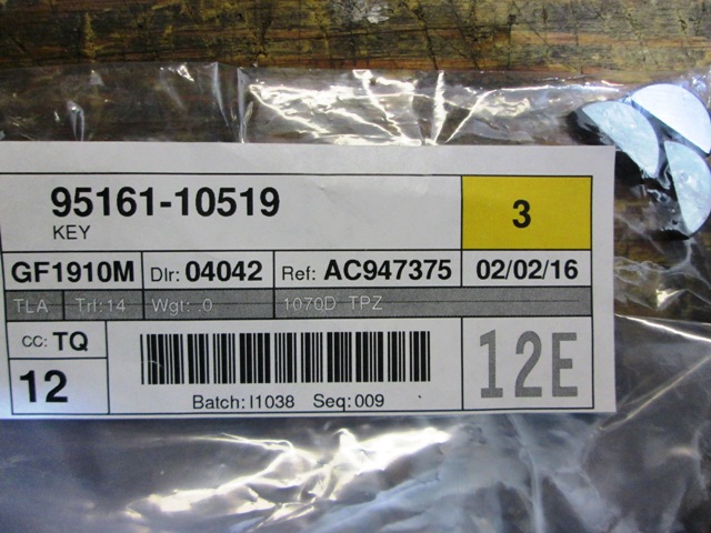

These are the woodruff keys that I thought I might need in case my harmonic balancer was moving and the key somehow broke.

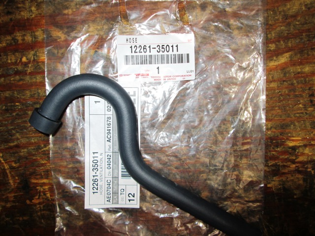

This hose goes from the manifold to the front top of the valve cover.
This hose goes from manifold to PCV valve.
The Four hoses installed

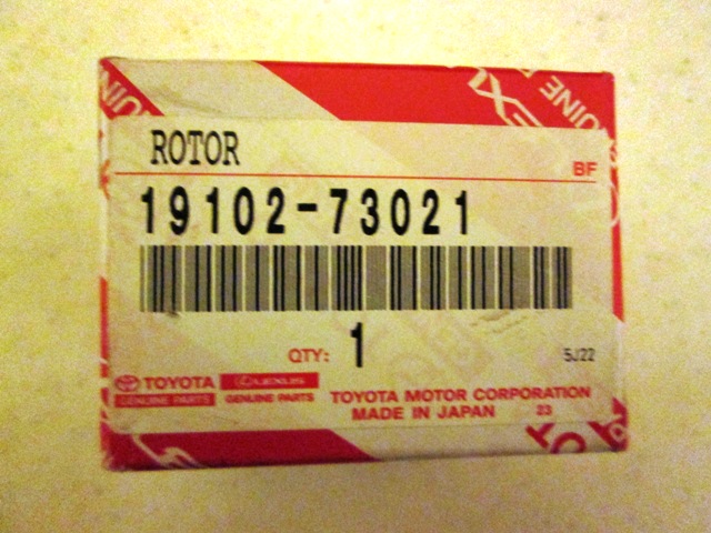

Rotor

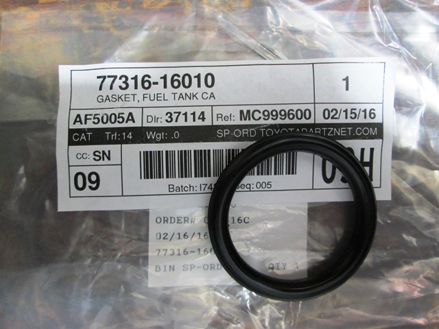

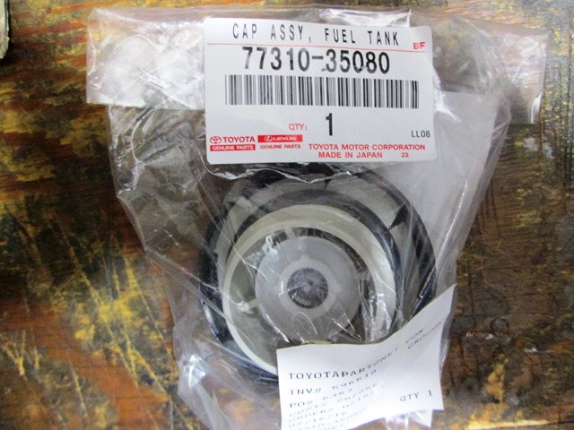

Also, my gas cap O-Ring is starting to crack. If it was cracked all the way through it would have failed visual inspection. Got to order a new one.

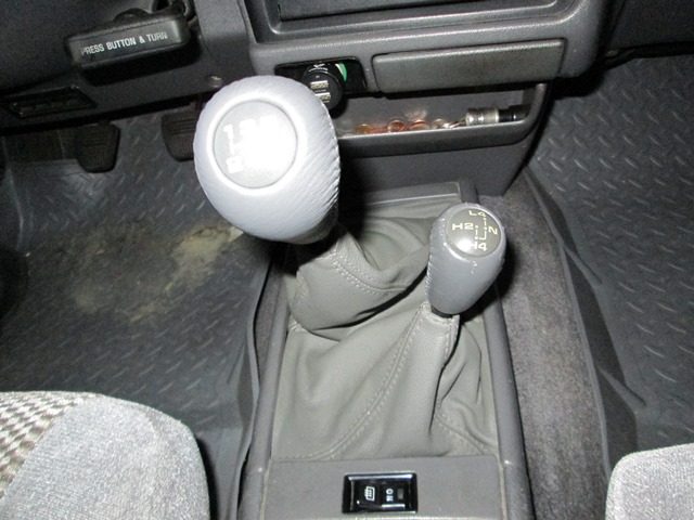

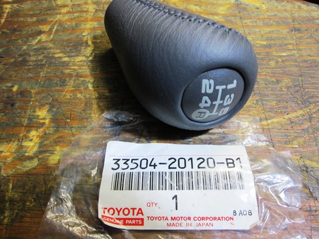

Found a killer deal! $20 delivered on ebay, it was a buy it now price, I wonder if the seller meant to set it as a starting bidding price.....this thing is $100+ from the dealership.
1992 leather shifter knob for an SR5 4Runner....brand new still in package.
Perfectly matches the 4WD knob I found at the junk yard....matching set now.

Those knobs are a nice touch. What did the floor liners come from? I've never seen them for older 4Runners.
Old Feb 19, 2016 | 08:51 PM
  #358
Grego92's Avatar
iTrader: (4)
Joined: May 2010
Posts: 720
Likes: 16
From: People's Republic of California
Originally Posted by 84 yota dude
Wow, nice find!! Good to hear you finally passed smog too.
Yeah, pretty lucky I think. Thanks, I was glad also....was pretty frustrating and a waste of two weekends trying to fix that timing issue. Ends up being a $.25 o-ring, crazy.
Those are Husky Liners for my 92' pickup. I looked for them for my 88' 4runner, but can't find them.

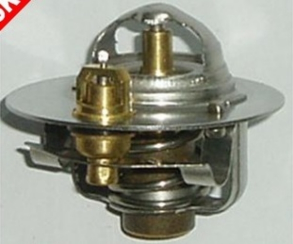

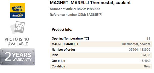

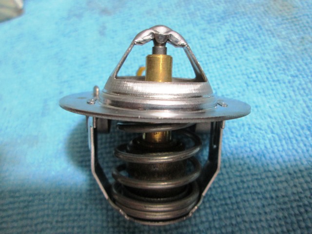

Old Feb 23, 2016 | 07:39 PM
  #359
Grego92's Avatar
iTrader: (4)
Joined: May 2010
Posts: 720
Likes: 16

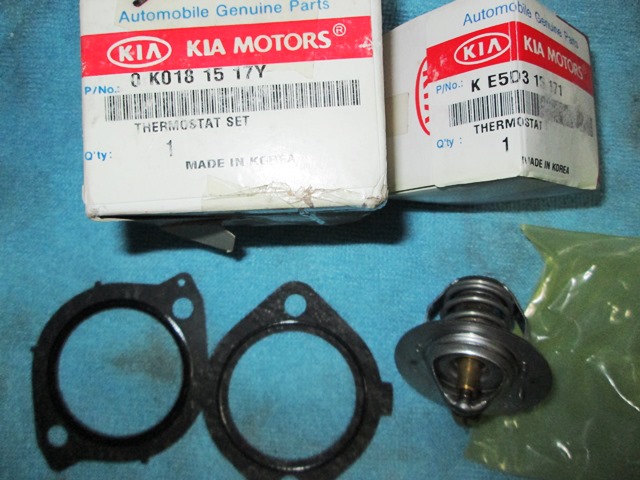

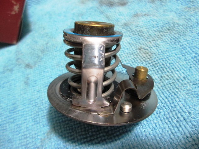

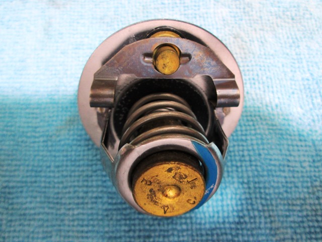

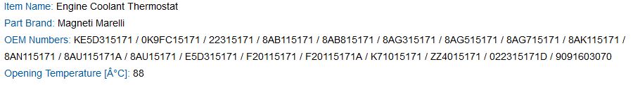

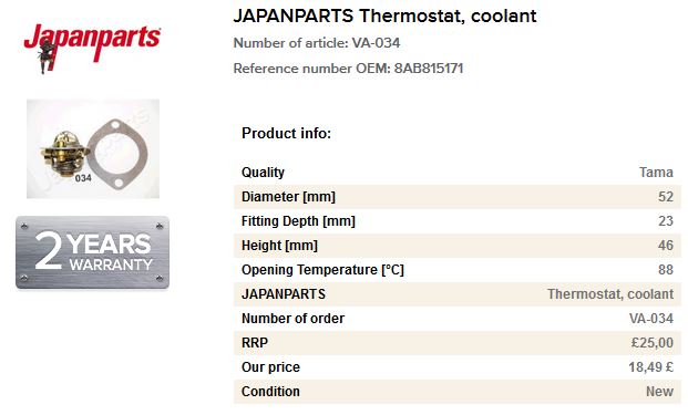

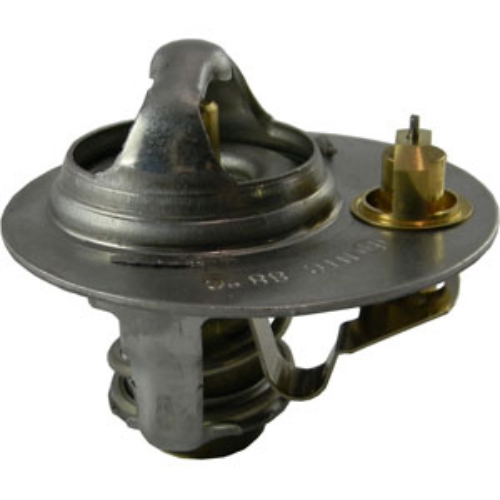

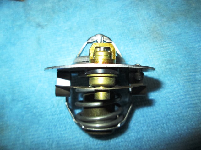

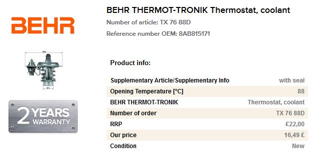

Research Project I've started regarding the dual stage thermostat that 4crawler had initiated. Attempting to find same quality for a more reasonable price. Appears many vehicles (european market?) use this same thermostat. Just notes for now:
TOYOTA 90916-03070 - $32.44 (Partznet.com)
KIA MOTORS - 0K0181517Y Kit includes Thermostat KE5D315171 - $12.76 (Kiapartsnow.com)
CHINA - Chinese made wholesale -
8AB5-15-171 80 88 Coolant valve thermostat - $2.50 per 100
KIA 0K9FC-15-171
KIA 0K710-15-171
KIA KE5DE3-15-171
MAZDA ZZ40-15-171
MAZDA B6H-15-171 A
MAZDA BP6F15171A
MAZDA BPD3-15-171
MAZDA 8AG115171
MAZDA 8AG3-15-171
MAZDA 8AB1-15-171
MAZDA 8AB5-15-171
MAZDA 8AG7-15-171
MAZDA 8AK1-15-171
MAZDA 8AN1-15-171
MAZDA 8AU1-15-171
MAZDA 8AU-15-171
MAZDA AB6-15-171
MAZDA F201-15-171A
MAZDA 8AB8-15-171
MAZDA 8AG5-15-171
MAZDA 8ABE-15-171
MAZDA 8AG215171
MAZDA B6H-15-171
MAZDA BP6F-15-171
MAZDA E5D3-15-171
MAZDA F201-15-171
TOYOTA 90916-03070

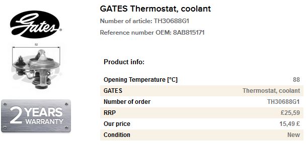

GATES TH30688G1 88°C INCLUDES SEAL - $25.79 (Rock Auto)
ASIA MOTORSROCSTA 1989-1998
EUNOS
500 1992-1999
KIA
CLARUS 1996-2001
KIACREDOS 1996-2000
KIA
RETONA 1999-2001
KIASPORTAGE 1995-2002
MAZDA121 1987-1990
MAZDA323 1985-2003
MAZDA
616 1973-1978
MAZDA
626 1988-1992
MAZDA
818 1972-1978
MAZDA
B2600 1989-2002
MAZDABRAVO 1999-2006
MAZDAEUNOS 500 1994-1999
MAZDAMPV 1988-1994
MAZDAMX-3 1992-1995
MAZDA
MX-5 MIATA 1990-1997
MAZDA
PROCEED 1989-2002
MAZDAXEDOS 6 1992-1999

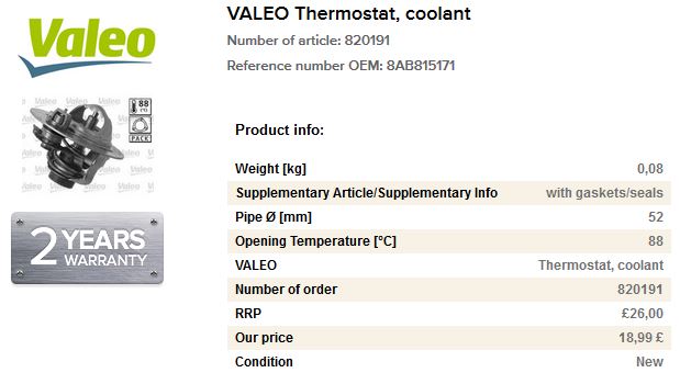

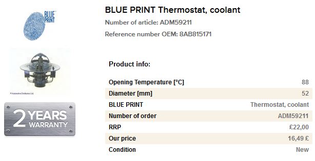

WAHLER - 85 DEGREE
