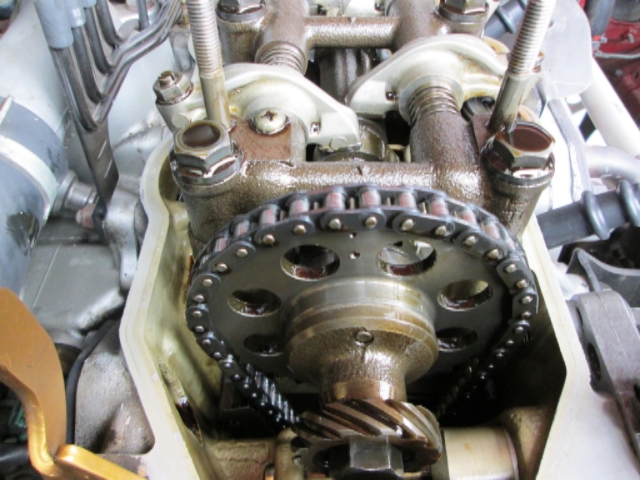

I finally start to eye balling my TDC and this is what I come across. I've read about "jumping" a tooth and all that, but I just can't see how that could happen? I would read those posts and just think they didn't have it set correctly to begin with. Does this and can this really happen? See my photos below and tell me what you think. My crank pulley mark is on the "0" mark, my cam gear mark is after 12 o'clock and my rotor seems too close to 12 rather than 11 o'clock.

If I am actually a "tooth" off now, how the heck can I put it back without tearing down?

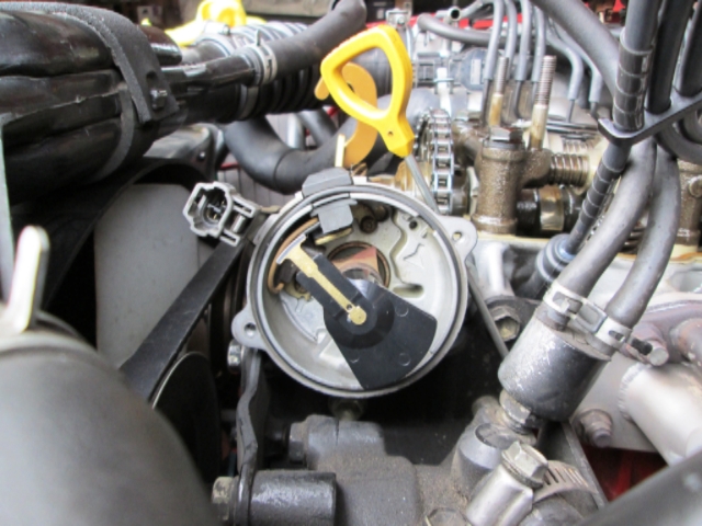

At some point did you remove the distributor? The helical gear has 13 teeth, so if you are off one tooth it's about 28°. Even though the timing chain is all correct.

Yes, I have pulled the distributor out and I put it back in the way the manual states, something I'm missing?
I would love it to just be the distributor positioning

I don't know if this would help but I would manually put it at tdc. I would actually do it with the distributor cap off and the valve cover off just so I could make sure I'm all lined up on my shiny links. Plus you'll see that groove I'm fixin to tell u about in the next sentence.
Now I read that you pulled the dizzy. If you got everything lined up and you put the dizzy back in then there's a little groove that should be just in the front after you stab it. I tried finding you a pic but can't find it.

This certainly is not possible.
The cam and cam sprocket can only go together one way.
The sprocket must be disengaged from the chain and the sprocket moved 1 tooth counterclockwise in relation to the chain..

Yes, I have pulled the distributor out and I put it back in the way the manual states, ...
Like this:
http://web.archive.org/web/201101242.../5distribu.pdf

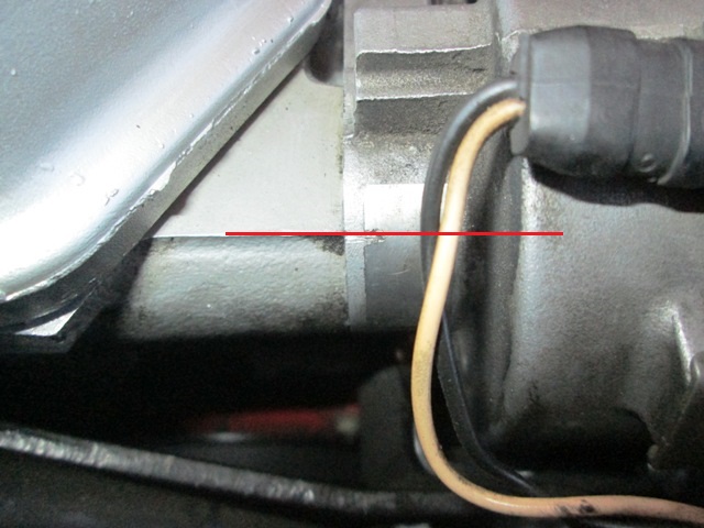

I was able to get the crankshaft bolt off, and using an inspection mirror and flashlight, this is what I saw. I think the two "lines" at the end of the shaft itself are where it should be and represents where the key should be lined up with. You can see my groove on the balancer where it should slip over the key is not lined up with the two lines. The distance between the two seems like it would be why I'm showing 19 degrees advanced beyond the expected 12 degrees with the gun (not jumpered). I have a gun that can adjust for advanced degrees, that is how I came up with the 19 degrees (forgot mine had that feature ).
Even if what I'm thinking is wrong, I still think RJR is right and it is the harmonic balancer, and the rubber separated. I've exhausted everything I can think of??? Can anyone verify those two lines represent the location of the crankshaft key?

I don't know what the two lines represent. But it's hard to imagine that you could have broken a woodruff key without a lot more trash evident. It's also hard to imagine you forgot the key when you replaced the Harmonic balancer.
I would inspect the balancer first for a tear in the annular rubber piece that RJR referred to. If you have a broken woodruff key, that's going to be one hell of job to fix. I would probably do the test RJR described to verify where TDC really is (by the way, why did he recommend using a soda straw? Wouldn't a screwdriver work?)

The crank snout on the 22RE that I am currently building has the two marks on its end.
Why the marks exist, I don't know, they may well be some sort of inspection mark that is randomly positioned on the crank snout....????
The marks on mine DO NOT correspond with the keyway line.
On mine, when the keyway is @ 12:00 the marks are at near 3:00.

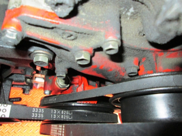

I had forgotten that I took these photos also. I wish I was thinking and pulled the #1 plug to make sure I was at TDC.
After using my timing gun and came up with 19 degrees advanced beyond the 12 BTDC (not jumpered), I tore down and cranked it to what I expected to see with my pulley lined up at "0". I expected the cam sprocket and rotor position to look like what is seen in the pic below.

However, when I shined my flashlight down to see where I was lined up at, I saw this.....about 19 degrees before "0". (Dang, gotta clean my engine )

When the cam sprocket mark is @ 12:00 the crankshaft keyway should be @ 12:00 also.

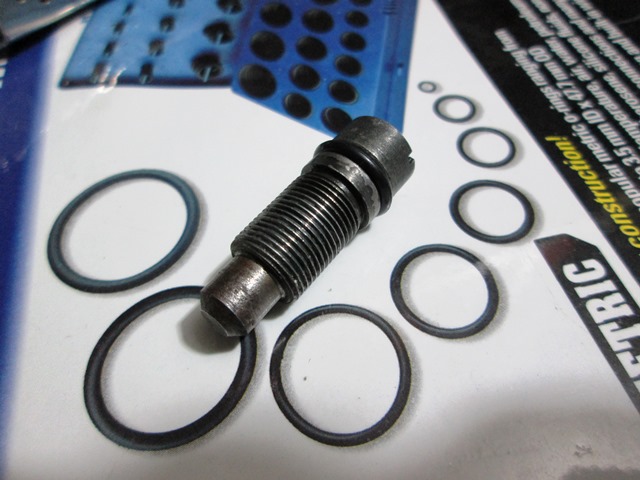

Guys, thanks for all the help. I think I just found the culprit this morning. The last few days I noticed my idle kept increasing to about 1100 RPM after driving around. I would get to work, park, and then notice my idle was high. I pop the hood and turn my idle screw so it is back to 750-800. Drive home and the same thing, so turn the screw again. Finally get some duct tape to keep it in place for the next day. Last night I check the forums for the o-ring size since I have a metric kit from Harbor Freight.
See my post toward the bottom on this thread. https://www.yotatech.com/forums/f116...51/index2.html
I do this late at night and don't even turn the engine over, just glad it's nice and snug again so I can take the stupid tape off. I estimated where the screw should be, and after warming up in the morning I was right around 800.
Drive to work and.......hmmmmm....engine sure sounds and feels good. Hmmmm....doesn't seem to vibrate as much either.....acceleration is pretty good.....feels pretty nice overall. Maybe I had a vacuum leak there also ?????
I had my timing gun in the cab. Get to work, park, and adjust my idle down just a tad to about 750-800. Shoot it un-jumpered and I'm at 8 degrees BTDC!!!!. I'm on to something. Throughout the day I drive the truck to lunch and other places just so I can check the timing again after parking. Stays at about 8 degrees BTDC.
In the morning I'm going to replace some other hoses that I noticed were hard and/or starting to crack with ones I just received in the mail from Toyota. Then I will re-adjust my TPS and see if I'm at 12 BTDC un-jumpered and 5 BTDC jumpered. Then if I need to, adjust the distributor a bit.

I am good guys. I replaced a few other hoses, and adjusted the distributor just a "smidgen". Thanks for the help, regardless.
It was just pure luck that the o-ring gave out enough to move around in the last few days and I have a memory that remembered the direction of the screwdriver slot on top of the adjustment screw to notice that it moved from a North/South to an East/West direction.
Gawd I REALLY hate vacuum leaks now!
The only thing that still puzzles me, is that my TDC on the cam sprocket is just past 12 o'clock, whereas on others it is just before 12 o'clock. I wonder if it because I have an engnbldr 268 cam rather than stock?
