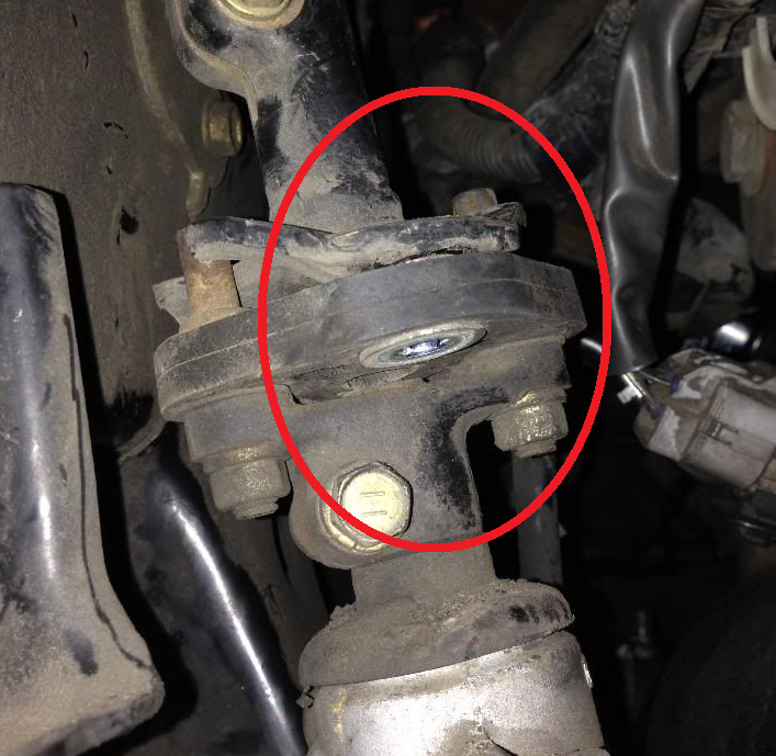

That isn't actually my rag joint. I only unbolted it at the two splined shafts.

I was thinking this too about the splines being misaligned but the only place they could be misaligned would be at the rack shaft. The spline on top of the rag joint and the spline at the firewall to the upper steering shaft can only go in one way since they are notched.
